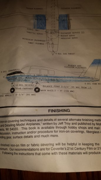

Oh wow.. I remember that plane in the magazines in the 90s when I was a kid.. Always thought it was huge and looked cool.. There will be very little info if any on the web.. However the Hershey bar wing makes it easy to cg. Should be 30% standard behind the leading edge.
If anyone ever comes across one of these for sale, Id love to have one. We've had a full scale Musketeer in our family since 1976. Id love to have a GS model of it.

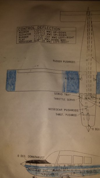

Here is the cg. 3 3/4 from the leading edge.
