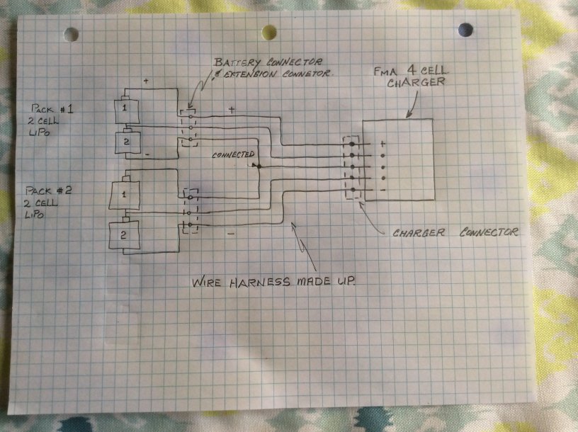

Please see the attached sketch. The sketch is showing 2 - 2 cell packs being charged as a single 4 cell pack. I believe this works and gives me an advantage of twice the amps that each pack can be charged at from the charger. Note all this came about that I was at the field and needed to charge my flite packs back up. The only charger that I had on hand was a four cell charger that could charge at a maximum of 4 amps. (FMA 4 PLUS). Yes I know I can parallel the two packs. I just believe that if I take the time to build the wiring harness from the two batteries to the charger, it will give me some advantage. What I am not sure about is, is there something about the internal workings of these chargers that I am missing. This set up gives more power to charge with and the charger sees all four cells to balance.
Your comments and help will appreciated.

From your diagram, you are charging in Series. Which means voltage increases for the packs, capacity remains the same. So, you would be charging as a 4S pack and your rated capacity ie 2600mAh or 2.6A Now, if you were charging in parallel, your pck voltage would be like a 2S pack, but your capacity would increase (double). Which does mean that you can charge at a faster rate, but still would be a MAX of 4A pertaining to your charger specs you listed.
Honestly, your best bet would to be to buy a parallel charge cord for your packs and a parallel balance cord.
I don't think that will work because a 4s pack is all in series and your diagram has split the packs such that your ground is in the middle. I believe the charger will see 0 cells connected. I think what you want is a harness that connects them in series. Flipping a batt in the diagram so that battery battery 1's positive is connected to batt 2's negative.

Thanks for all the responses from everbody. The batteries are connected in series and the charger will see the terminal voltage at 16.8 volts max. (4.2 Volts/cell fully charged. ) The "Y" is connected the same way as a four battery pack would be. Yes I agree that a second charger will do the trick and avoid any possible connection errors. Yes again at home all my batteries are balanced and brought back to storage charge ready for the next flying day. Yes to the connection between the packs while charging through the balance port the packs need to disconnect from all the switches in the plane. That one I missed. Yes that will give you a ground error. Ok will not do this.
Ok can we take this one step further as a technical discussion. the two pack are removed from the plane they are on the work bench they have both been balanced and have about the same charge, the main power leads are not connected. Like to charge as shown in sketch. WHY WILL THIS NOT WORK.
You need to have the discharge leads plugged in, as well as the balance leads. If you have done this, then there is an error in the wiring harness.
