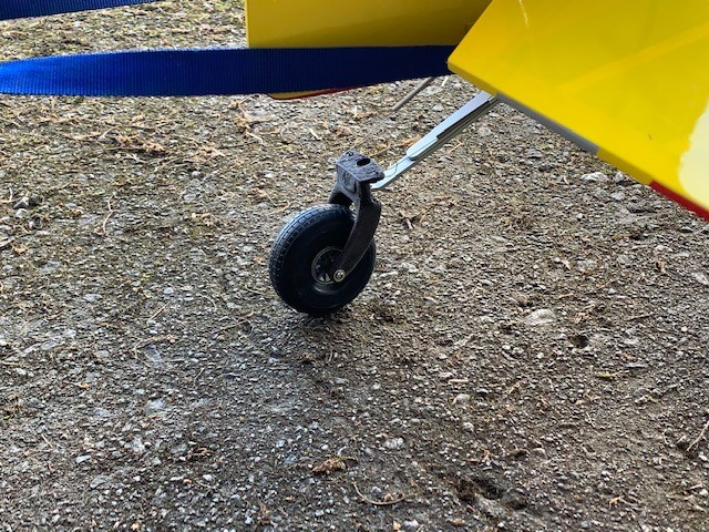

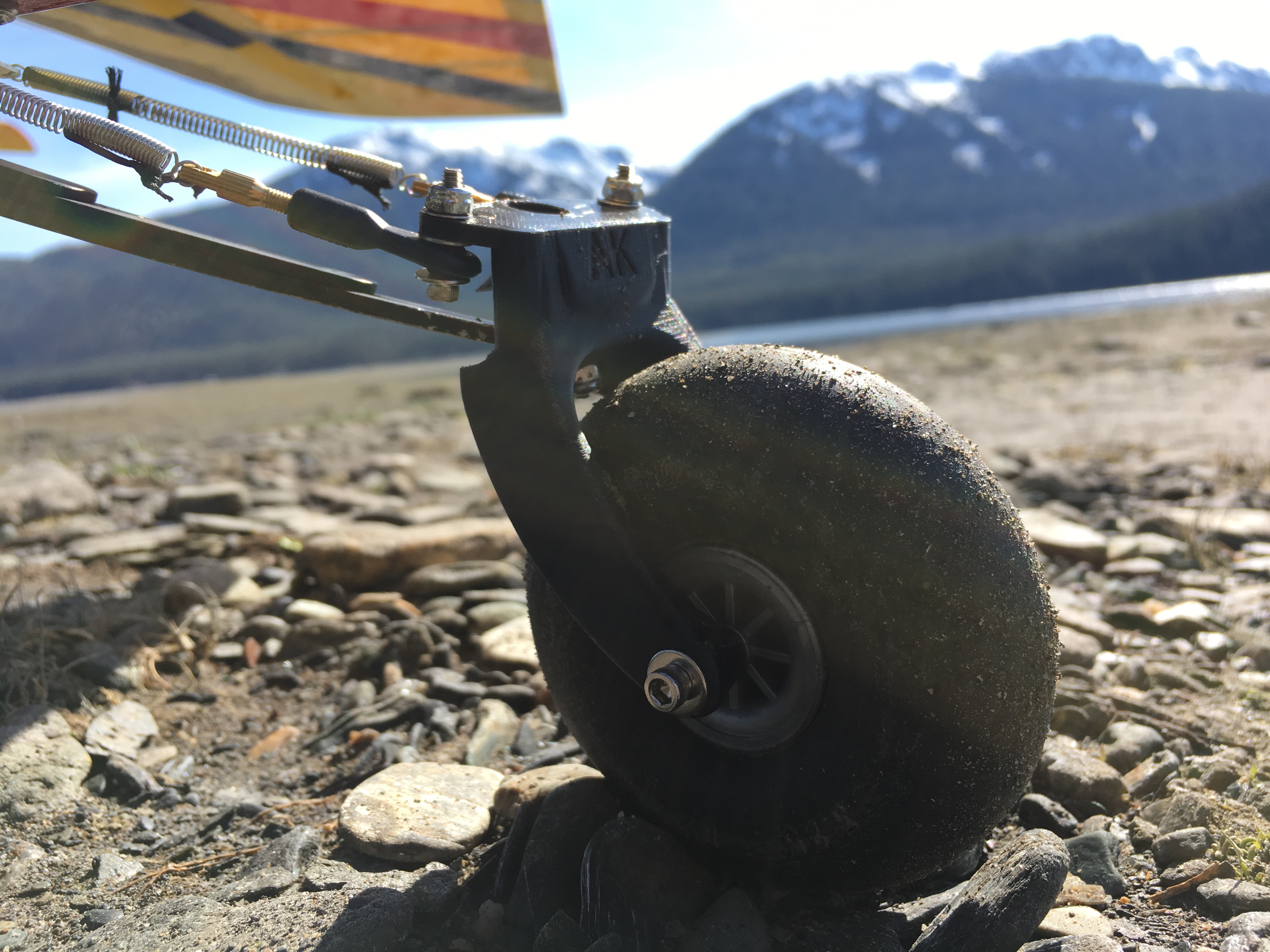

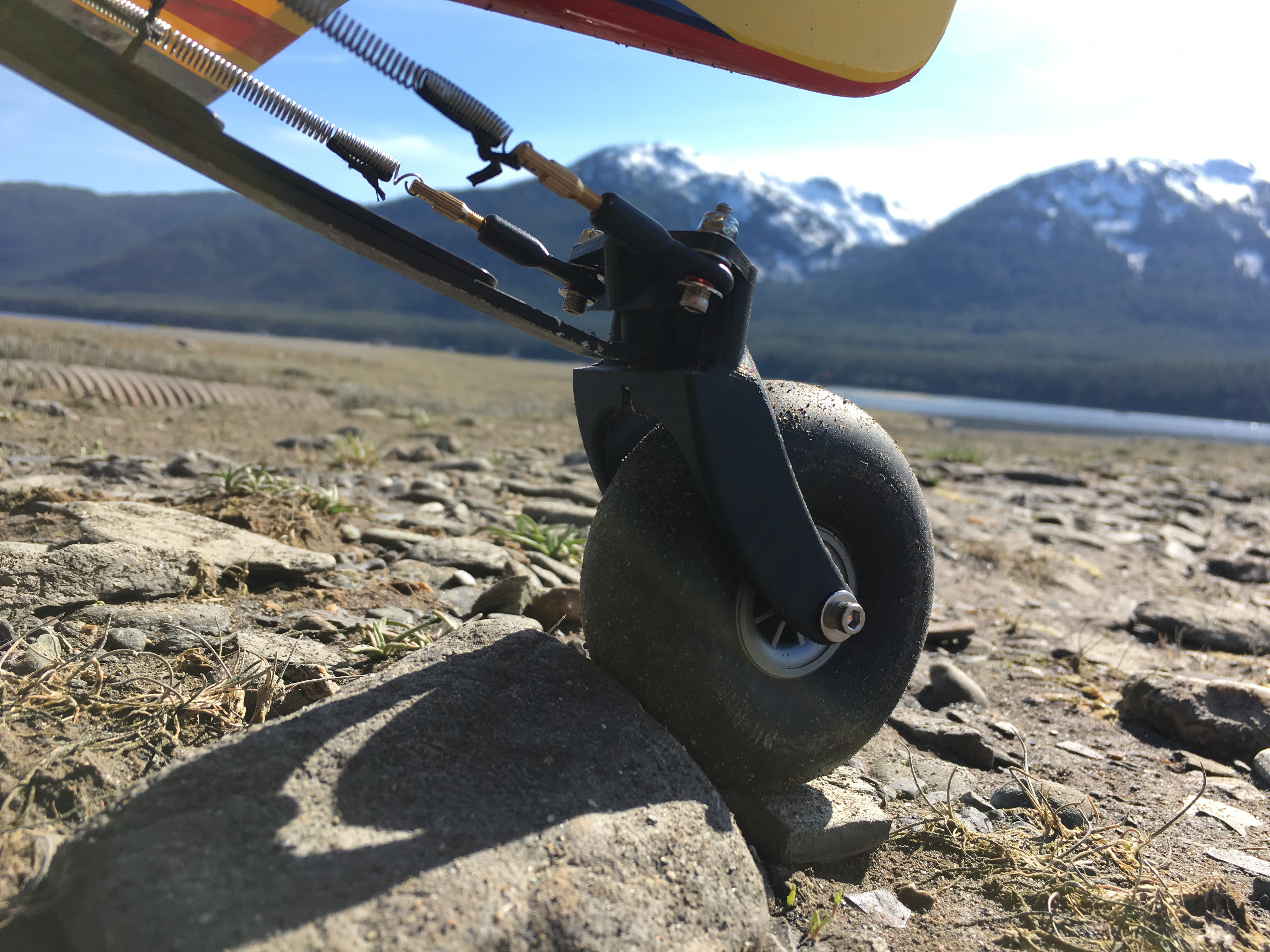

UPLOADED my Tailwheel fork to Thingiverse! That was a long time in the making. Now anyone with a printer can give it a whirl.
https://www.thingiverse.com/thing:4484038
View attachment 114996 View attachment 114997
@AKNick, installed the tailwheel you uploaded to Thingiverse !! Looks great.. Got to modify the spring steering cables to a system similar to yours.
-now the maiden next. Unfortuntly, weather just turned **** over here, but as soon as the WX improves, it will get airborne.

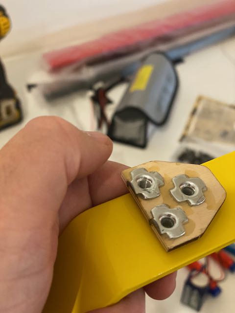

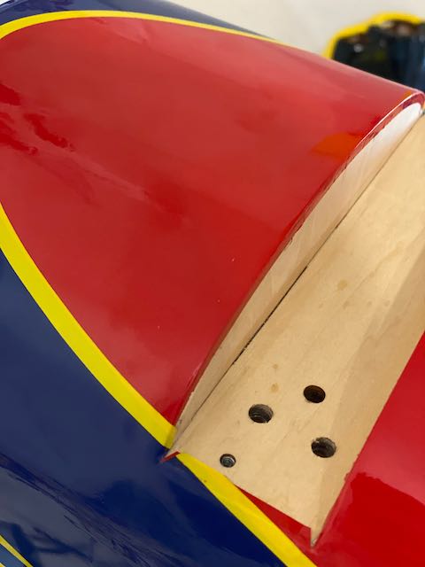

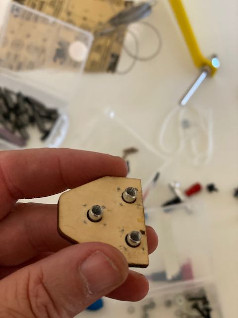

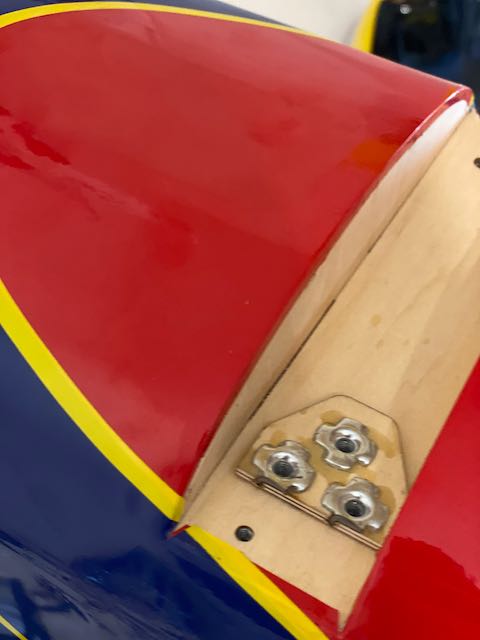

For those that have installed the stock gear...the instructions are less than clear to me. Maybe someone can help. The wooden mounting plates with the 3 blind nuts mount between the gear and the fuse, and the manual seems to show the side with the blind nuts protruding faces the gear vs going into the recessed holes in the fuse. Also, it just says 'screw them in'. Into what? The blind nuts in the fuse are larger than the bolts with the gear hardware (and the bolts with the gear do fit the wooden plates). Are you supposed to install the gear using the 4 lock nuts and put them inside the fuse when screwing in the gear?
Thanks
320CKA
30cc
The last photo is what the manual shows as 'proper orientation' -- but the protrusions from the blind nuts would be stuck between the plate and the gear....this can't be right is it? They fit perfectly into the fuse as shown in the other photo
Post a pic of your make! I'd like to see your finished print :)
May not be the best pic.. need to do some mod's with the springs, but have not had time to figure it out yet..
(New to printing...so still some tuning to make the finish perfect)
