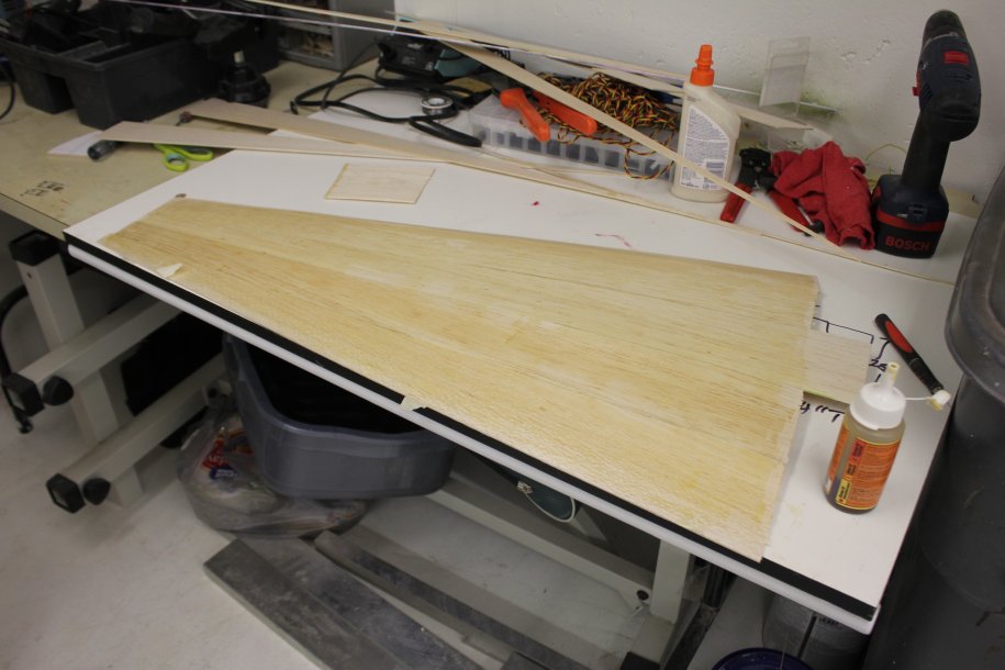

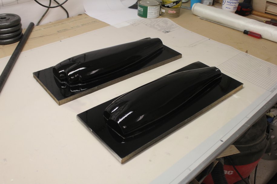

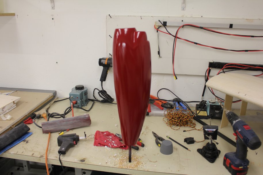

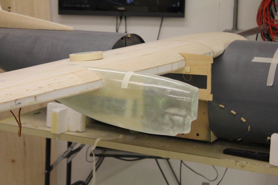

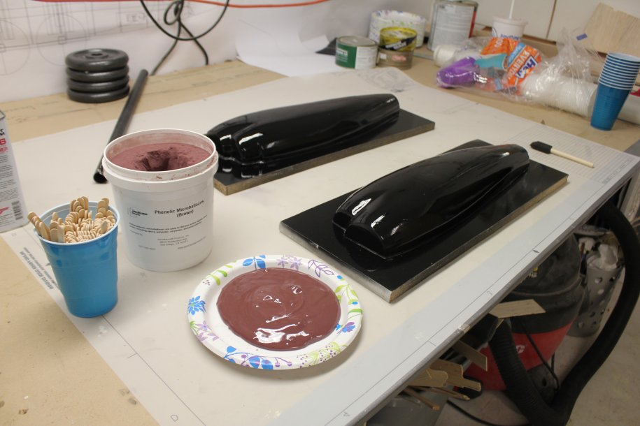

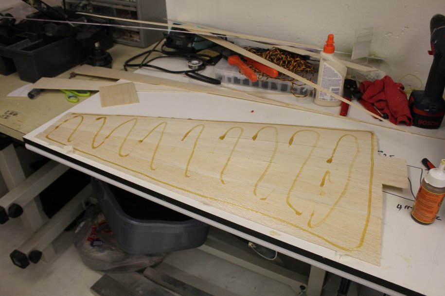

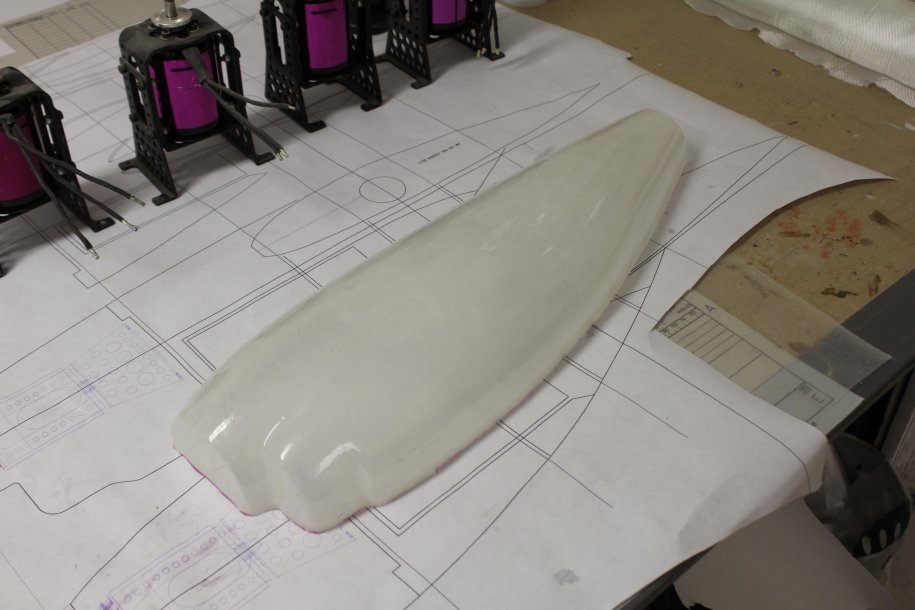

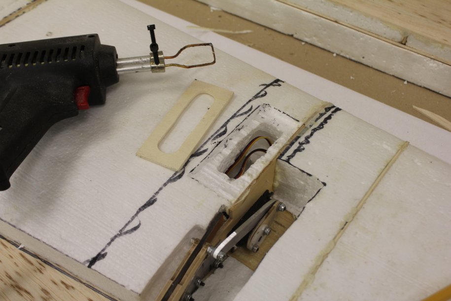

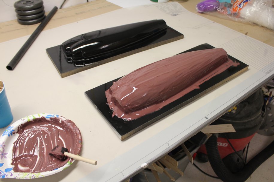

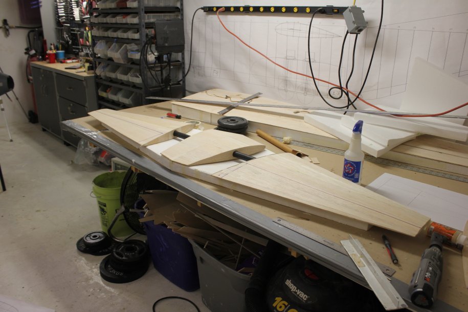

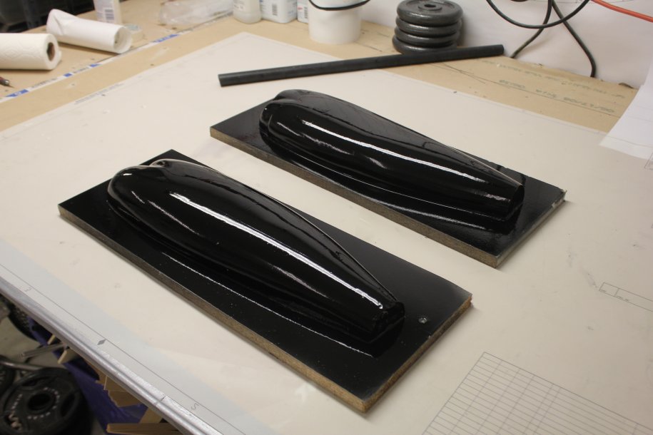

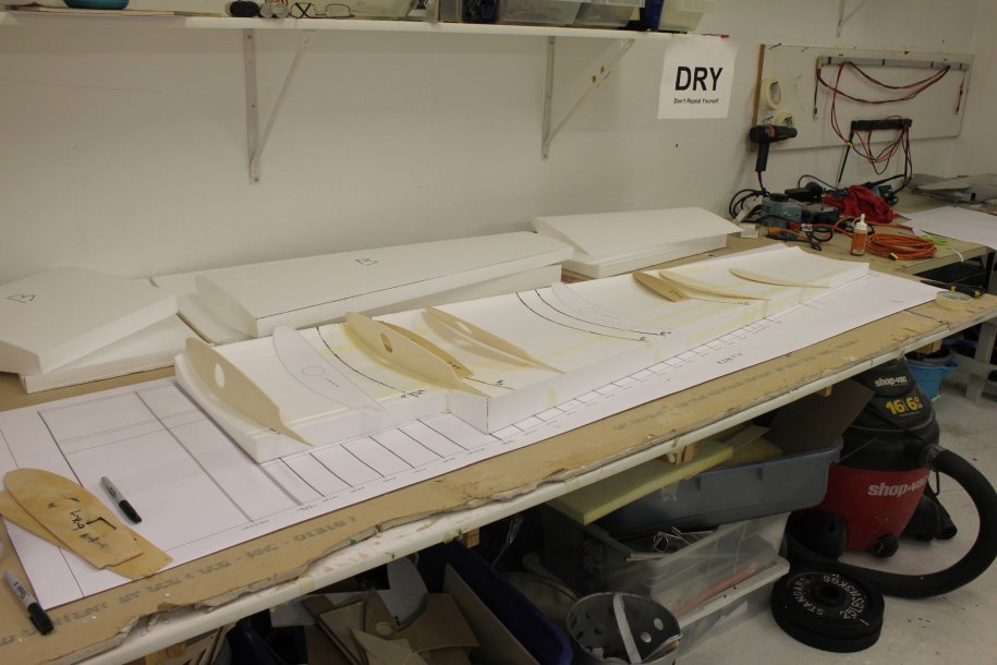

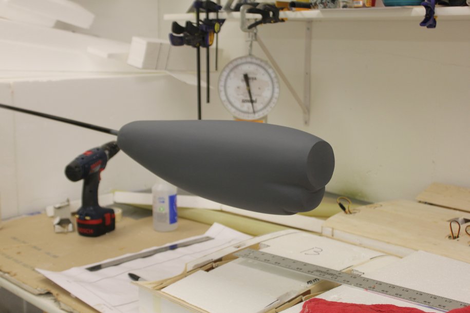

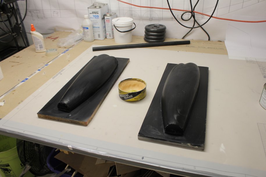

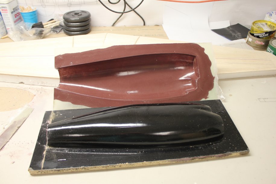

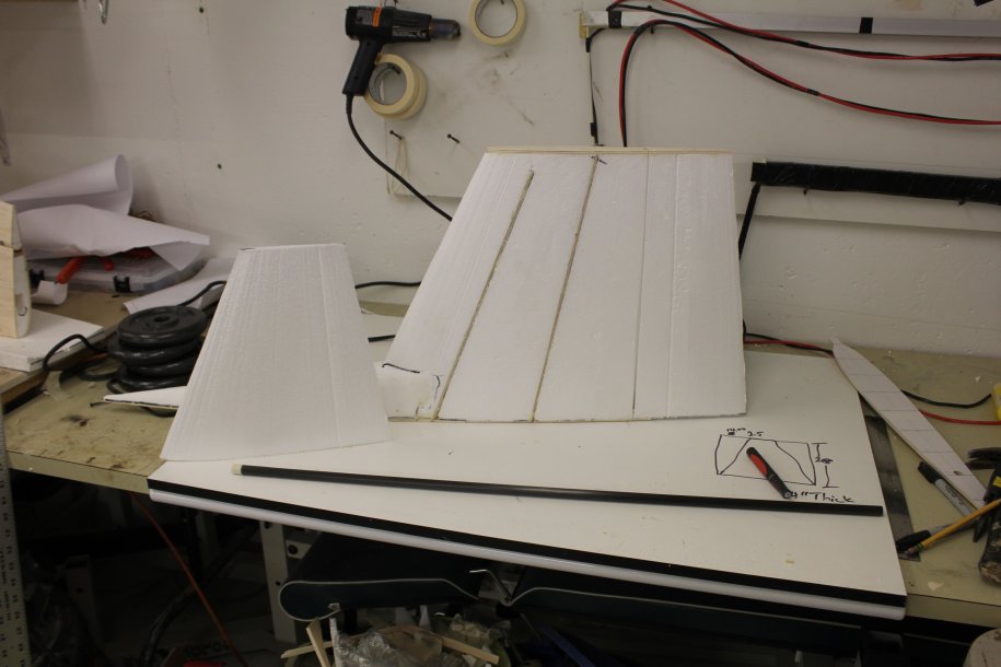

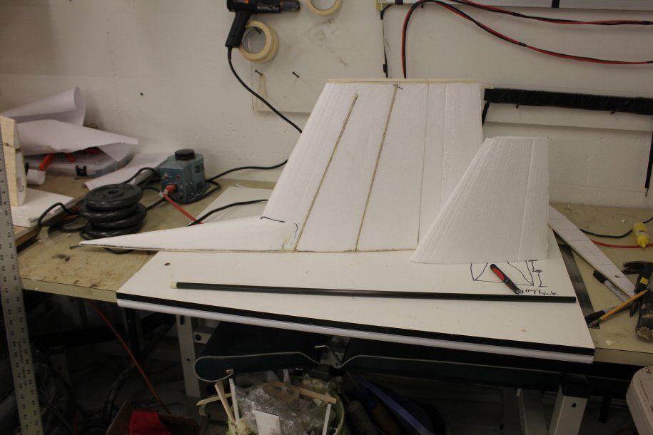

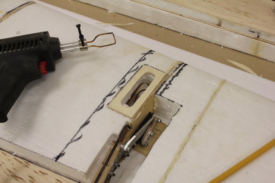

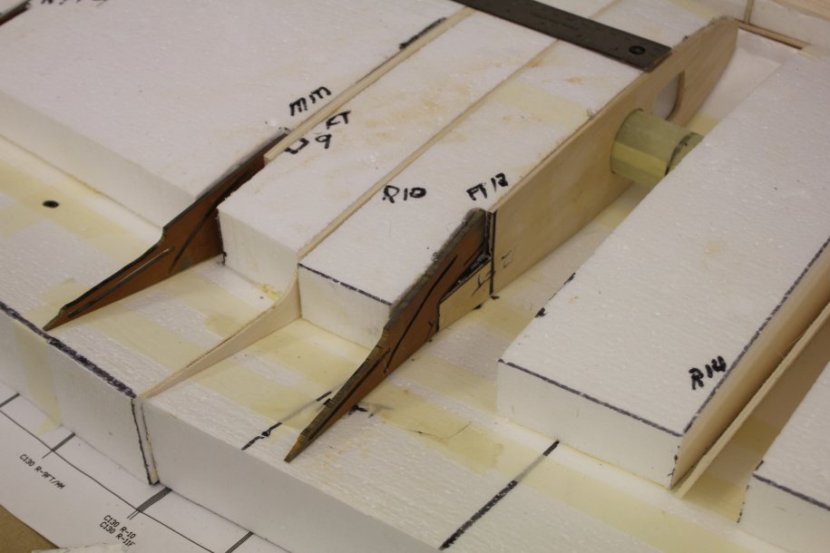

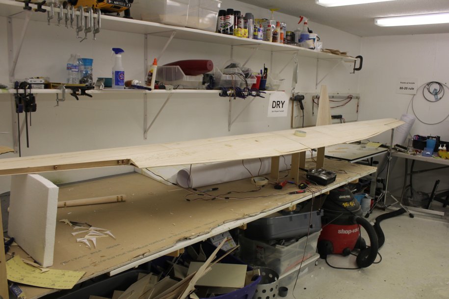

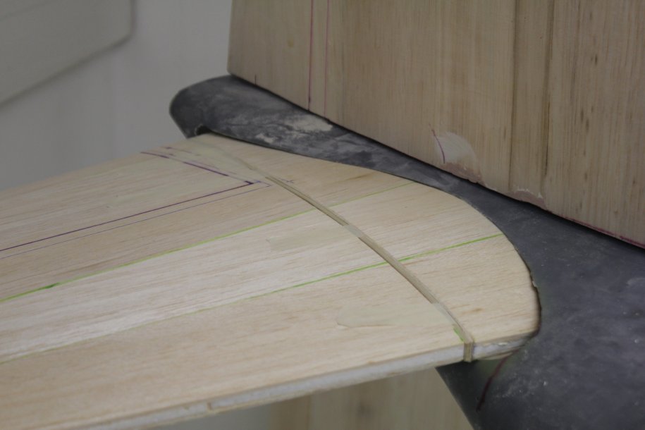

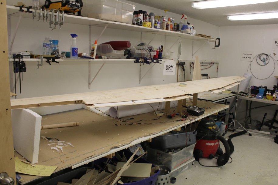

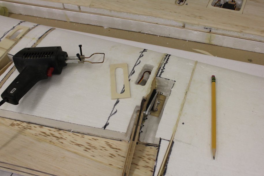

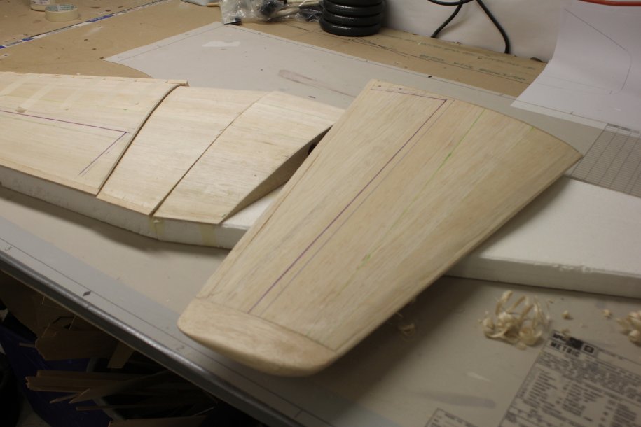

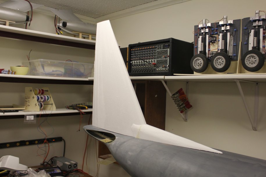

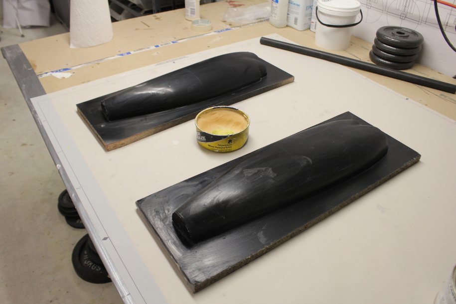

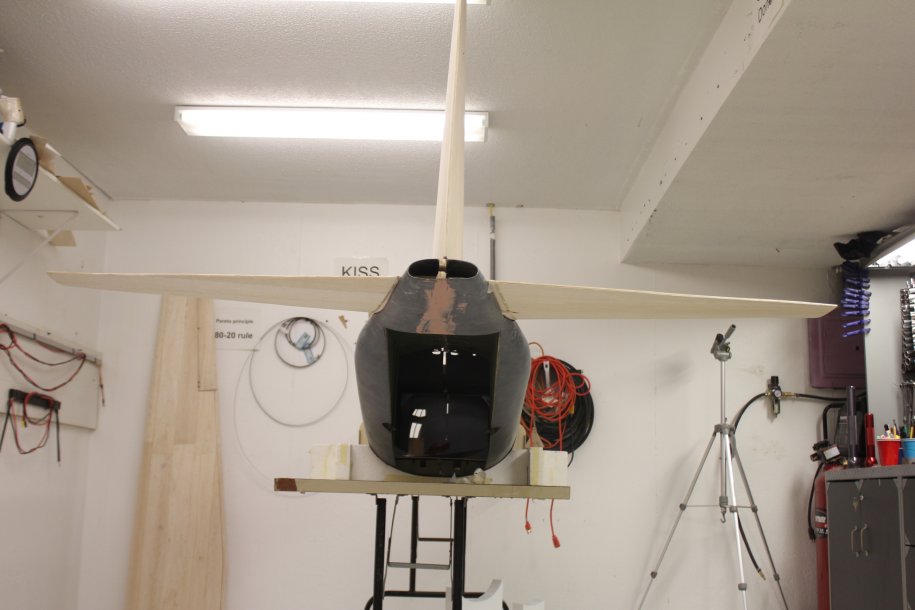

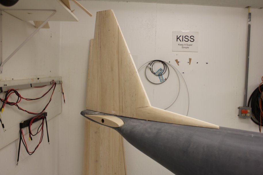

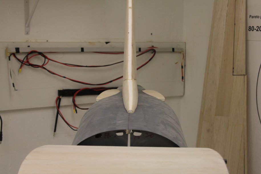

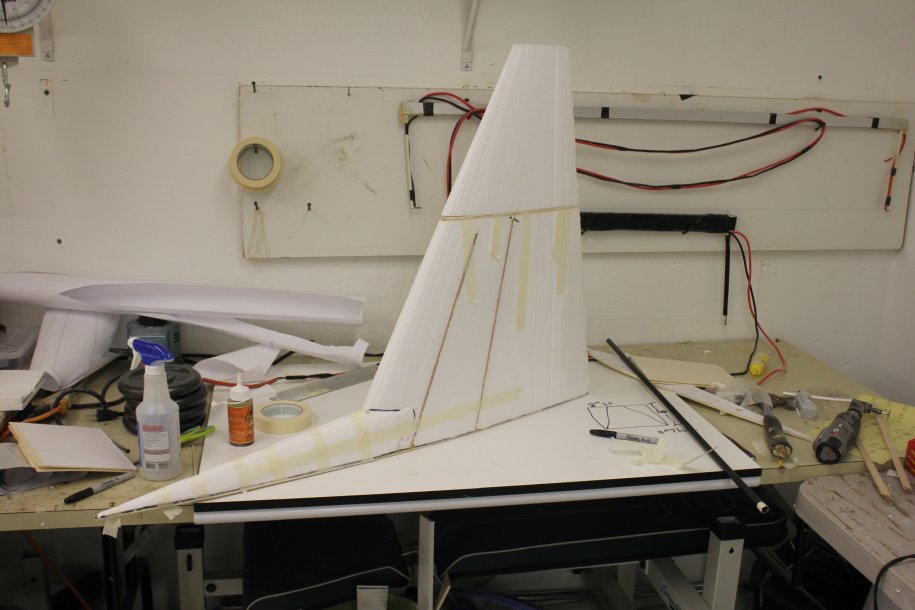

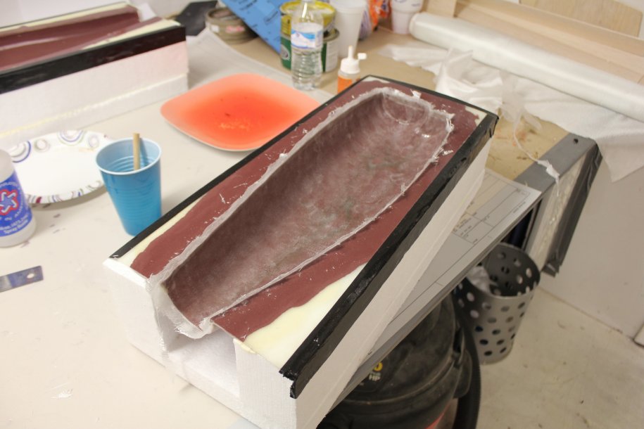

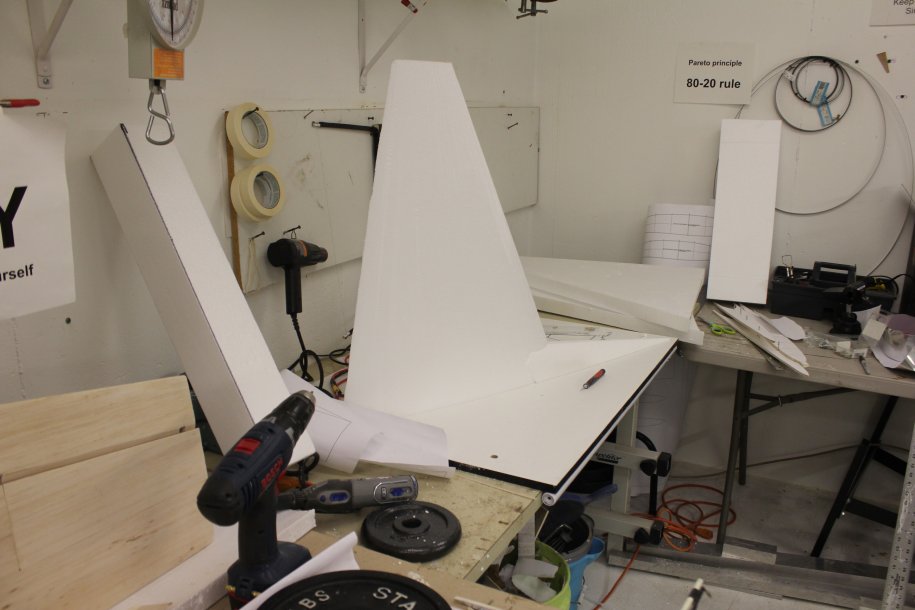

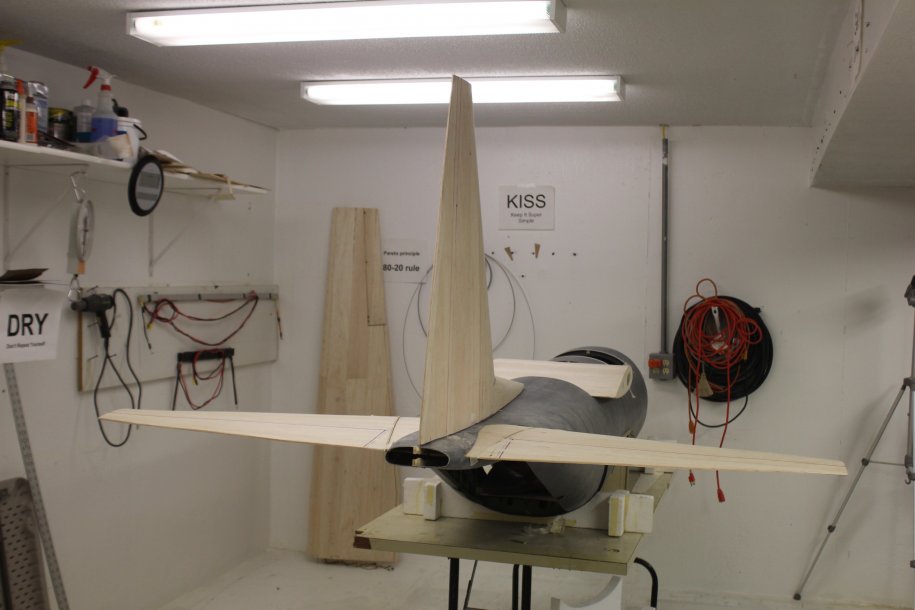

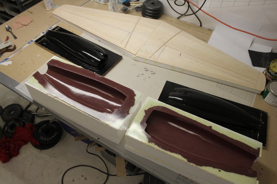

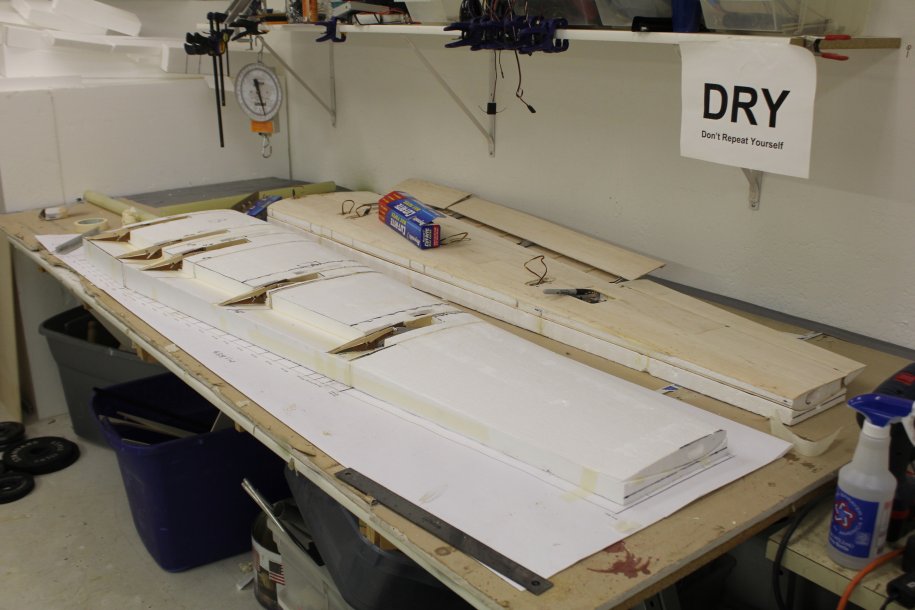

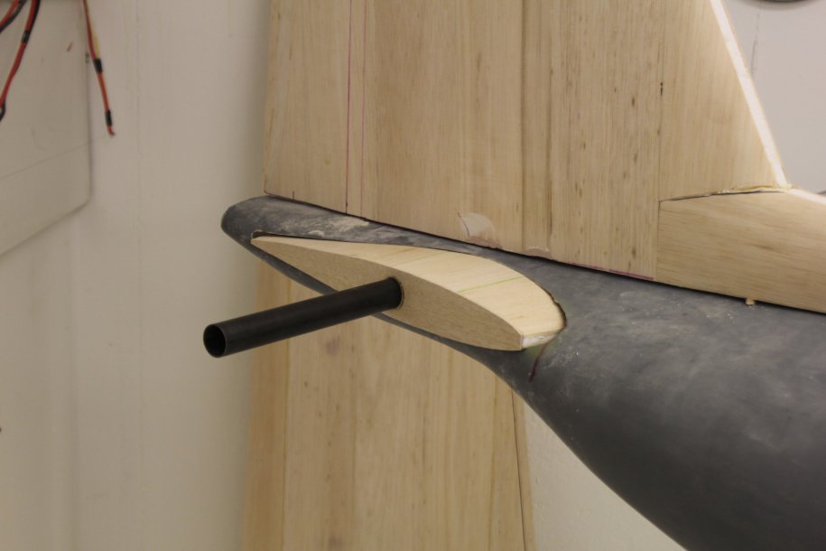

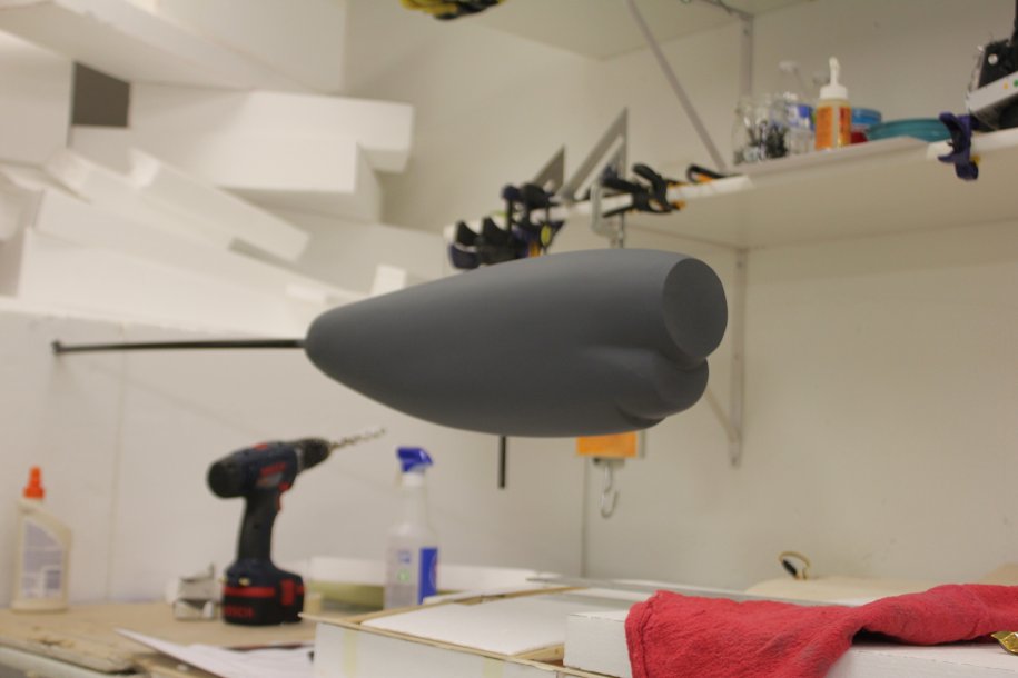

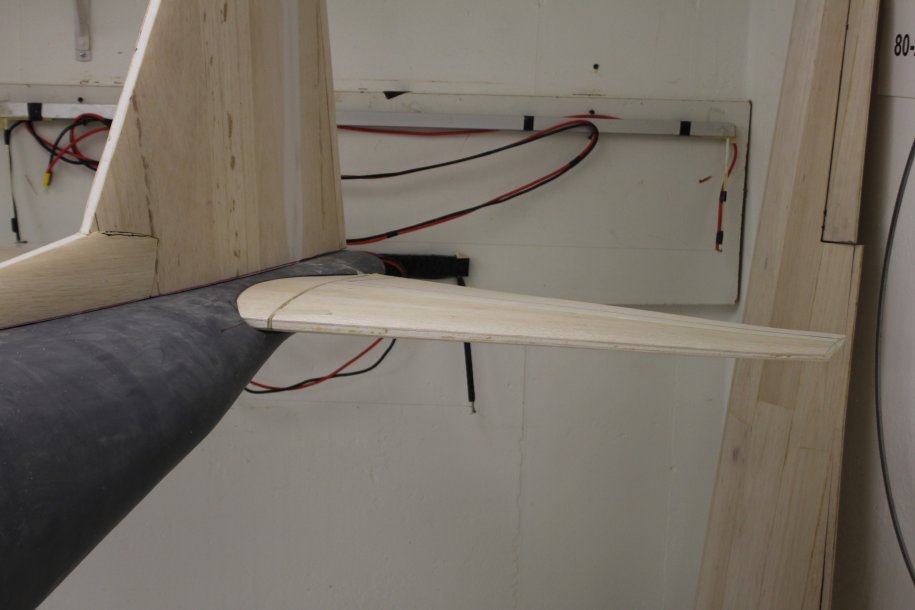

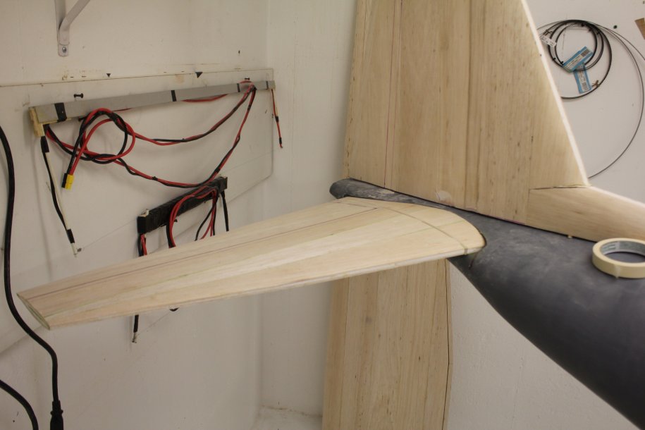

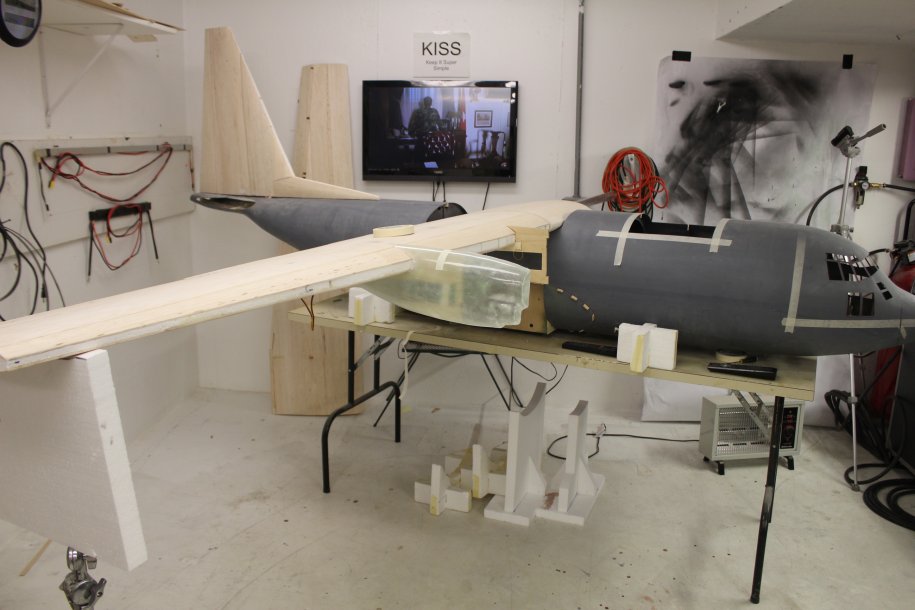

Thanks all for the wonderful comments. She is really coming along very well now.
Here is what I have done over the last week its not a ton due to my travels for work!!

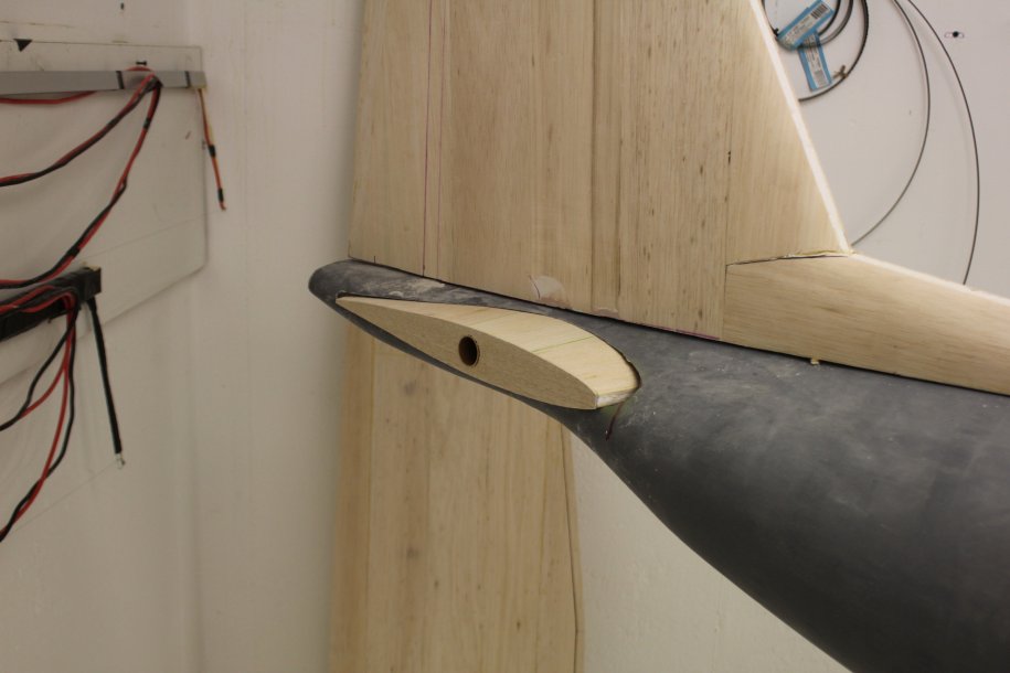

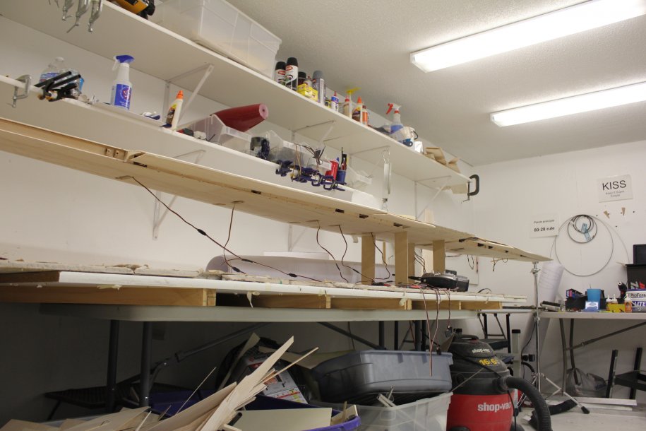

DAG214
Its a update:):):)

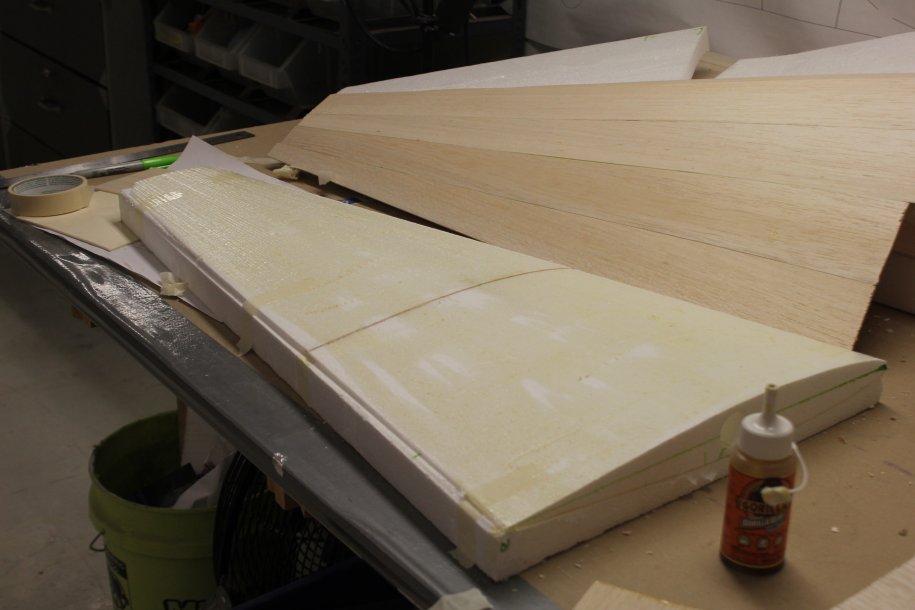

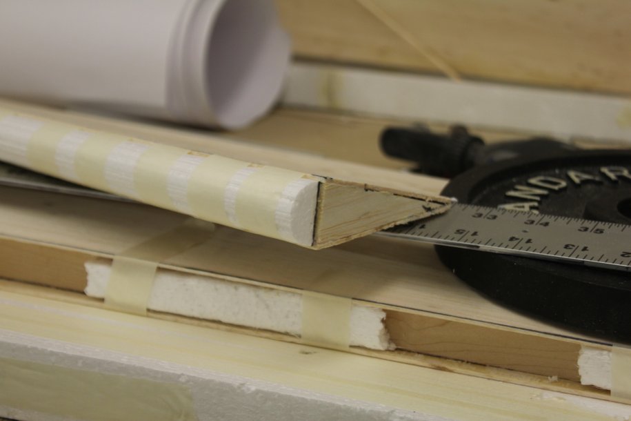

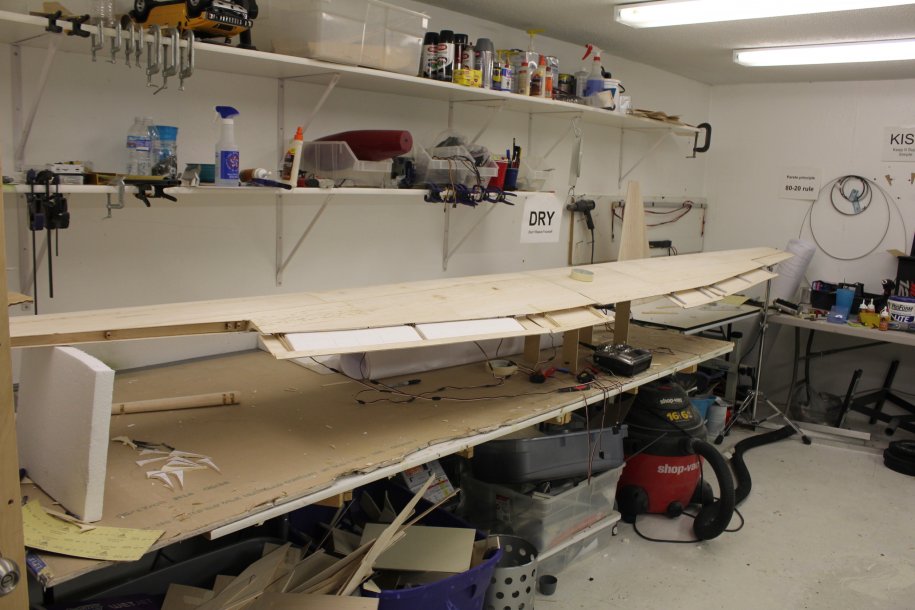

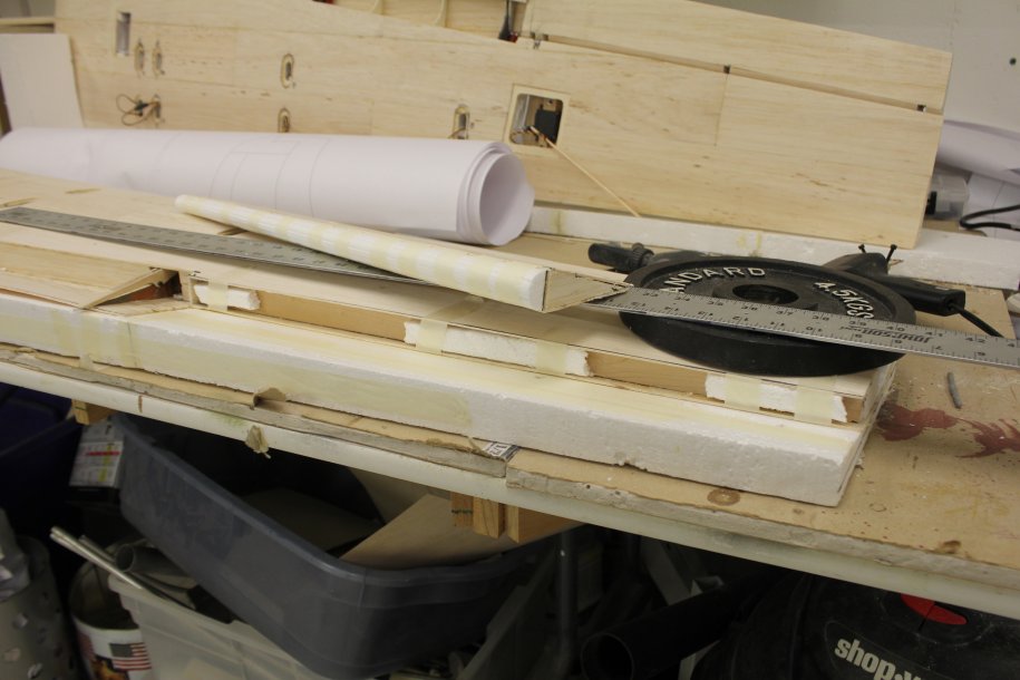

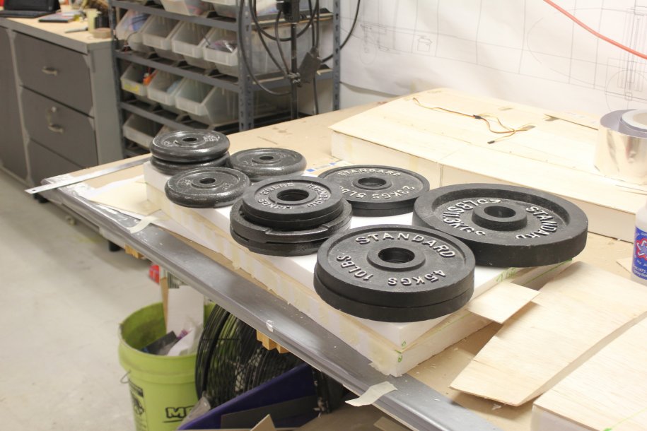

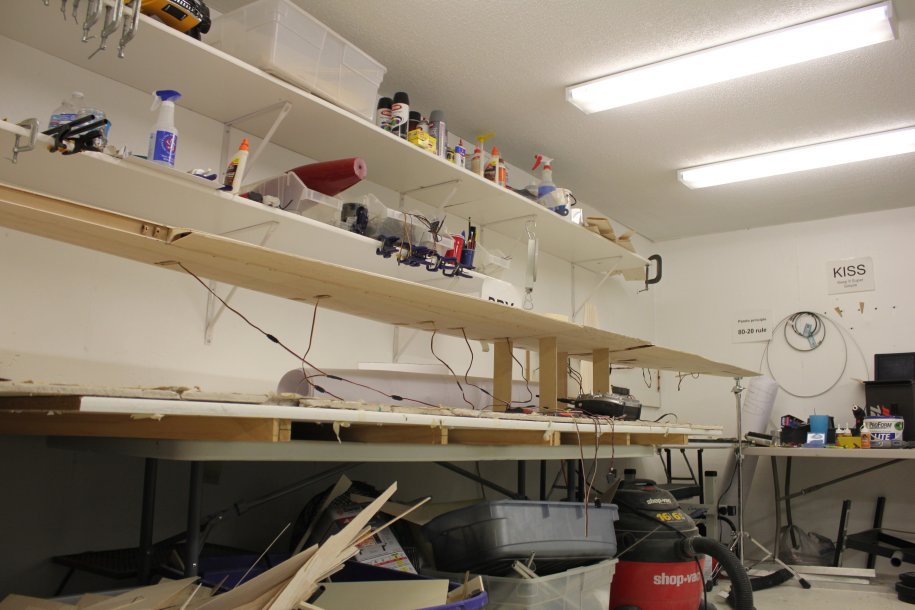

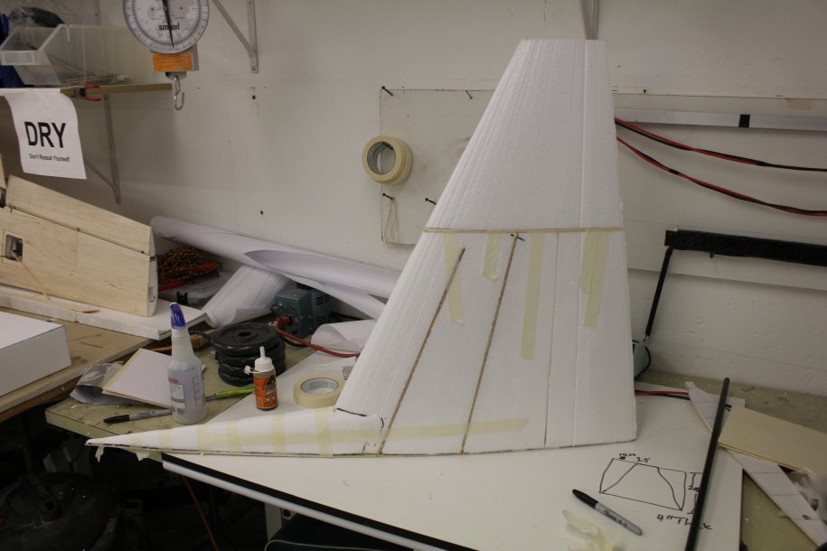

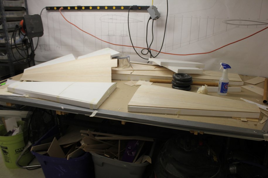

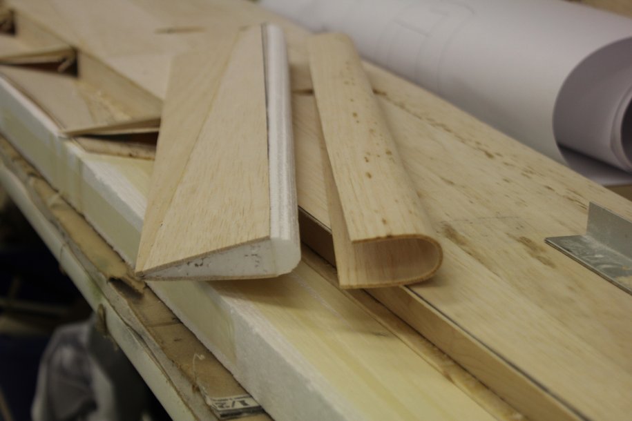

I clamp my foam wings between 3/4" MDF. No weights needed. Awesome project though, thanks for the update.
DAG214
I have tried the MDF way, but it bows with 80" wing sections. I have just found it easier to use weights. Maybe one day I will make large MDF jigs which are reinforced.

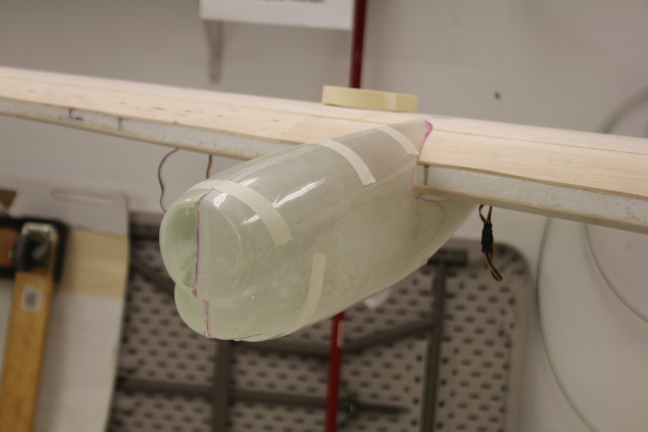

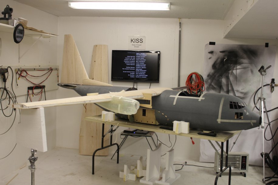

DAG214

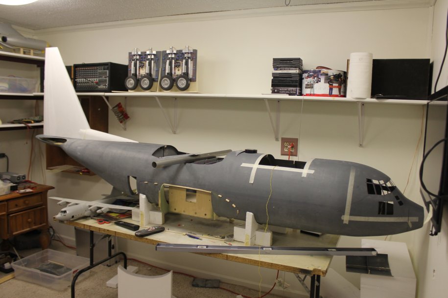

Thanks for the great comments!!!
Here is a update!!!!
