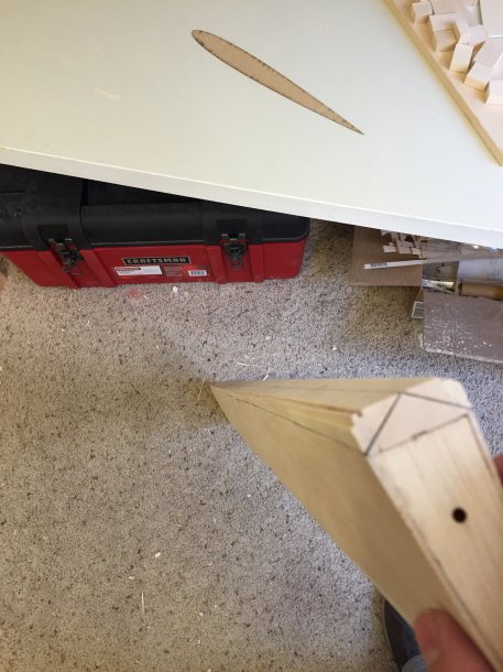

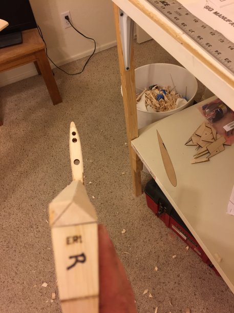

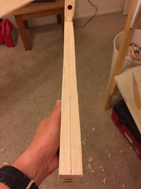

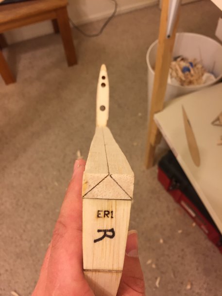

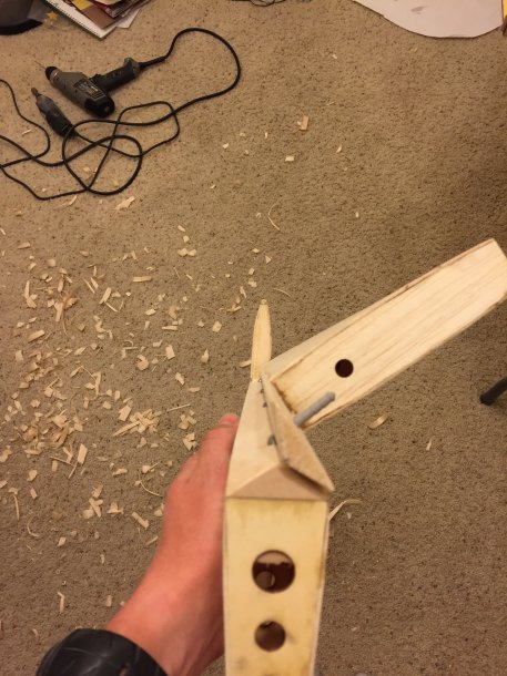

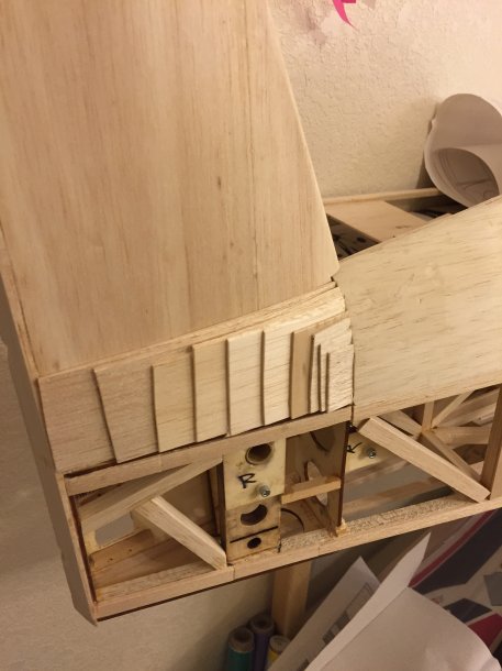

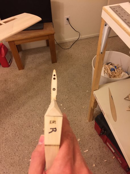

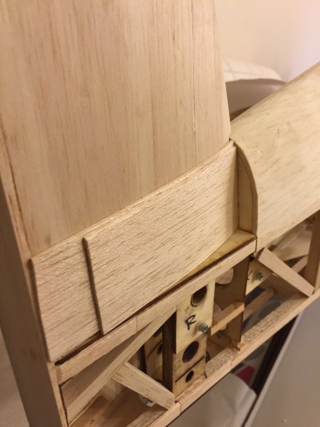

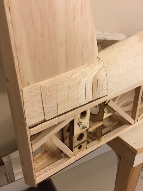

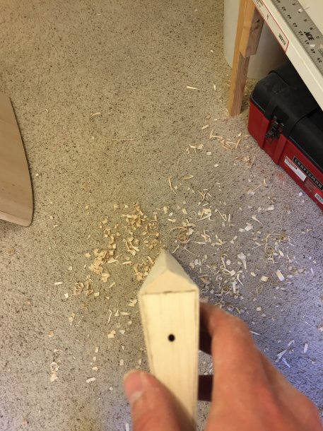

I did the bevels on the tail surfaced last night. The rudder is close to 50 degrees of throw. The elevators have room for considerably more than that. Plenty for the rudder???? Or should I go for a few more degrees for 3D flying?
I took pics of the progression of one of the surfaces.
The last pic is the shavings from my fun last night.

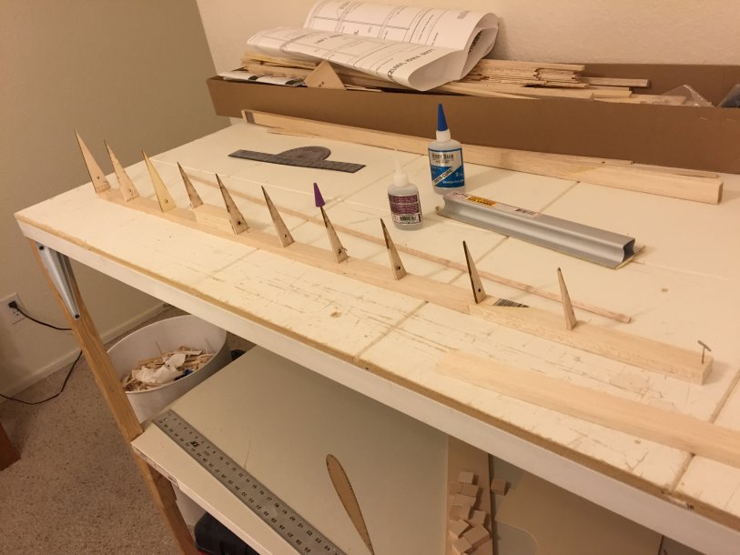

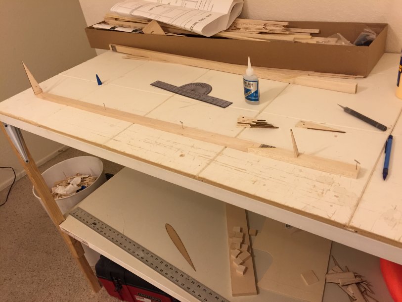

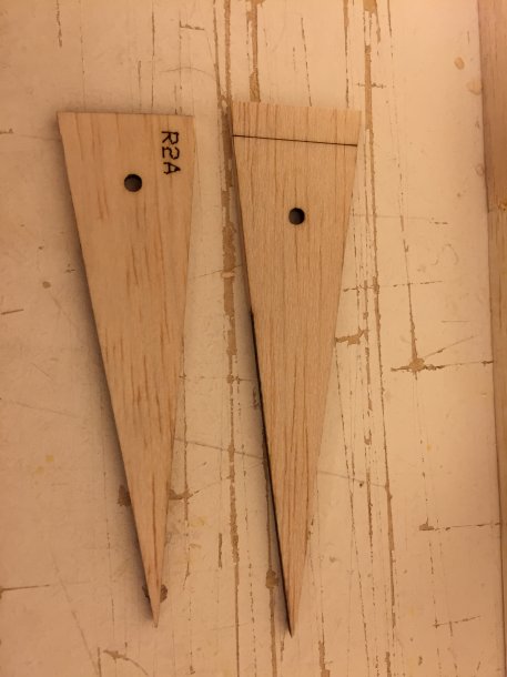

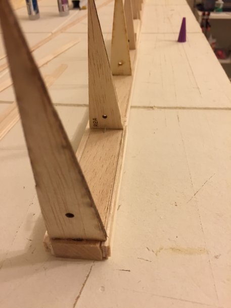

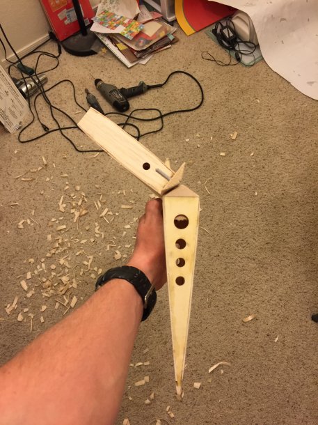

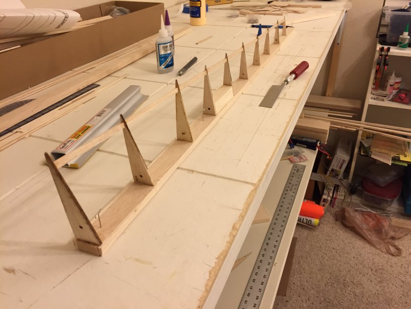

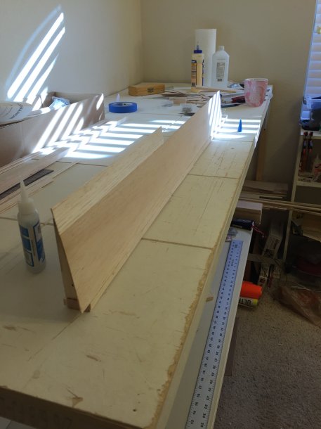

I didn't quite make it to my goal. But I do have one aileron framed up and the sheeting pieces for both ailerons made to start with tomorrow. The piece that will be beveled is not quite wide enough so I glued 1/16" layers to each side to make the correct thickness. The R2 isn't quite long enough so you can see in the first pic that I used some of the spacer area from the identical rib to make it usable.
Progression pics of the aileron.

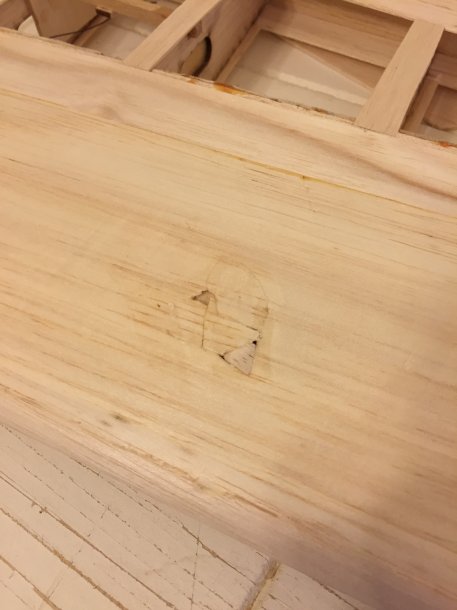

I had a little whoops with the wing... And fixed. I did the bevels for the one complete aileron and wing. Then I took a break from that to work on the tail.

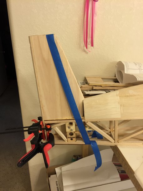

Epoxied the vertical stabilizer on. Instead of shaping a wood block, I used sheeting to make the turtle deck extension. The tail is looking good!!

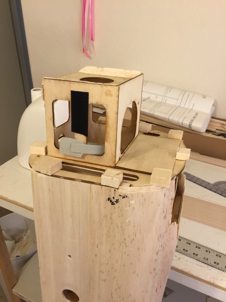

I CA'd some basswood block on the firewall for the screws that will hold the cowl on.

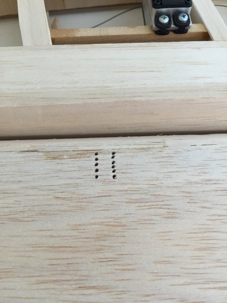

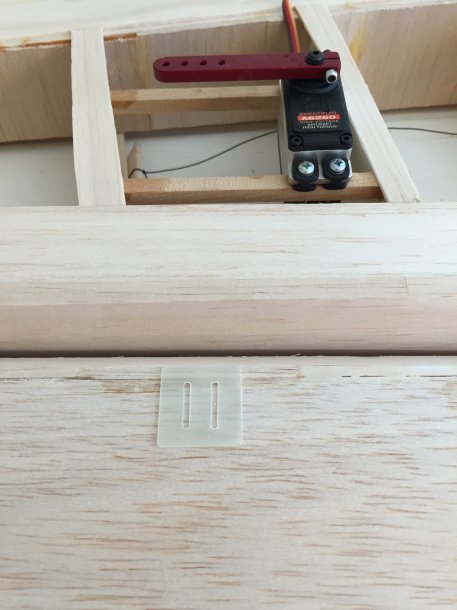

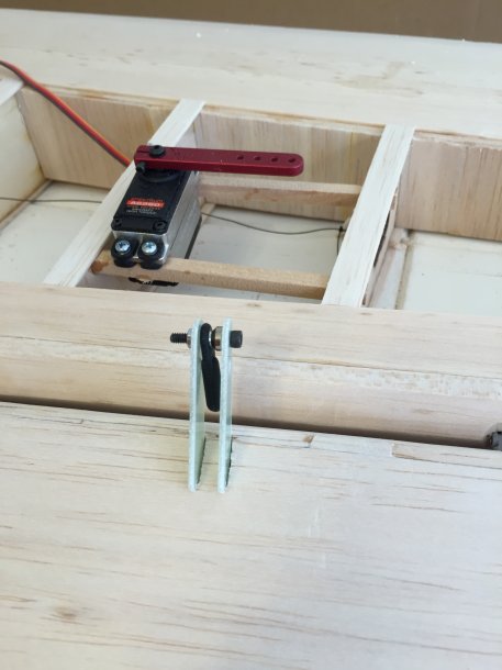

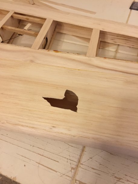

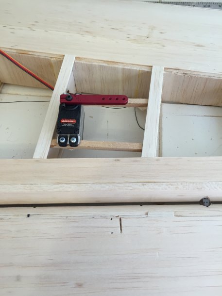

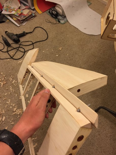

I put the control horn slots into the control surfaces this morning. First I mounted the servos to see where the horns needed to be placed. Then I used the template to drill 1/16" holes at the edges of the slots. Then I drilled as many holes as I could between the others before using a really sharp knife to clean out the rest. It took about 3 hours to do all 5 control surfaces.

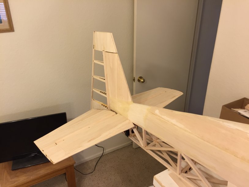

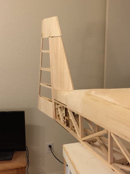

The last pic is the tail completely together for the first time.
But now I am to the final finishing touches before covering!! I just need to go over the whole thing to check for spots that need filler then final sand everything!! I'm excited to have this thing almost complete by the end of the weekend!!
