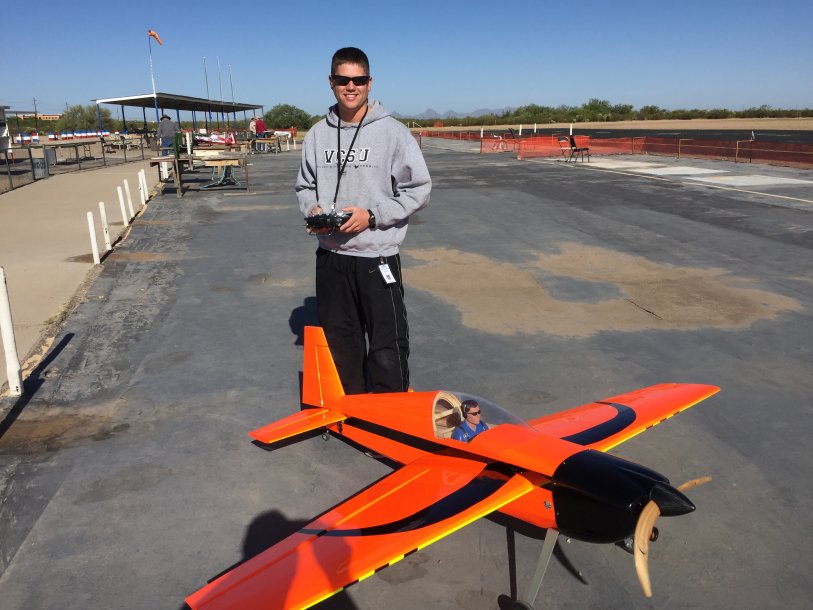

I had some pretty good comments at the field today. "I wouldn't be able to see it cause it's blinding me!" "You are not gonna be able to lose that ever!"

3 flights this morning!!!!! 2 clicks of elevator trim, 2 clicks of aileron trim and about 4 clicks of rudder trim and she was hands off on the 2nd pass after takeoff. She took off at 1/3 throttle and was pretty stable right off the bat. Was very gentle with her the first flight. The landing was a 3 pointer but very controlled and pretty slow.
The CG is slightly tail heavy right now. Chopping the throttle on level inverted flight and the plane stays level. On the 45 degree up line inverted, it is also rock steady with no tendency for the nose to drop. It tracks pretty well. I'm sure I will need to make a few tweaks to get it "IMAC" perfect. Not that I plan on competing anytime soon...
The 2nd and third flights were used to test medium and high rates. The elevator makes a little snap on high rates close to full deflection. But it is also extremely touchy on the elevator. Which is also explained by the tail heaviness.
Overall, I am super stoked on how well she performed! Not overly powerful with the 50 up front but enough to hover and have some pullout ability. She is a keeper!!
