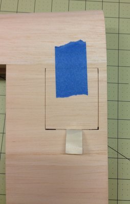

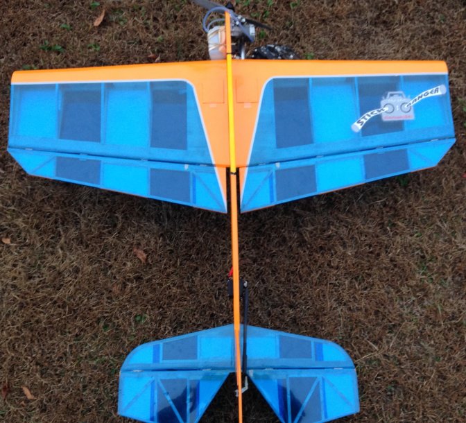

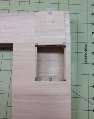

Here is the way I did it in my sbach45. Basically just lay out with a pencil and straightedge where you want you hatch (make sure it wont be over any ribs). Then cut it out with a #11 blade and straight edge. Then sand the edge of the piece you took out to take up for the thickness of covering and put a couple pieces of scrap 1/16" balsa strips under the sheeting to keep it from going to far in. I used a magnet to close the hatch on this one but you could just as easily put a couple small pieces of liteply under the sheeting and just run a couple small screws in to hold it in place. If you want to go that route and don't have any small screws then let me know I can send you a few to do what you need.
Its hard to see in the last pic of it covered but once I had the Hatch installed a put a small strip of covering on the front edge of it to act as a hinge and to help keep it from blowing off in flight. My first slab I put my hatches in the bottom of the wing but that proved to be annoying having to turn the plane upside down to get in it so on this one I just did it like everyone else and put them on the top.
