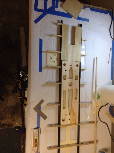

Also my glass tubes don't go the full length is that correct

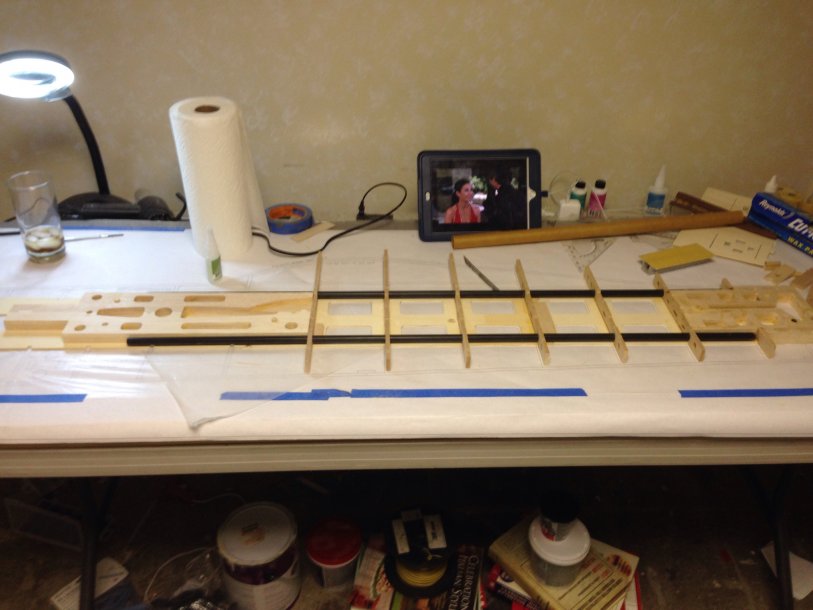

Ok here is how I think it goes. No glue yet. Just moked up. I really need some pictures to look at.
kwj48
I would put any splices up in the motor mount/wing saddle area.
Also did you get any smaller pieces of glass tube to put inside the main tube to make a splice? If so use epoxy to make the splice. Lightly sand inside and out to give the epoxy something to grip to.
When cutting glass tube wrap a piece of masking tape around at the point you want to cut then use a fine tooth saw or dremel disk to cut.

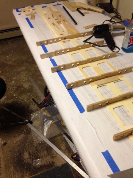

So I tried debonder on the formers. No joy. I called to try to order the parts but they are a month out. And didn't sound to interested in breaking up a kit. I don't blame him. I guess the cnc cutter is busy for awhile.
daman691003
Ok I sucked it up and remembered it's only wood. My fix was to use scrap and splicing on new pieces. You guys think this is ok

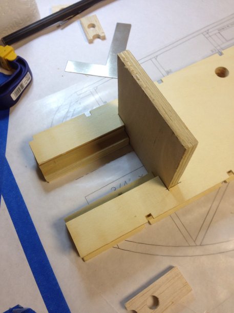

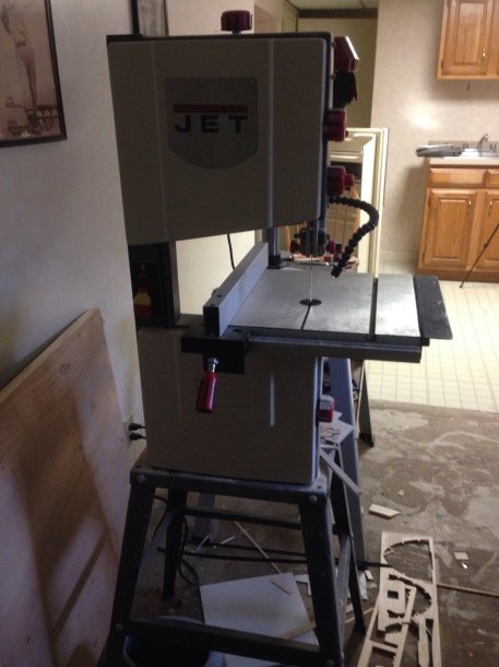

Made some progress today. I'm using dle 30cc so before I glue fg spars I wanted to cut in firewall. Went great with nice tight fit. It's nice having band saw.those arnt over cuts they are pen marks
