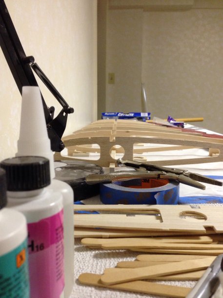

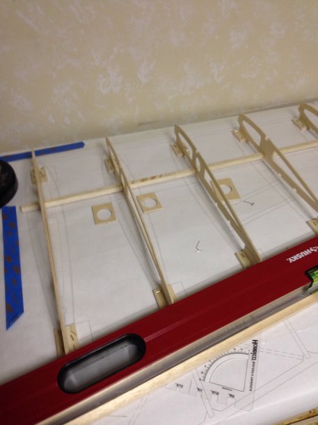

I started the wing. Everything looks nice and straight. I decided to make some doublers for the wing tube. Think they are needed.
daman691003
So my wing tube isn't long enough. And it looks like I'm missing the donut doublers. But I made my own. For the price of this kit it is very disappointing.
