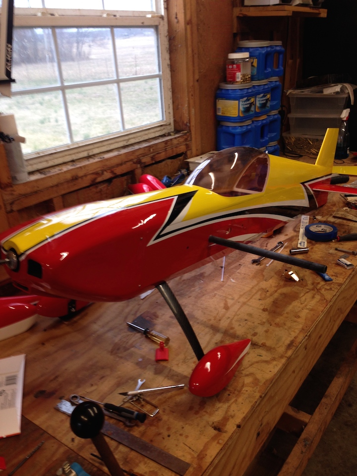

After a nice weekend of flying I got motivated to start some building. I need to finish this one so I can start my 103"
This is my sons Plane.

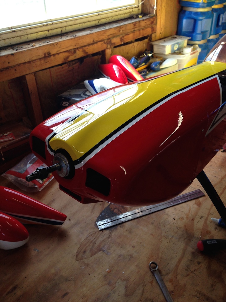

Motor and cowl mounted
Landing gear mounted and wheel pants mod done
elevator and rudder hinged

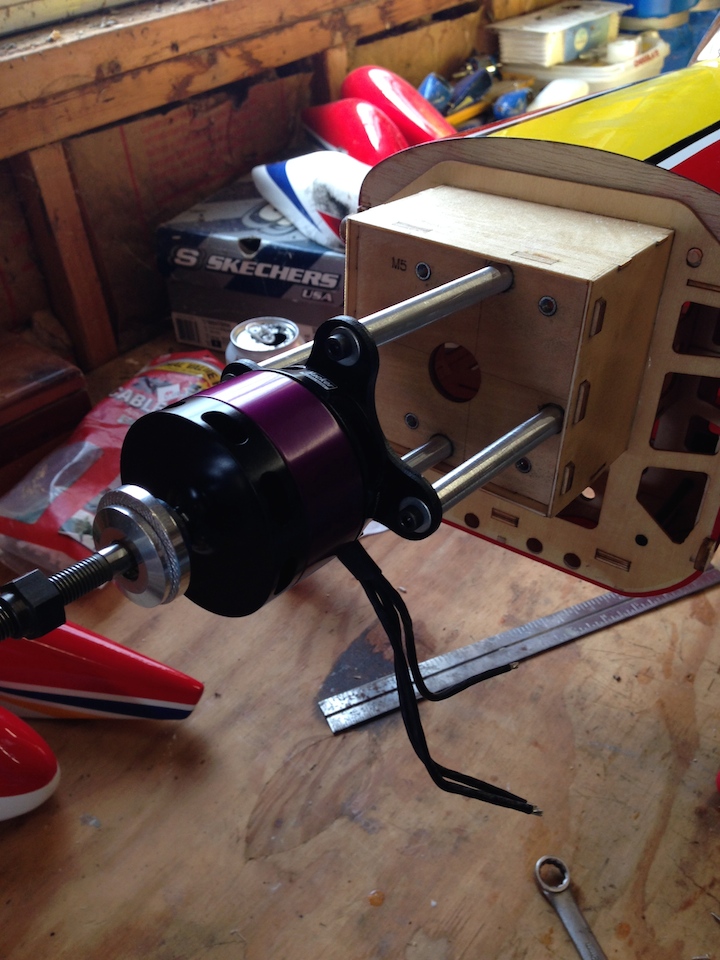

Setup is as follows
Hacker A60-5x on 6s
CC Edge 100
CC bec pro
7985 servos
Setup is as follows
Hacker A60-5x on 6s
CC Edge 100
CC bec pro
7985 servos
might want to rethink that CC edge with the 28 pole motor, they are not playing well together
