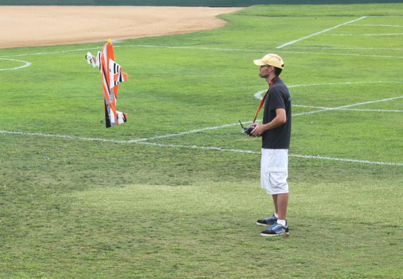

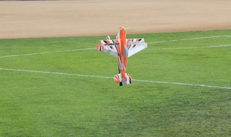

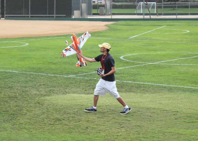

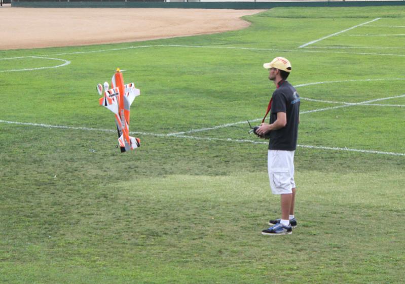

Ok, so.....I'll start off with, it's a shame so much attention (at least in the other forums) has been put on "whether or not my wing is twisted" ;) simple fact is figure out if it's the wing or the stab. (my case was the stab.), take your time on the build, get it right, and go fly this thing. After reading pages of twist, twist, twist, that's all you remember, so I'm glad I built one myself....
.....cuz this little gem ROCKS!!! Great plane to throw around at the park. I actually wound up flying my 3s 1000mah 25C GensAce packs. Way light and floaty, but plenty of momentum for tumbles and spins and the vertical performance was outstanding. Inverted tumbles were definitely a giggle factor. Rock solid in hover, upright harrier took a couple laps to figure out how it liked the aileron and rudder inputs. KE flight is absolutely ridiculous, get it on it's edge and let go :) it doesn't want to pull or push at all, just locked on a rail. On the 1000mah packs I was safely getting 4.5 minutes. So 5-5.5+ shouldn't be a problem with the 1300's.
Basically, don't miss out on one of these, great flying little plane!!
Also had my 6yr. old out for his "maiden" on his new A-10 Warthog AirHogs ;)

Awesome pics Rob, and good comments too! :) Just build it and go fly! :D Great to see your son out there with you...careful, won't be long before he has more skills than his dad ;)
