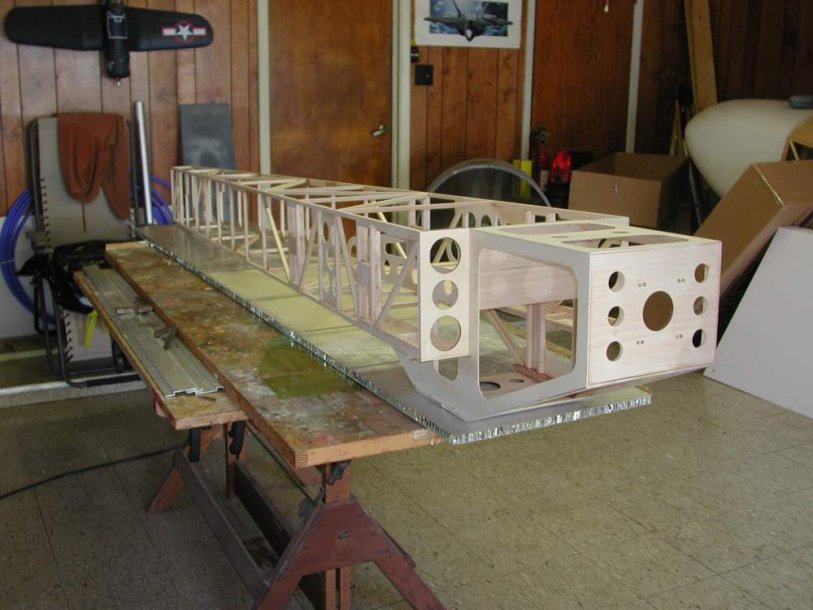

The fuselage weighs 4 pounds 4.1 ounces. It's 95% glued here is a picture of the stress test. I weigh 189 pounds. And yes the fuselage is still in one piece.
Come on man....JUMP!!!!! I have faith. Super cool build. I will be watching.

Joe, What ply are you using on most of the fuse?
90% of it is light ply. Then I have some 1/8 inch burch and 1 piece of 1/4 inch burch ply for the landing gear plate and F1. I know it is heavy in those spots but one of the places I fly has sprinklers that love to take out gear.
Question to you... As a builder I am curious to know the fuselage weight of the 55% extra that is in your avitar picture. Did you happen to weigh it before putting the turtle deck and belly pan on? I am wanting to compare weight of a 3/8 balsa stick build vs ply.

Can't find my weights. But... Bob Sawyer's came in at 4# 4.3oz at this point.
