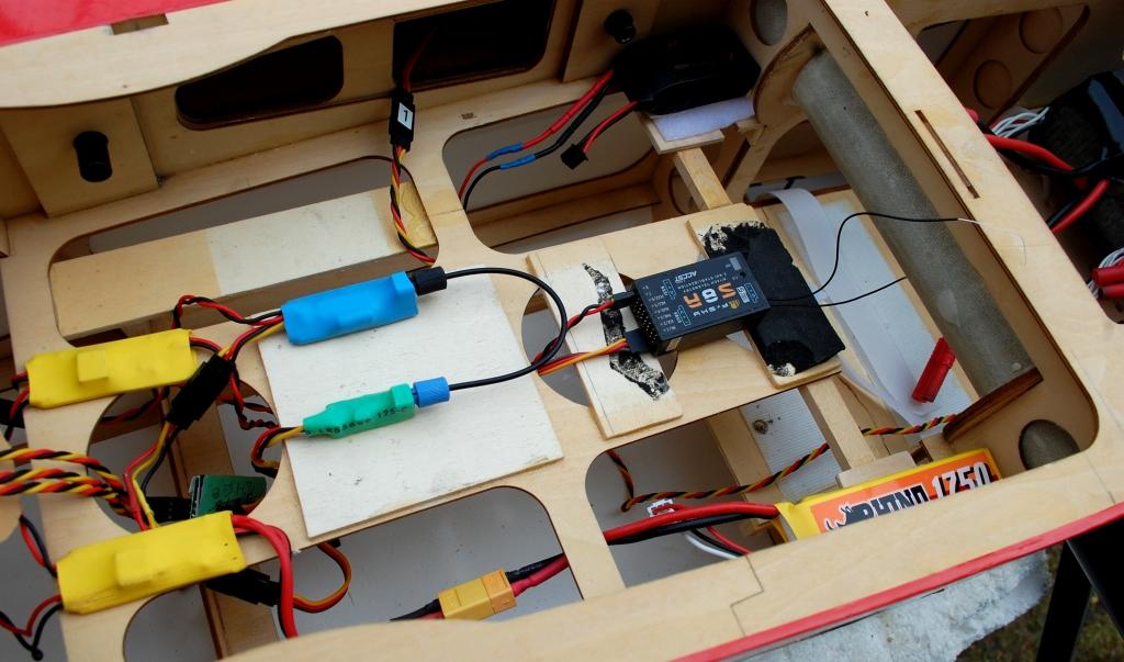

Here is the fiber optic installation in the 33% Edge I'm getting ready. the two yellow units are the two failsafe switches on only one toggle switch. The blue unit is the FO decoder and the green one is the encoder, you can barely see the Sbus decoders below , here i am using only two since this airplane only need 6 channels. you can see the yellow battery for FO decoder, SBuss decoders and servos not quite tidy yet but will be later. With this installation the receiver is totally opto isolated from the rest

So in other words the packets are much like the information packets on a computer and how they are transferred back and forth between programs and LAN based connections? All being sent out with identifiers so they can't go to the inappropriate channel? With each decoder having it's own power source, will this run into weight distribution issues? I know many people, (myself included) who try to keep weight down as much as possible. And power cells...(batteries) are the biggest issue in that department. I have to say, I do like the idea of totally isolating my servo channels from any possibility of interference or rf feedback.

There is no penalty with batteries, , if you normally use one battery as an exemple, then you would also use the same battery for everything except the receiver which only needs maybe a small 500 ma battery

Now I think I finally got my head around it. Really no difference except location of flight pack and sending signal down a single line. That was the strange part for me. Lol
