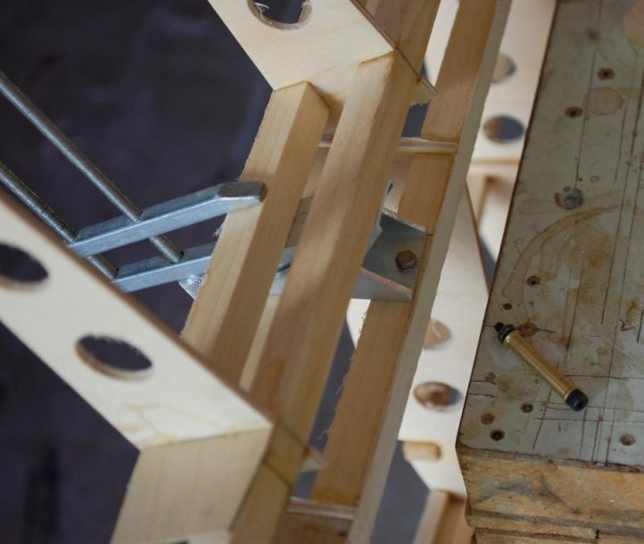

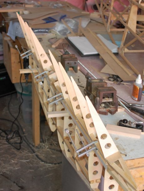

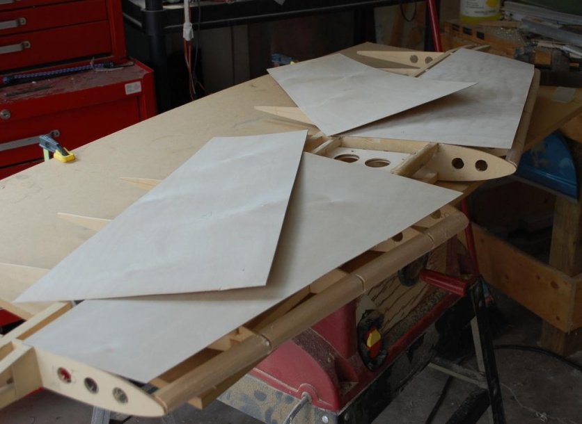

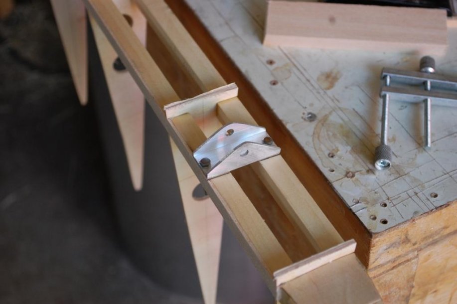

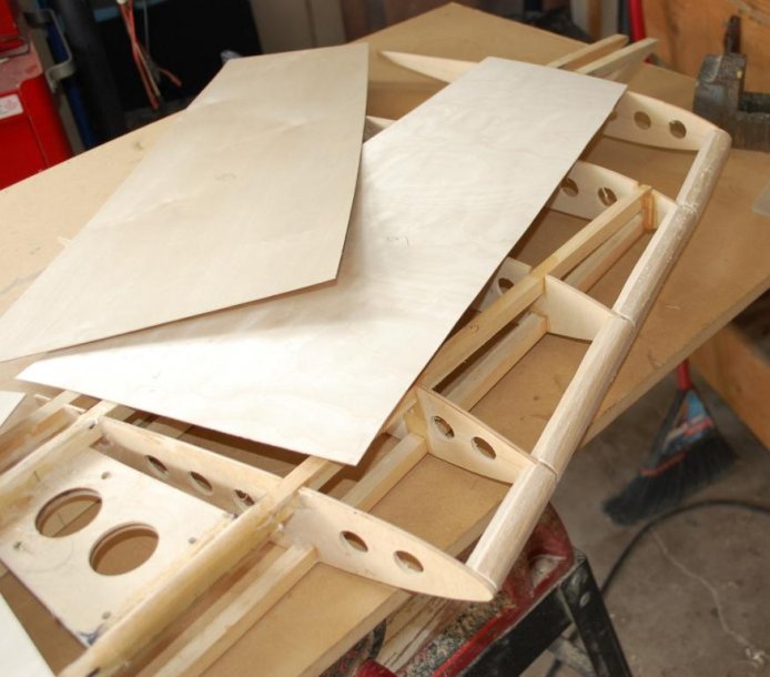

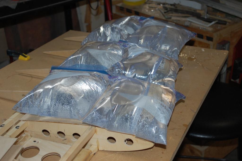

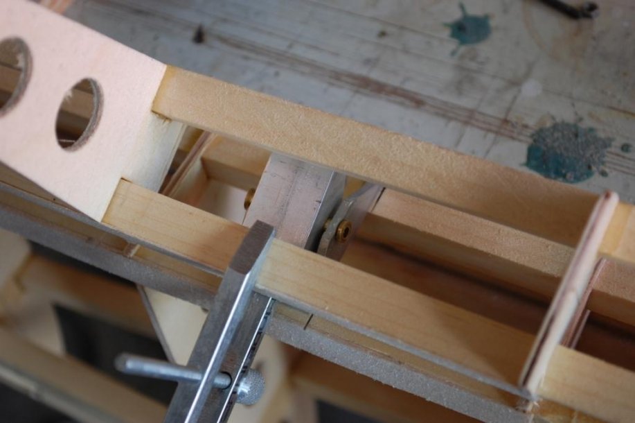

cut the stab/elevator apart, and working on the hinges, , plus stab sheeting is all cut should get this done by Friday, will show a novel way to keep down the sheeting while the glue sets, and no , not the cat litter LOL

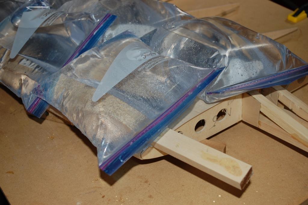

no those are not saline breast implants lol instead of the cat litter I simply filled them with water, one is glued and drying , only 3 more to go
