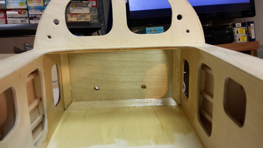

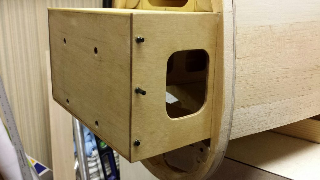

I've been doing a little work here and there. I glued my rudder servo tray in place and drilled and installed some 1/8" carbon fiber rod through the sides of the engine box into the firewall. I also installed some triangle stock on the backside.

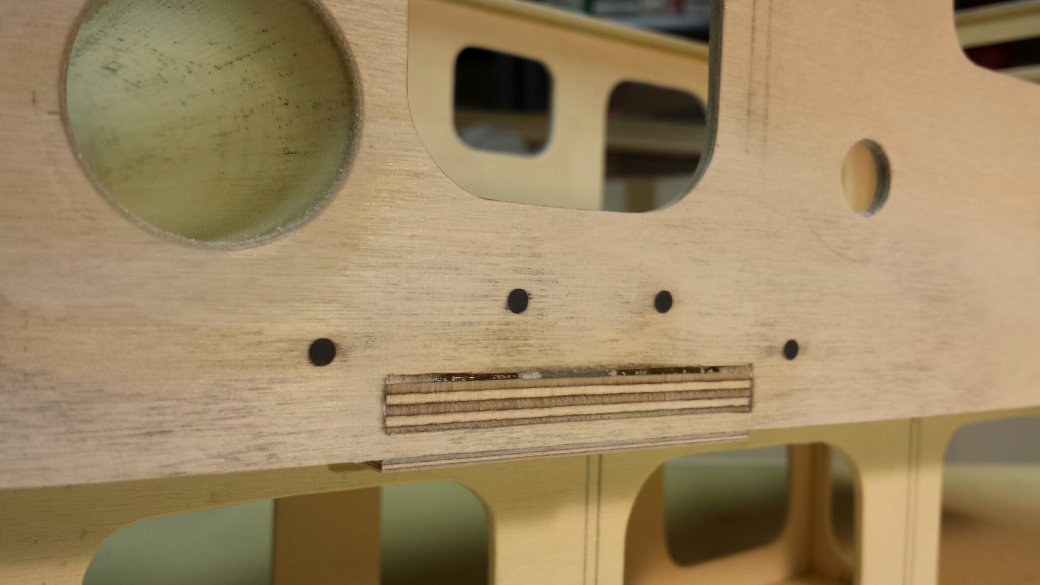

When I used the carbon fiber rod to strengthen the landing gear plate, I didn't like the way it turned the wood black when you sanded them flush, so this time I fuel proofed it first to seal the wood. We'll see how that does when I sand these flush. I'll do a little more fuel proofing later on after I cut a hole in the firewall for the carb.

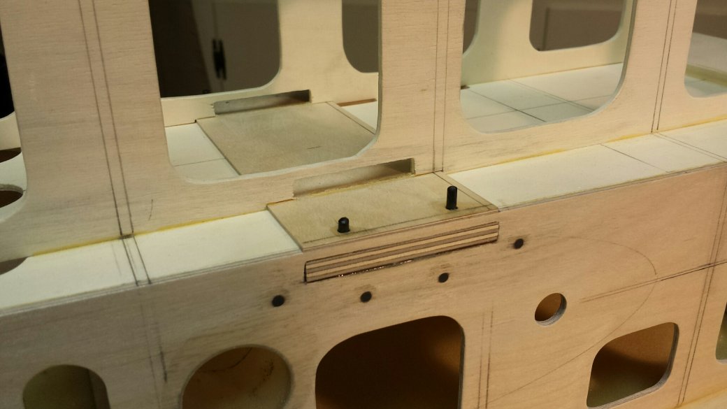

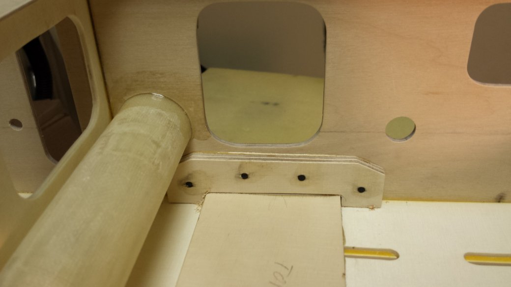

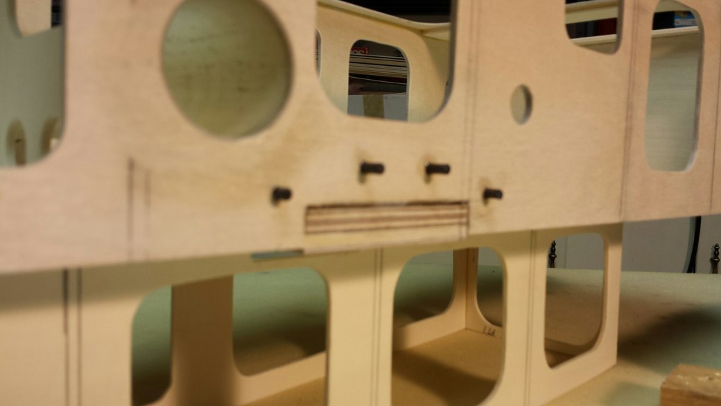

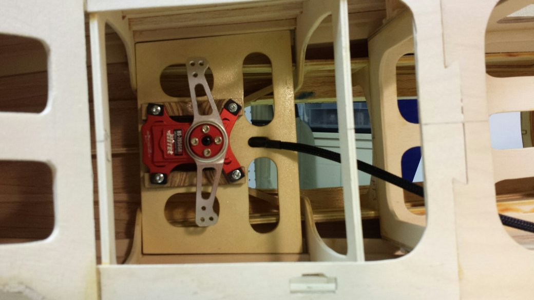

@Jetpainter,
Would you please post pics of the LG mounting plate mods you performed? That or an informative description.
I just went back through the thread and I didn't see the landing gear work so I went through my phone and found these.
I used the 1/8" carbon fiber rod to secure the plate to the reinforcements and the reinforcements to the sides. I still plan on adding a piece of triangle stock on the inside.
