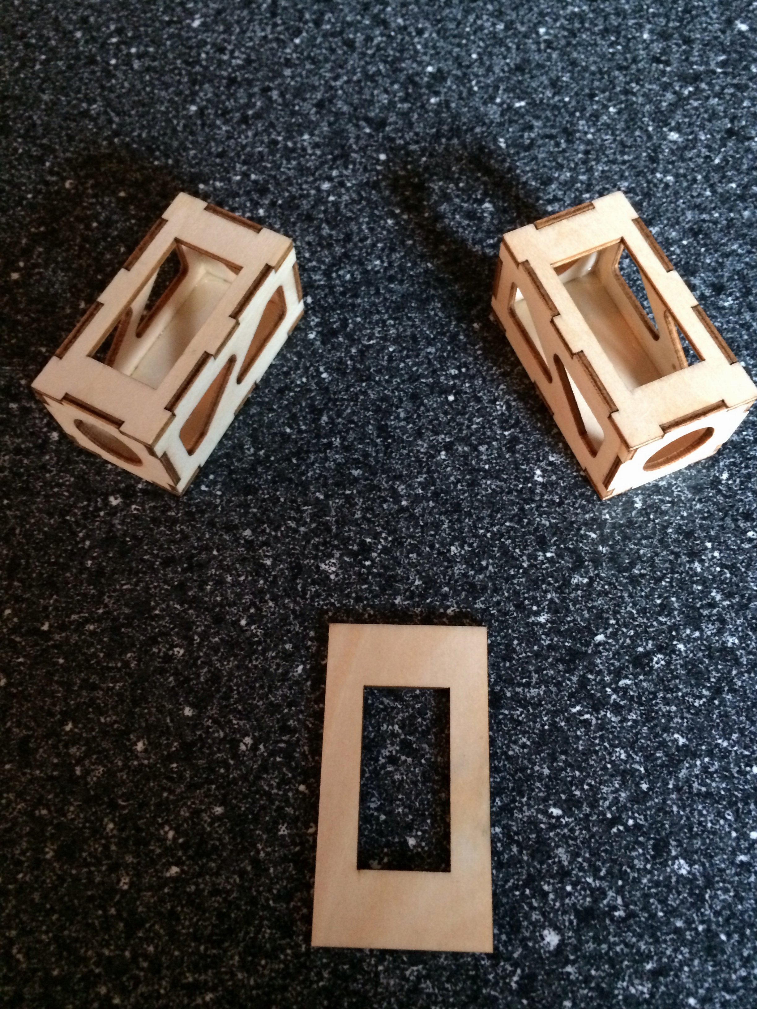

This mite be yet another easy answer but are these three servo mounts suppose too be the same size in the kit. I would think one of these balsa boxes would be bigger for standard size servos but these are all micro size. Thanks

There should have been one standard size included in your kit.
Might have to try and reach 3dhs if you need the standard, or just cut out one that you have with an xacto
I looked at just making the hole bigger but it's not deep enough.i will just make one if I need it its not that big of a deal . I will prob mount the throttle servo in the tunnel with carb pointing down on the twin after talking to one other person that did the same engine. After looking at the tunnel I can just cut a servo hole in the side and beef up from the back side but all this being said with out seeing the twin yet as it didn't get to me yet .it was shipped Friday and tracking says Monday delivery ,that seems like a long time to me but it is what it is.what do you think about mounting the throttle servo in the tunnel?
Most of the 3DHS 30cc kits come with mini servo boxes. I have managed to hog them out in the past to get them to work.
Jtec sells a wooden servo box if you need one.

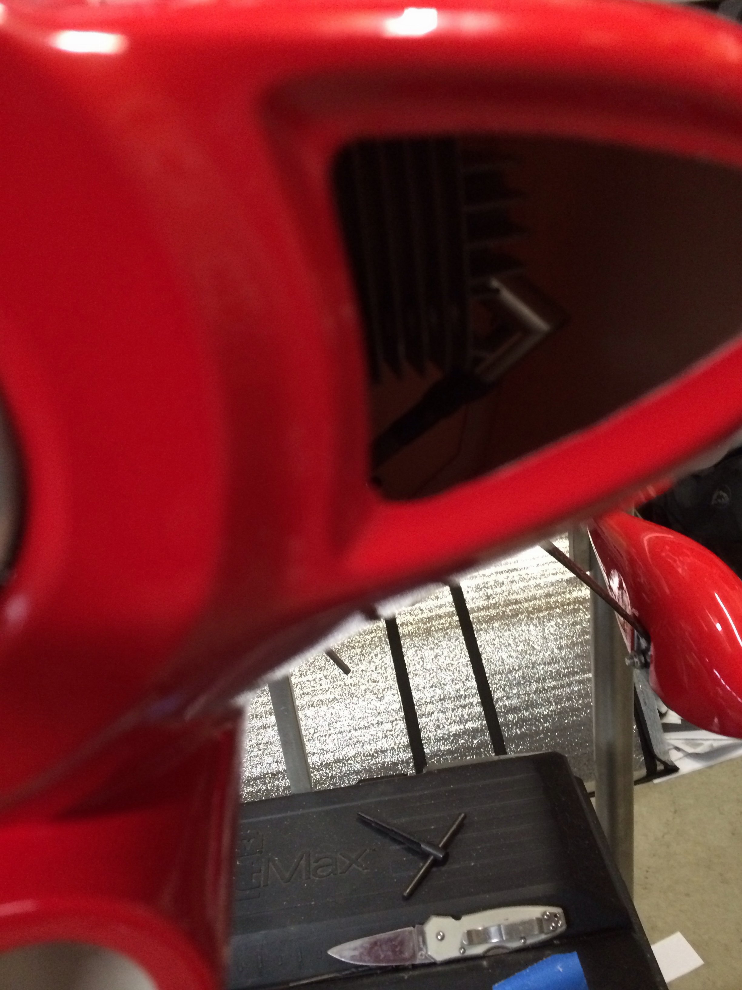

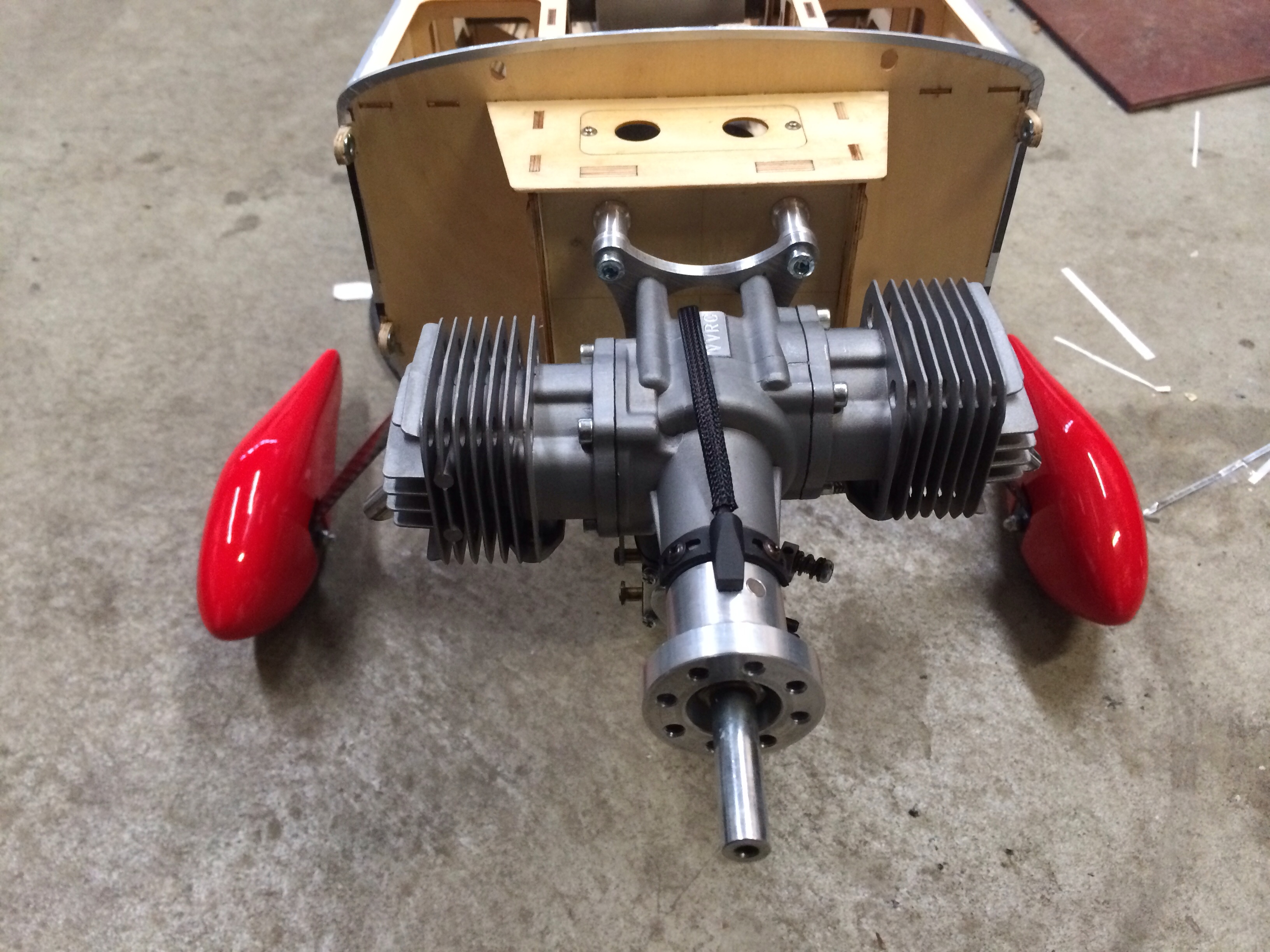

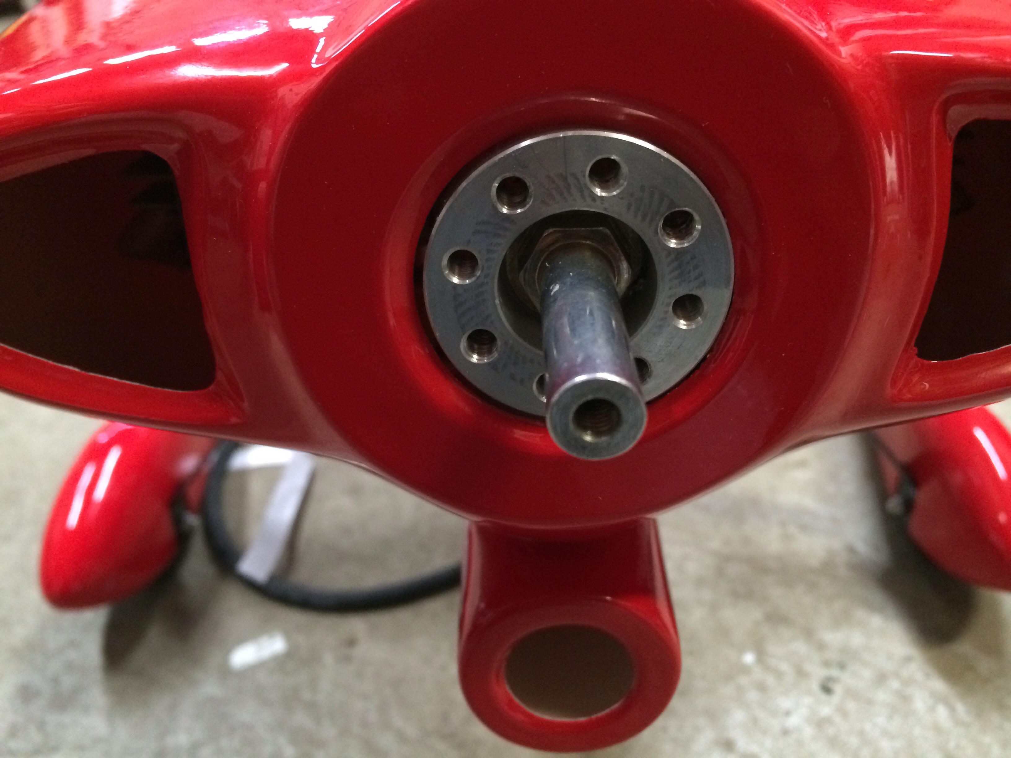

image.jpgimage.jpgimage.jpgSo far so good guys. The motor fits like it was made for it. The only thing i mite have to do is open up the cowl were the prop shaft goes threw as it is hitting the left side. The only problem i see with the engine is one of the cylinders are bolted on the crank case a bit off and makes the exhaust crooked to the other one and might have to unbolt the cylinder and tighten straight ,other then that the engine looks great.
I just bolted up my 40cc twin last night but I had to add 3 washers to get the correct spinner gap. No I need to figure out were I'm going to bolt the throttle servo. I ordered some JTec servo boxes. Debating on cutting a hole in the bottom of the motorbox and mounting the throttle servo on the bottom of the motorbox.
