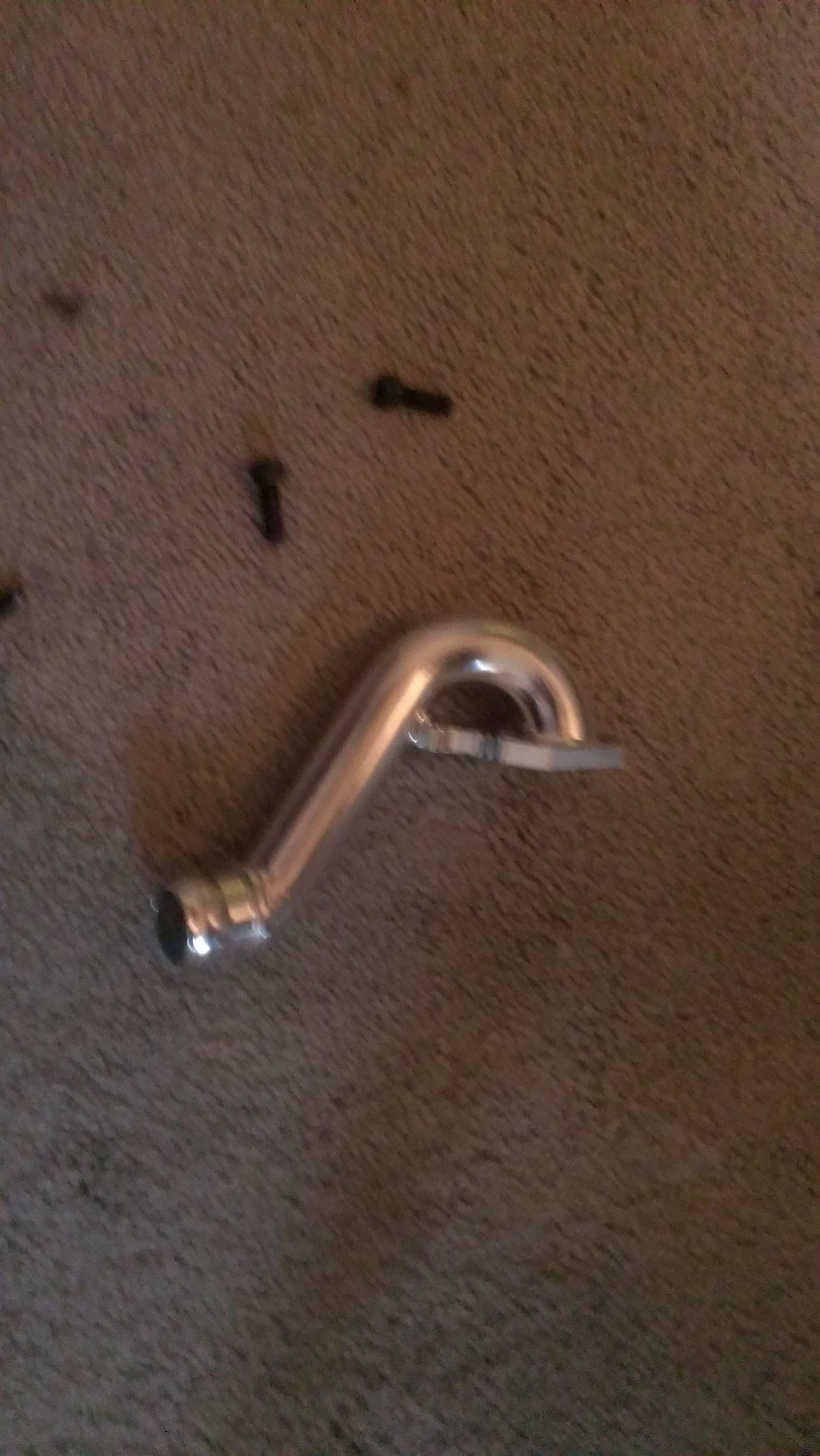

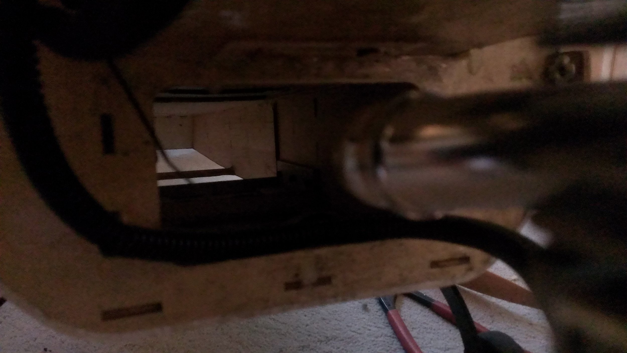

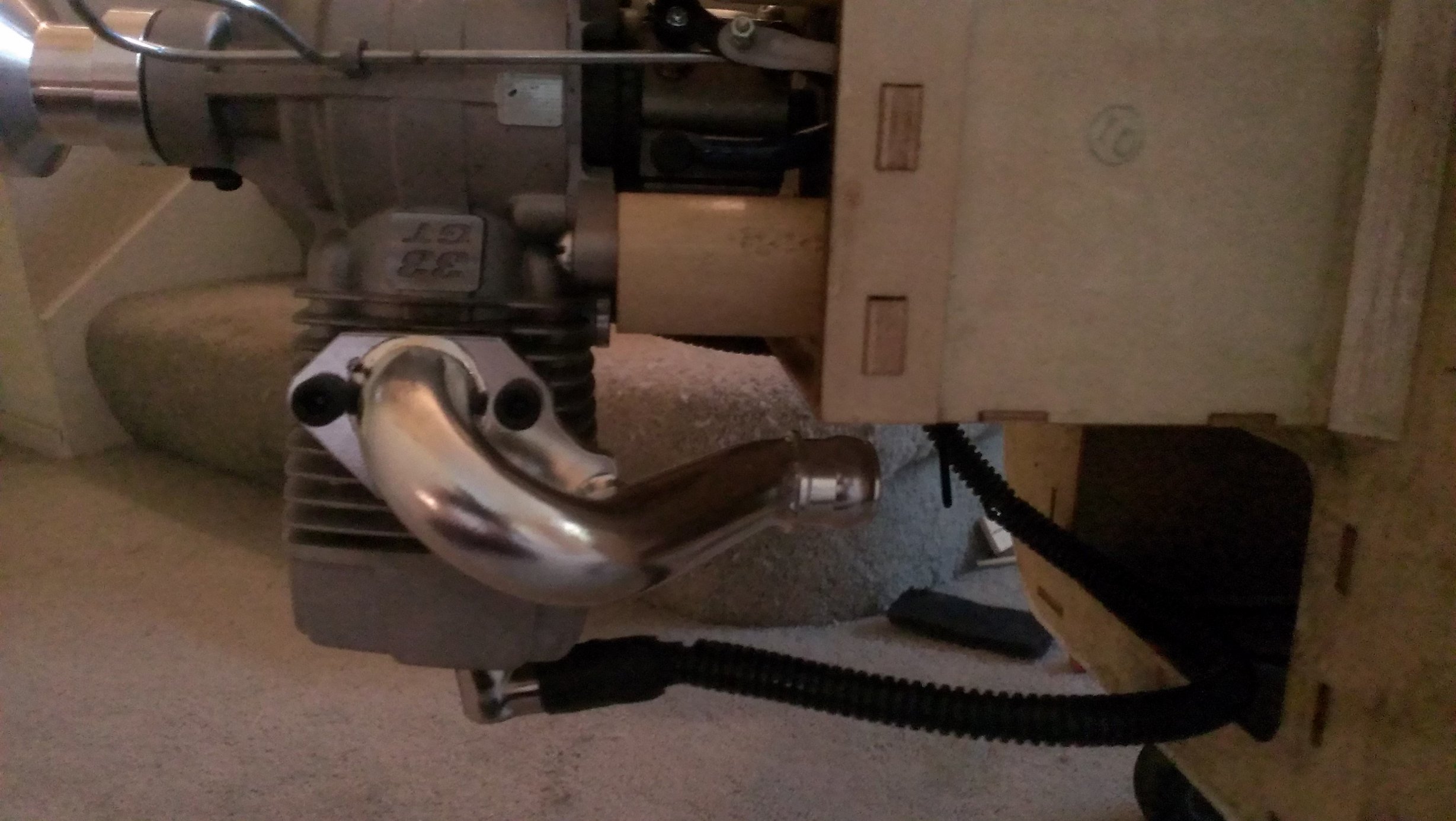

I received the Hatori header today and it will work great! The drop is perfect(25mm), it comes with the right size bolts needed too. Just need some spring clamps and it will be all ready to setup. The header feels super solid. Very nice quality and it drops right in.
Sorry for the poor quality pics but it lines up nicely! I need about 7'' in between the header and pipe, should i make an aluminum extension or would it be OK to use the teflon tube and just cut it to the length i need?
How much was the header?
