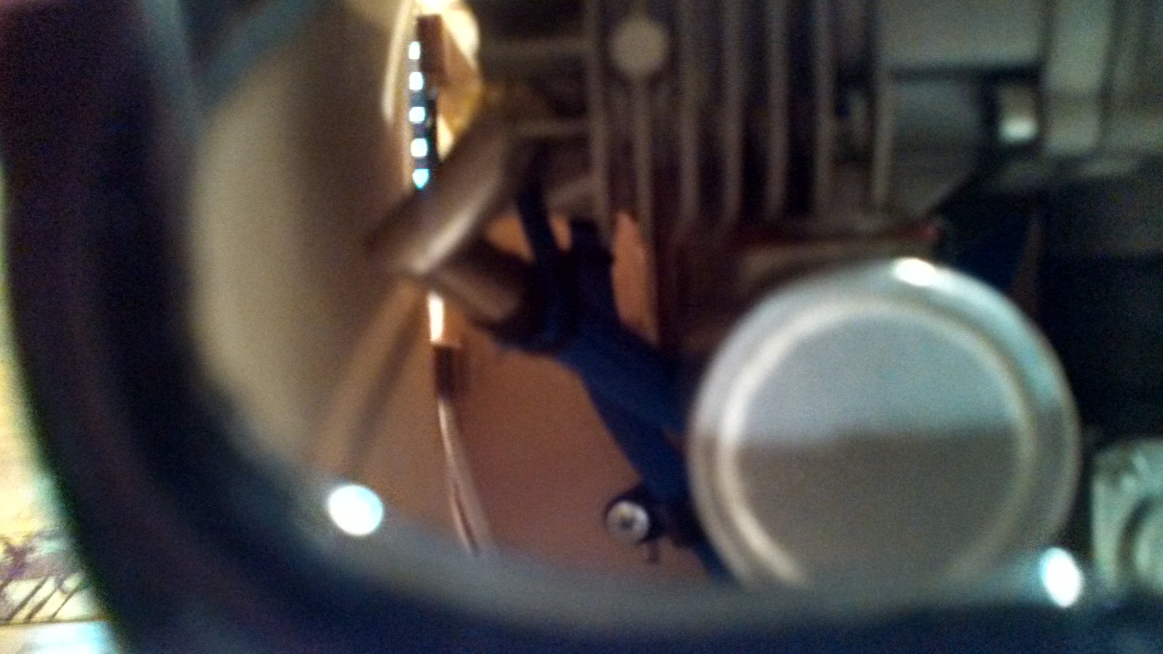

Kevin
I see you have the 40cc with the small plugs. How much clearance is there b/t the cowl and the plug boot? Do you think the 40cc with the CM6 angled plugs will fit?
RKEstes
Maybe 1/4" on each side. I doubt it would fit without cutting the cowl.
