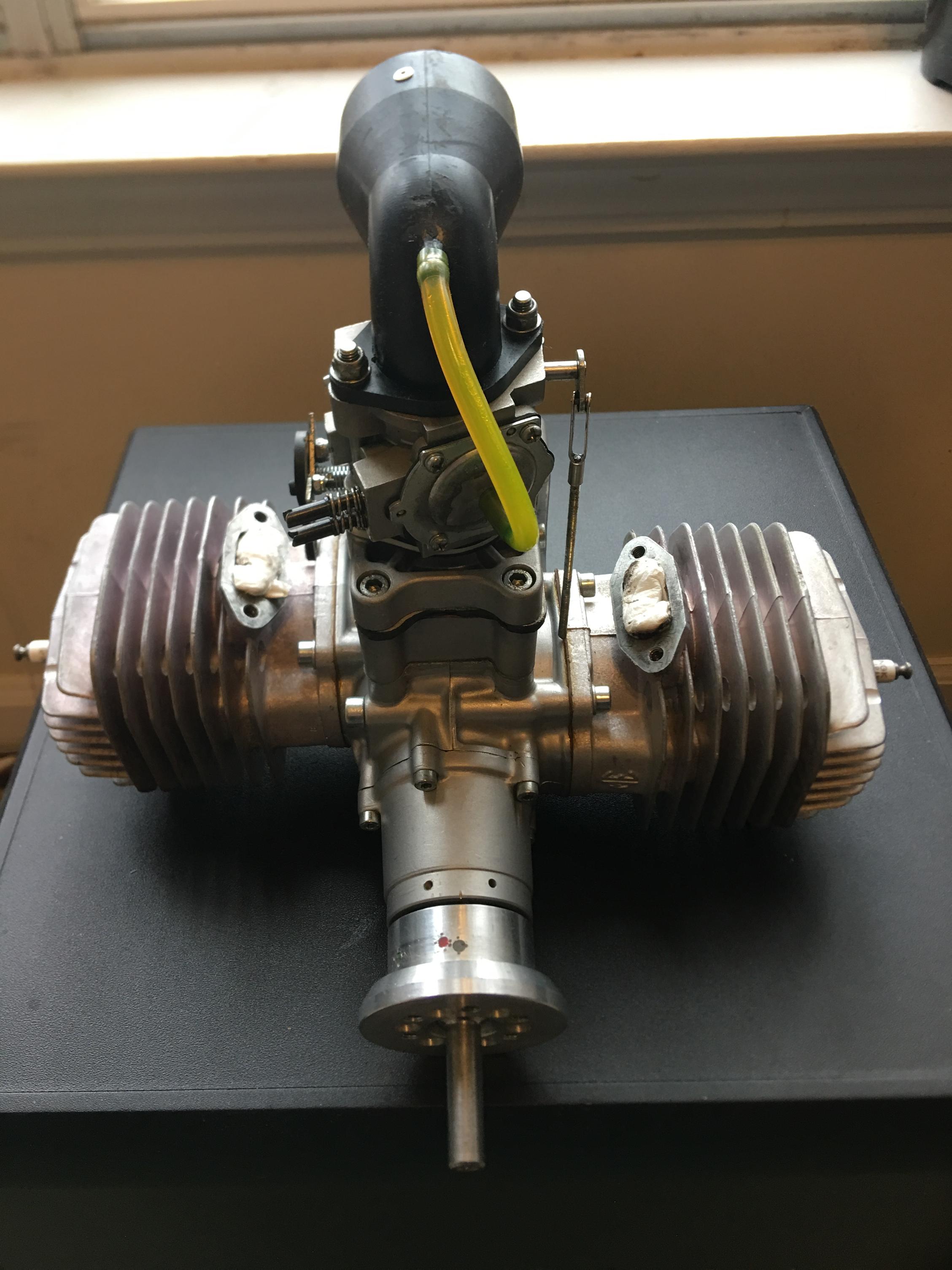

Ok, I guess a little background would be helpful. The engine was sent to Gerhard in August, the ignition was upgraded, a new magnet installed, and the carb was rebuilt. It also has the (I believe) new style aluminum reed block, see pic. I spoke with Gerhard and he said in August, when it left his hands, it was in perfect order. I looked in the openings and there did not appear to be anything out of the ordinary. With the plug in it was nearly impossible to turn it over by hand.
Any chance you have a side view photo of the carb and Reed block?
