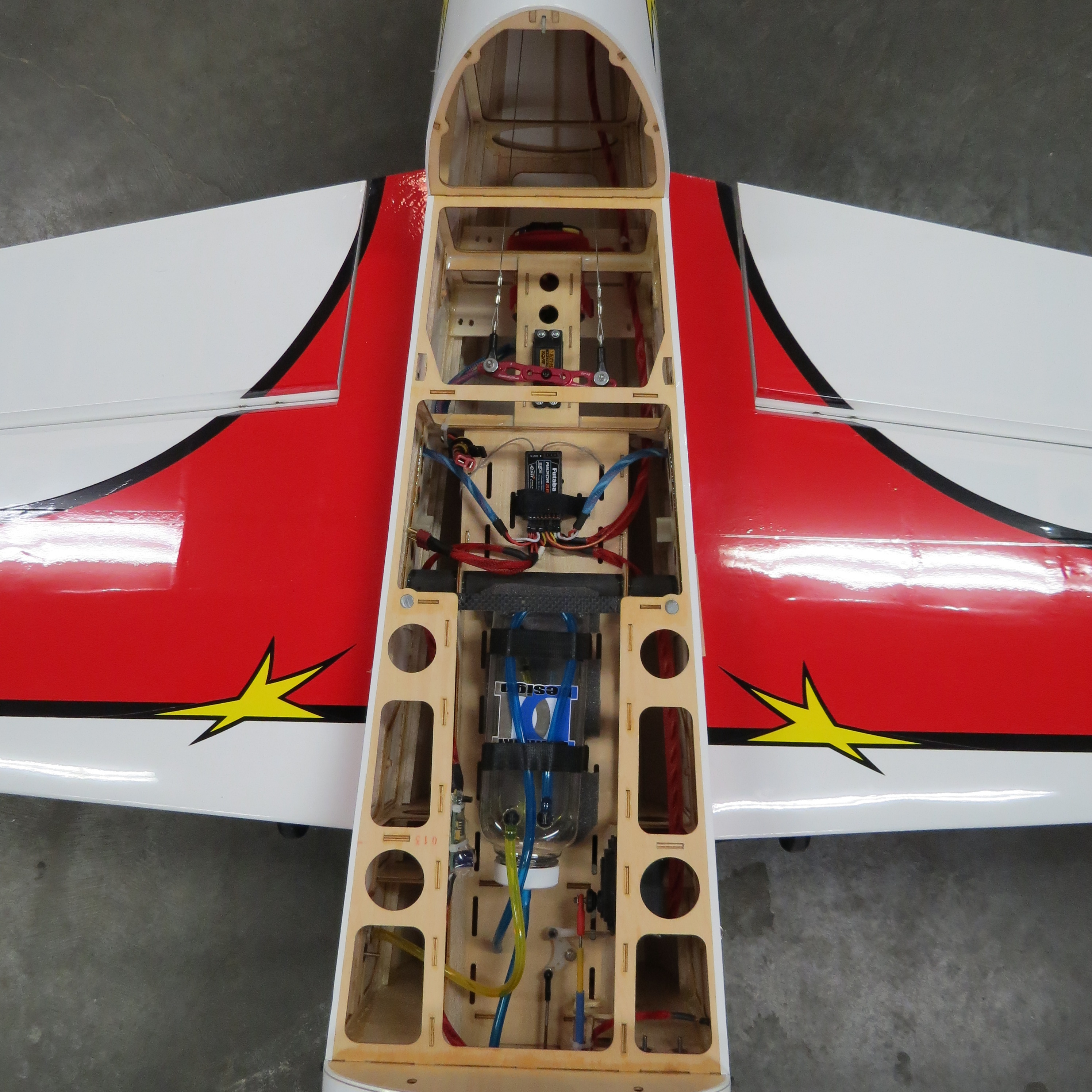

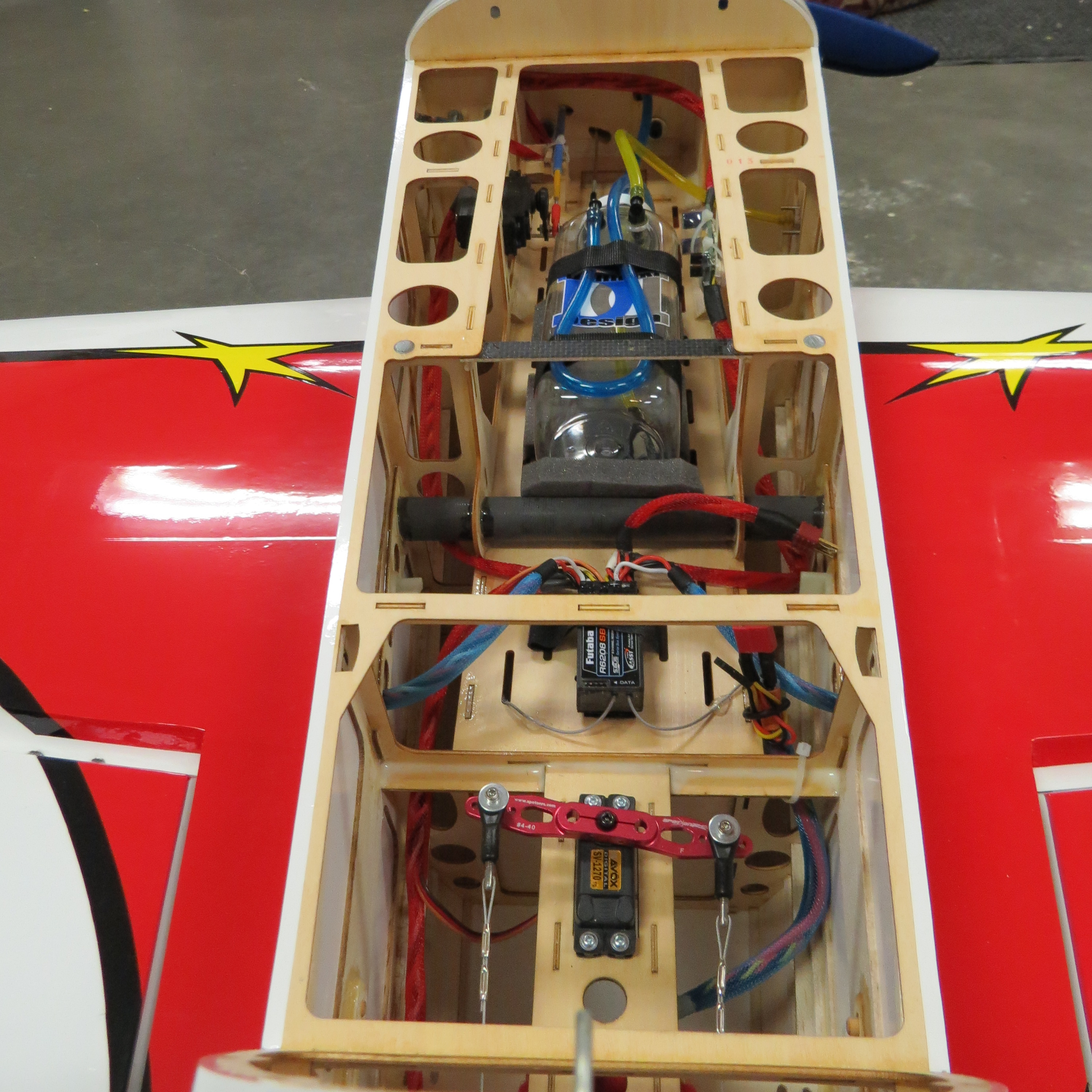

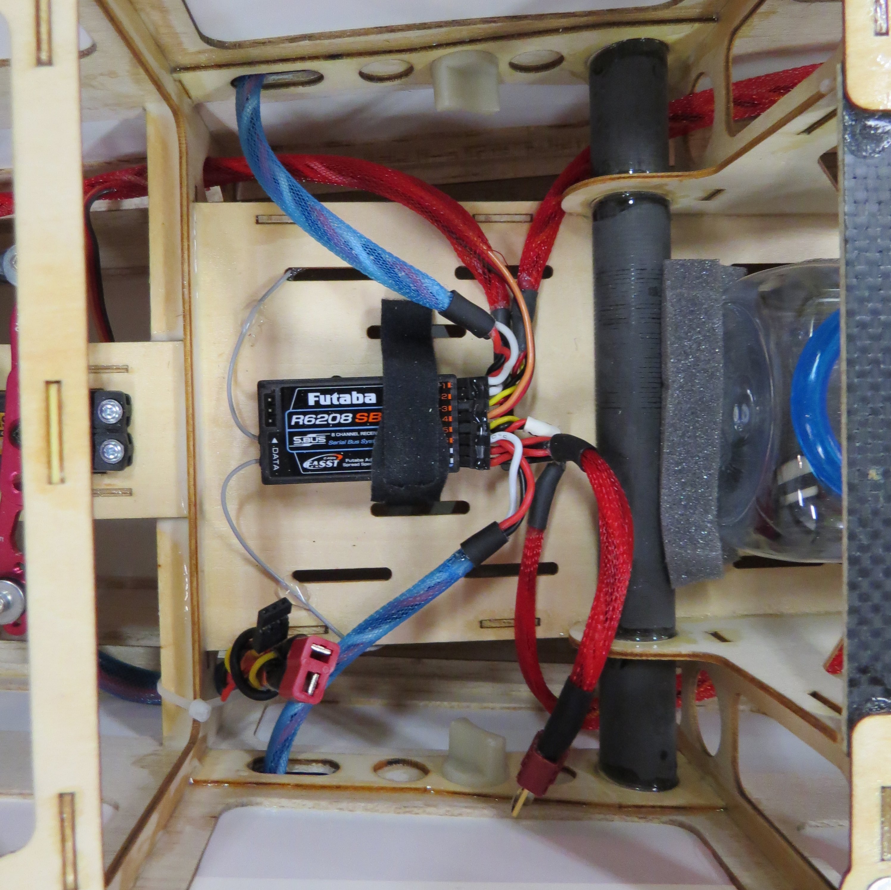

Futaba R6208SB, brand spankin new. Curious if the Tech Aero was emitting feed back causing the brief interruption.
I soldered two leads (Y-Harness with two Rx plugs and on Deans batt plug) to from the battery deans connector to the receiver to share the load, so I don't think it had a bad battery connection. Just sport scale flying, so I don't think electronic overheating would be an issue either.
I could not have added enough foam insulation around the RX or IBEC either... maybe? dunno
Took me a while to gain the confidence to fly it again, then this happened again. I'm going to buy another receiver and send this one in anyways.... but I hate not knowing!!!
Still thinking an intermittent failure on the receiver. So new receiver for sure. Maybe a ferrite ring around the tech aero? Or a new tech aero. Engine was running great even during the lock out, so I doubt it's a battery issue since the tech aero runs off the rx.
There is a thread on FG about Futaba receivers overheating. I no longer wrap my receivers in foam to avoid this issue.

My guess is it was an electrical issue. When running an IBEC you throw a lot of current through the receiver switch. All I use is the Tech Aero IBEC and never had an issue. I use Futaba heavy duty switches and have not had a problem yet. Most my planes however now have the Booma rc dual hidden fail safe switch with dual batteries.

Thanks, I'm not really sure what to think of all of this. I'm also using the TechAero IBEC, I'm not using a switch just a deans connector, one single 2500mAh A123 with two HD rx input servo wires Y'd off to a single deans for the battery connection. I am going to assume this is an intermittent Rx failure/glitch since I have sent the Tx & Rx in and returned with no issues found. . . however the same P/N Rx in a different plane on HS mode has always worked flawless. I have been flying different models without a hiccup. I wish I had a plane that I didn't care about I could use in HS mode with the possible faulty Rx to somehow confirm this intermittent failure. All this makes me interested in getting a Jeti system... redundancy is ridiculous in that thing...

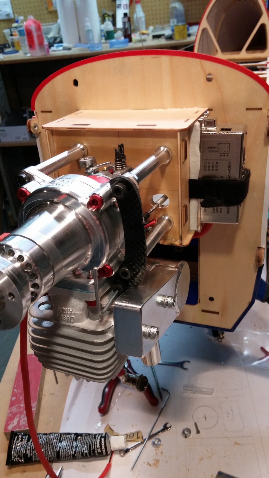

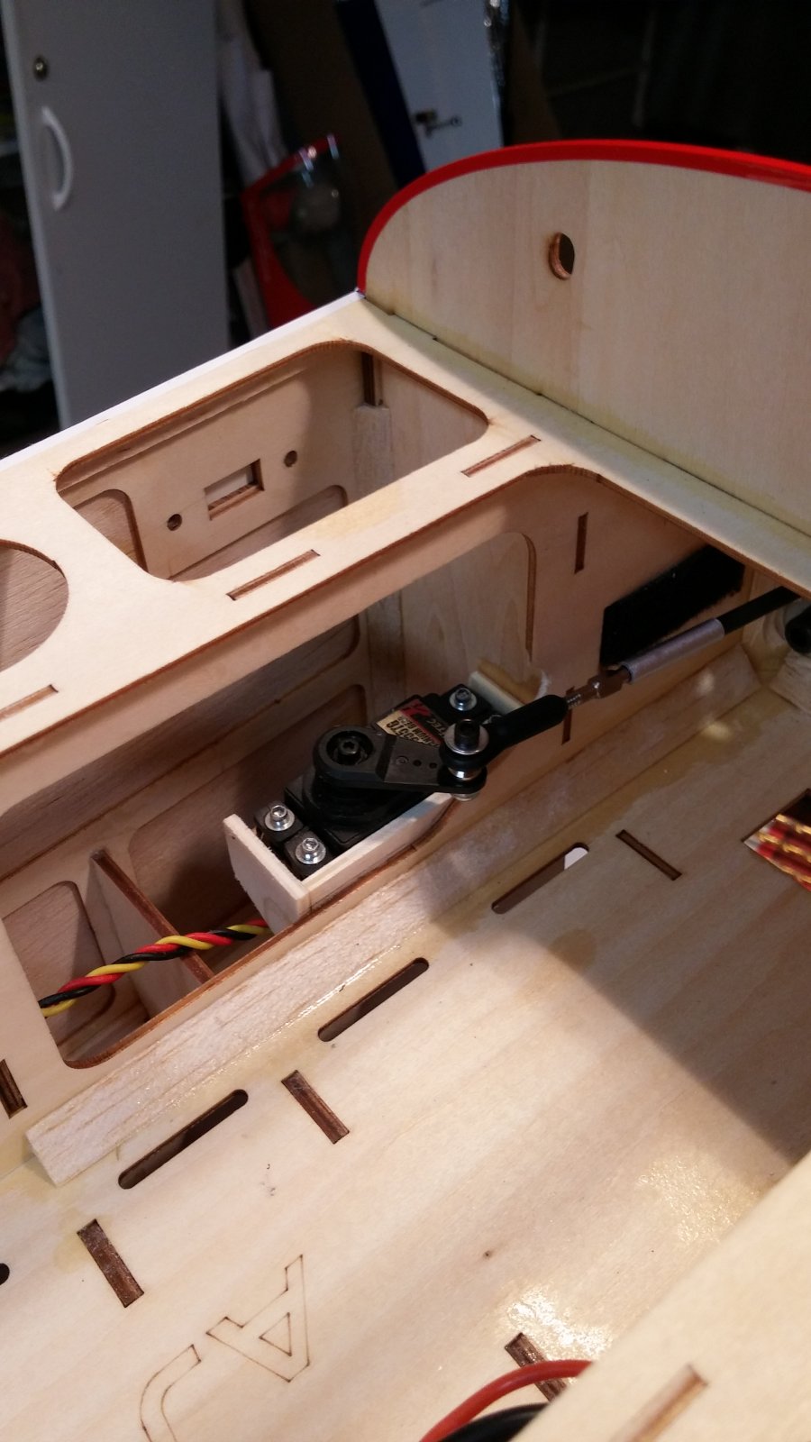

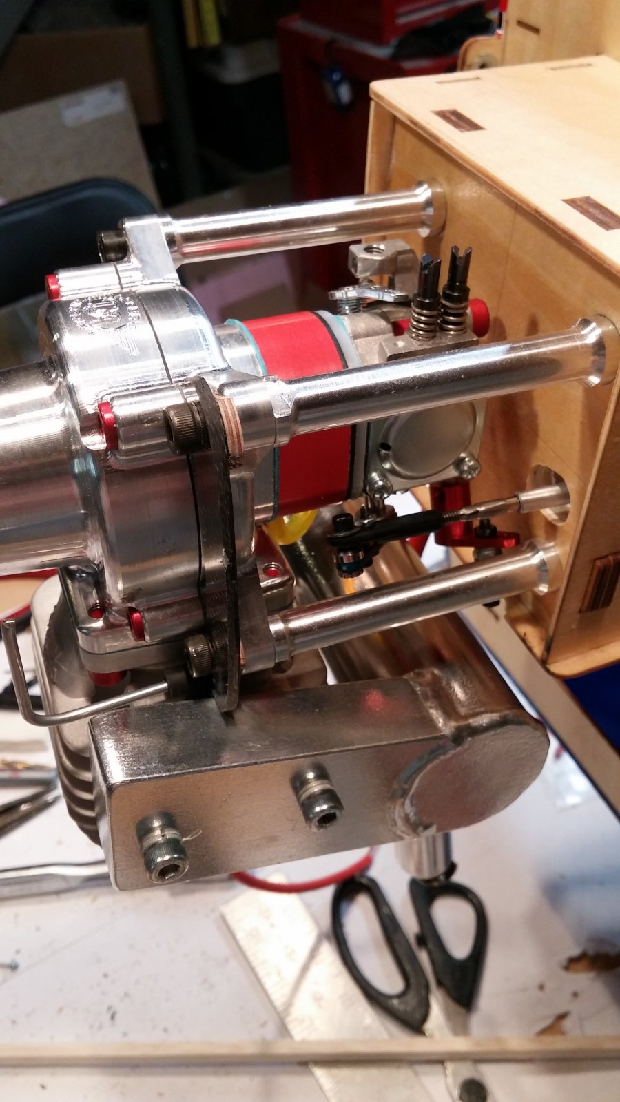

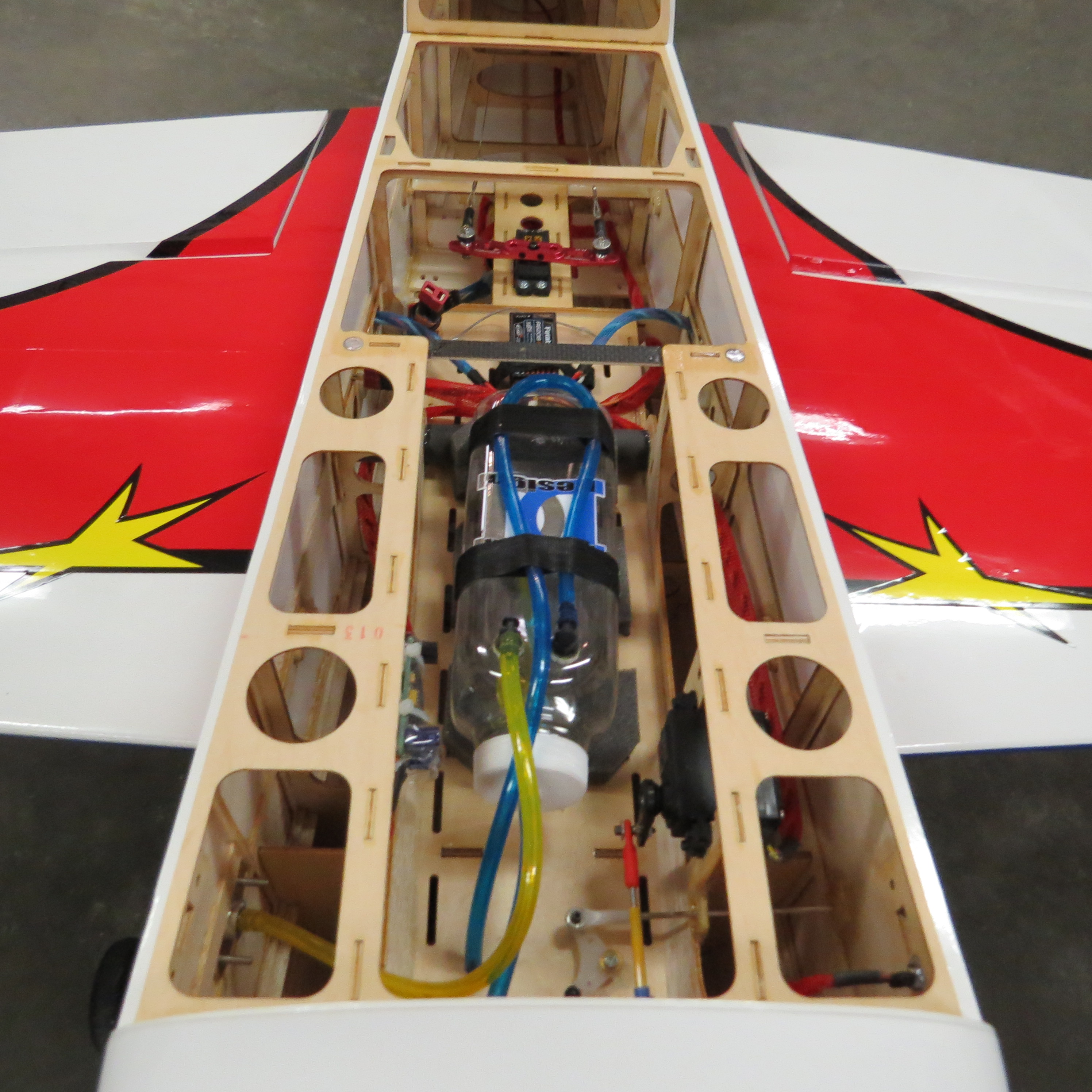

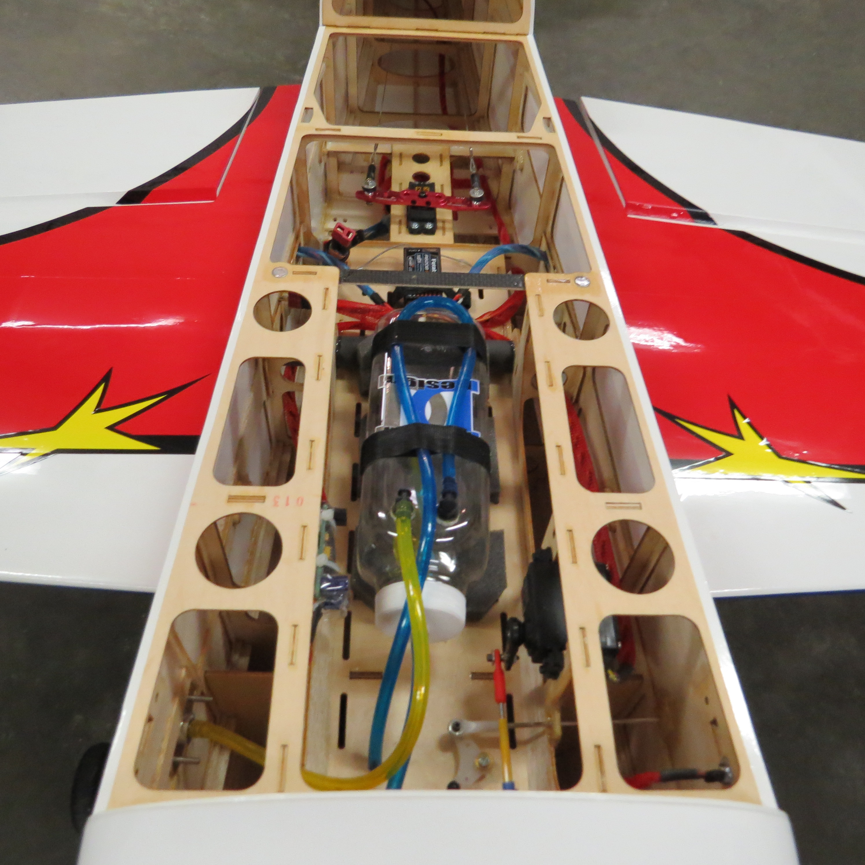

mikeh
Thanks to all you guys putting this thread together, it was a great resource. I was less than impressed with the carb setup on the DA. But got through it and I should have good resolution on the throttle. I extended the throttle arm and had to give some height to the choke arm. It got tight in there. Hopefully on the fourth I can get the maiden done.
