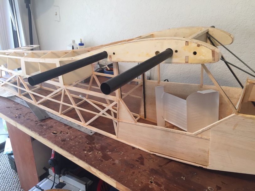

A lot going on with the cub in the coming days. I have IMAC stuff starting up, so some of my weekends will be consumed with flying rather than building... oh darn! haha! But I received my wing tubes and sleeves from Jtec this past week. I didn't realize the sleeves were going to be carbon fiber as well, so that was an added bonus, and will look nice and tidy through the windows. The wing tubes will be, really the only thing not scale on the plane, but I'm building this to fly, and fly out in the country at ranches, not to sit on display... so everything I do is with this in mind.
That brings up an off instruction step I'm going to take this week. I'm going to add some dowel pins to the firewall, as well as maybe to the doors. I'm also going to put a little bit of fiberglass in at some strategic joints, just for my state of mind. And of course! Start on the wings!!

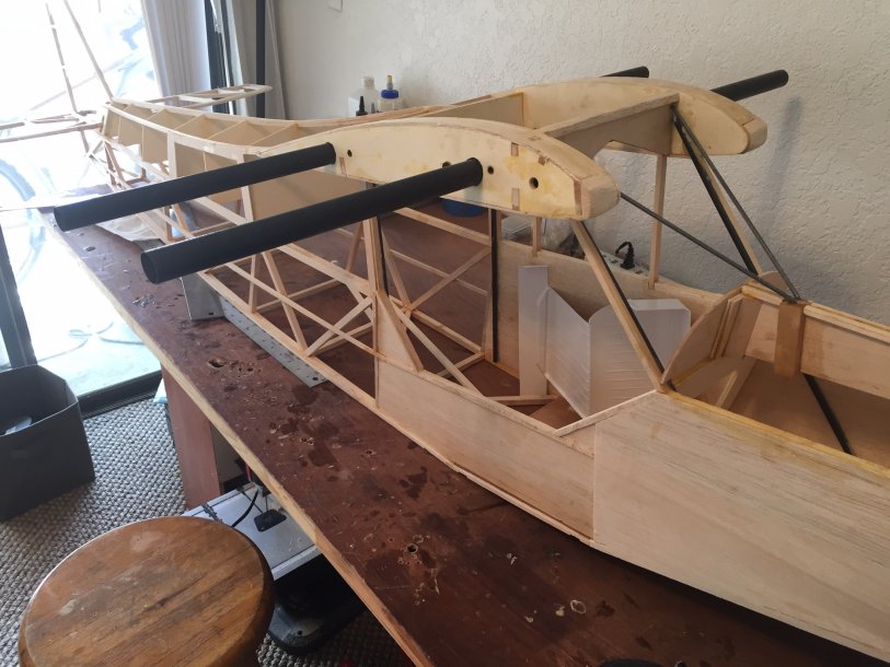

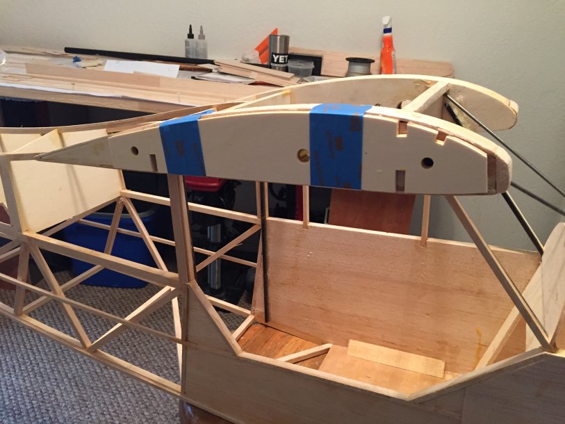

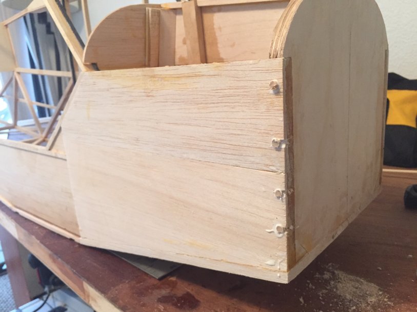

Well, I've finally got back to building after have been flying a lot the past couple of weeks. I started on the wing construction this weekend, and also doweled the firewall to the fuselage.

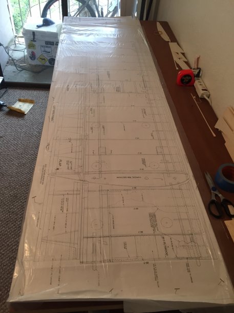

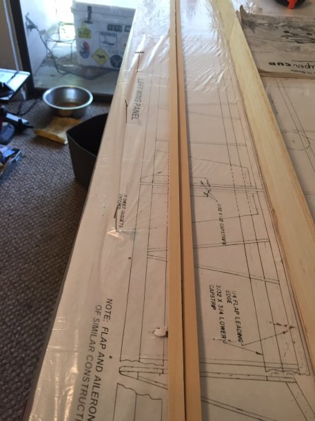

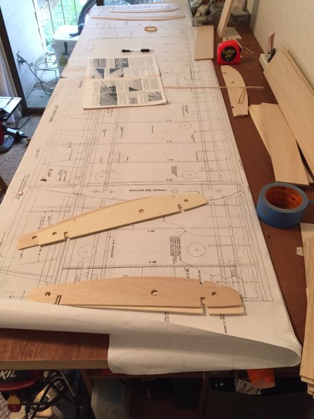

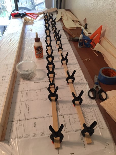

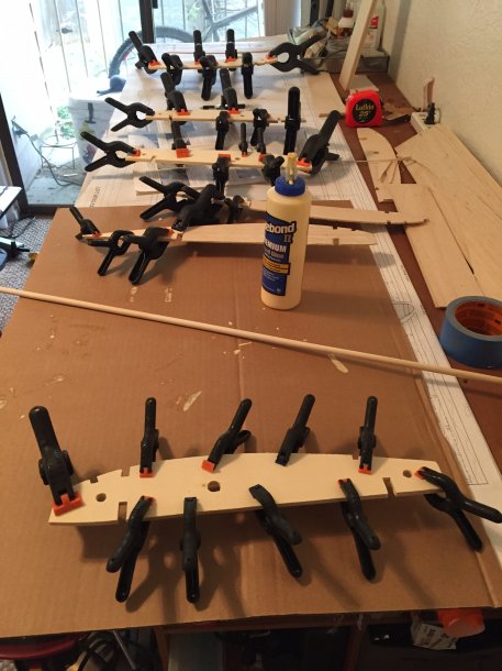

The first couple of things I had to do in this step were, #1, clean off my work surface and put down the plan and plastic covering. One wing takes up my whole table!! #2 I began laminating the ribs that required it, as well as the wing spars. On the spars, it calls for (2) spars, that are 5/16" by 3/4", you have to actually laminate these as well. I called BUSA on Friday to verify before I used the long spruce pieces incorrectly, and they were EXTREMELY helpful and very nice! What great people! They confirmed that you do indeed laminate the two to make one. So Lamination Factory was set up once again!

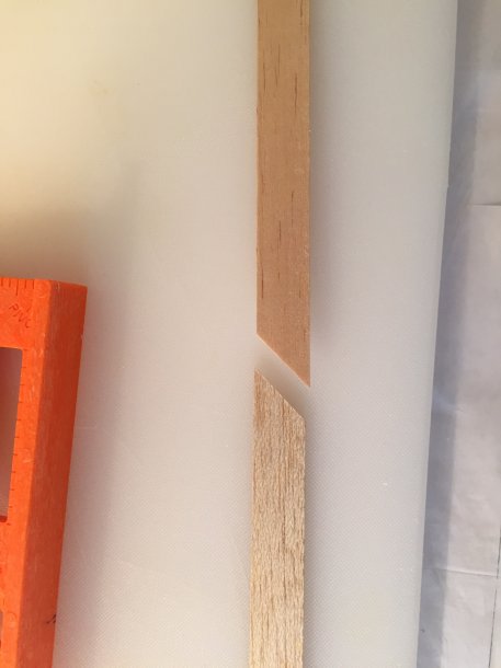

The next step was to layout the rear false spar, which is two pieces joined, and I decided to cut them at a 45, rather than a straight butt joint.

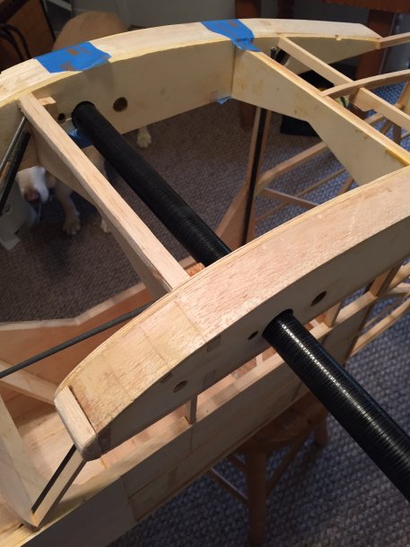

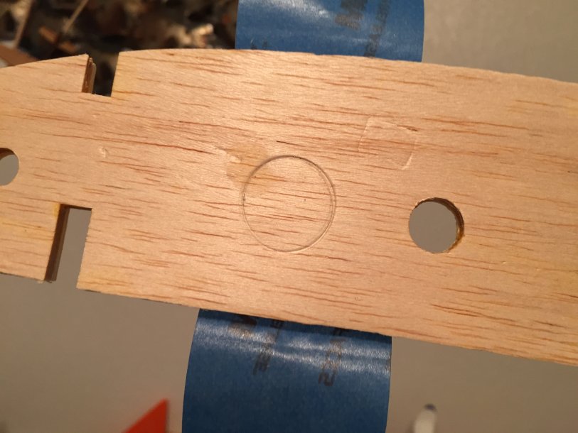

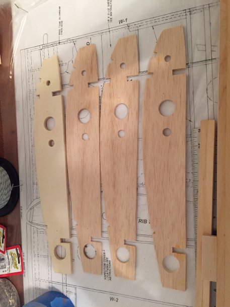

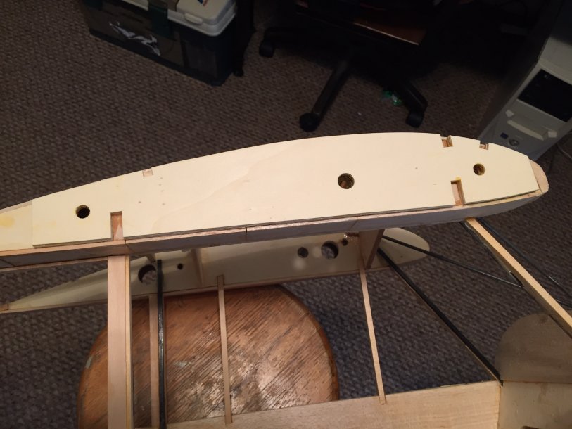

Next, was a pretty critical step. I had to drill holes in the first 4 ribs for my wing tubes. I used the root rib and taped it to the fuselage, and then stuck my wing tube through and created a tube mark where to drill on the rib, and then used this one rib as a template for the rest. My wing tube is 7/8" and I purposely drilled a 1" hole so that later when I mount the wings with struts and get the correct dihedral I can use plywood donuts to secure the tubes in place. That's the theory anyway! Haha!

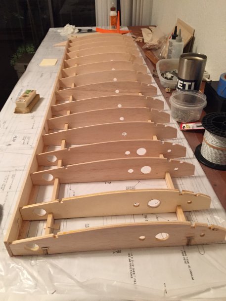

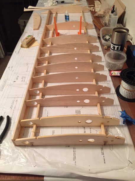

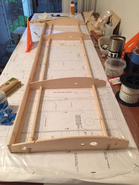

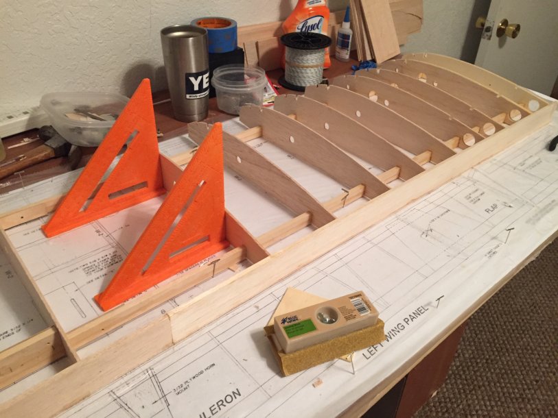

Now for the fun part! (I skipped a step on the thread, which was the strut mounting blocks, but I did that as well) Laying out the ribs and building the wing! This is great, because it takes shape so quick... it's instant gratification!
It looks like the weather's going to be windy and maybe rainy this week, so more building than flying I think. I'm ready to get this bird complete, but man, when it's beautiful outside it's just too hard to resist going to the flying field!
