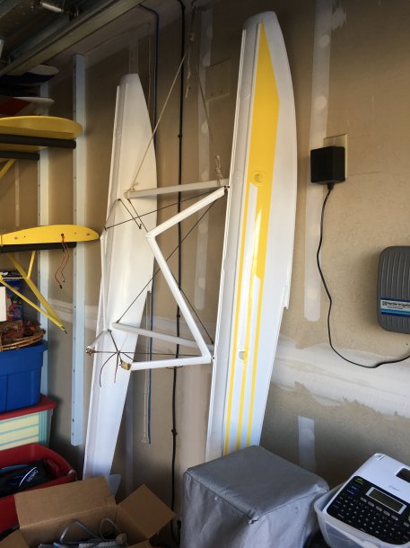

Here's a pic of the floats hanging on the wall. If I lived closer to somewhere I could float fly the plane I'm sure I'd put the floats on it. Mine has a D&B 5.1 (83cc) engine in it and it fits except for the spark plug caps. It has plenty of power, a 70 would easily fly the plane. Take off and landing rollouts are about 4ft.
http://www.dandbengines.com/db51.html
The floats look great! Now you've got me thinking about it. Haha! Yea, the EME 70 was the biggest twin I could buy without the plugs sticking out... and that's one reason I chose it. I have an EME 120 on my Yak 55 and it runs great, so I'm definitely a fan of those engines as well, but I definitely checked dimensions for a twin that would fit.

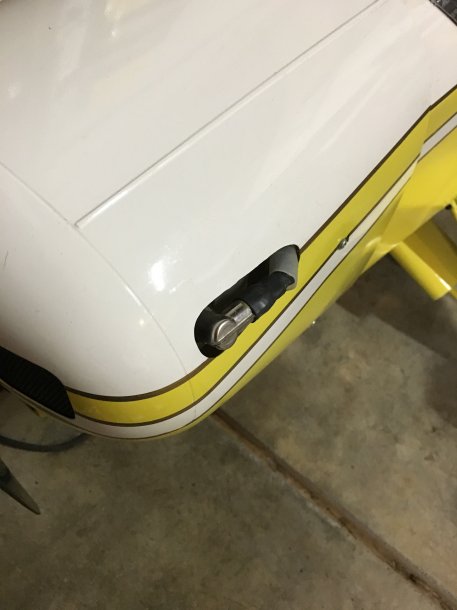

Here's a pic how much the spark plug caps stick out. He had this engine on his 35% Carden Yak and then decided to build this plane so he bought a DA100L for the Yak and put the D&B in the Cub. He built several sets of these floats and always complained about how much work they were.

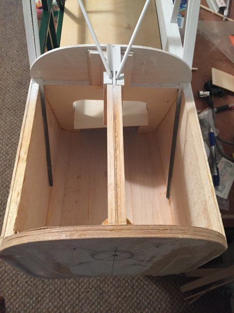

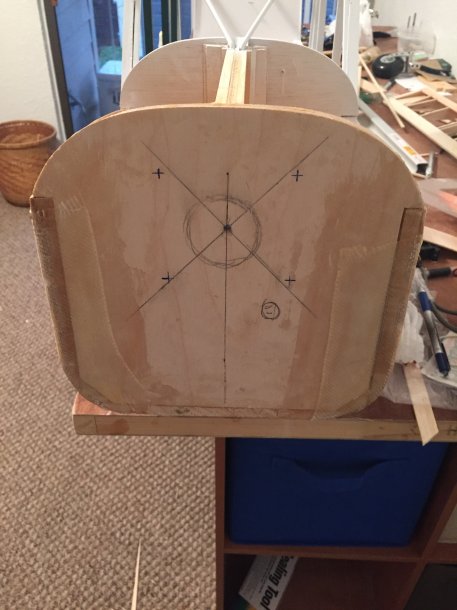

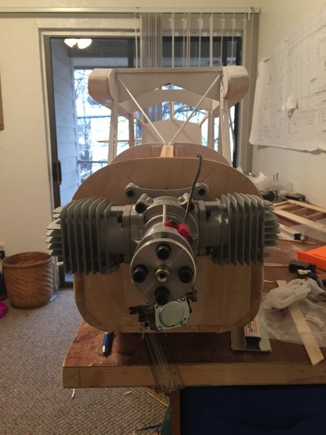

Today was an important day in the birth of an airplane. I mounted the engine... Well, I pre-mounted it... I have to paint the firewall before mounting it permanently, but getting it mounted up set a chain of events. In front of the instrument panel there's a piece of wood that's glued permanently in place with a piece of aluminum that will go over the top. In order to keep this scale appearance I had to first mount the engine, then drill the holes for all the supporting components and then place them inside. Since I want to use the aluminum I decided to access all of this from a hatch on the bottom of the plane. Here are the first few shots... and they say "measure twice, cut once" with the engine it's measure about 20 times and drill once. Ha! My 2 degree down thrust will be achieved with washers when finally assembled.

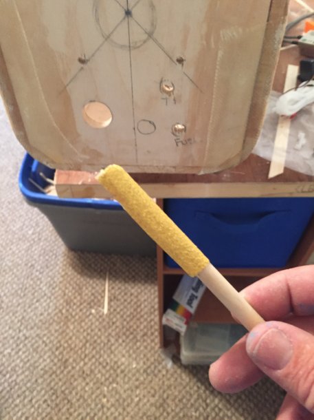

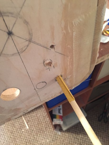

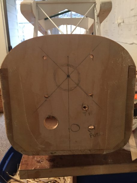

After setting the engine I marked and drilled the holes through the firewall for the throttle rod, fuel line, and ignition cables. Once these were drilled I used a piece of sandpaper wrapped on a wooden dowel to sand the edges and hopefully prevent some wear down the line.

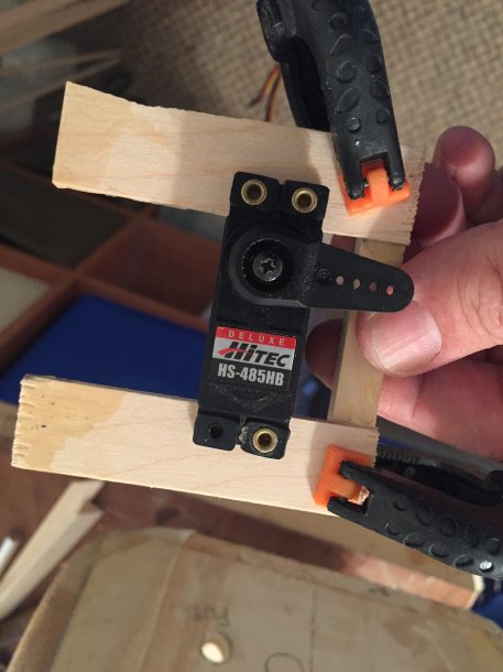

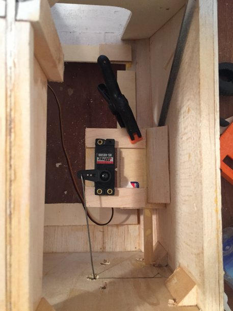

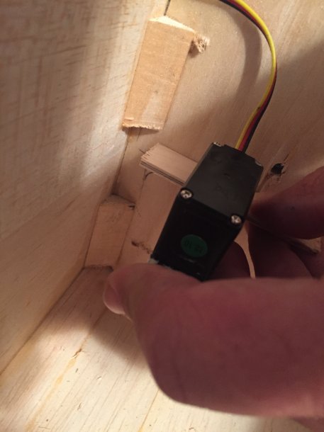

The next step was to mount the throttle servo using a spare servo I had lying around and a piece of wire to substitute for the final rod assembly to give me an idea of where to put it.
