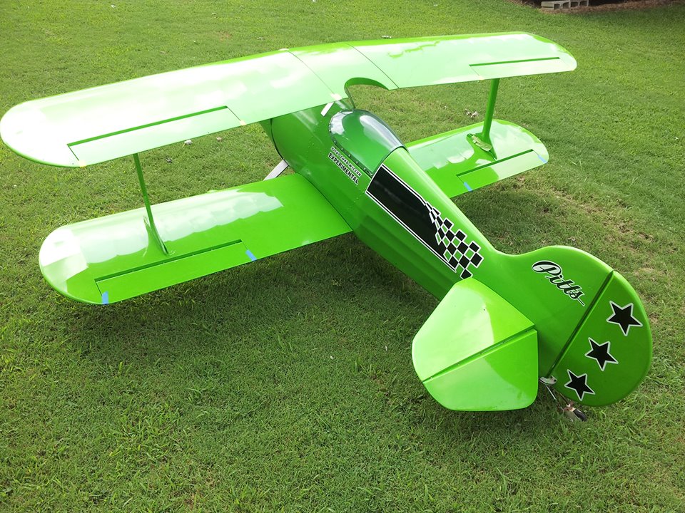

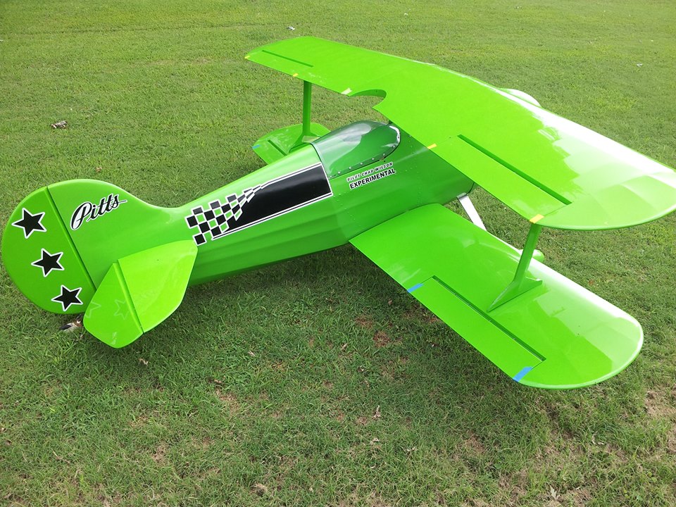

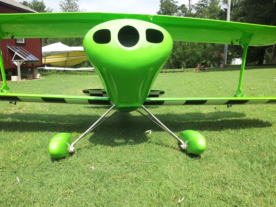

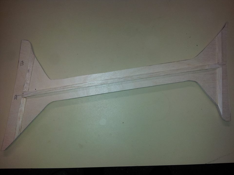

Ok guys. Long time no update...
I stopped on this one while I get funds for a 170-176cc to build a corvus..
here are some pics...

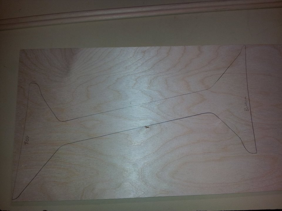

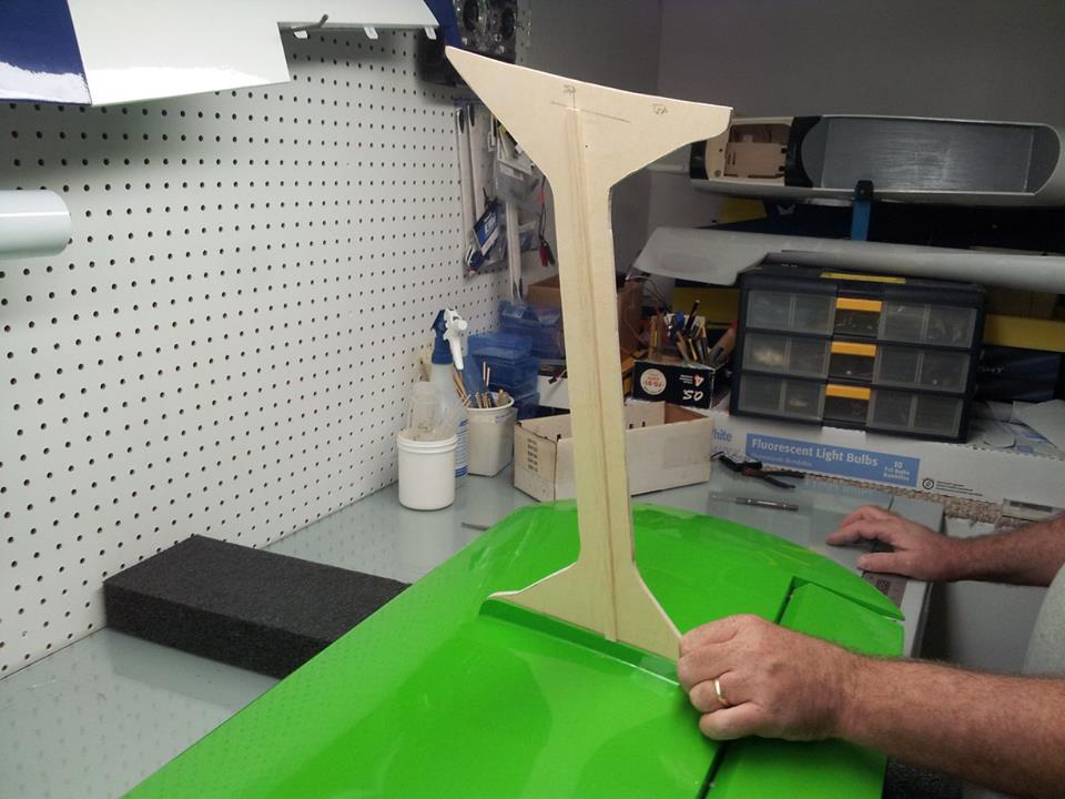

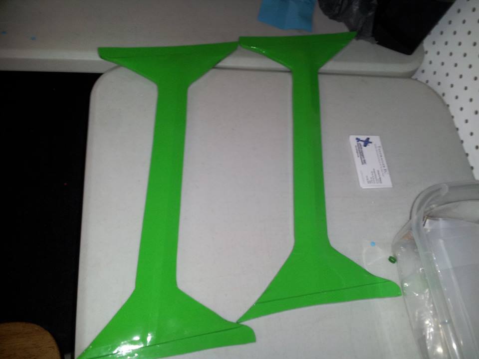

I had to build so I-struts for her... Made from 1/4" spruce ply. Added balsa cap strips for an airfoil shape and covered...
Here she is as a mock up in the yard.. It gets huge fast when the wings go on;)
