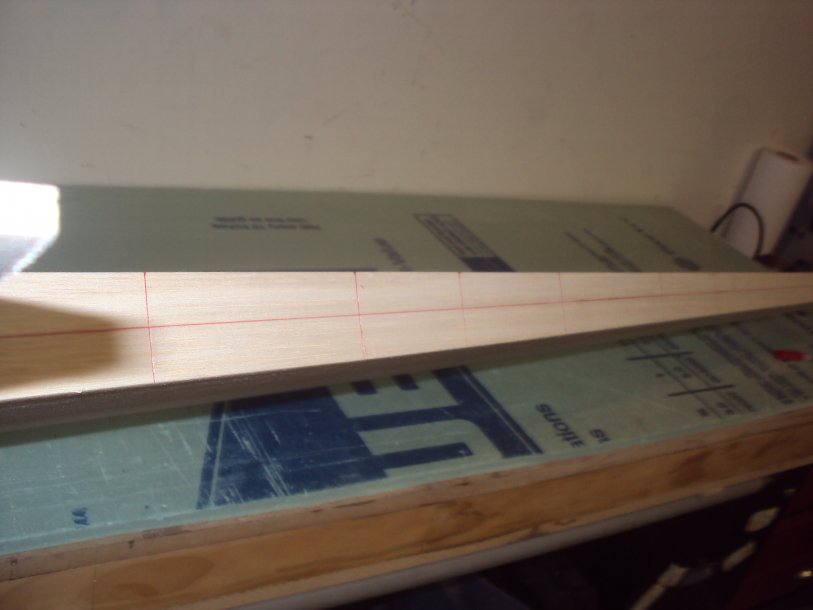

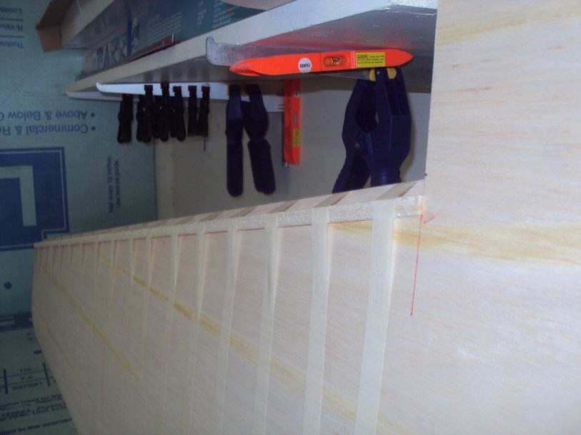

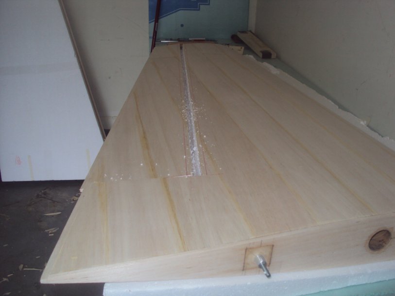

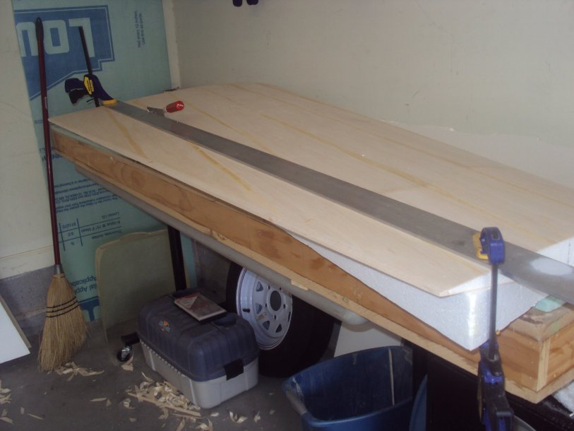

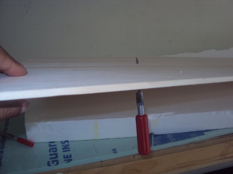

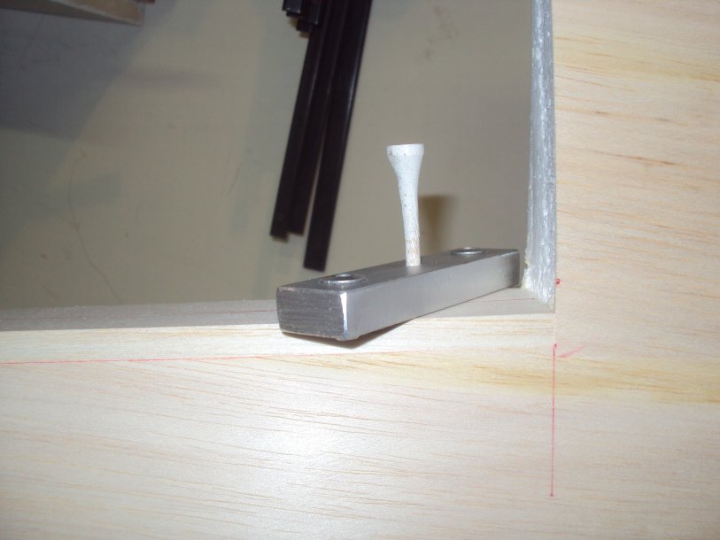

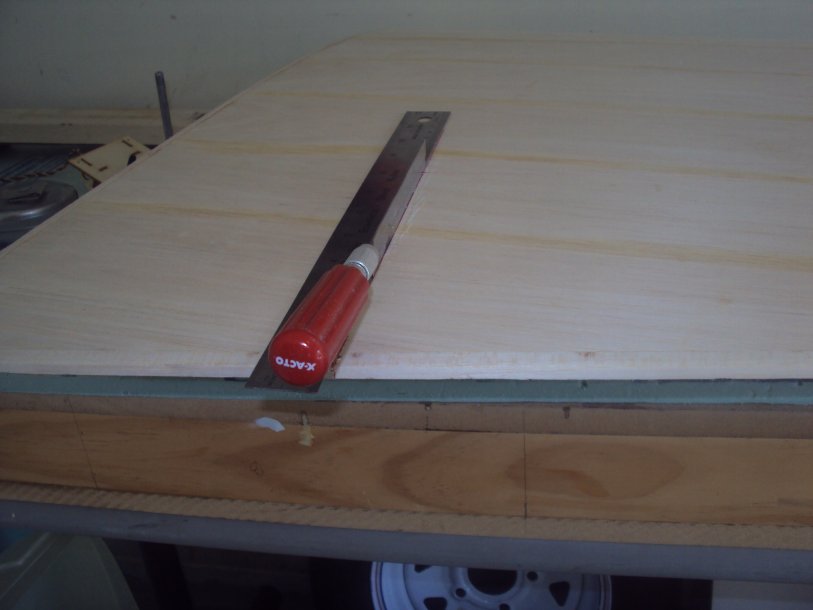

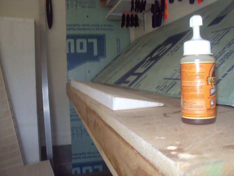

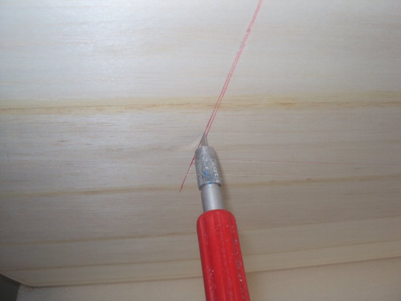

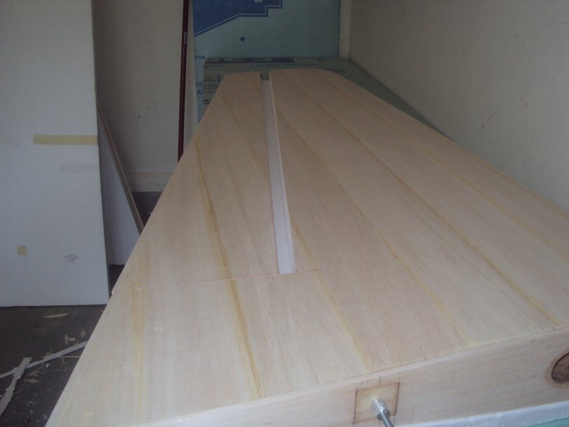

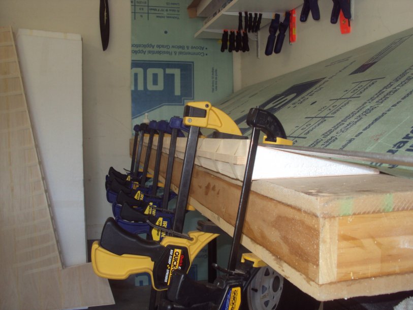

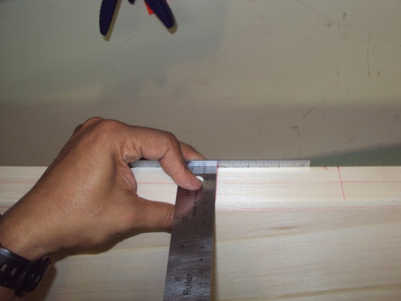

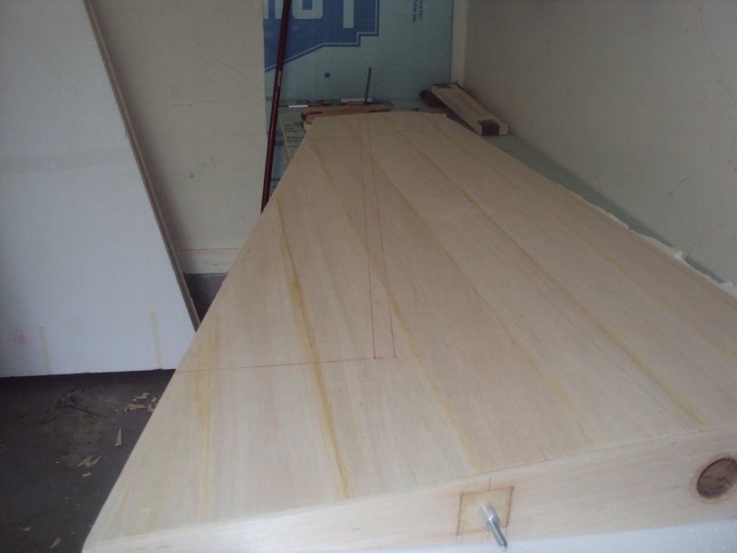

OK, few more steps closer, I took a break from the hatch and worked on cutting the ailerons and everything else that comes with that like gluing on the LE, TE and locating the hinges. Unlike the rudder and elevators I decided to locate and drill the hinge locations after trimming the 3/8th balsa LE, TE strips. If you guys remember on the elevators I drilled both the LE and TE together giving me a perfect centering and because they are obviously shorter the aileron LE, TE I felt I could keep them center on the stabs and elevators, which it was the case. To find the center on the on the wings TE and aileron LE I made a tool which help me keep the drill straight and perfectly on center.

Alky6
Love the drill jig! Need to make one myself, thanks for the great idea. What did you use for the pins on the ends to engage with the outside of the LE and TE?
ROLLERMAN
I used rivets, another way would be to tap the hole with a 1/4 20 or 1/4 28 and after put some shrink tubing on the threads to keep from marking the balsa. If you make something post it here.
Alky6
Will do. If I go the route of cap screws, will probably machine off the threads where it protrudes. Good ideas!
