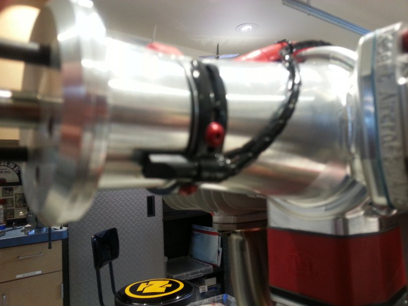

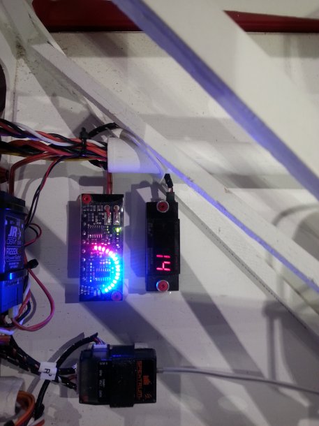

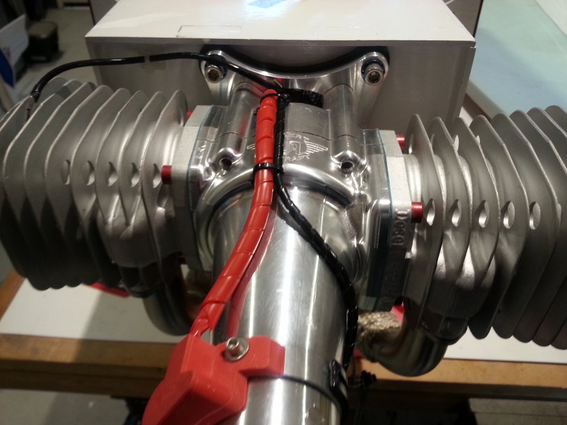

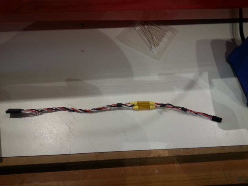

Some pics of installed system. total cost under 30.00 including digital tach.

Alky6
I recently picked this up for use on my VVRC 40 twin. Works great. Plugs directly into the tach output on the RCexl ignition and is supposedly optically separated. One item to note, during fast spool ups, the unit can't keep up and you get an erratic rpm reading, much higher than actual (325,000 in one case). It does settle right back down and keep perfect pace with the on-board digital tach.

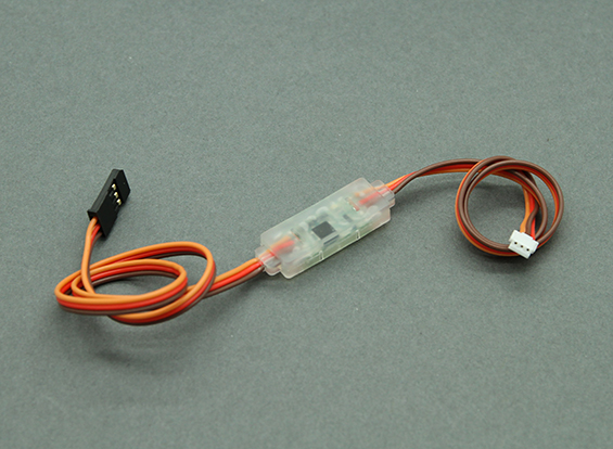

BJ Swope
Just an FYI......
I found this at HK for $4.90. Currently out of stock:sorry: of course. It is an Rcexl component so you can plug the Tach out from an Rcexl ignition in to the tm-1000.
