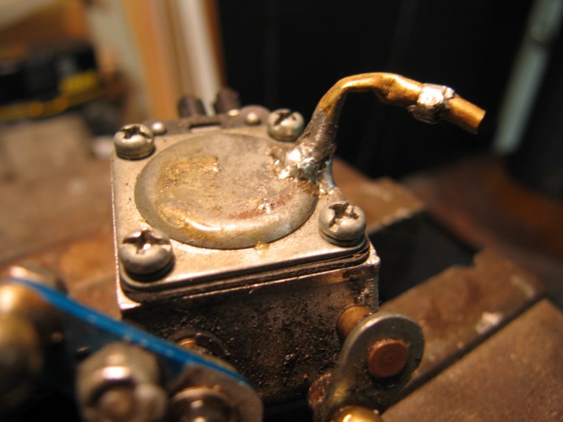

This is what I do, then I run the tubing into my muffler, works like a charm.

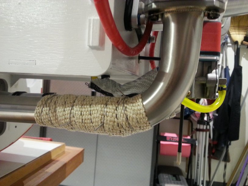

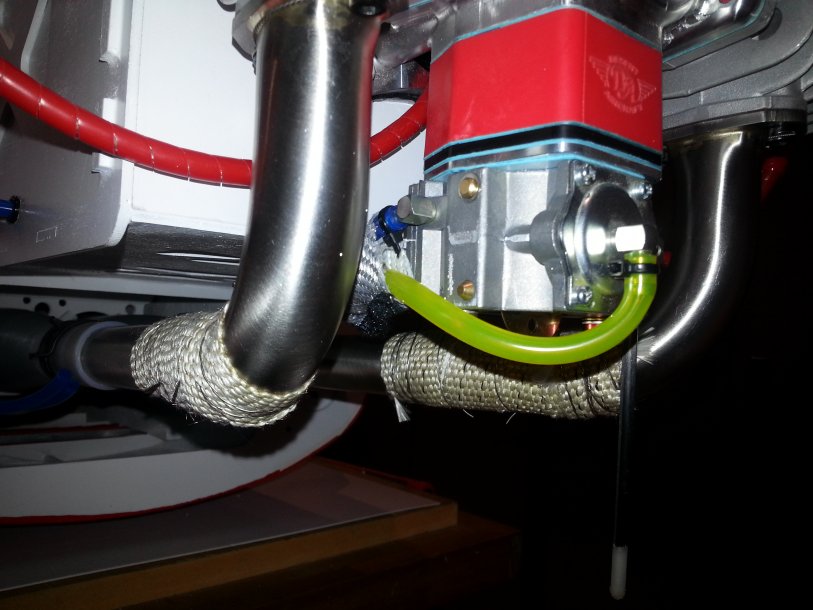

Went with this for vent/diaphragm from carb. And added a heat shield for both lines. I like it !
In motor box used a aluminum tube 1/2" long by 3/16" and grommet with a tie on it to keep the line from deforming.
That Works!
I was also wondering where to get that thermal wrap?? I know about the braided wire pipe socks but that wrap + sock will keep heat and mess to a minimum.

Both of those items were from the JEGS hot rod catalog. Forgot what brand I threw away the packages, sorry.
Saw the same stuff at kragen for half price though.the wrap.. Not the sock that is.
