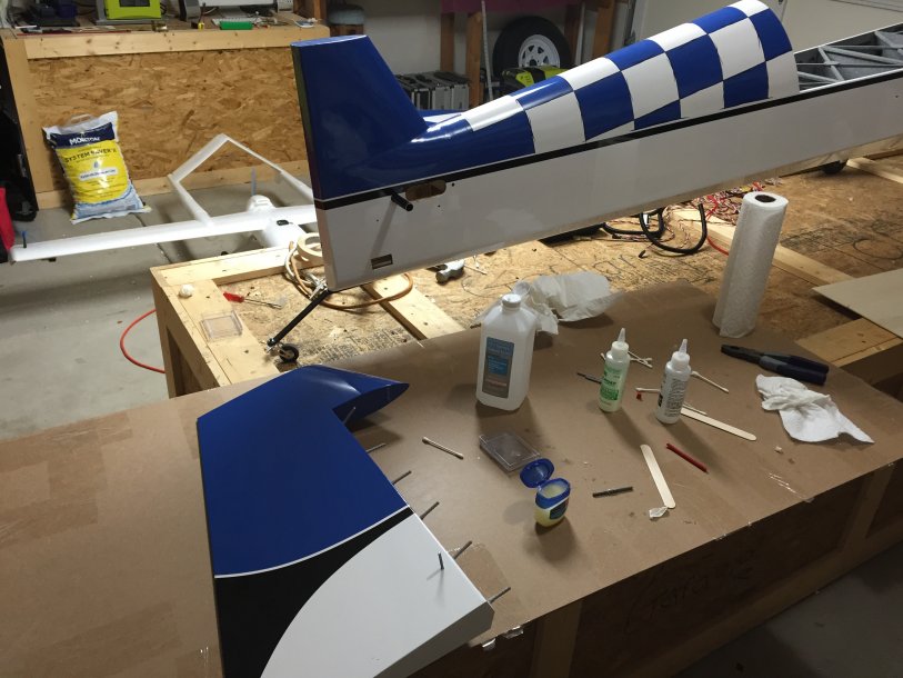

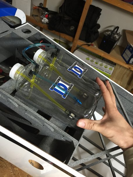

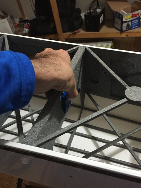

More photos of the progress!

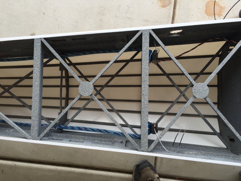

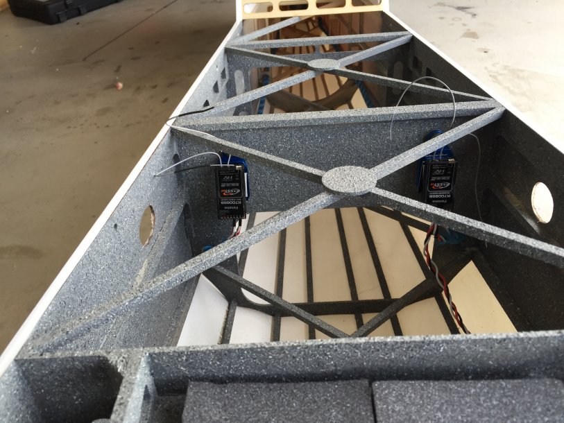

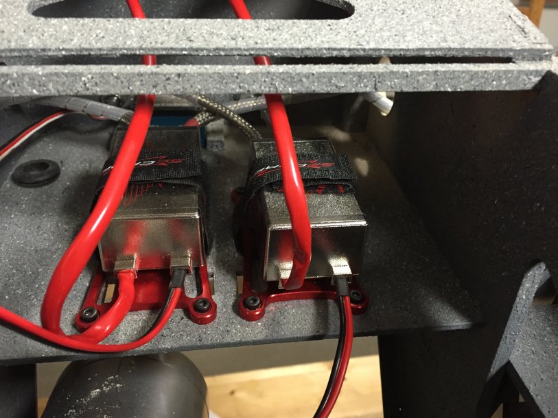

garlandk
I am using secraft rx mounts to mount my RXs to the plane. Instead of using the wood screws supplied with the mounts I used M3 screws with lock nuts on the other side.

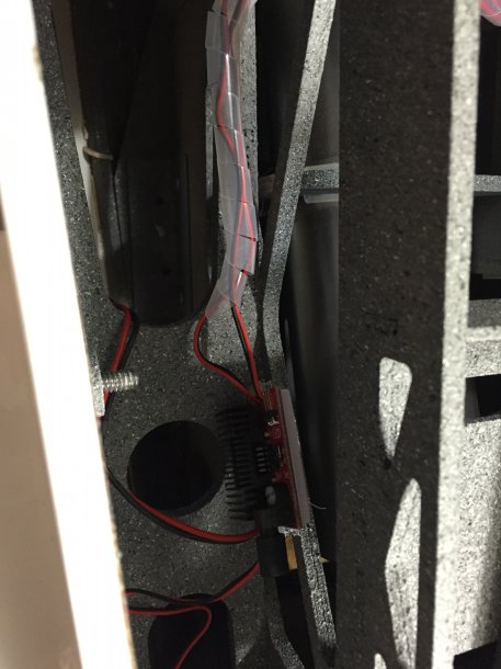

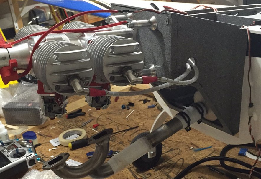

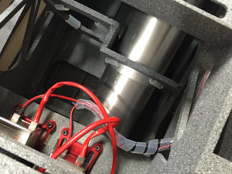

garlandk
Help of a friend tonight we got the throttle linkage done. Also going through and putting heat shrink on all of the cables.
