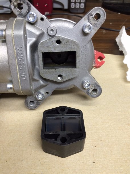

I have no choice but to check the reeds and blocks on my two DLE 55's now after the previous debacle with the 30.
(Come on Jody)
Anyway, I started with a 55RA that flamed out on me in July and caused damage to one of my favorite planes.
The plane was rebuilt and flown a couple of times after the incident, but my flight log still shows that it ran, didn't quit,
but wasn't idling quite right. Wouldn't idle down.
Guess I fiddled with the needles enough to get the test flights after the crash done, but now I'm looking at it
in a different light.
Today I pulled the reed block and carrier off, and much to my surprise ---------->
Survey Says:
PRESTO!
No gasket between the crankcase and the reed block.
Oy Vey...

Good thing you checked it before the previous incident repeated itself. BTW, that reed block could use the same treatment you gave the one in the 30.
