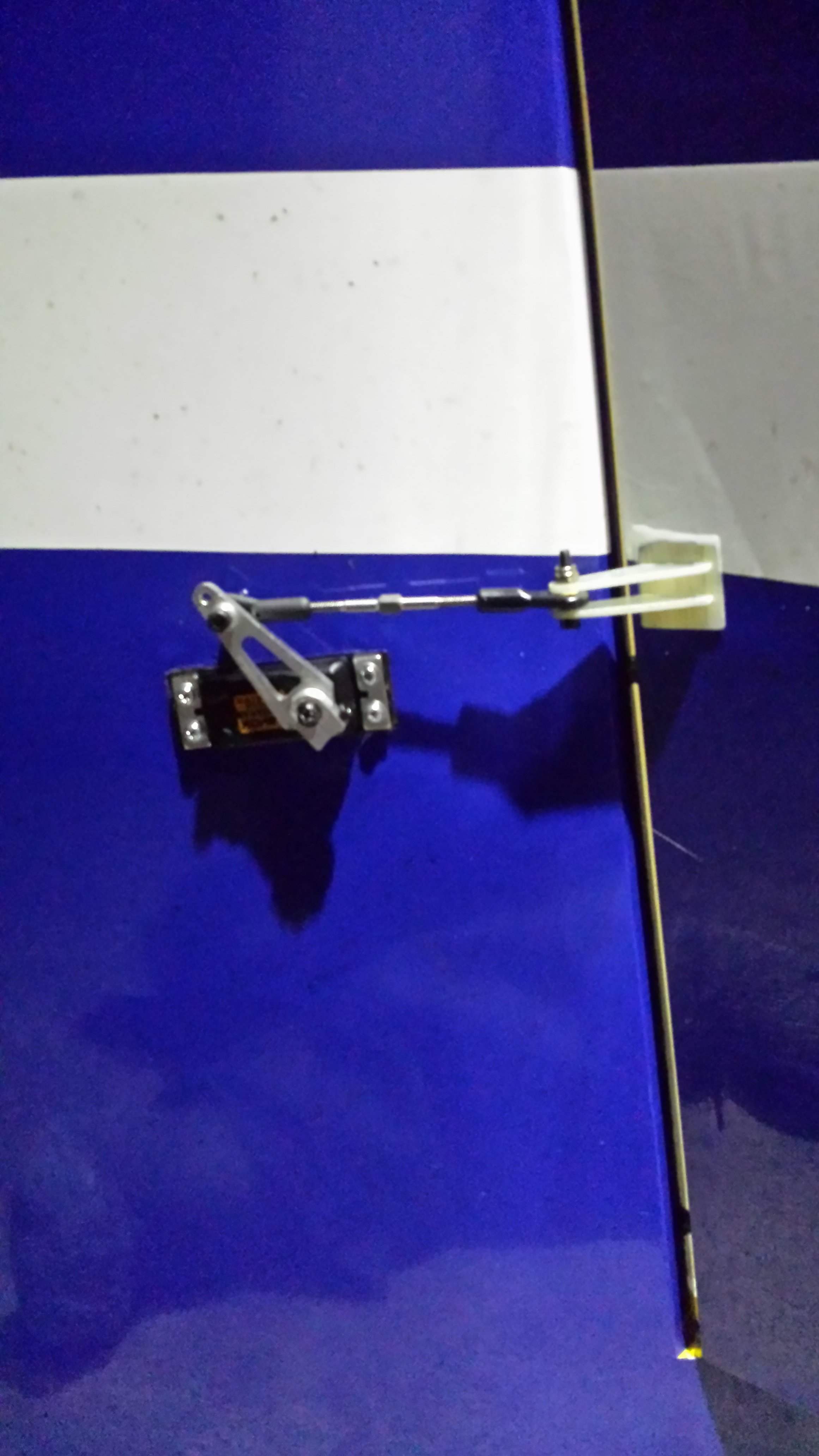

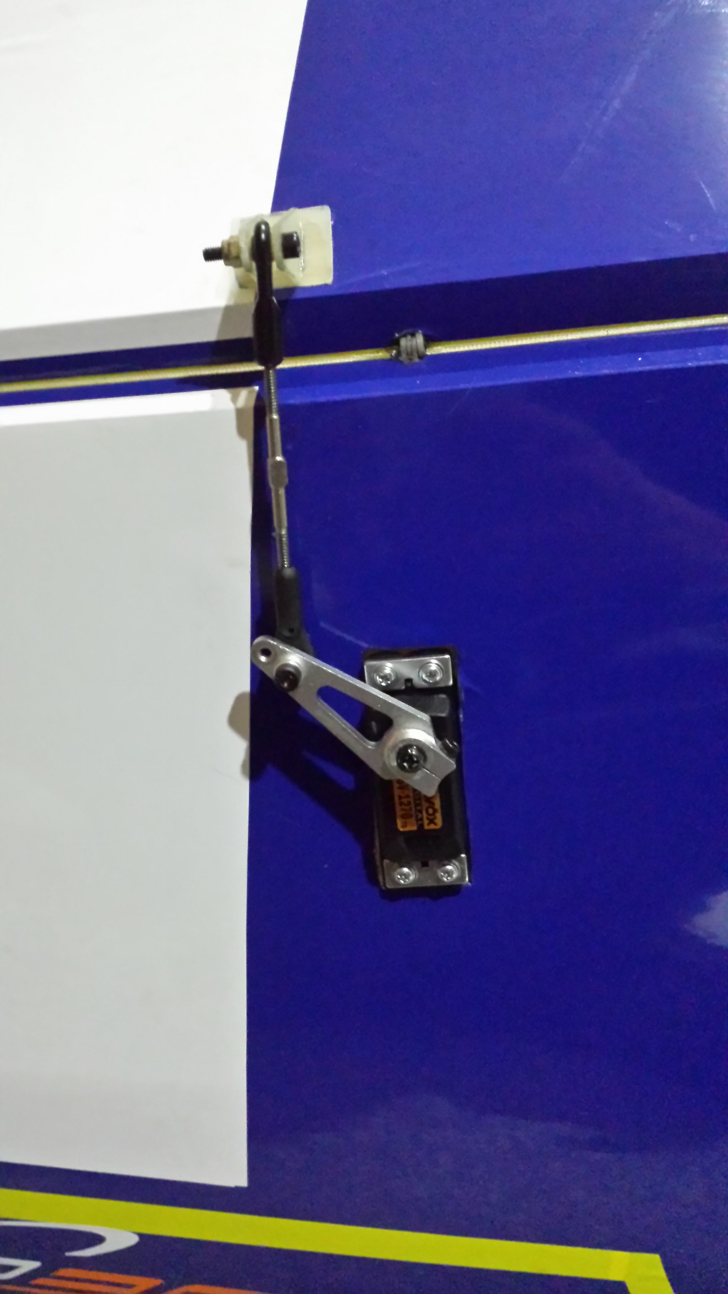

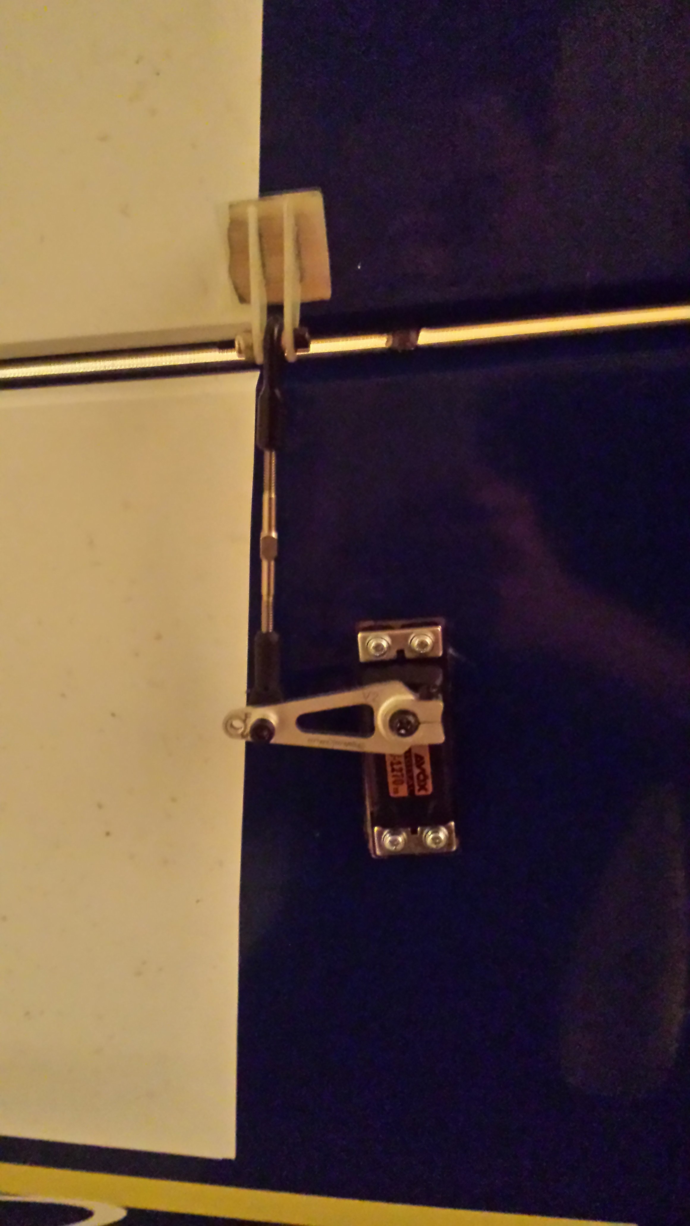

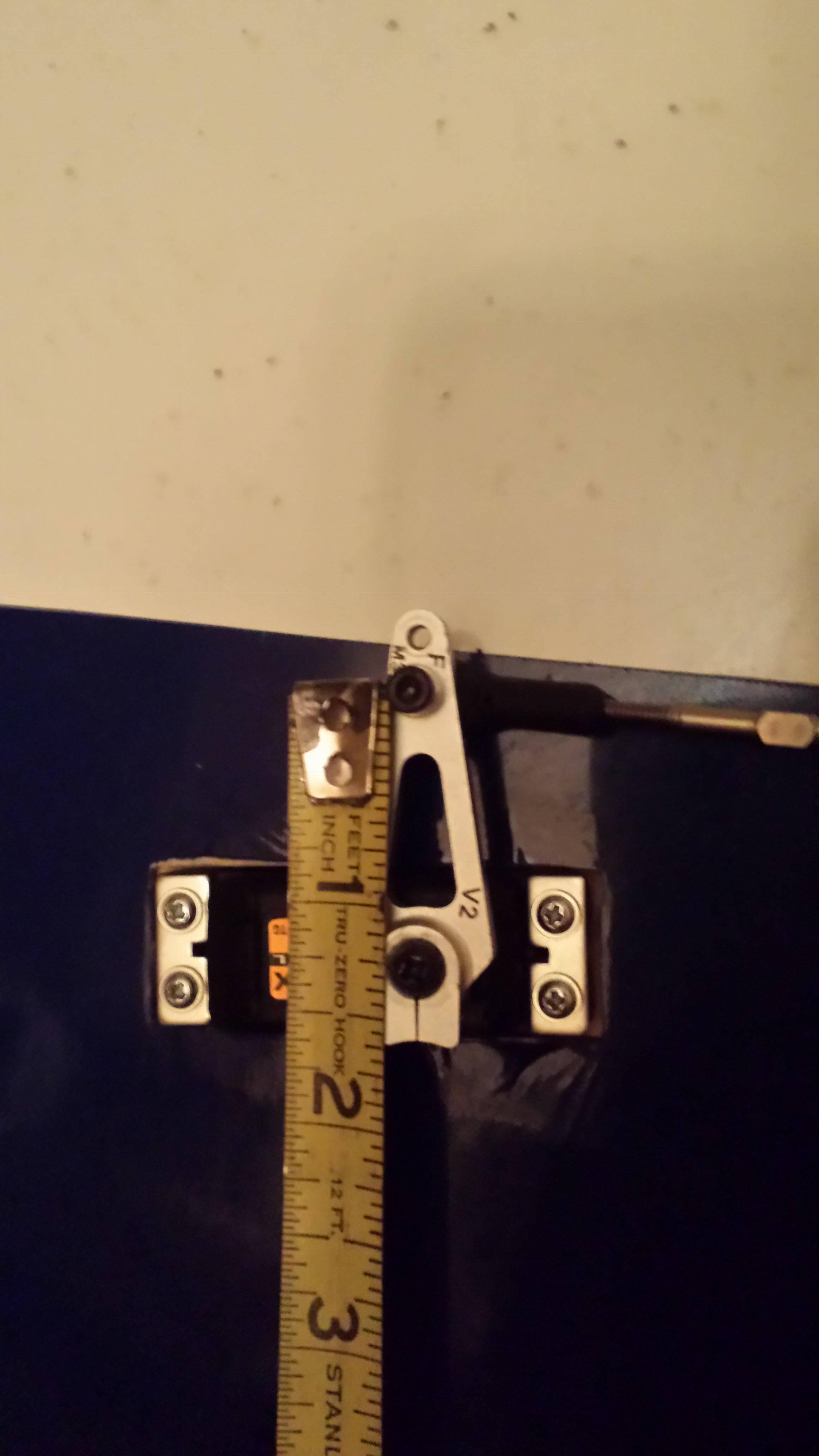

Made some adjustments on my aileron setup. I was getting 50 degrees of throw with the 1.5" spot on arms and my endpoints were not even maxed so I moved them to the 1.25" hole. Now I'm much closer to 100% on my endpoints and still am getting 45 degrees of throw.
Using the Savox 1270s.
Sorry for the blurry pics, the lighting is terrible.

I am using 7954s at the 1.5" position. I like the maxed out throw for hovering. With my usual setups I sometimes get better roll rate on mid rates at speed. I read once that anything over 38 degrees is just drag and deflective force.

I think I can still get more than 45 degrees but yeah they were acting as air brakes when doing rifle rolls at 50 degrees. I would go to an even smaller arm but I think it would mess up the geometry. I'm close to 100% endpoints but have 140% available.
