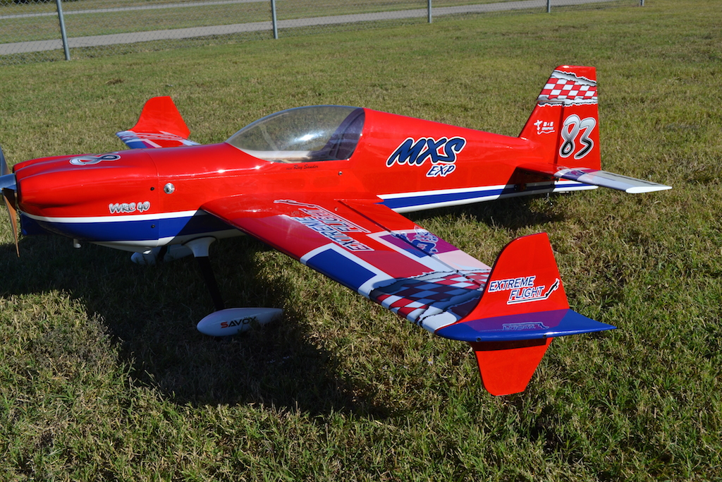

I am really close to pulling the trigger on a 120cc PAU Edge 540 and if so my beloved MXS needs to go. If anyone is interested in and around the Texas area I will drive half way.
I'm interested. Can't see too well on the iPhone but is it gas? Only interested in electric.

Yes it's gas with a VVRC 40 twin
