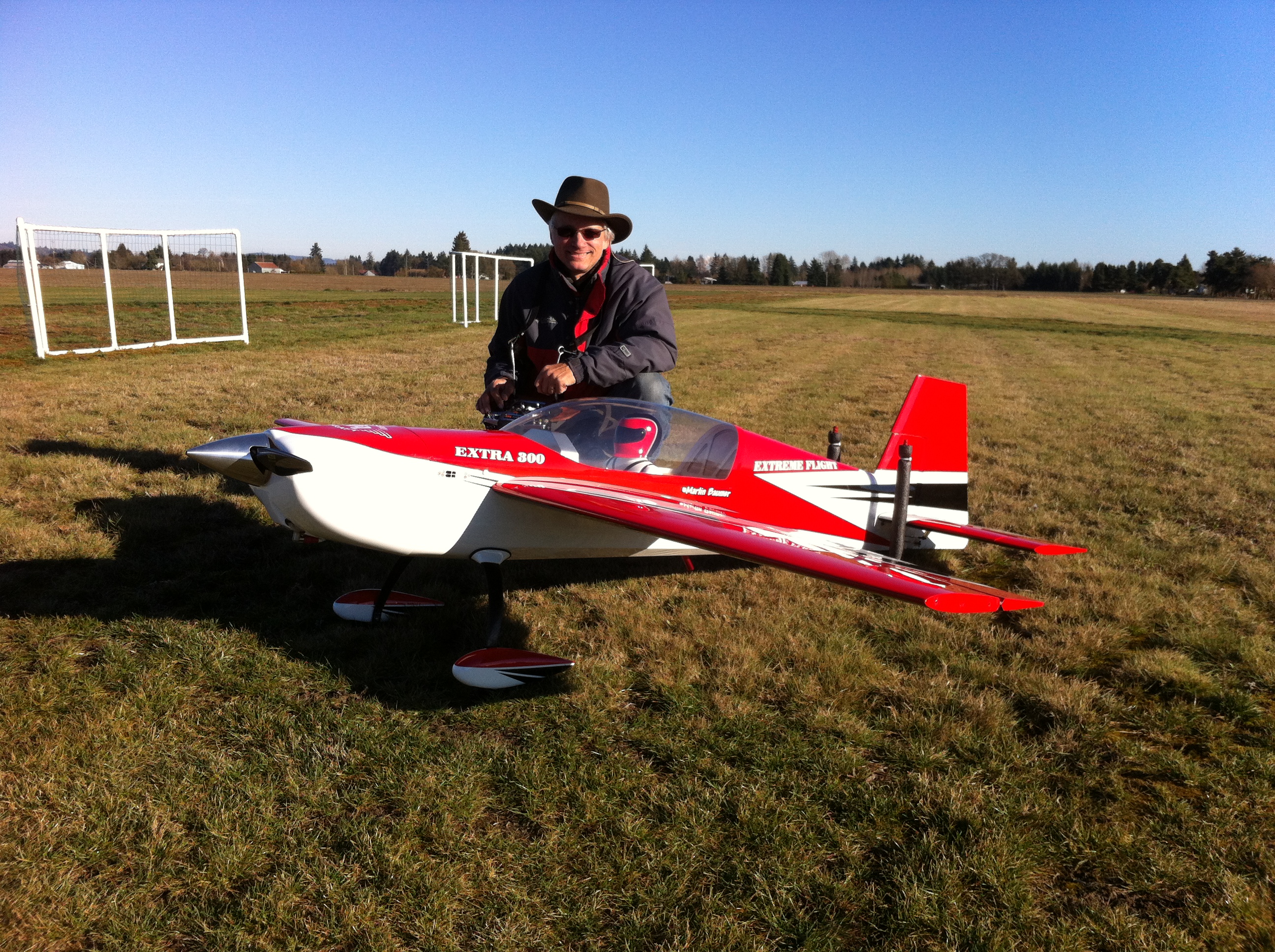

Here is a Pic of Martin Baumer and his EF 91" Extra 300 powered by a DA60 with MTW RE2 header and pipe. Sounded really nice.

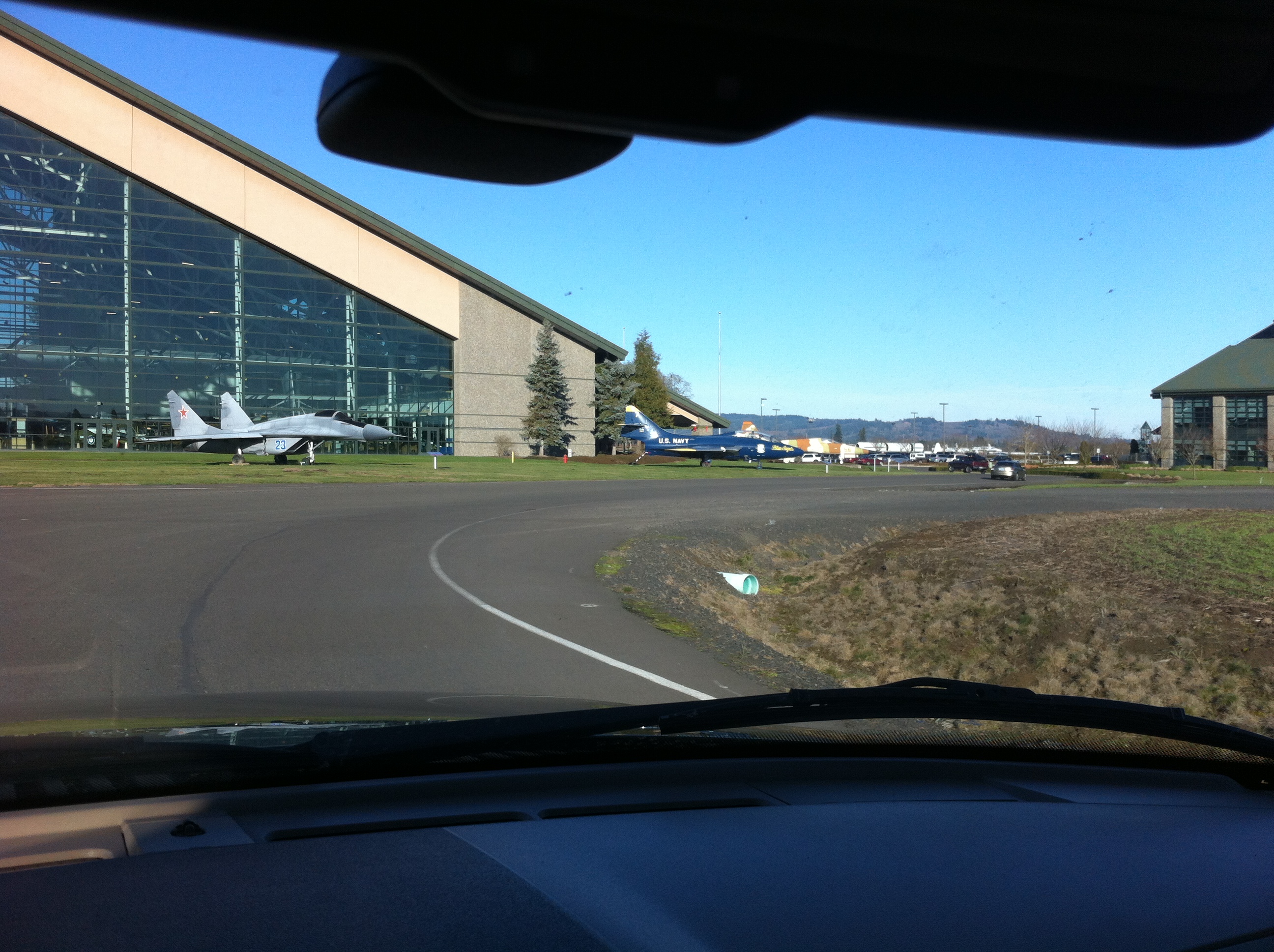

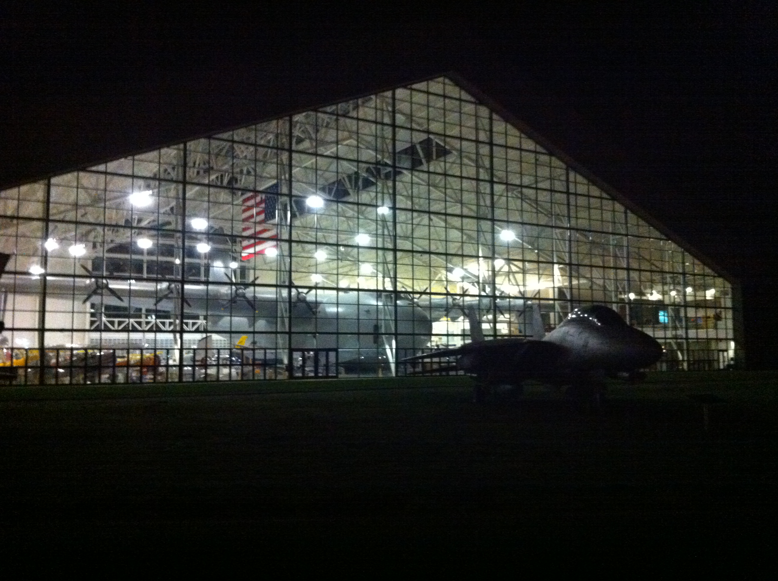

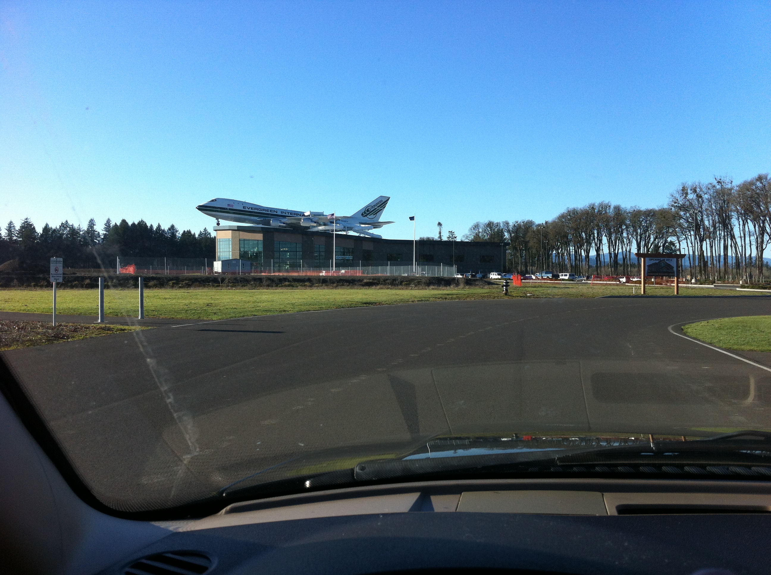

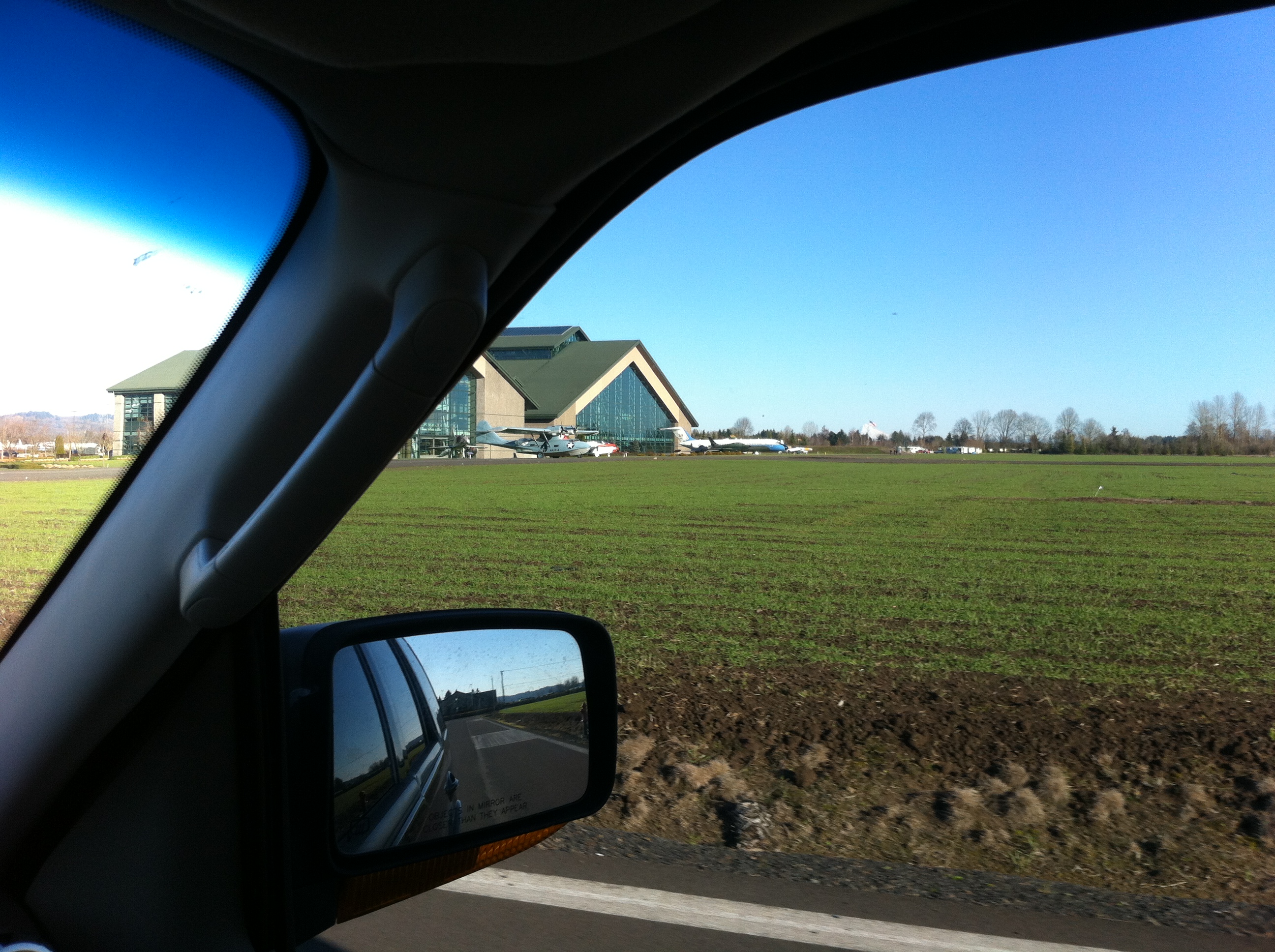

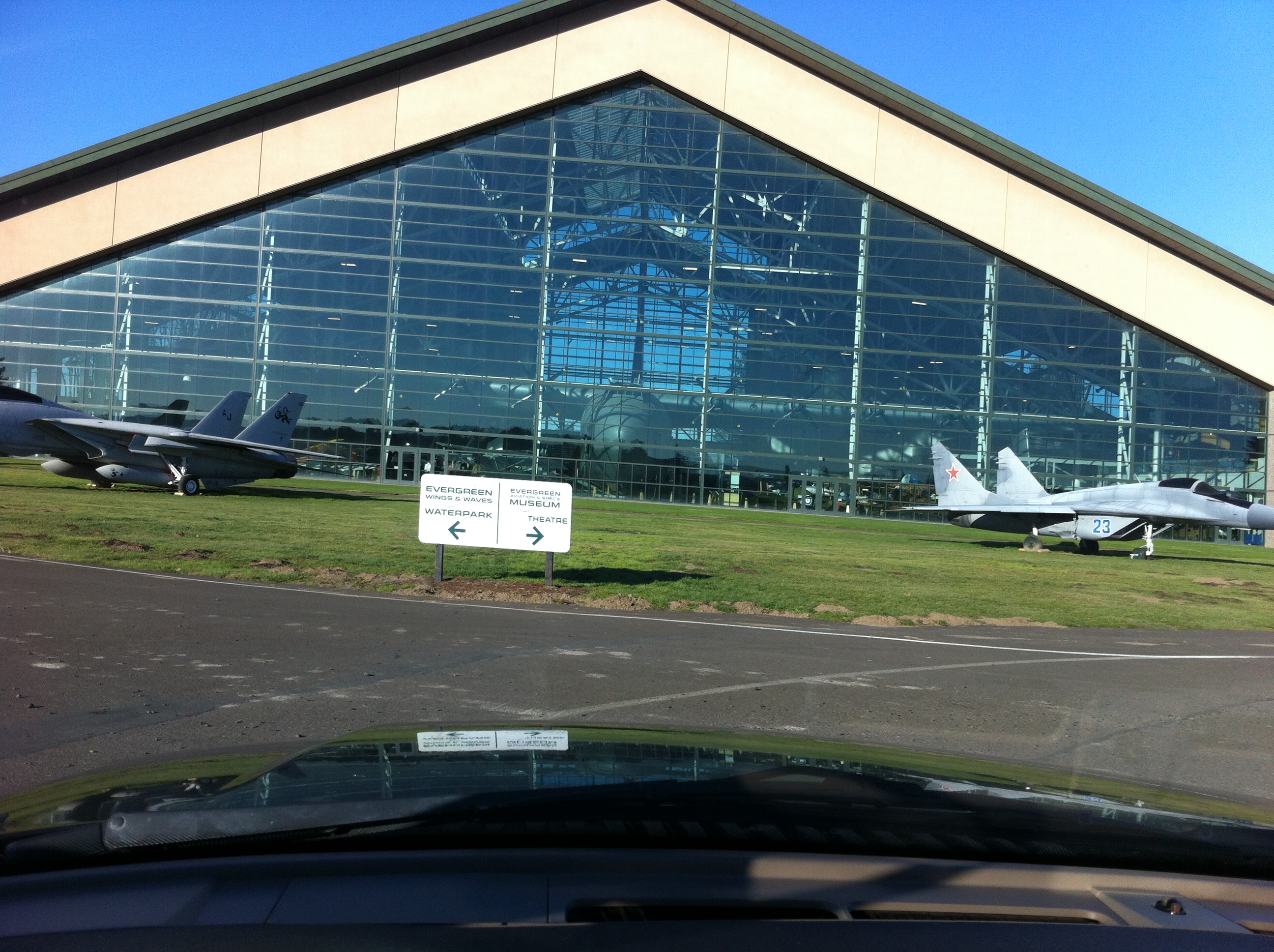

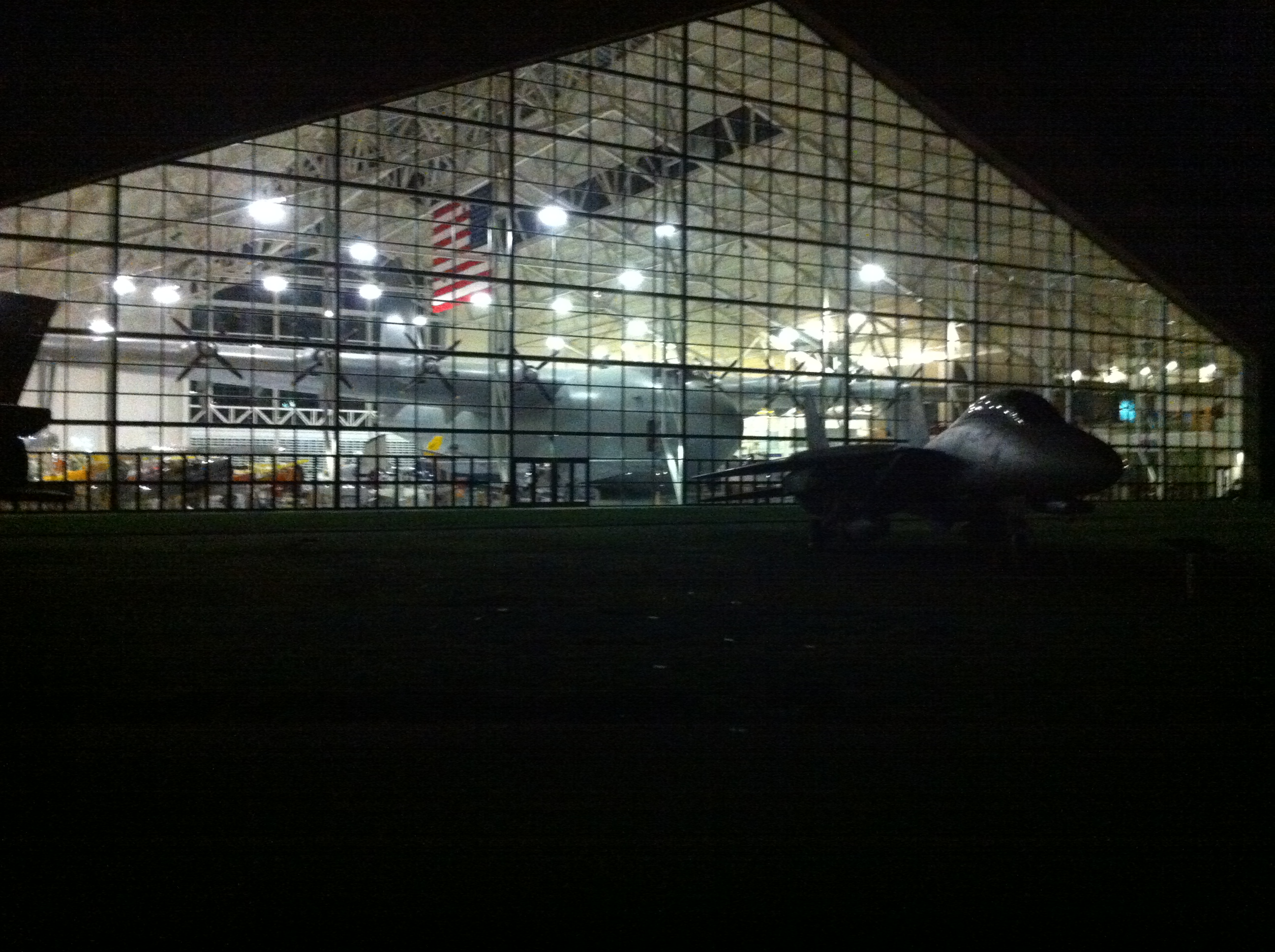

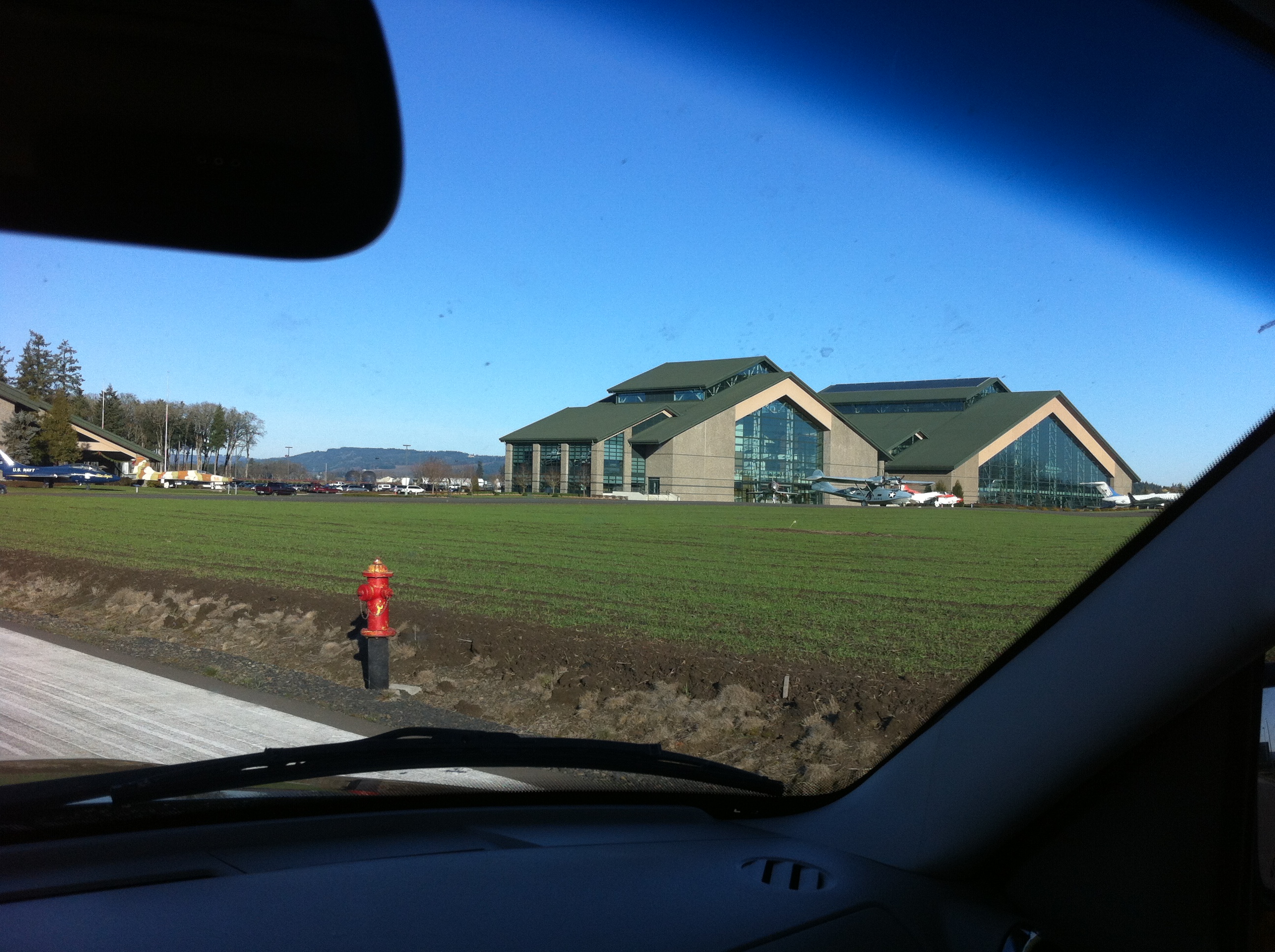

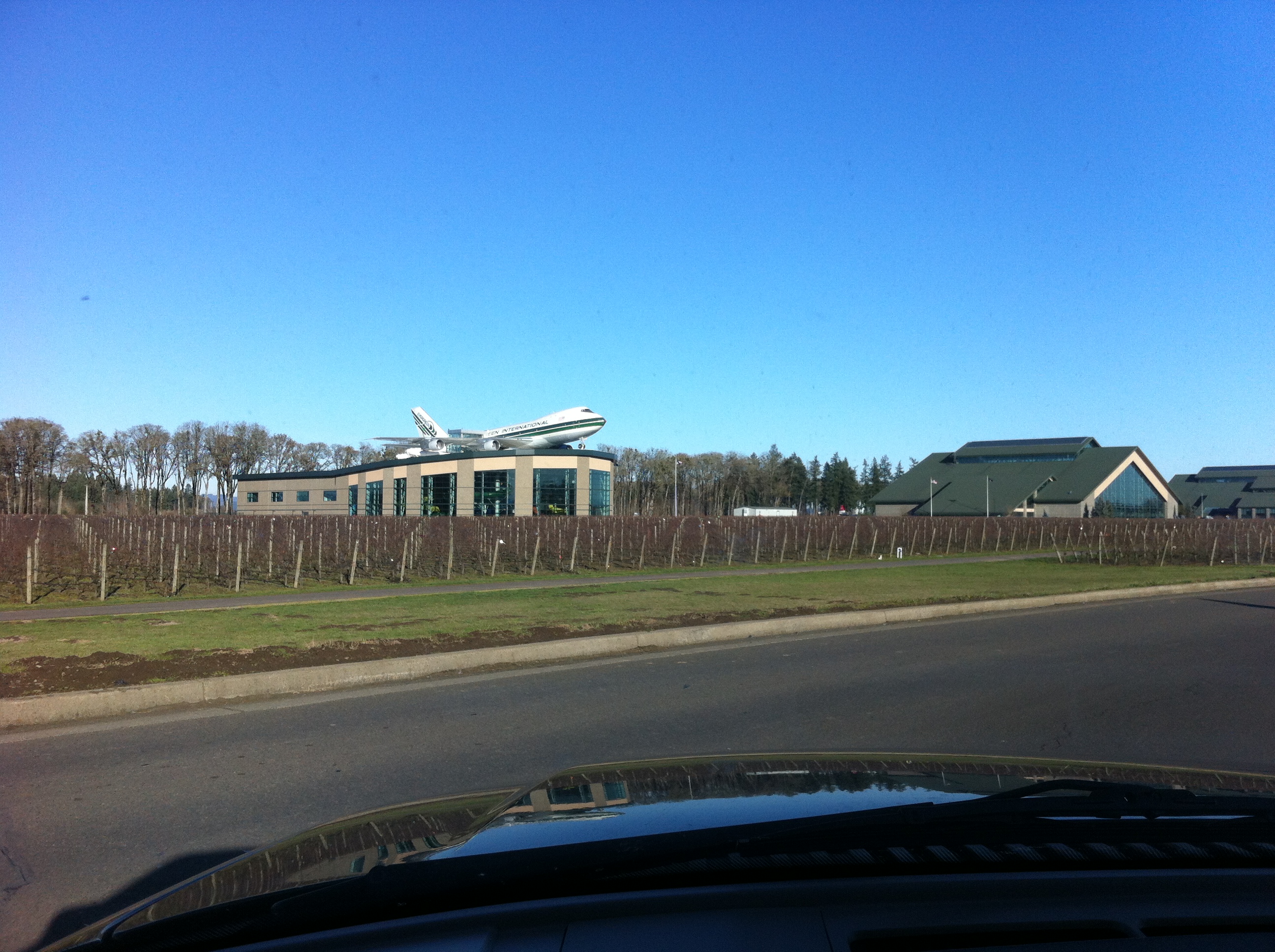

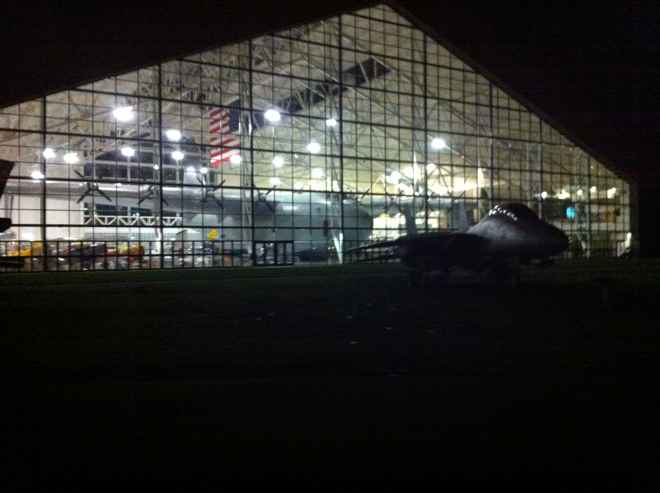

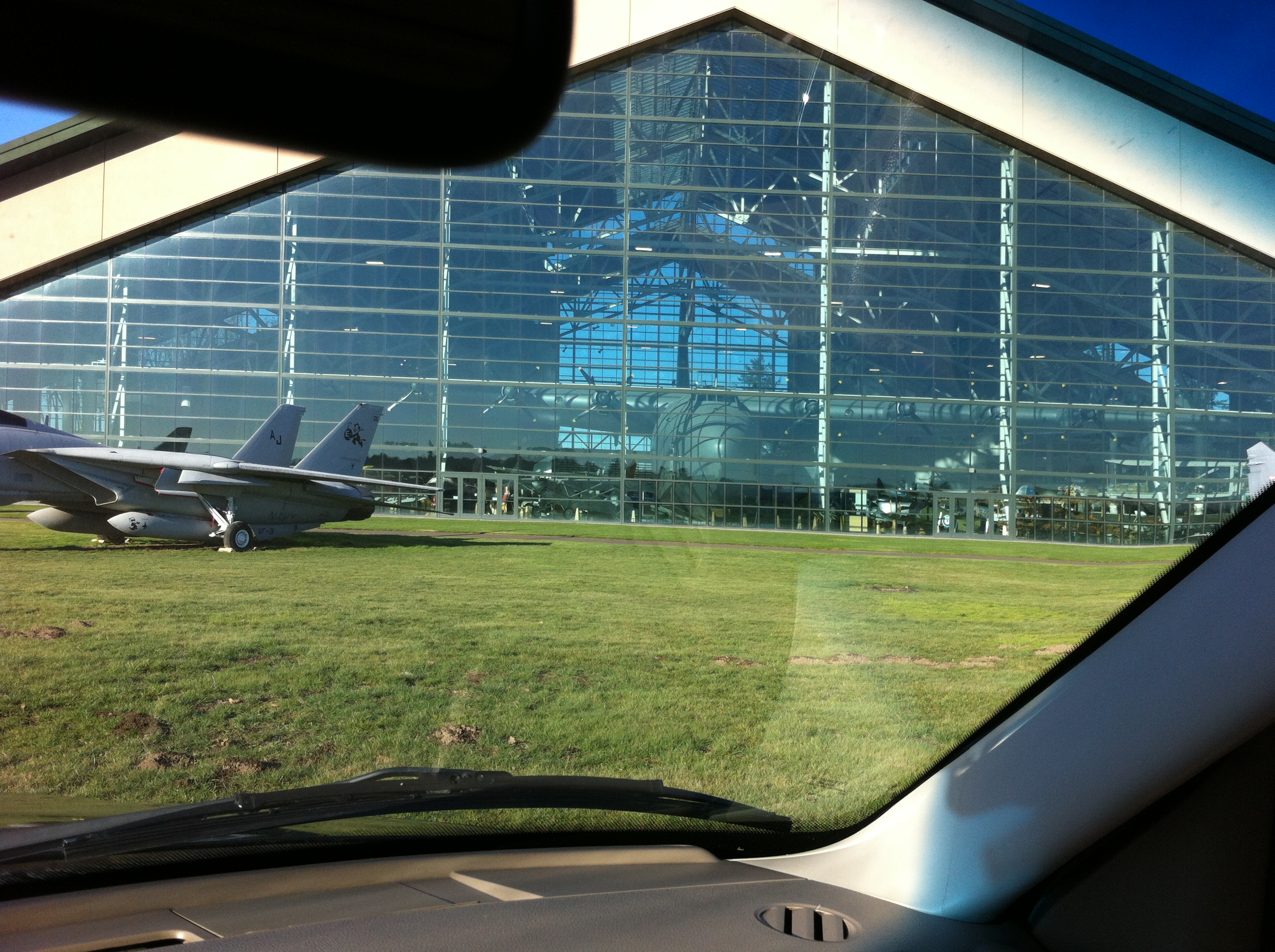

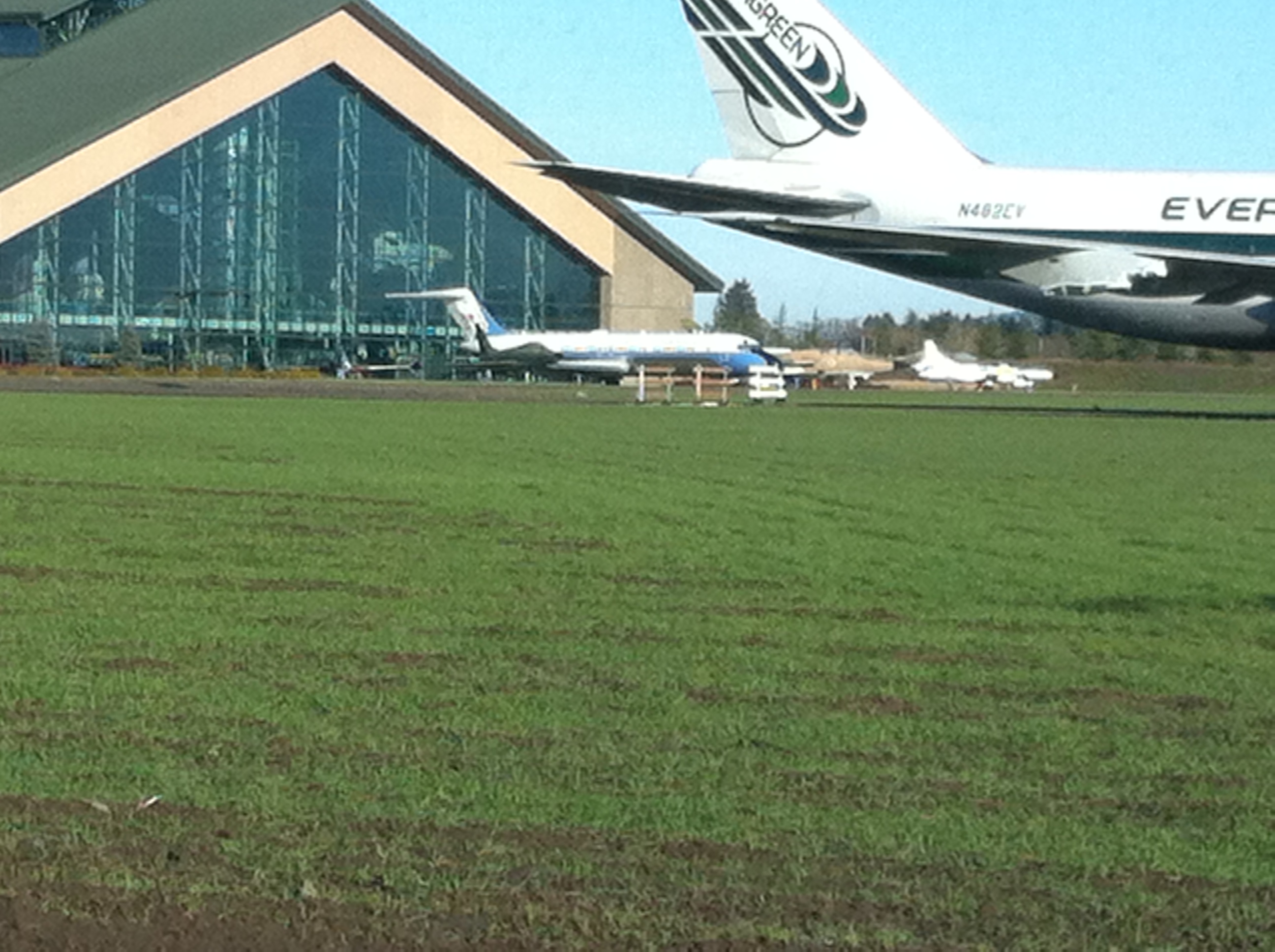

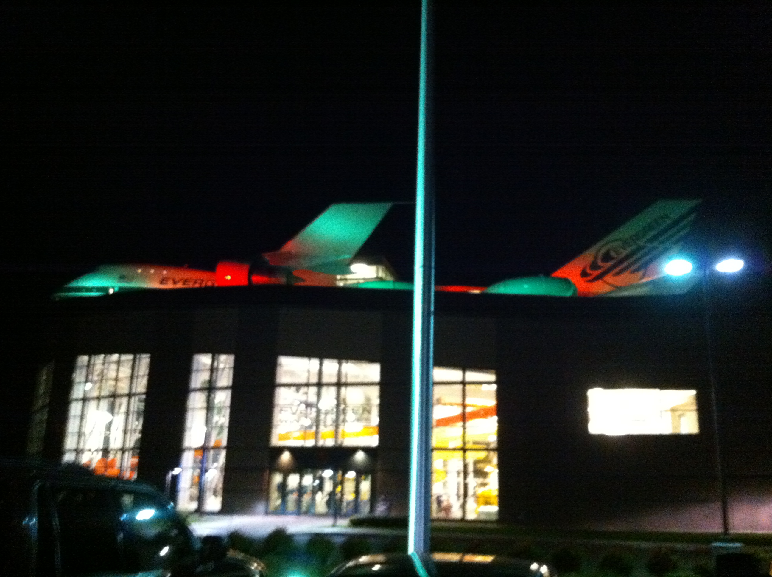

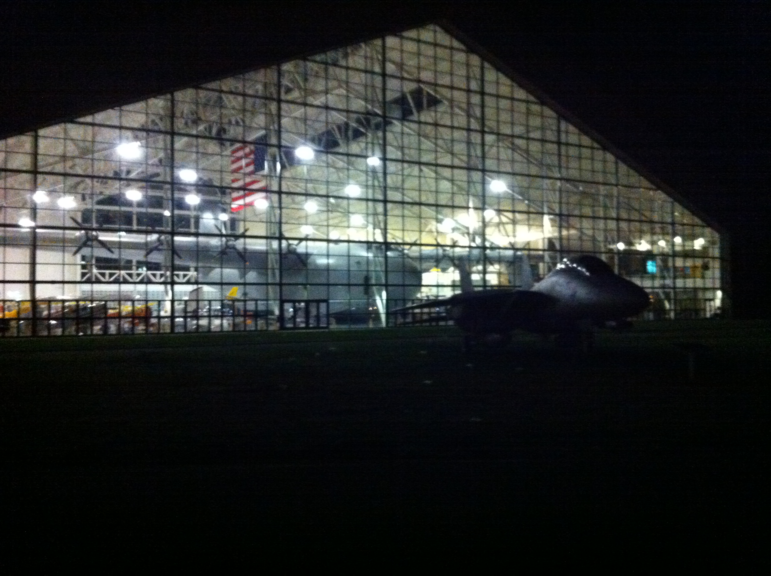

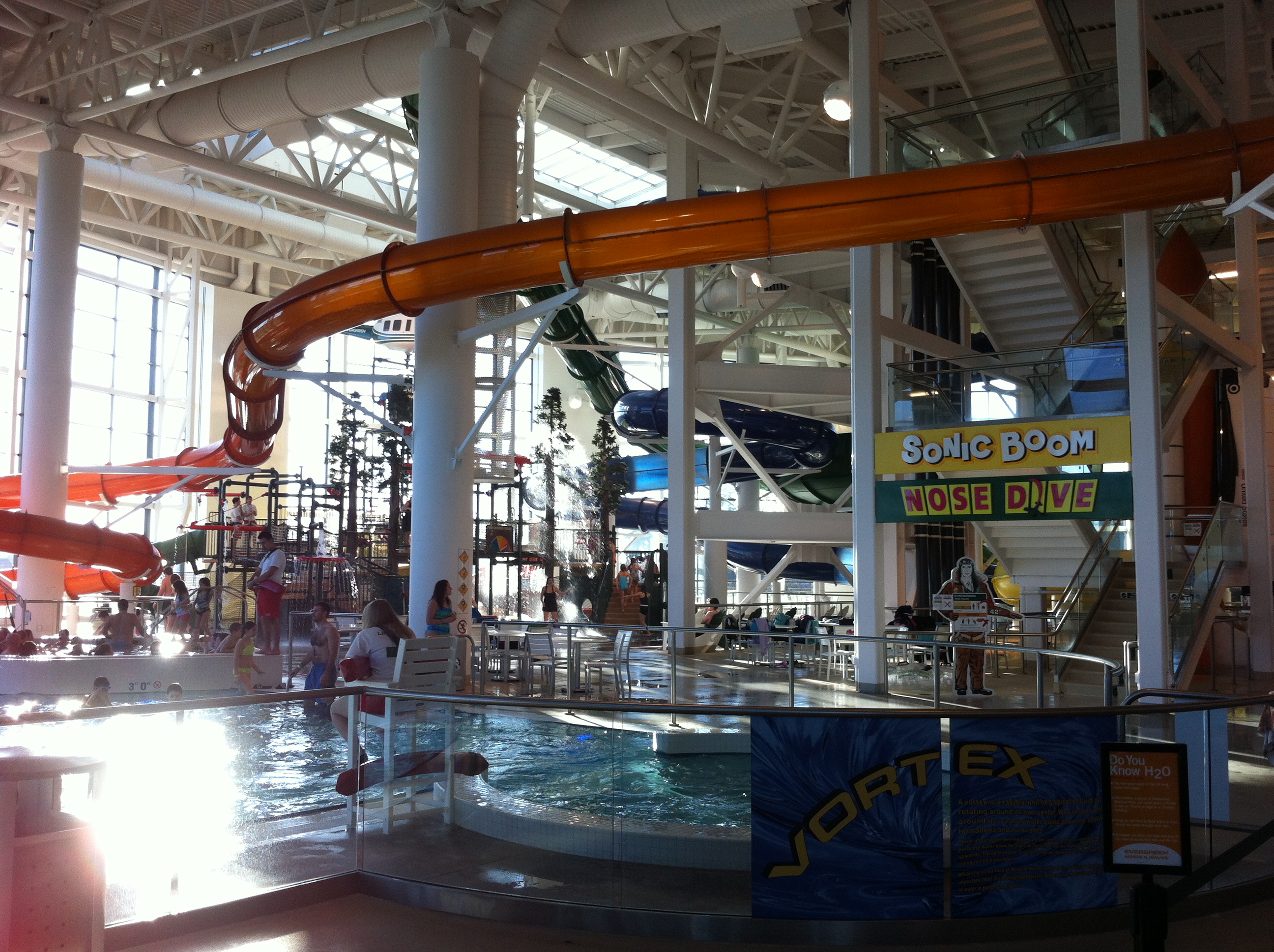

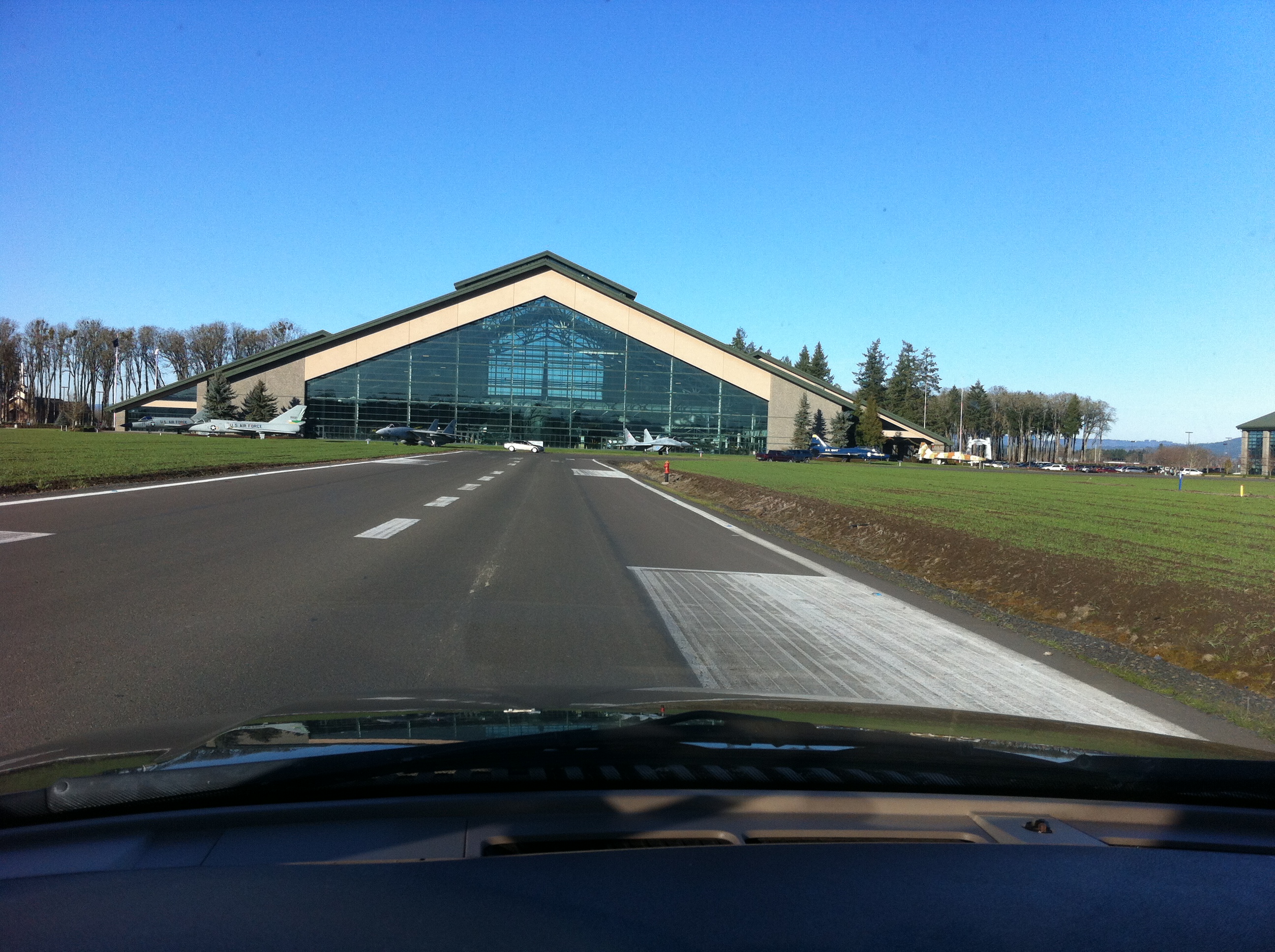

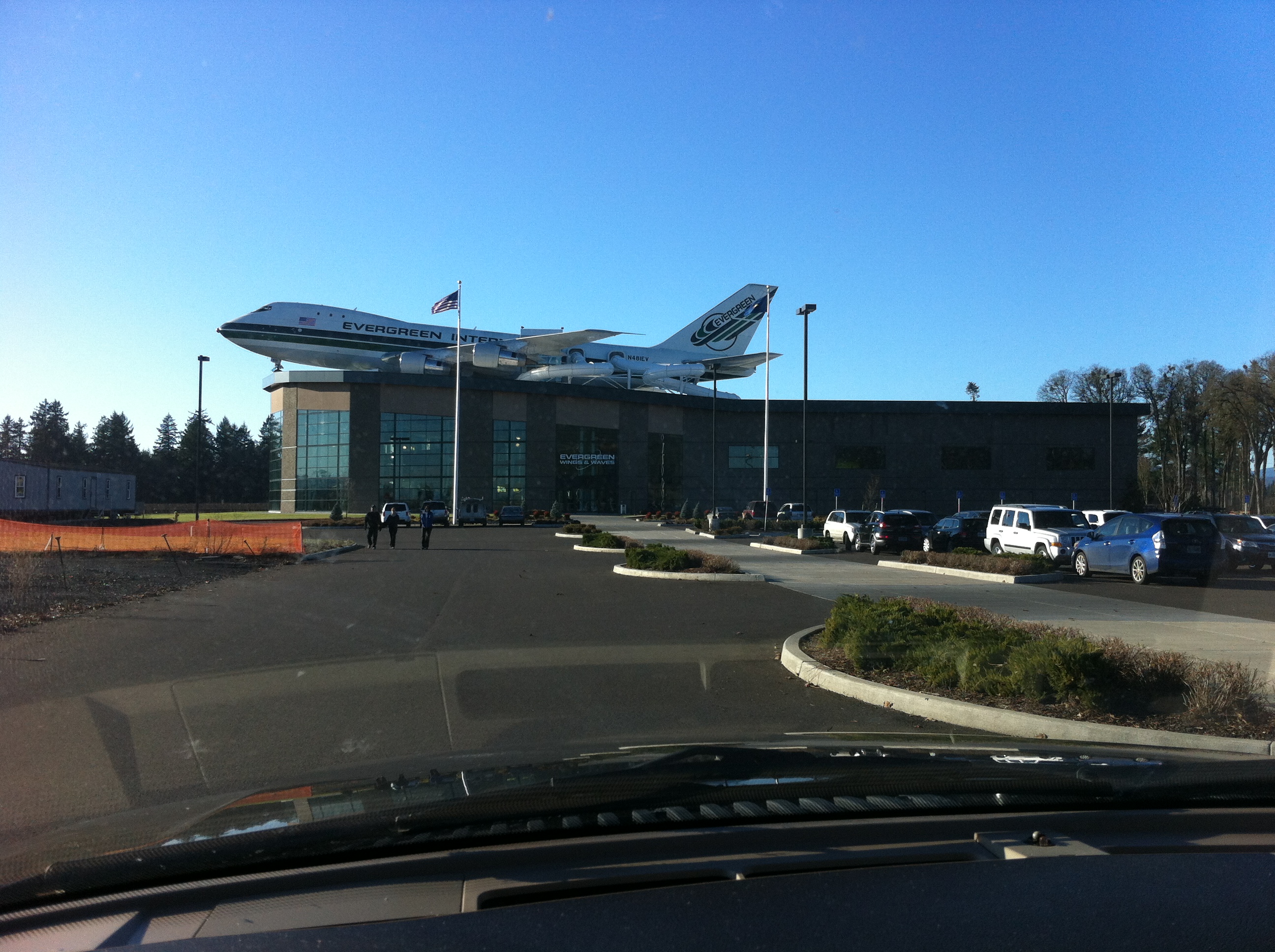

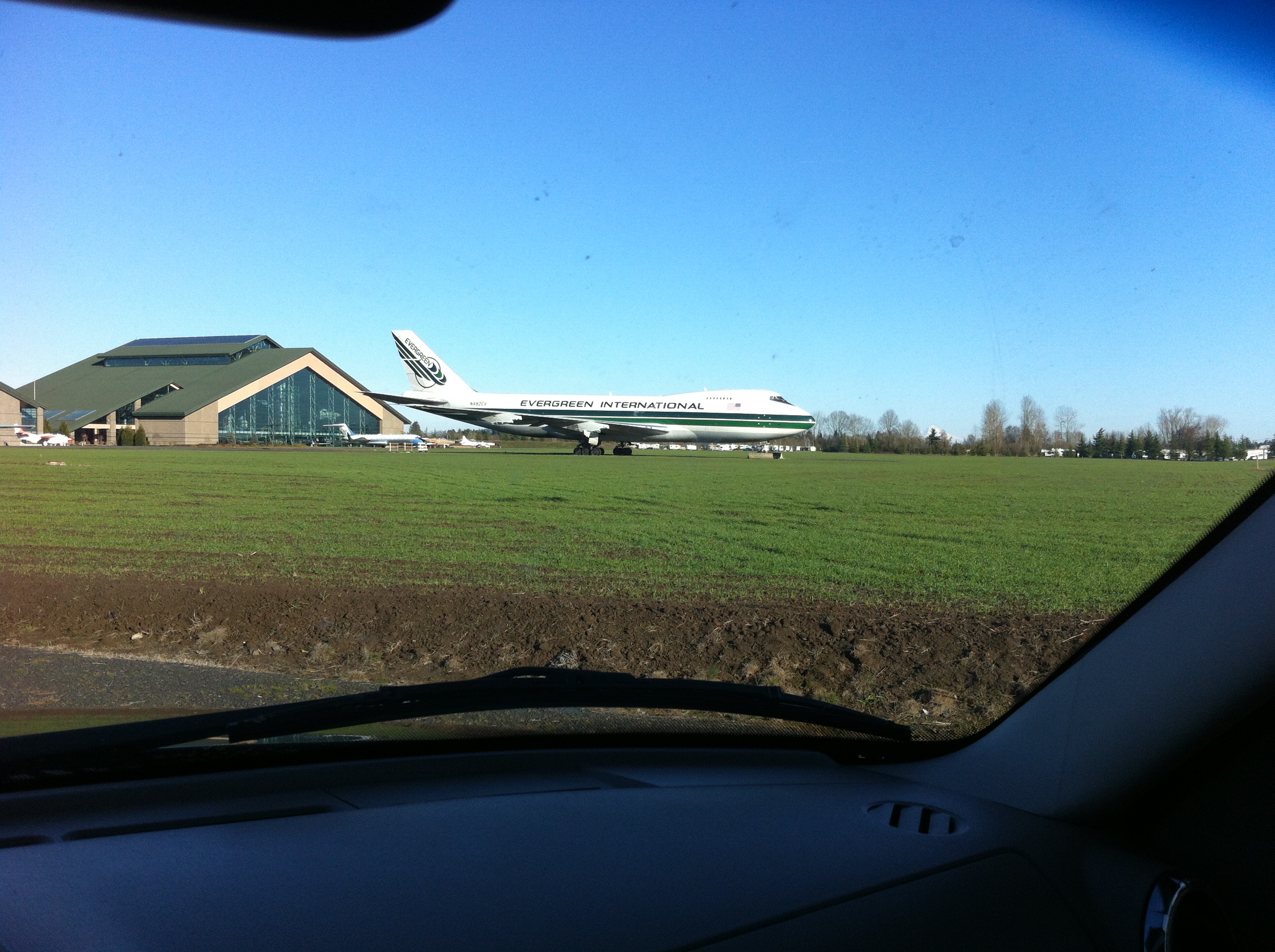

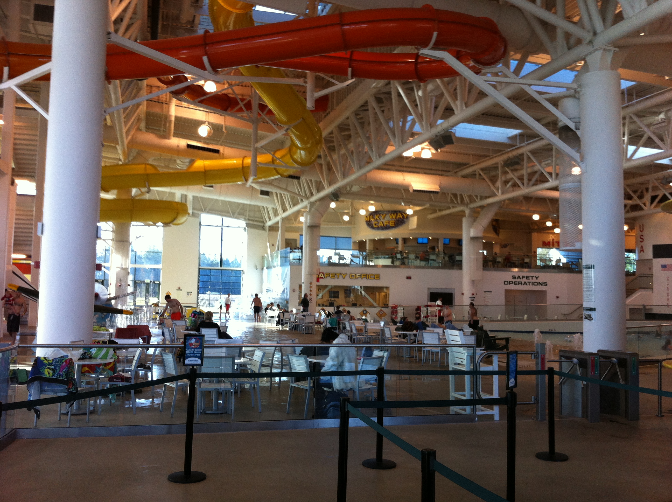

Here are some pics of the Museum and Water Park. We are so blessed to have such a great facility here in Oregon. The Evergreen family works hard to promote great family and biblical values along with their passion for aviation. Truly a great place to visit. If you live in Oregon or S. Washington you should take the time to visit.

Our former paved runway and availability of AC power attracted many flyers with smaller airplanes, so for most of our members the altitude restriction is easy to deal with. For the few of us flying larger aircraft it is more difficult to comply. I do have telemetry with an altimeter in my 60cc Extra which helps a little.
By the way, the Extra flies great! It makes me not wanting to fly any of my other planes anymore. The RE2 pipe seems less peaky than the ES composite pipe I had on the Edge and I am happy with the amount of power I get out the DA60.

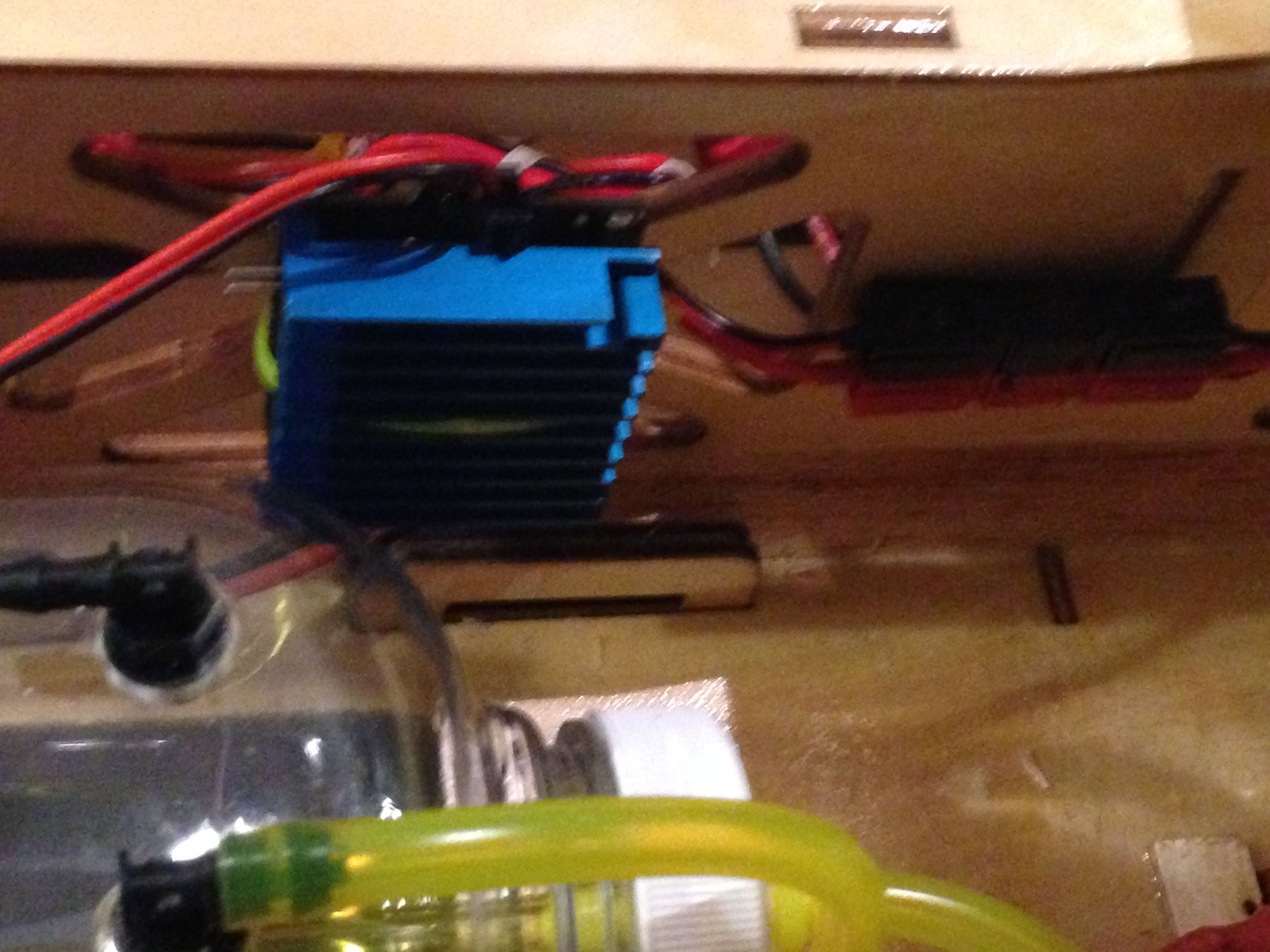

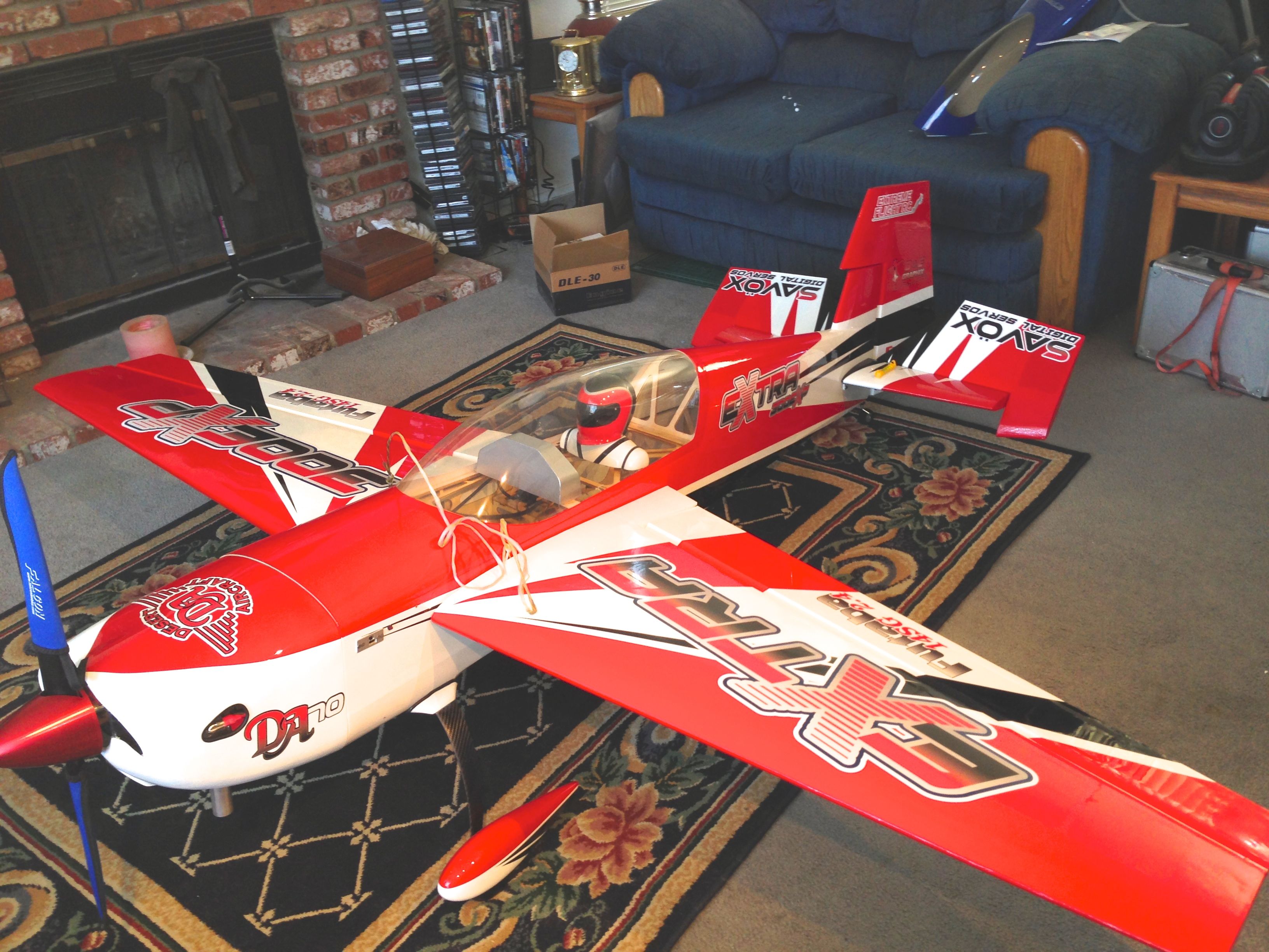

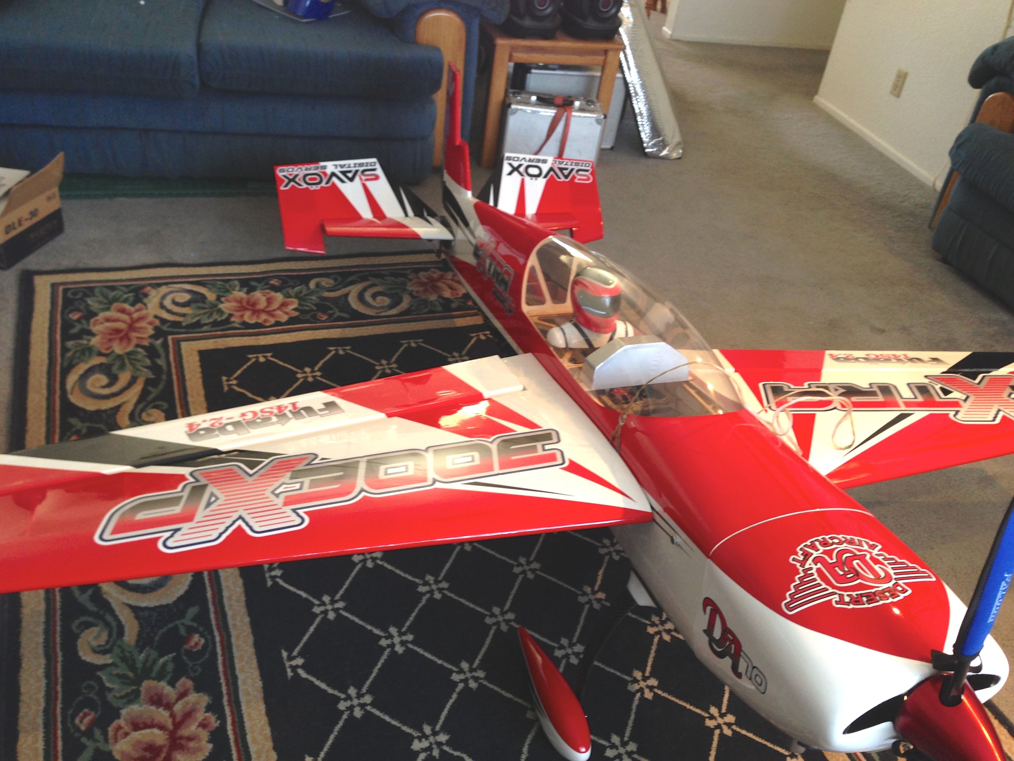

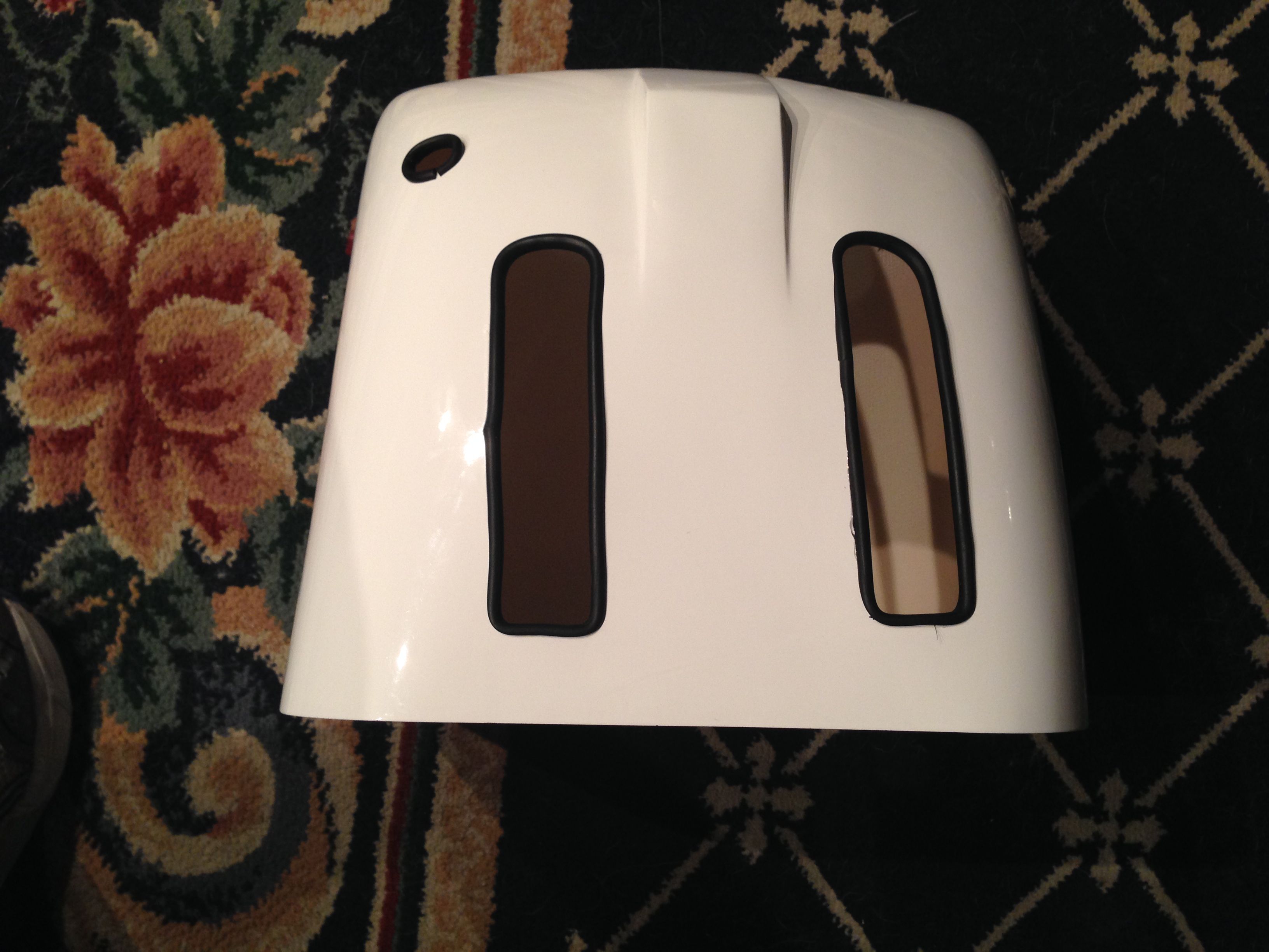

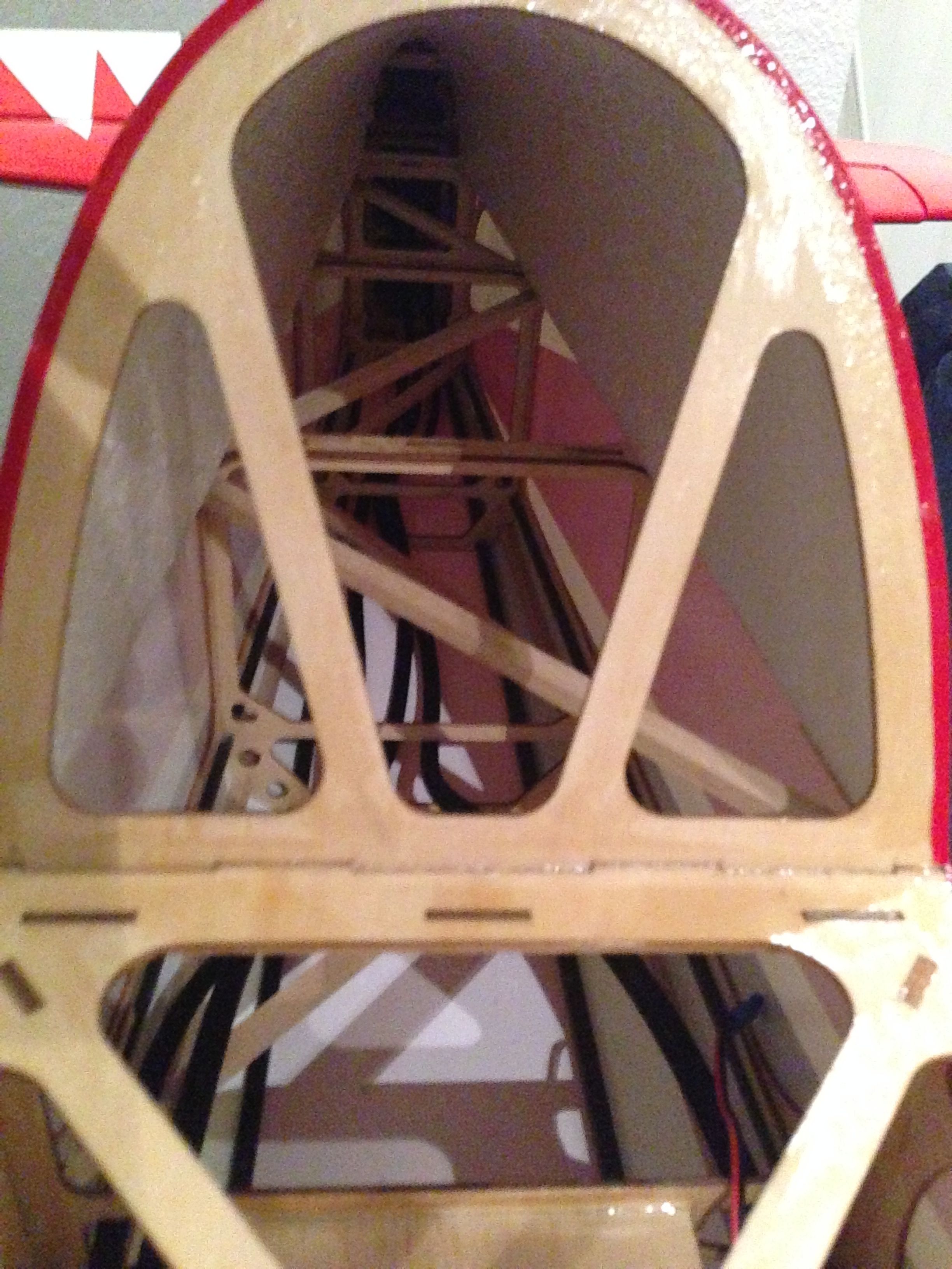

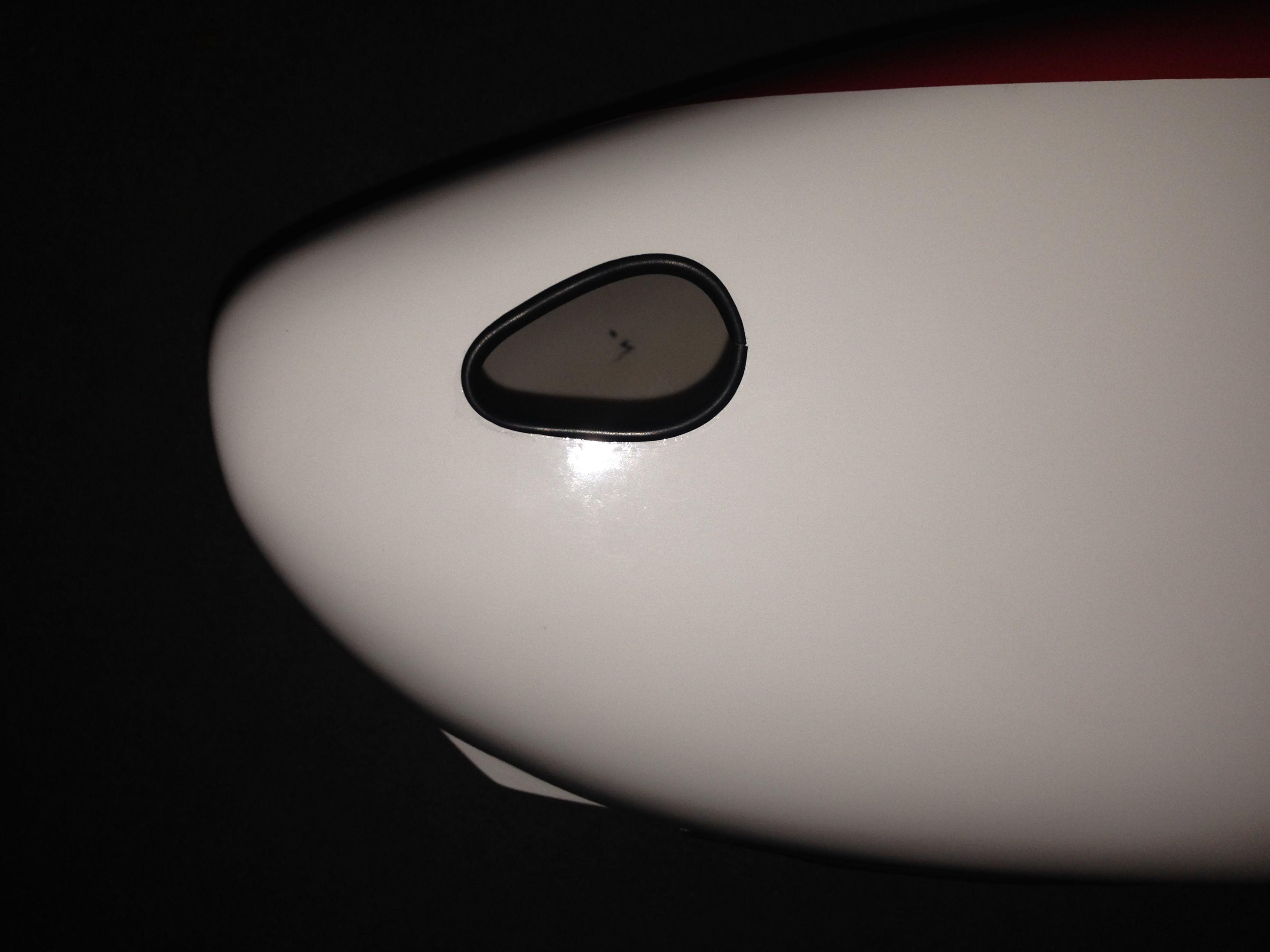

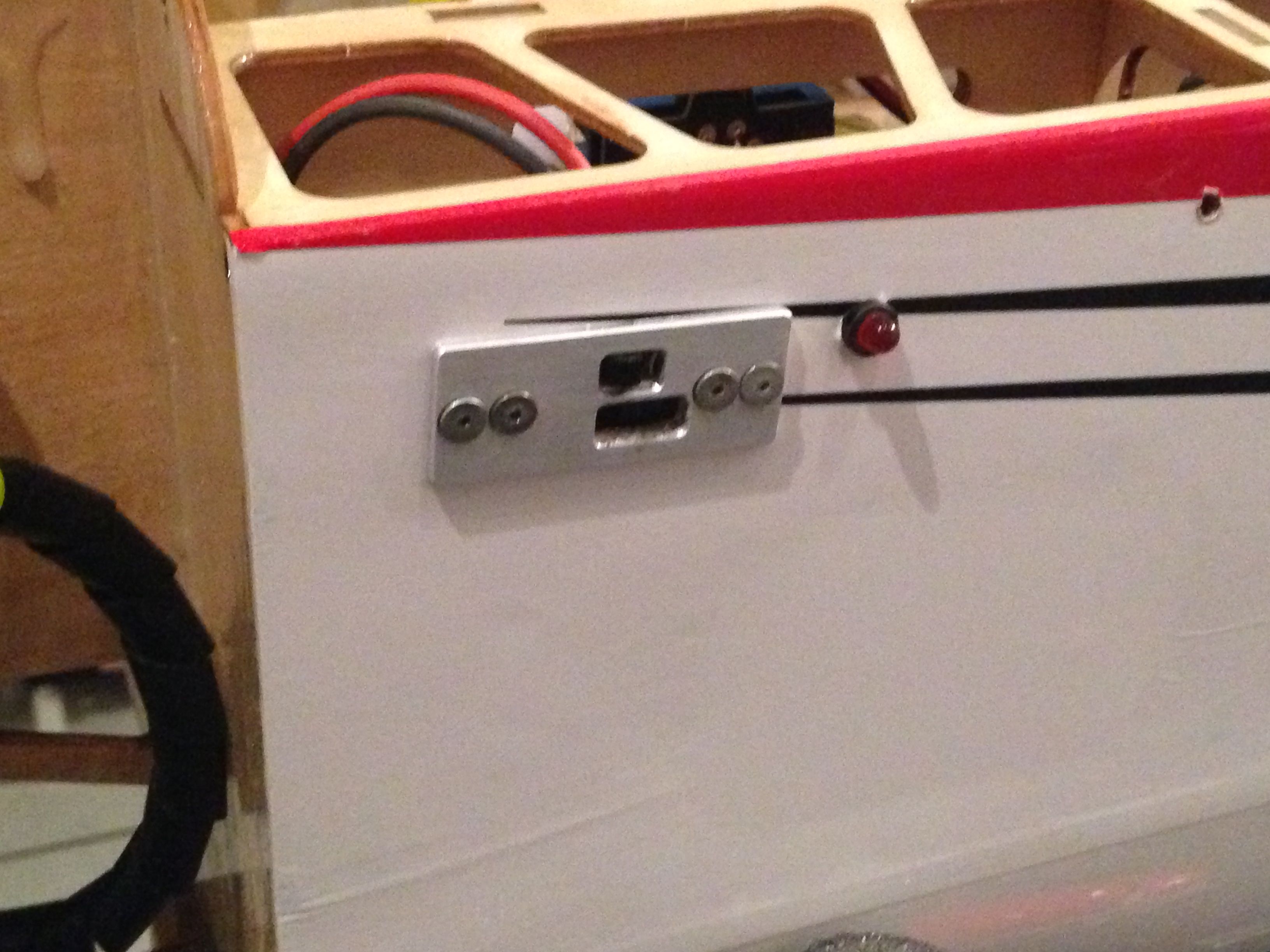

Been a while since I've commented on my build. I finally have the cowl cut and complete. I decided on how to mount the pilot and the instrument panel. I have the regulator and switch for the DA 70 ignition installed.

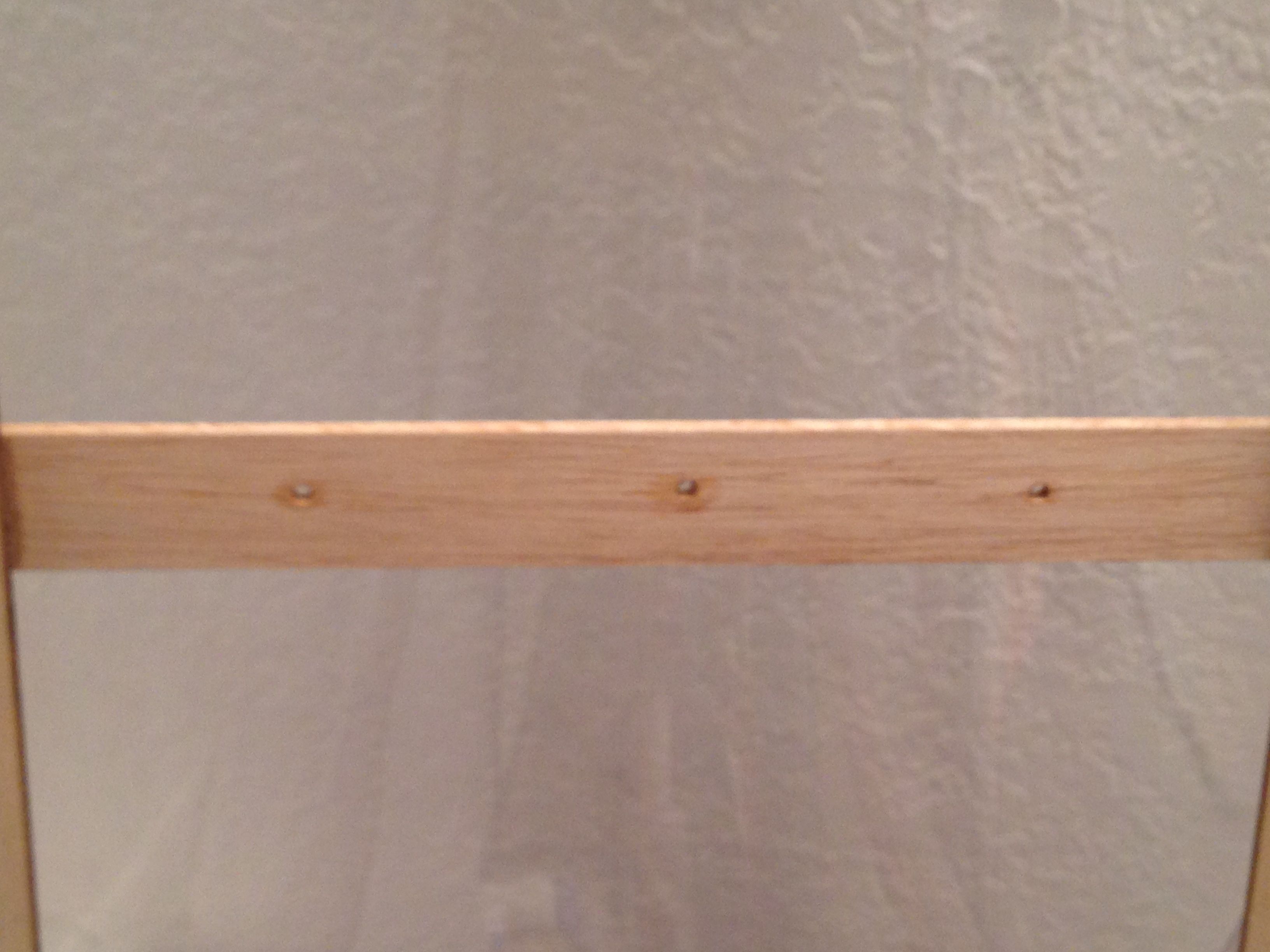

For the instrument I decided to secure to the canopy with 4/40 blind nuts. I added a piece of wood onto the the canopy and glued one to the bottom of the instrument so it can be removed when needed.

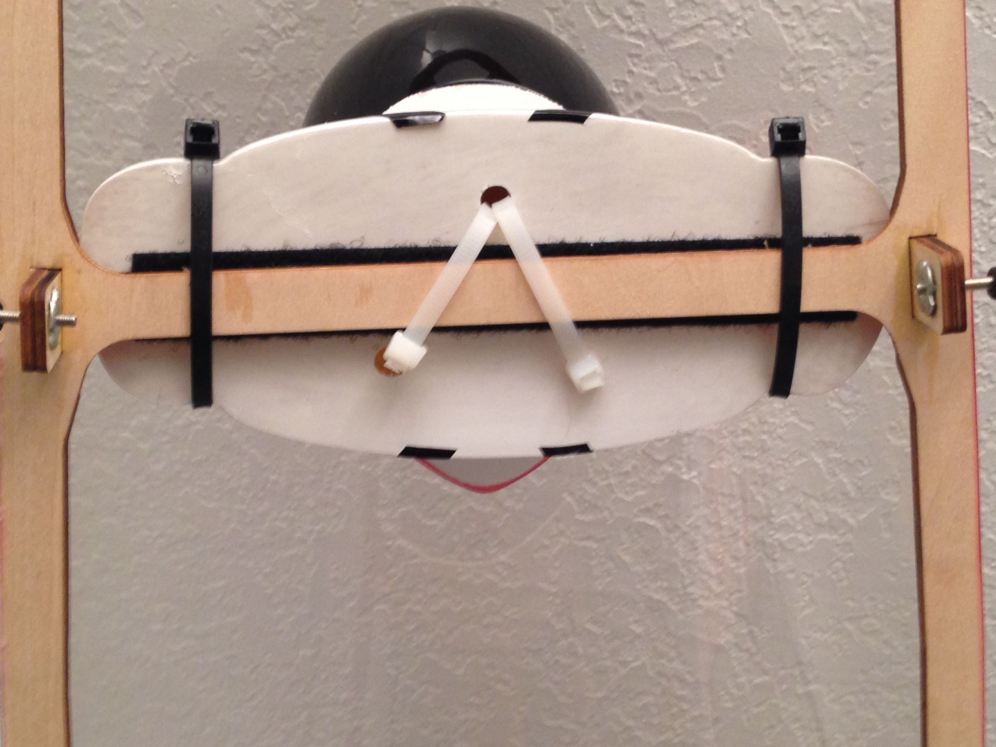

As for the pilot. I use black tie downs to make it look like seat belts. I also added velco to the bottom of the pilot figure and ran two white tie downs to secure the underside of the pilot figure to the wood.

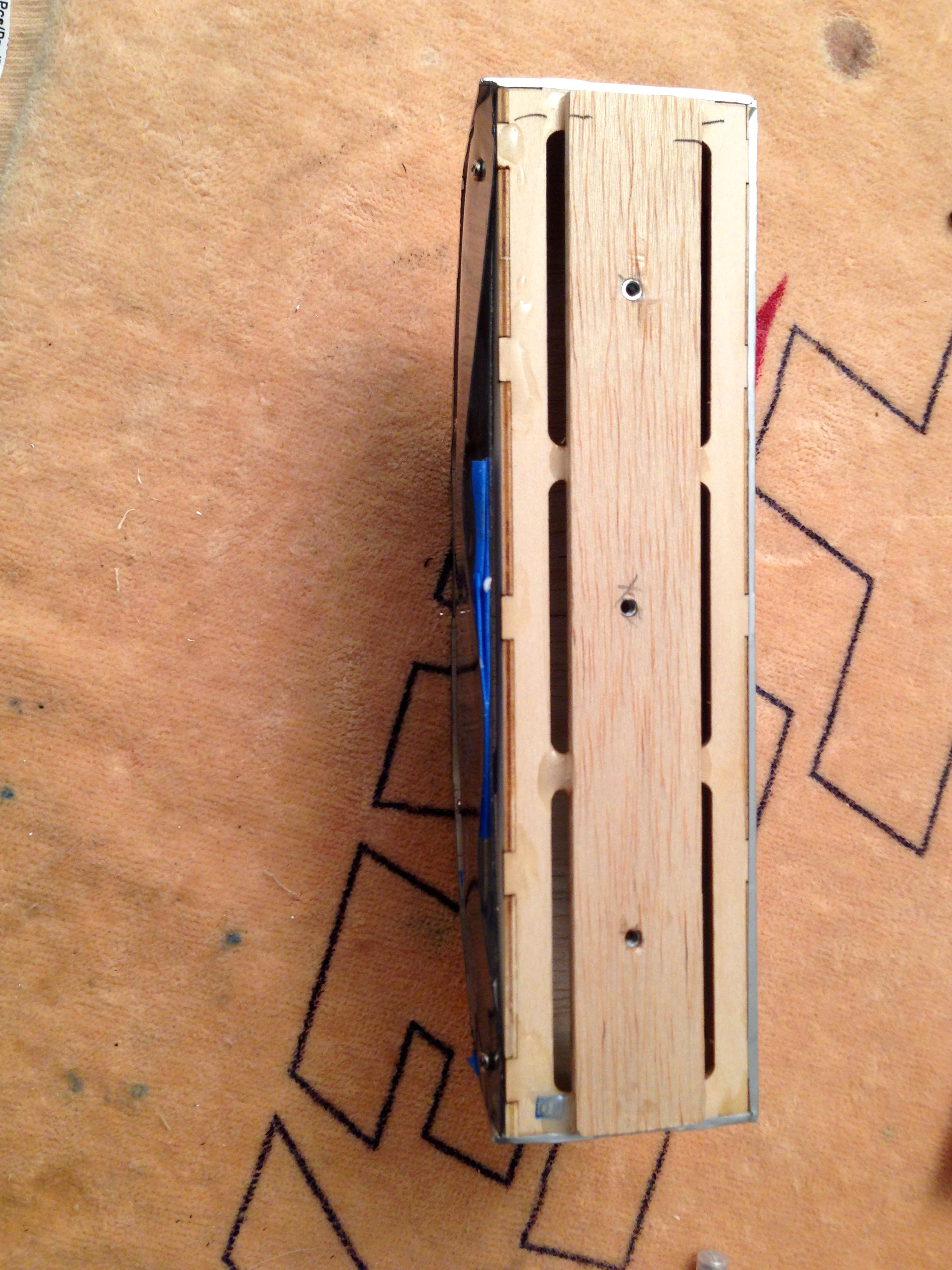

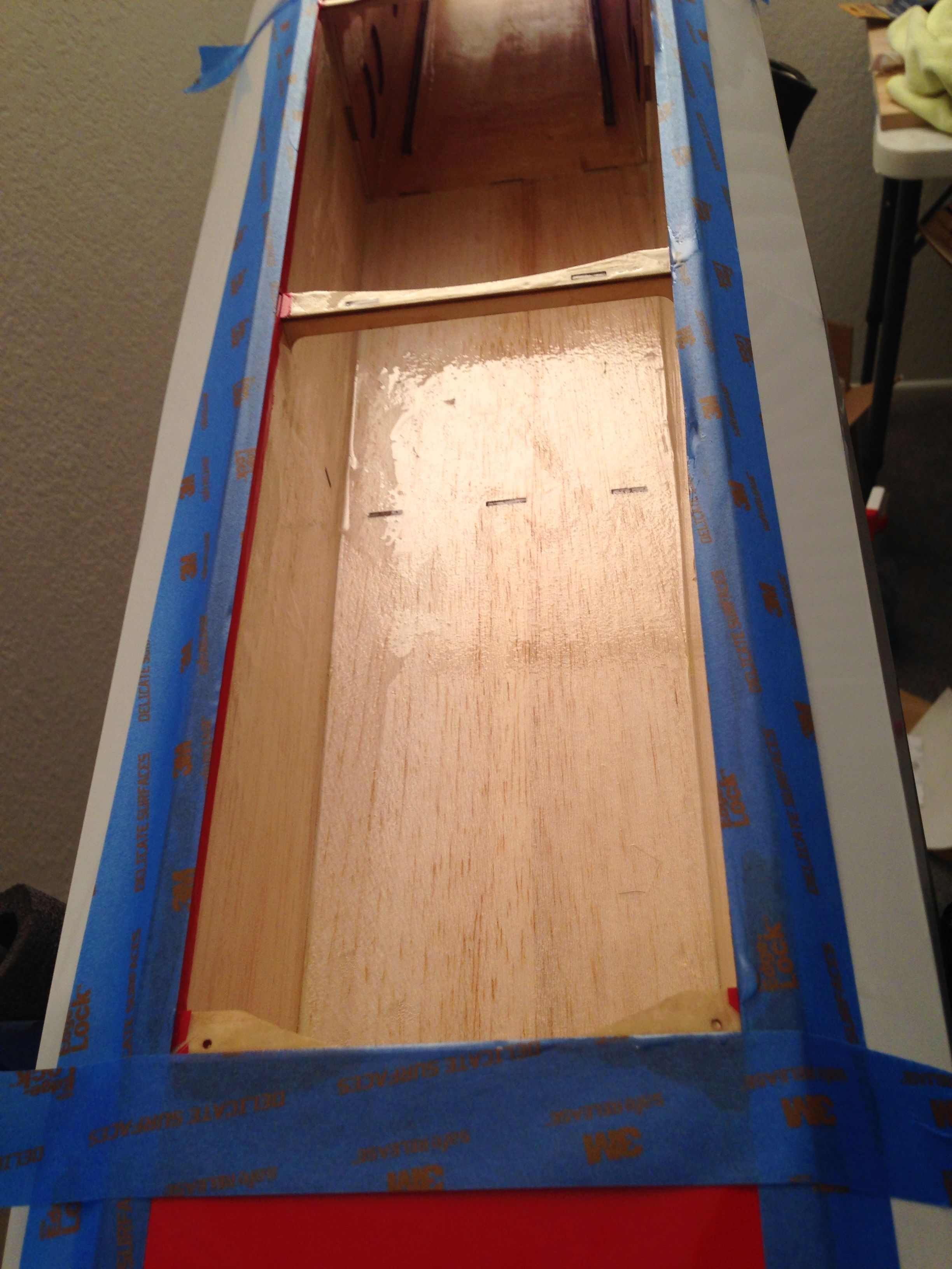

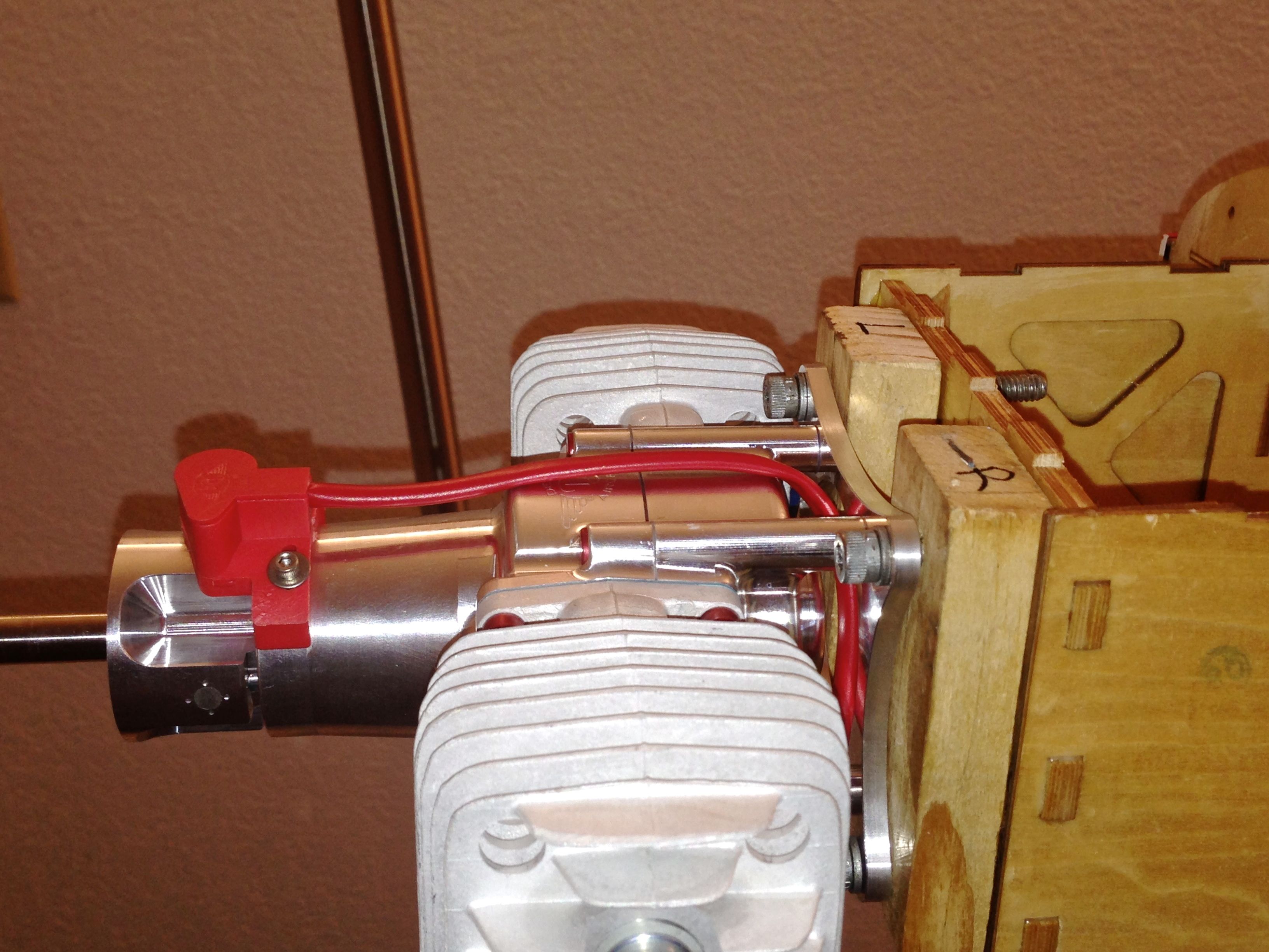

As for the engine box, I glued the top in place with epoxy mixed with milled fiberglass. Last night I installed the tie-stock with the same adhesive.

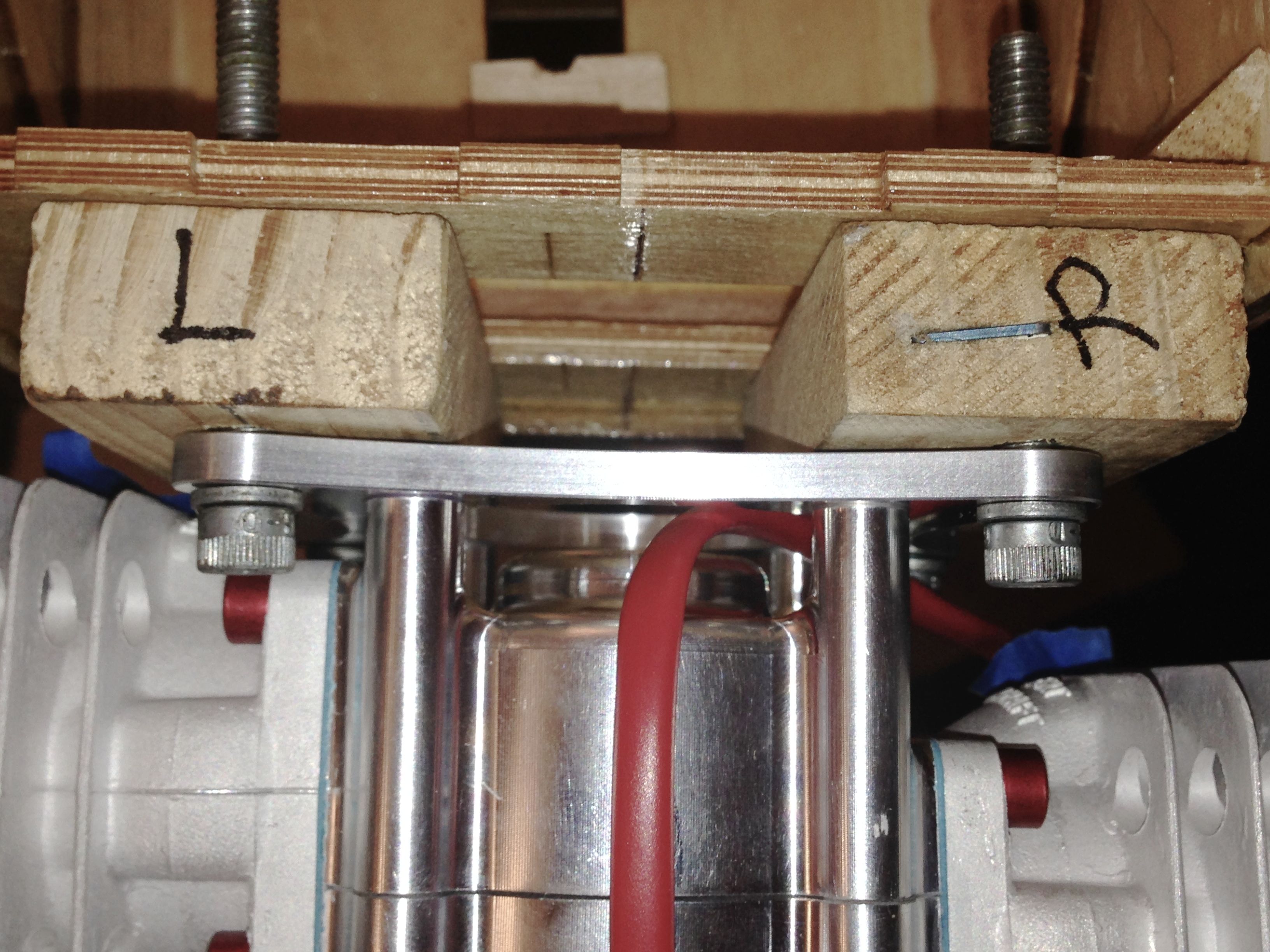

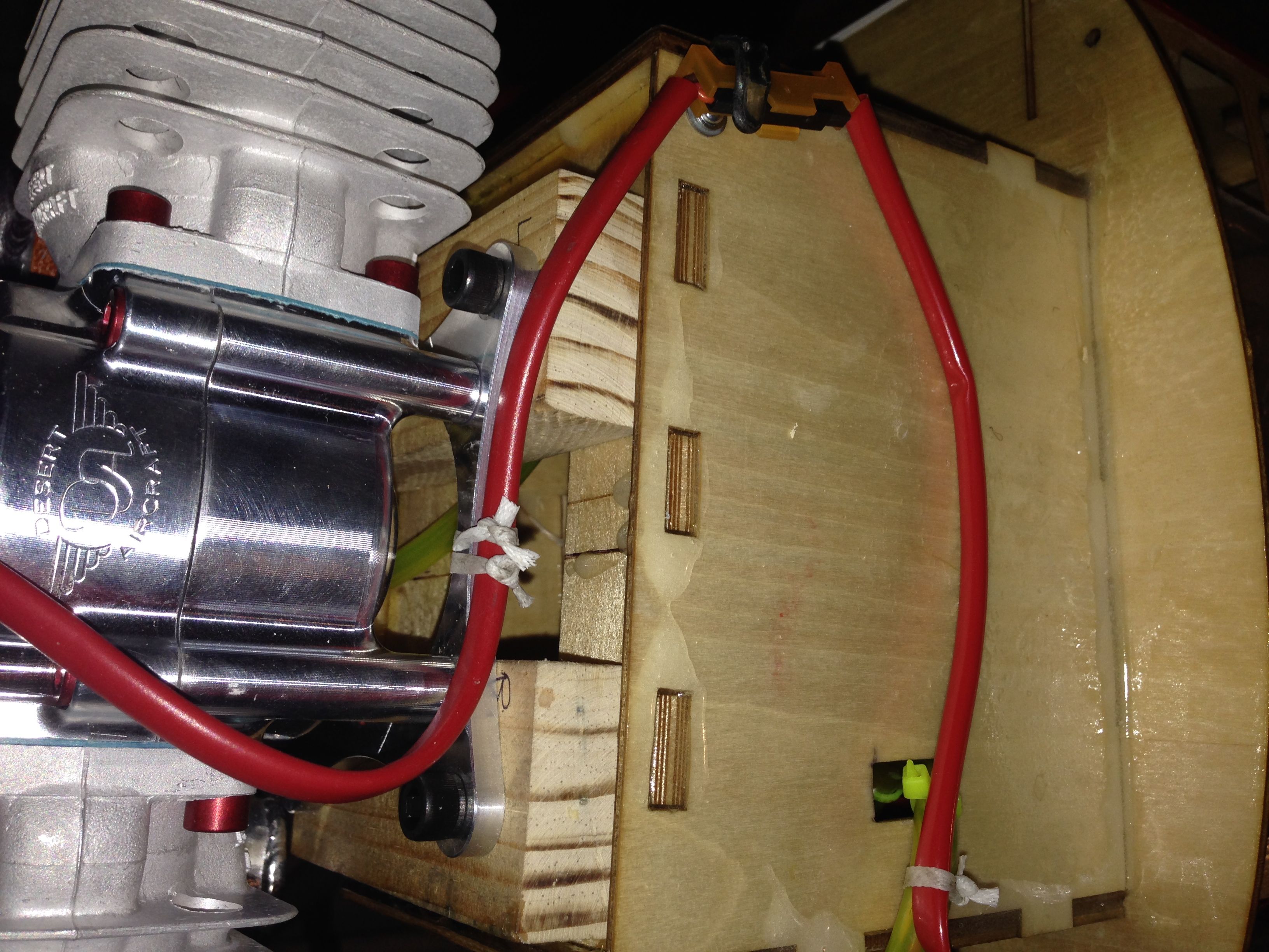

DA 70 fit check
I cut a small hole on the top of the engine box to run the power from the ignition to inside the Extra.

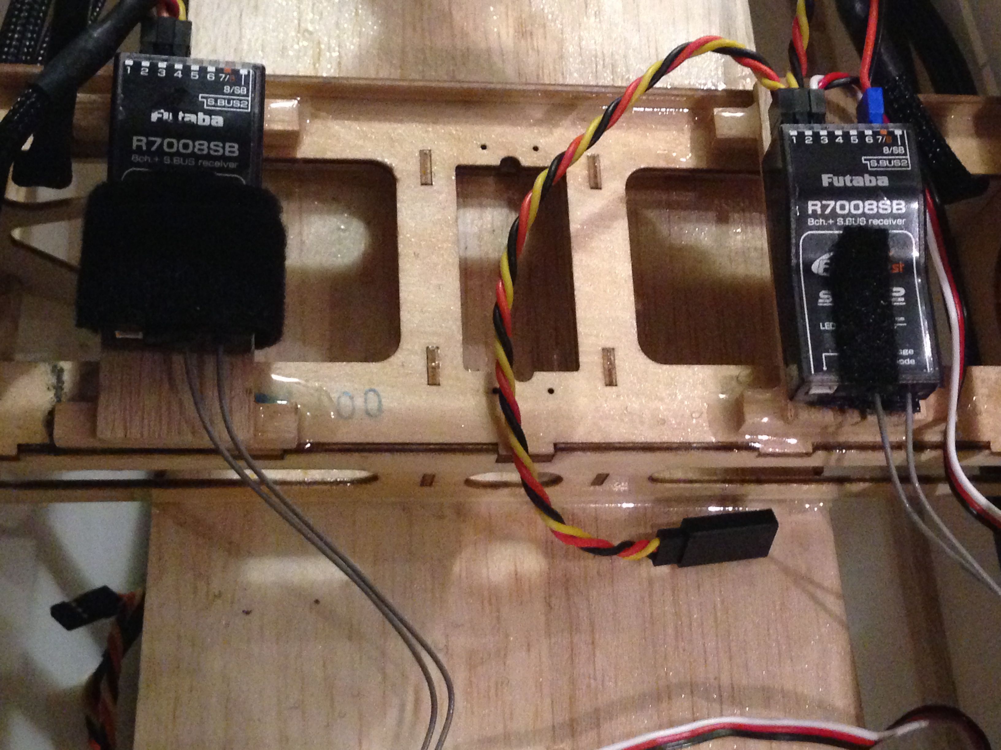

I have the receivers mocked up.
I'm going to install the cowl, prop, spinner and canopy and check the CG before I install the two flight pack batteries and switches.
It's finally getting close...lot of work to get his in the air. My first big plane, big for me anyway.

All I have left to do is install baffels and balance the Extra, which will require mounts for the batteries and installing the Fromeco switches; then I can start the DA 70.
I hope I can test run the motor this weekend

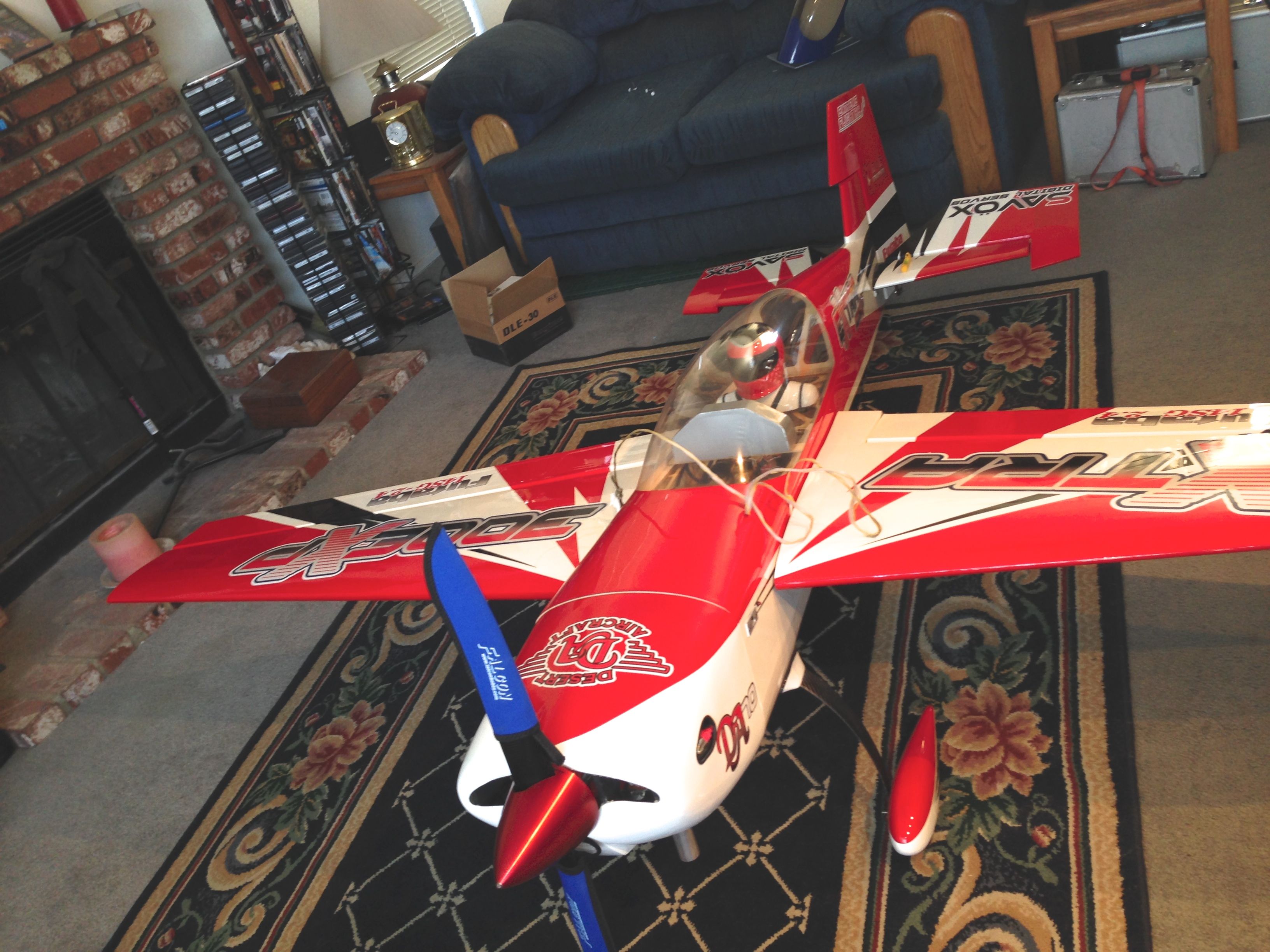

Finally at the stage to balance the 300. I did a balance today and found out I need t place the batteries up front by the engine box for it to balance on the wing tube. I should have them installed before the weekend.
