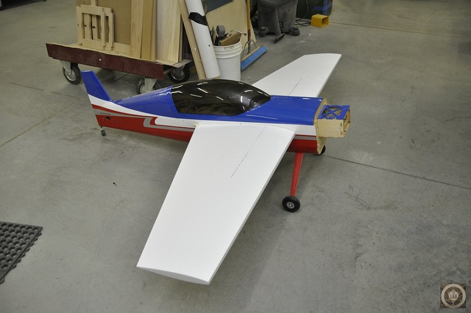

Getting back to work, I got a few things done tonight:
- Removed can tunnel to inspect for damage and reduce a couple of ounces.
- Removed all damaged areas that need to be replaced (mainly just some parts in front of the landing gear).
- Repaired all internal cracks.     Mostly just the non structural  sheeting above the landing gear, one partial former (F-2) and one crack by the rear anti rotation pin.
- Repaired firewall
- Replaced wing tube phenolic
- Fit wings and ready to glue in hard points in the AM.

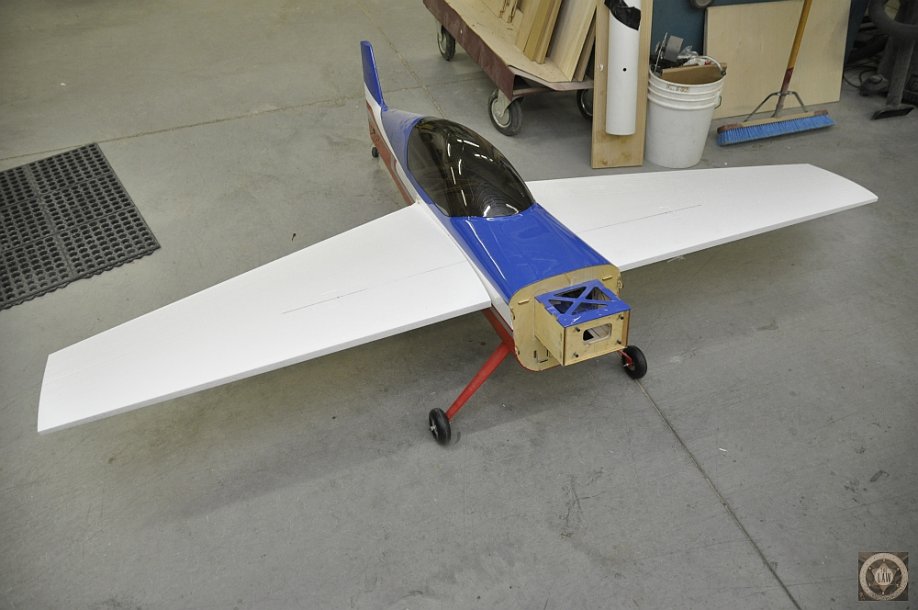

Terryscustom
Time to get back to work on this project. Sorry the pics are all missing but the basic rundown is my 91" EF had a little smack-down and I picked up a one-flight old 88" EF Edge. The wings for the edge went to a friend and I'm making my own. The edge will have a 70cc twin on the nose. Since this is my third 88" Edge I know what to expect and they are an amazing fun plane to fly.
So, the only mod I'm making to the Edge is:
- A different airfoil on the wing that has a little broader range of CG
- I'm adding a little bit of root and tip chord
- Wingspan will be 90" with 250sq. more wing area.
- Stripping tail feathers for a new scheme on wings and stabs.

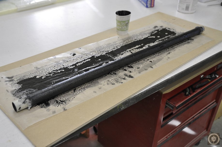

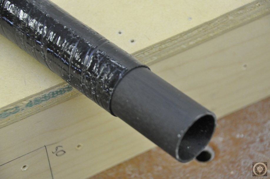

For starters, I'm making a new wing tube sleeve......going to cut foam in a little while when the LAW shows up.

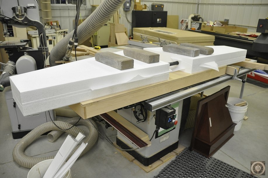

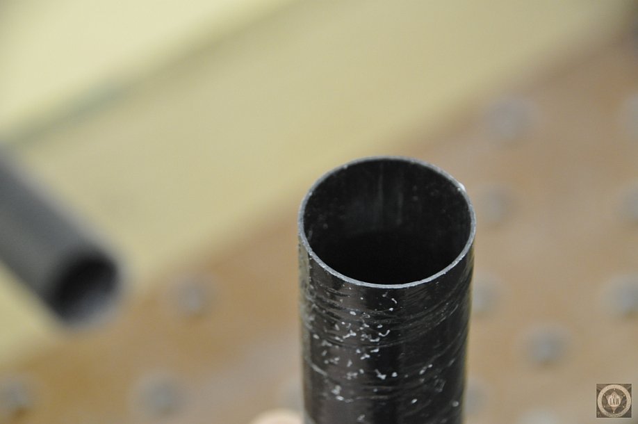

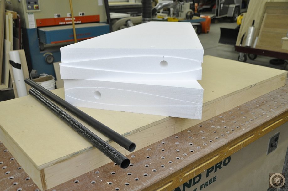

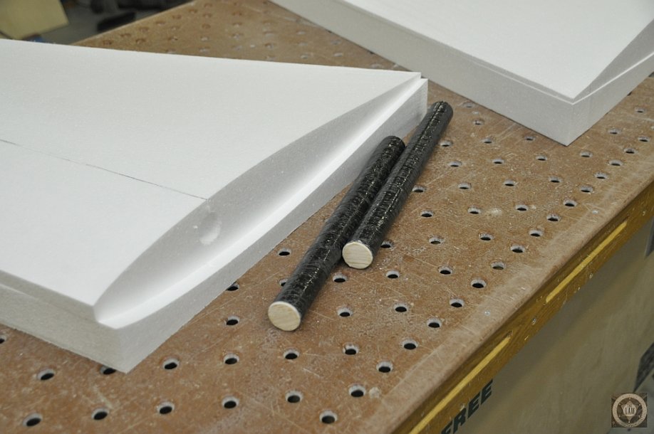

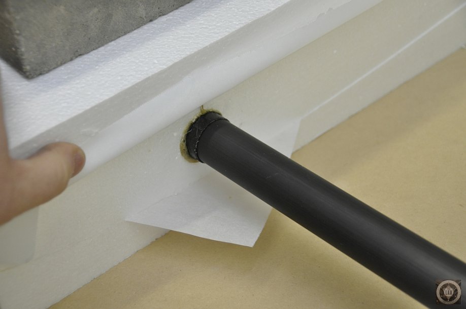

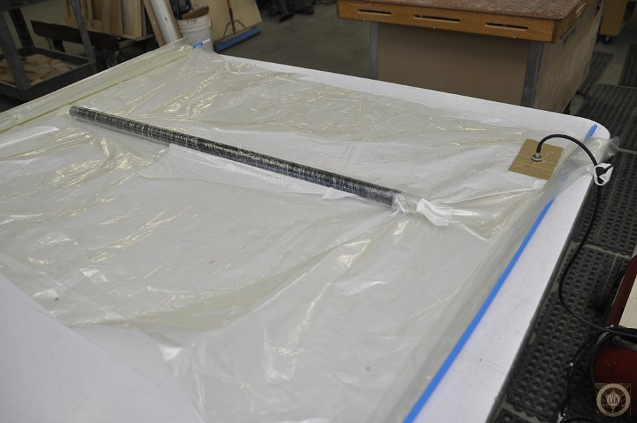

Terryscustom
Wing tube sleeve came out perfect! @thelaw helped me cut foam and I installed the fresh phenolics into the wings to dry for the night. This Edge will be a bad MOFO.
