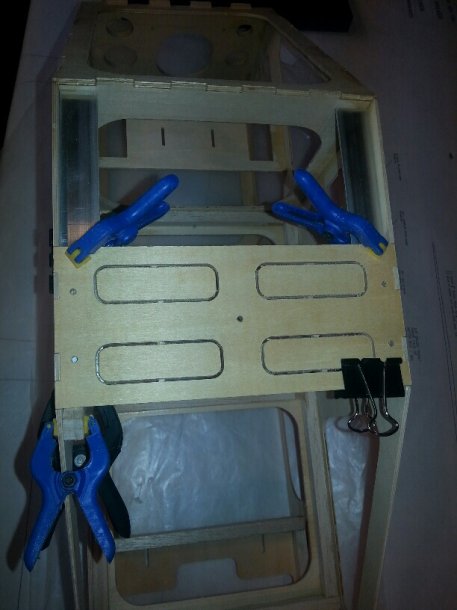

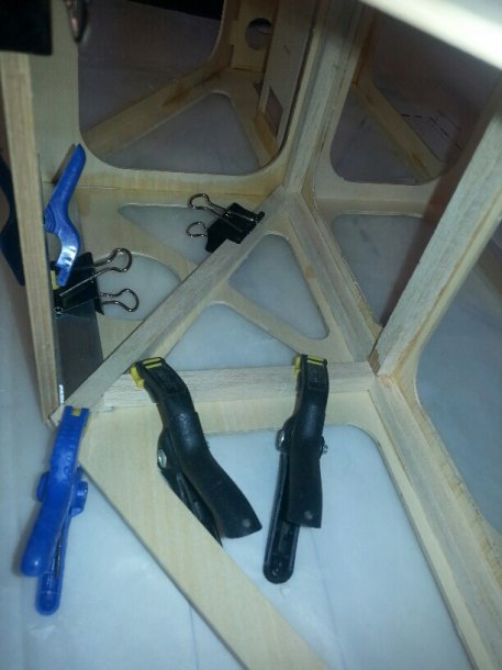

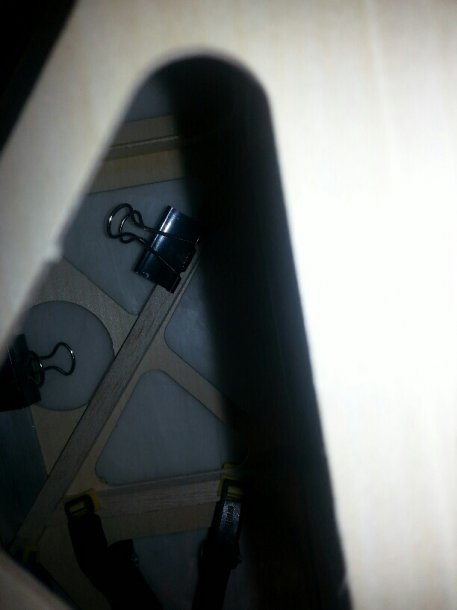

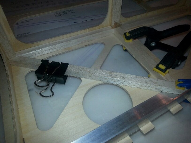

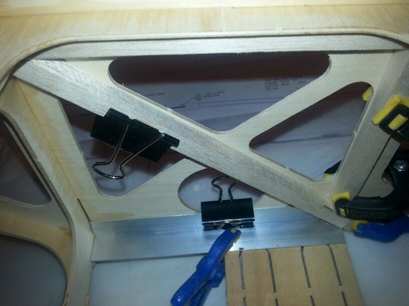

Okay I didn't do a whole lot tonight other than look at the landing gear plate and trying to decide if I should use oak or aluminum angle. Well I decided I'm going to deviate from the manual and this came down to two reasons why. The first one is I didn't have any oak, but I did have aluminum angle. The second one is I don't always have the softest landings and I really don't want to knock out the gear if I dumb thumb the plane when trying to land.
Here is the plan that I'm going with. I have 3/4" X 1/16" aluminum angle that I will run under the the landing gear mount up to F2 I will scuff the aluminum with 80 grit sand paper and epoxy it in place instead of using 4-40 bolts and bolting it to the side of the box. I got this suggestion from Terry and that is the way he did it on the Viper. Then I plan on running 3/8" square balsa at an angle and then a piece vertical to reinforce that area. I will do a very thin coat of epoxy on the balsa and then harden with CA.

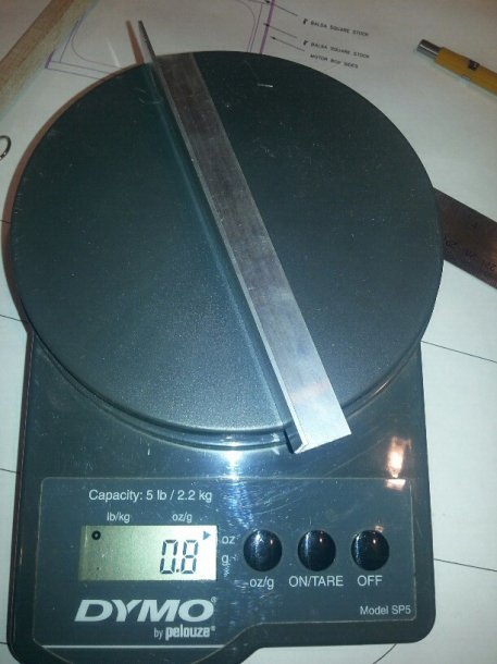

As you can see in the picture, using the aluminum angle will be about 1.6 ounces for the two pieces, I don't know if oak would make much difference in weight.
