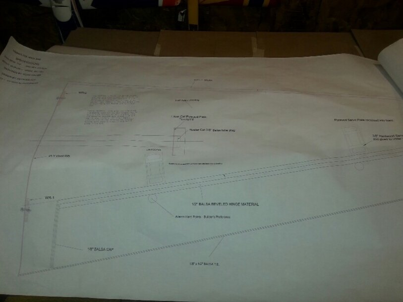

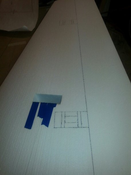

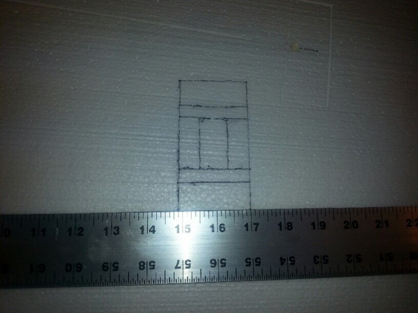

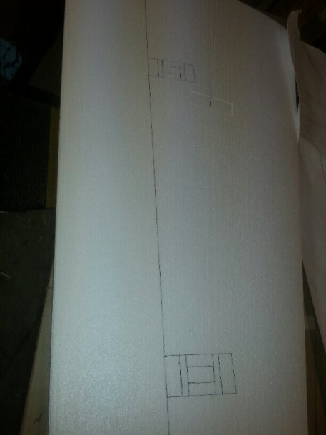

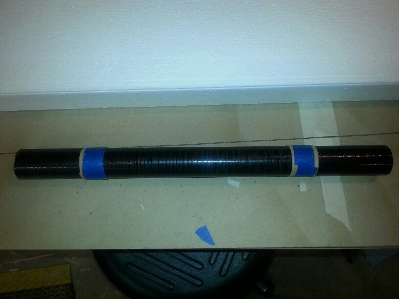

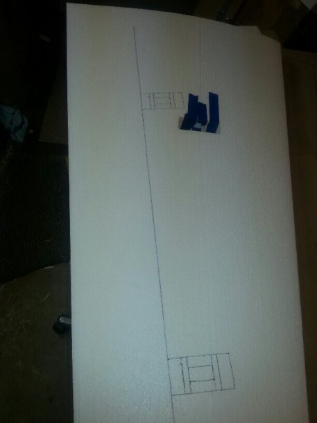

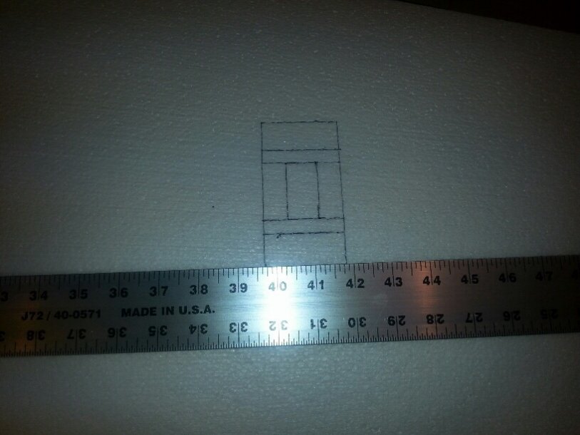

Started laying out the left wing tonight. I will get the servo pockets cut tomorrow night and the sleeve glued in. The sleeve is smaller than the hole in the foam so I'm going to wrap part of a paper towel tube around it in a couple of places. I did a test fit and it and it fits snug like it should. I will use Gorilla glue to glue it in and when it expands everything should be good.
I took a picture of the servo plates and my ruler that I can refer back to after the wing is sheeted so I know where to cut the hole for my servo. I made a template of the servo plate out of see-temp so I can just lay it down on the sheeting so I can cut my hole in the right spot.
Looks good. That's what I did. When you glue the plug end in the phenolic I suggest drilling a pin hole in the plug. I am having a difficult time putting my wings on. The tube fits perfect but there is no way for the air to escape and the wing wants to shoot off. I need a very loooooong 1/16" drill bit.
I plan on drilling a hole in it, I did on my stab socket ends. Do you have a long piece of brass tube that is small in diameter? If you do you can sharpen one end of it and drill through your socket end, or solder a small drill bit to it and use it to make a hole that way.
