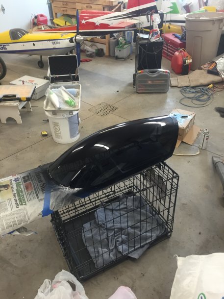

Tried my luck at tinting a canopy thanks for all the help you guys
