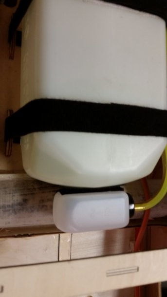

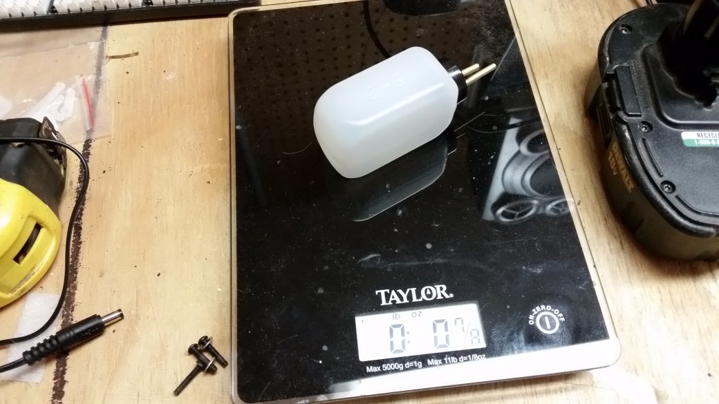

So, there is a thread on this forum about header tanks or vent tanks (maybe both). And it was brought up about having a smaller tank to catch fuel from the vent line. I for one get irritated about fuel getting on the fuse after every flight. Tried different methods with the vent line but it seems to never work. Im thinking with IMAC flying with the number of snaps, rolling maneuvers, inverted stuff,etc the vent does not get a break. So I went over to see Tom at TNTLanding gear and purchased a 2oz fuel tank. With a weight of under an ounce I think it is worth a try. The lower line is for the pick up on the bottom of the tank. It should siphon any fuel in there back into the tank. The vent is terminated in the center of the tank and should hopefully not pick up any fuel. The down side is during filling I will need to look through the canopy to find out when the tank if full.

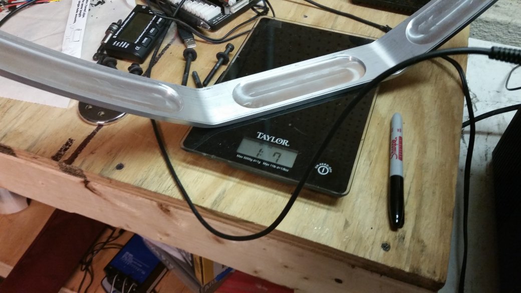

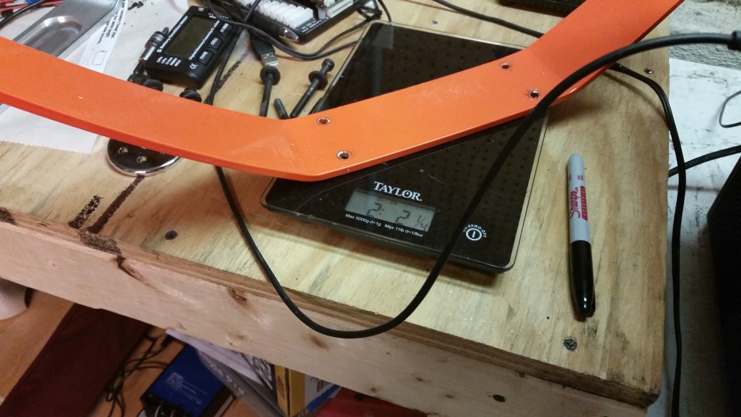

I have been thinking of changing up my landing gear to something a little lighter. I like the weight of carbon fiber but never really been a big fan as on crack could put you out of flying for a contest. And to me they are a little to stiff. So decided to call up Tom at TNTLanding gear and have him make me up a gear. He bent one up for me and milled it to lighten it up some. There is definitely a weight savings on his gears. There may be some more flex to it than the stock gear but I think I should be ok. This plane lands easy. He wants me to test it out for him and let him know what I think. He can do several different things to his gears to lighten them up or just keep them unmilled. Looking forward to this experiment has rumor has it Graphtec may not be an option in the future. I did end up cleaning up the gear and painting it orange like the stock gear.
