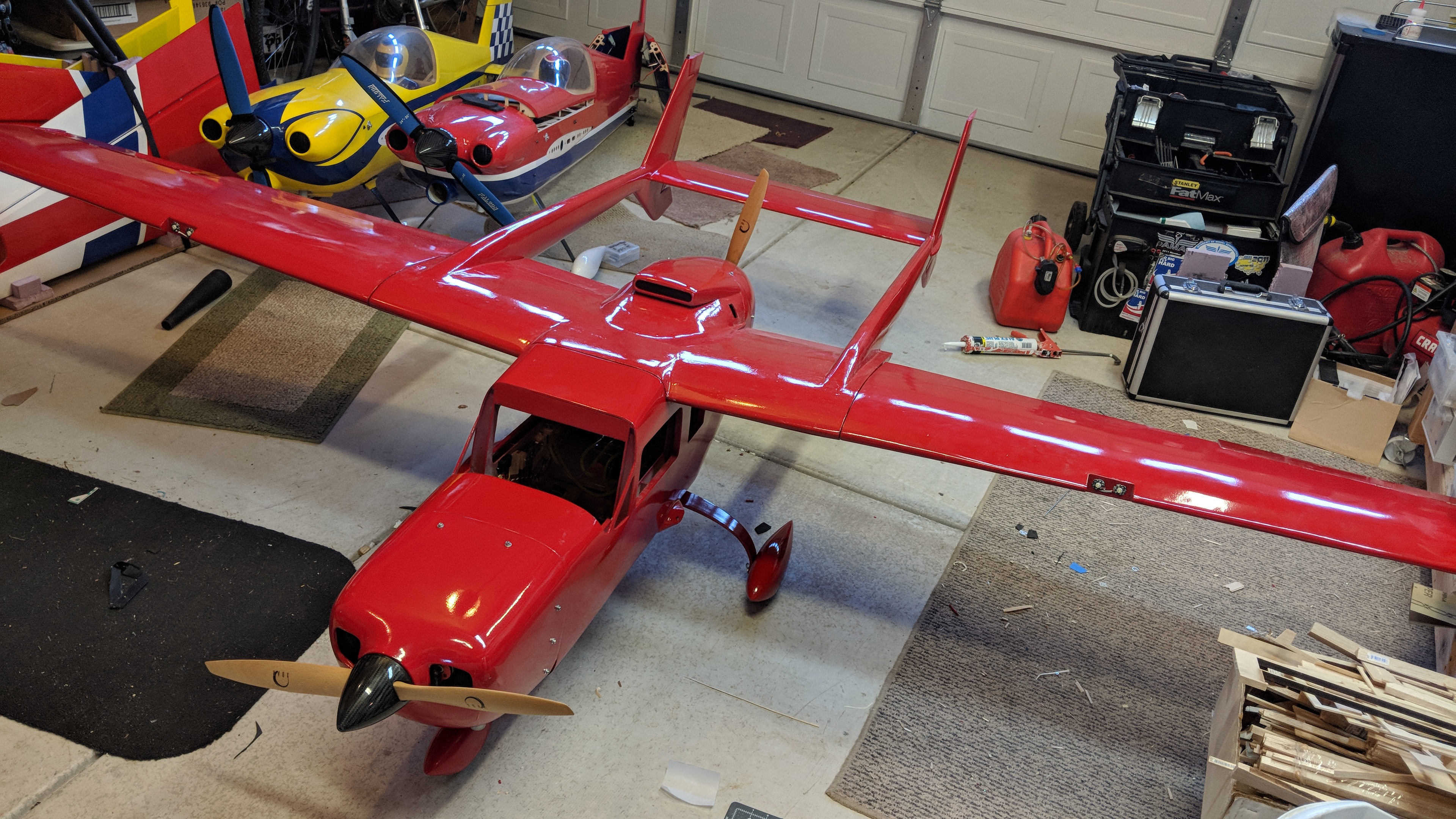

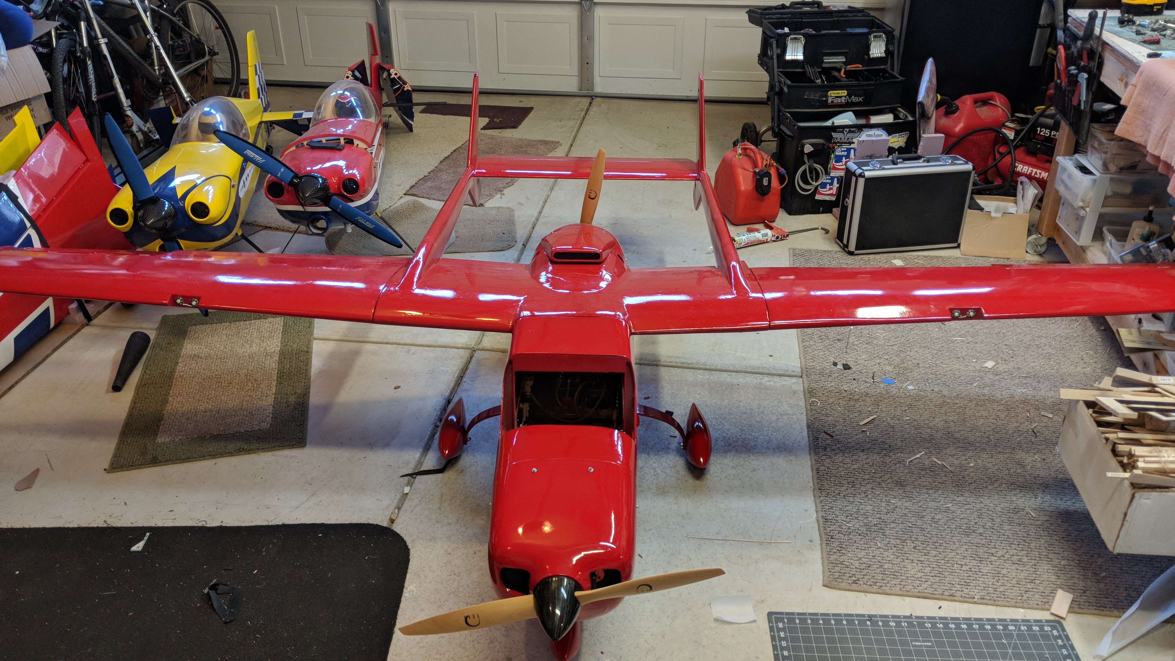

I have been out due to surgery on my elbow. I've managed to get a few things done using one hand. Lots of issues to sort out with the control linkages. I thought I had it all squared away before glassing it. Next time I won't bother spending all the time to get things set up before the finishing stage since I had to re-do pretty much everything!
We're getting close to being ready to maiden. All control surfaces are hinged, control horns and rods installed, everything works.
Oh, everything works EXCEPT the beacon light on the vertical fin! It went from working to flickering to dead.

Don’t get me wrong baffles are great and you should do them if you can but one thing you need to remember that the anxiety of baffles came about 3D flying were people were hanging on the prop and using big horsepower to do it with no forward movement. If you just do normal forward flying like you will do with that type of plane everything will be just fine.
