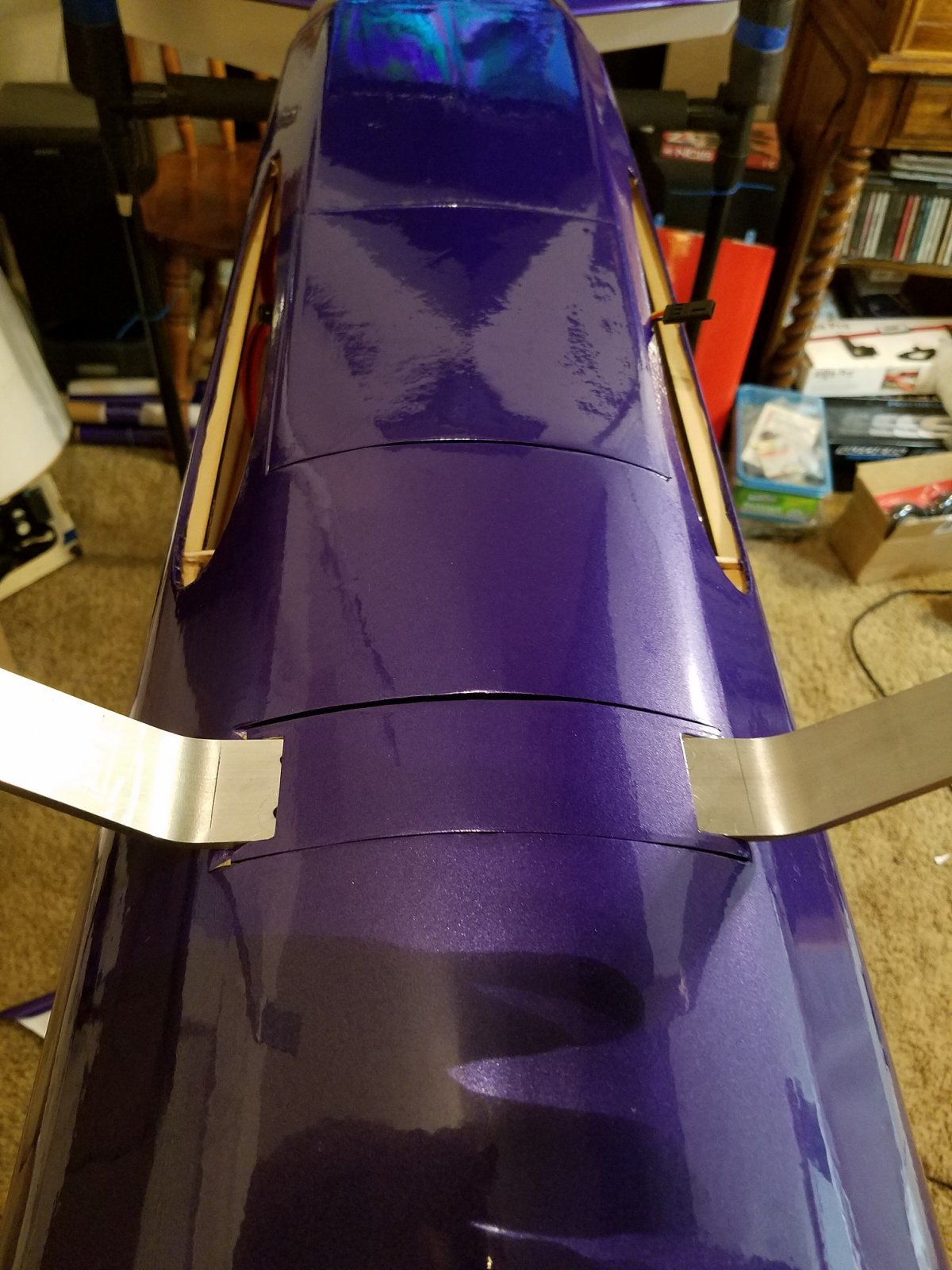

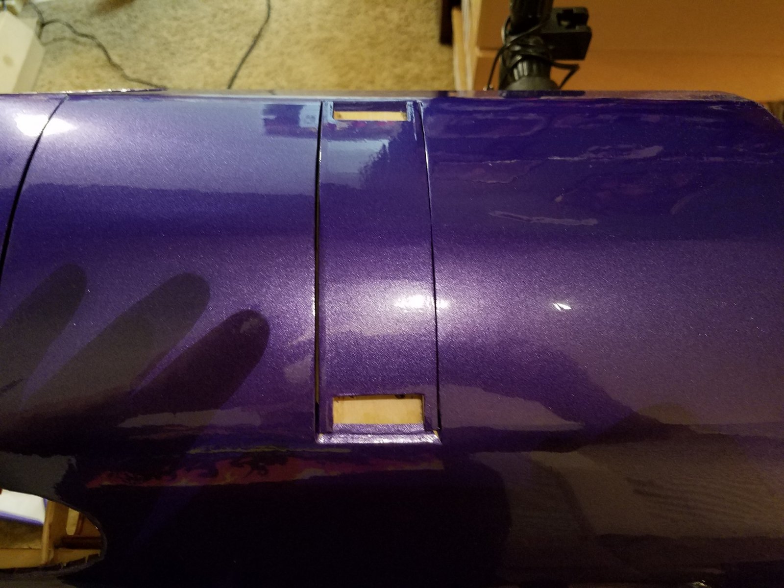

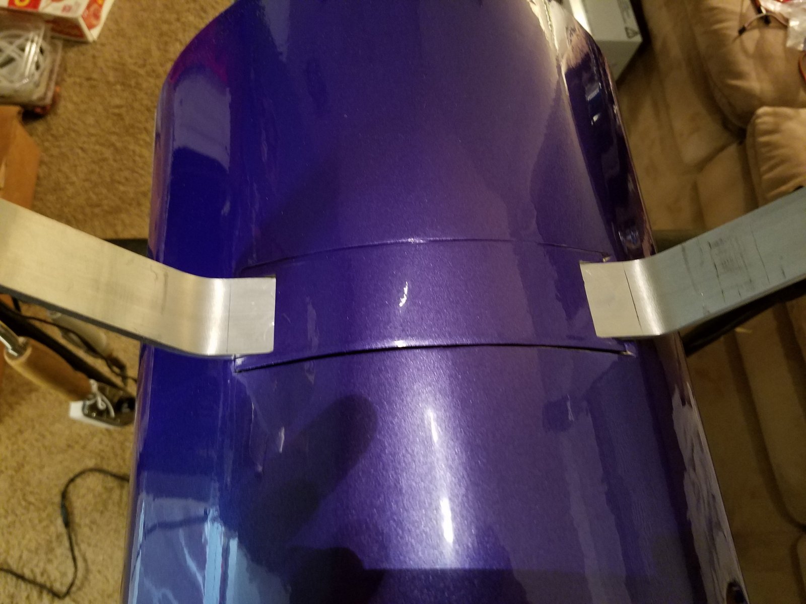

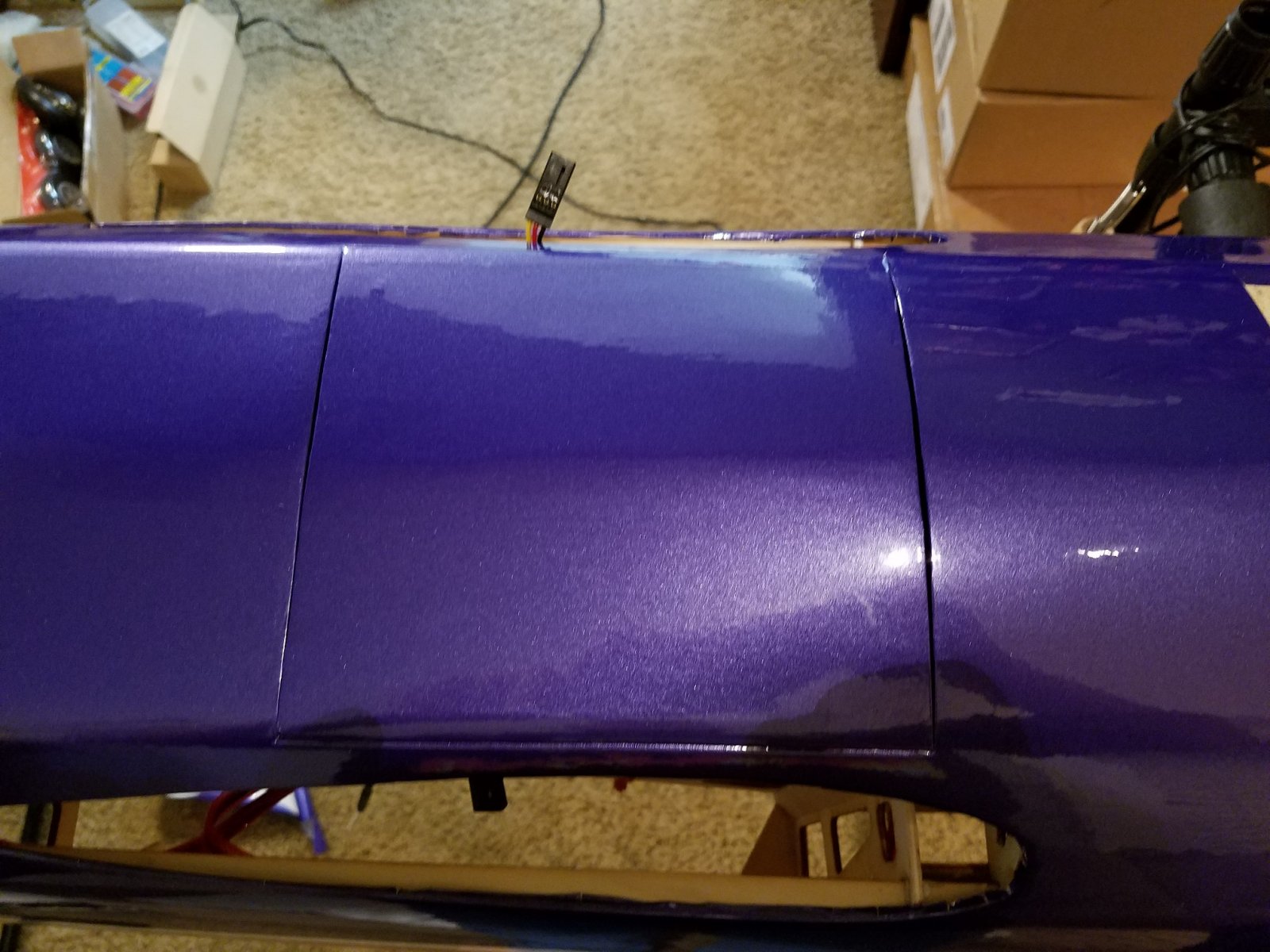

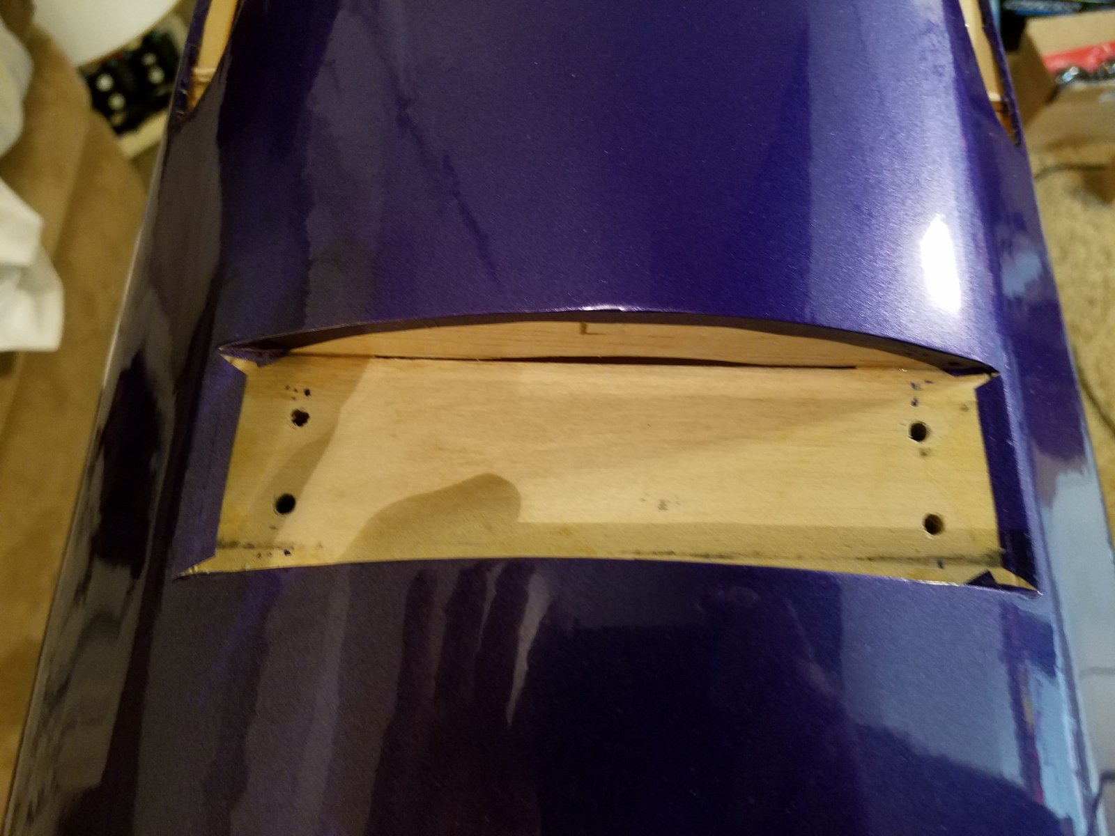

Progress on the Pitts is starting to slow up. It's those finishing up things that seem to take forever to complete. I finally got around to cutting the belly and the landing gear plate openings. I figured I best get to that while I had the plane upside down while building the throttle servo support. After getting the covering cut and sealed off, I covered the belly hatch and the landing gear cover plate. I think they turned out ok. Sure is going to be much nicer than the gaping open hole in the belly. JMO.

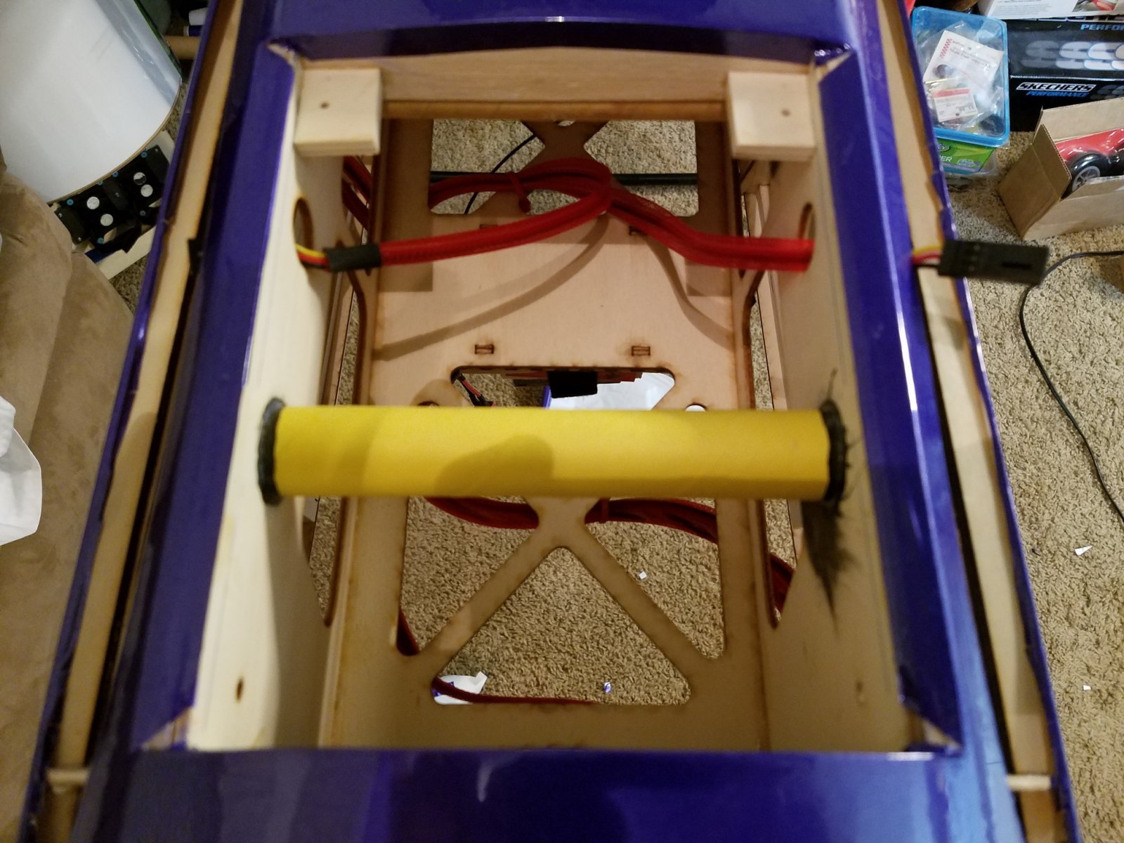

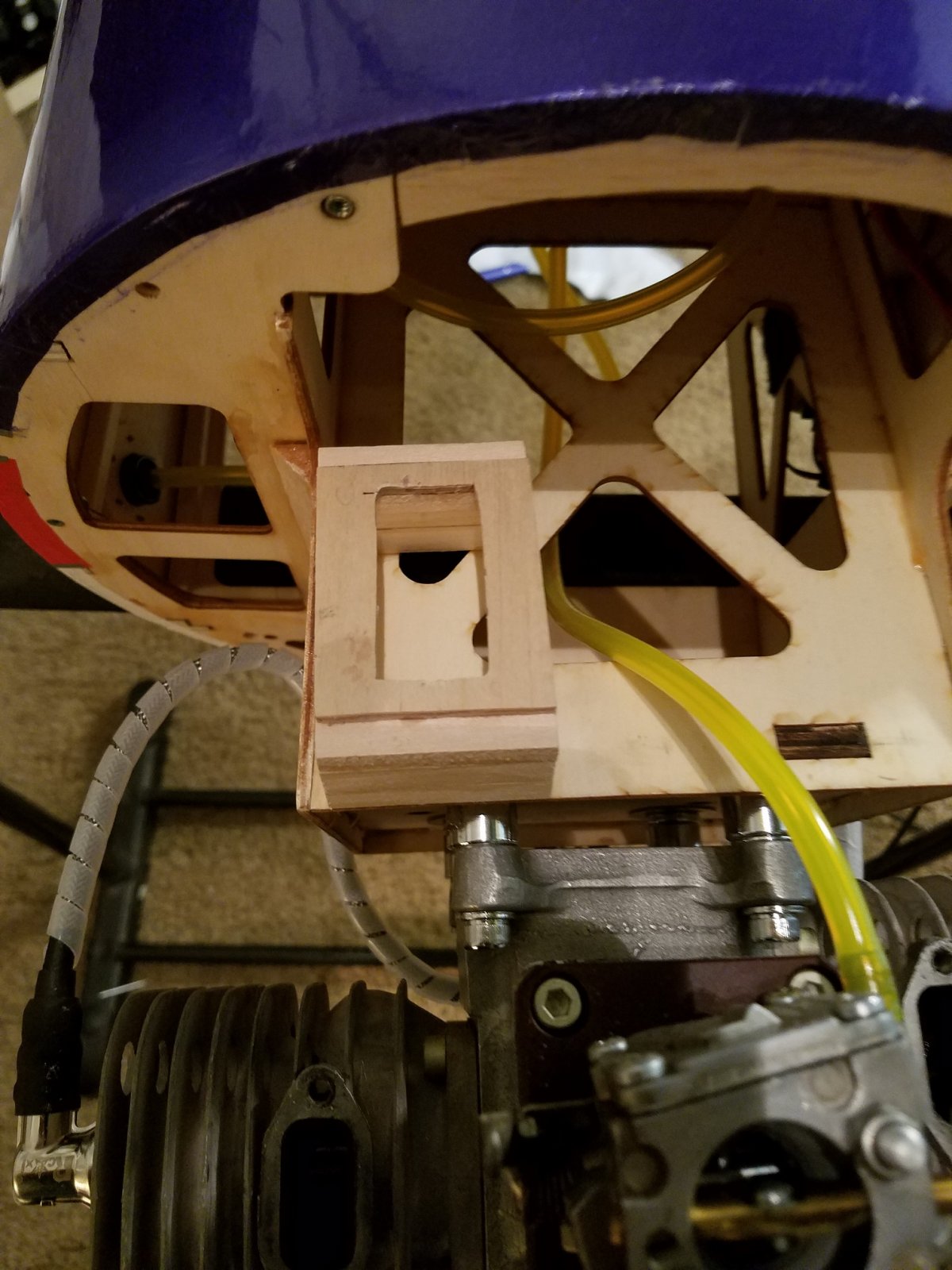

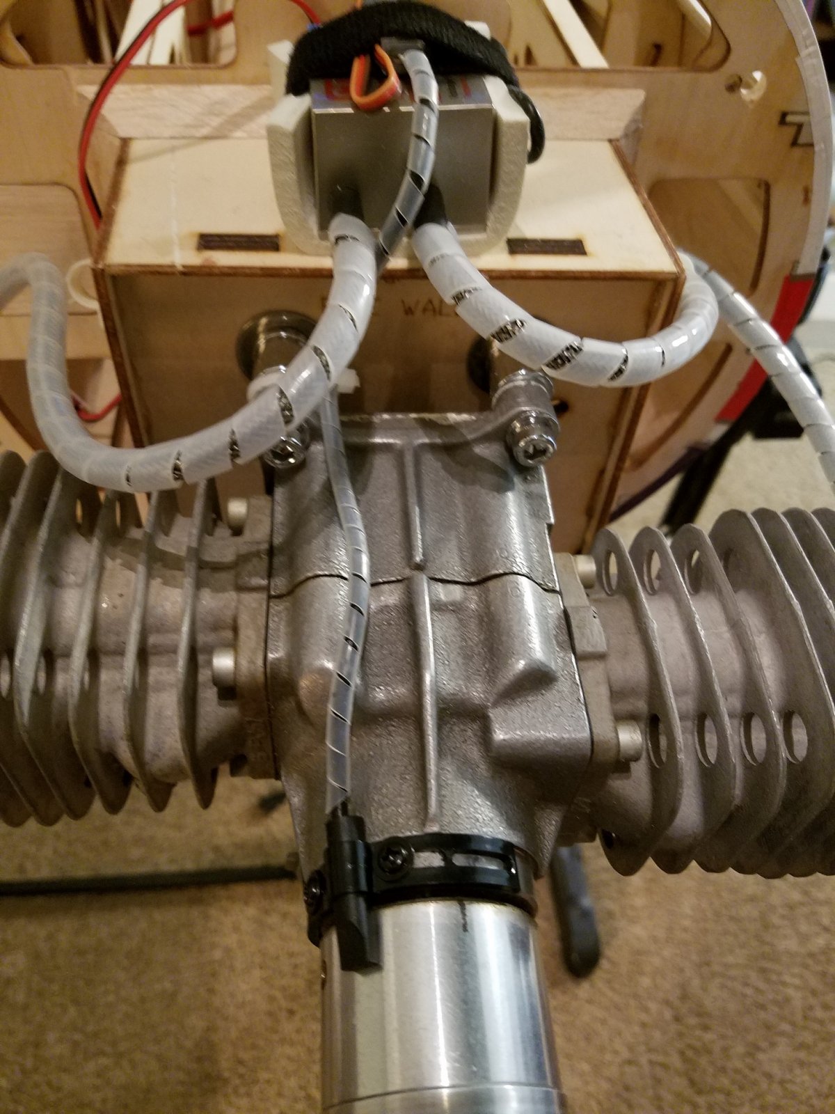

I also got the Hall sensor mounted and the ignition wiring pretty much tidied up. Also the throttle servo support is now in place.
I got the tail gear mounted and hooked up to the rudder for ground control. I also test fit the upper wing center section with the aileron servo harnesses in place. This plane should be very easy to assemble at the field. Slide in the bottom wings, plug in servo harnesses, install wing bolts. Slide in the top wing outer sections, plug in the servo harnesses, install retaining bolts....gas, fly. hee hee.

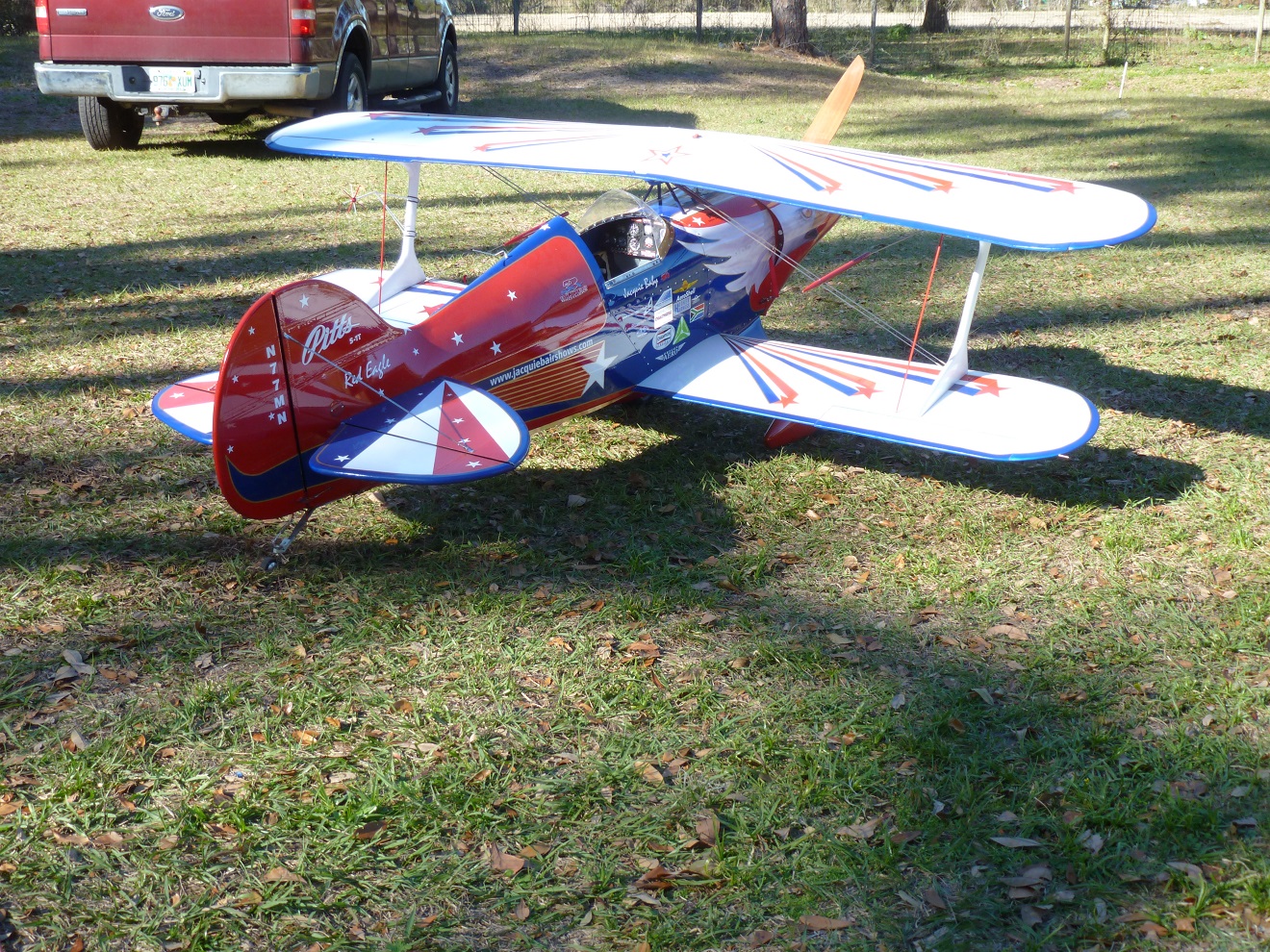

My "Red Eagle" Pitts with the wrapped headers leaves absolutely no residue on the airframe. Pre heat the oil and adjust the pump appropriately for a clean burn, simple as that. A little over two years and have not had to clean it other than for dust collected while in the trailer. And the three other airframes with smoke are the same way...
