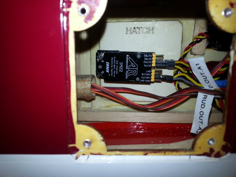

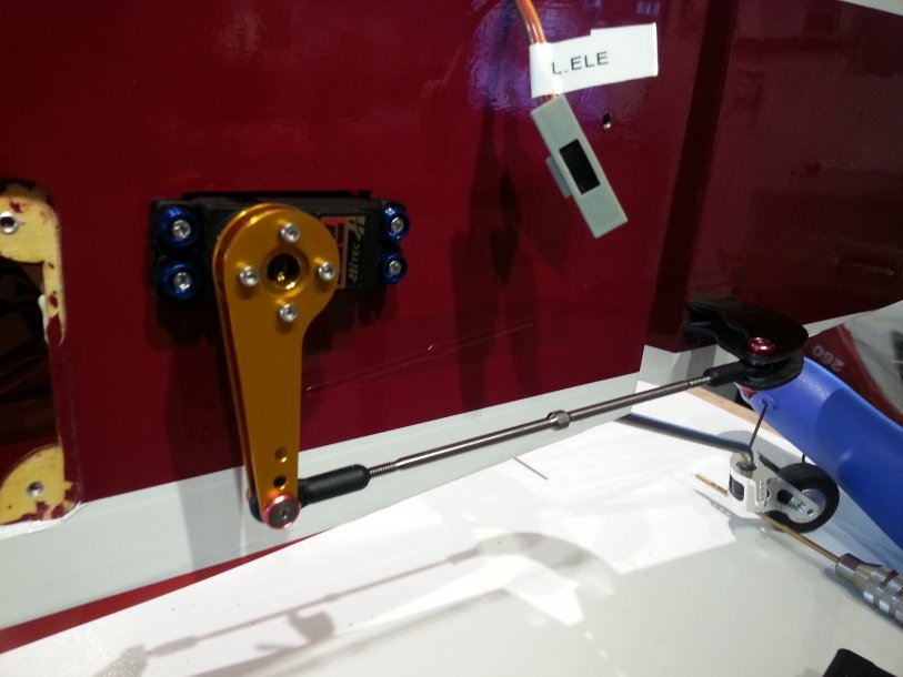

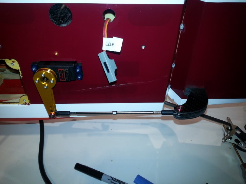

Hoping there's enough bling on there. Secraft hardware, swb turnbuckles, airwild arms, titanium bolts/ screws, dubro ball links, and intellimatch mounted, everything labeled . moving on to front of electrical system and hardware.

Thank you guys, appreciate every word, I really do.
