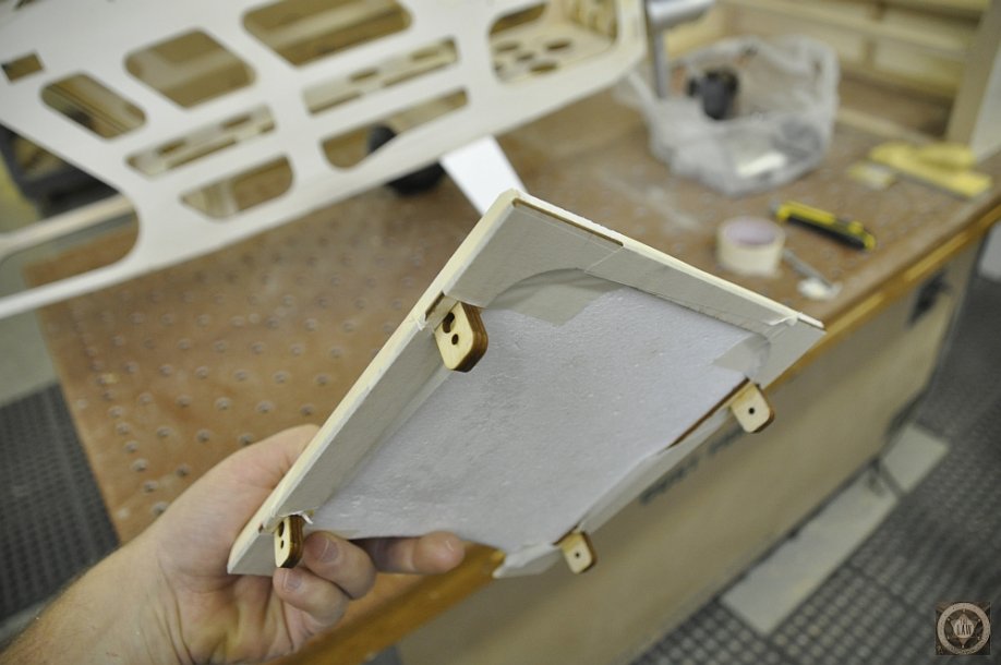

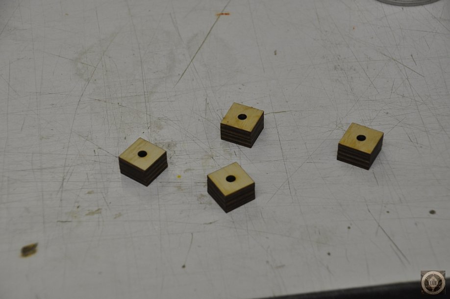

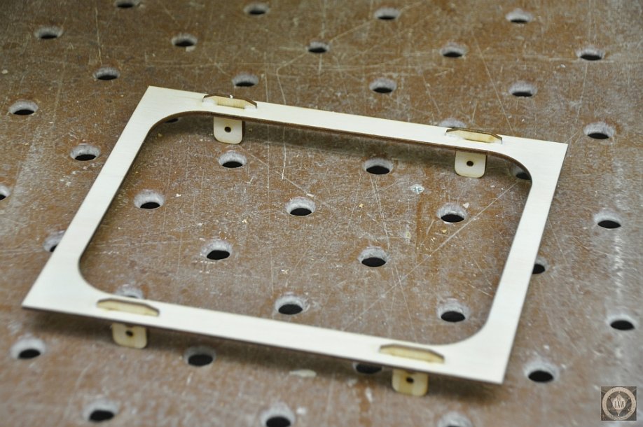

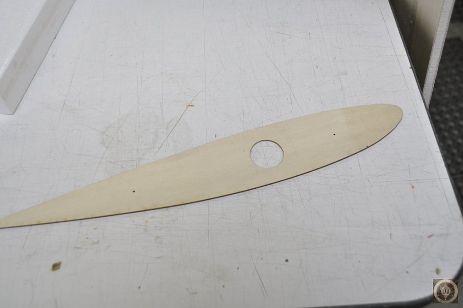

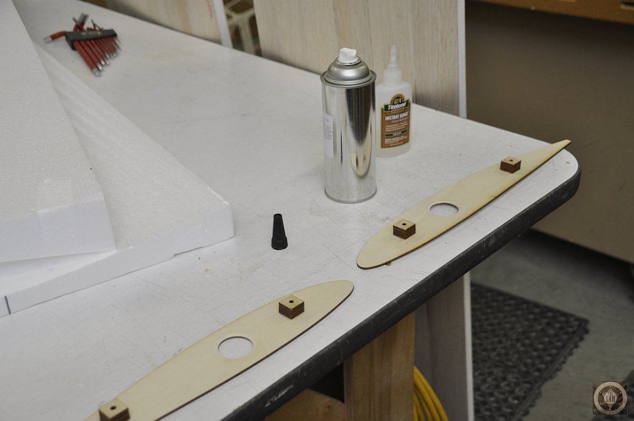

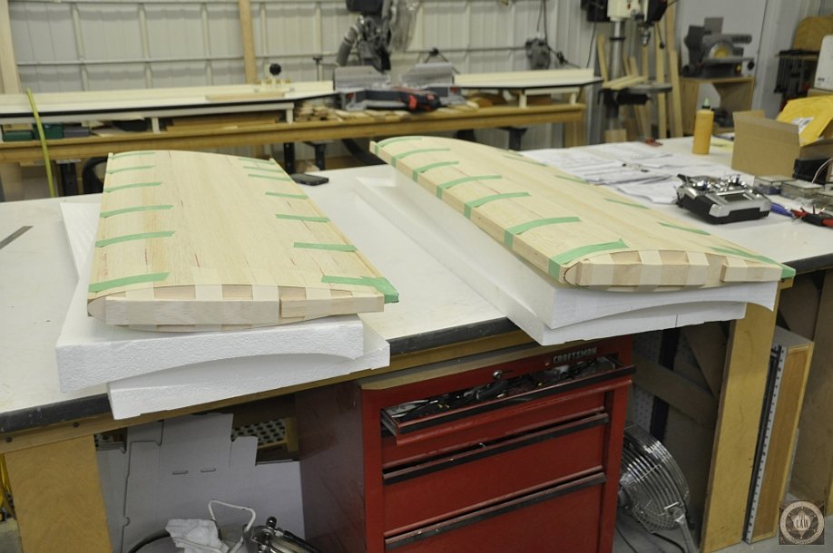

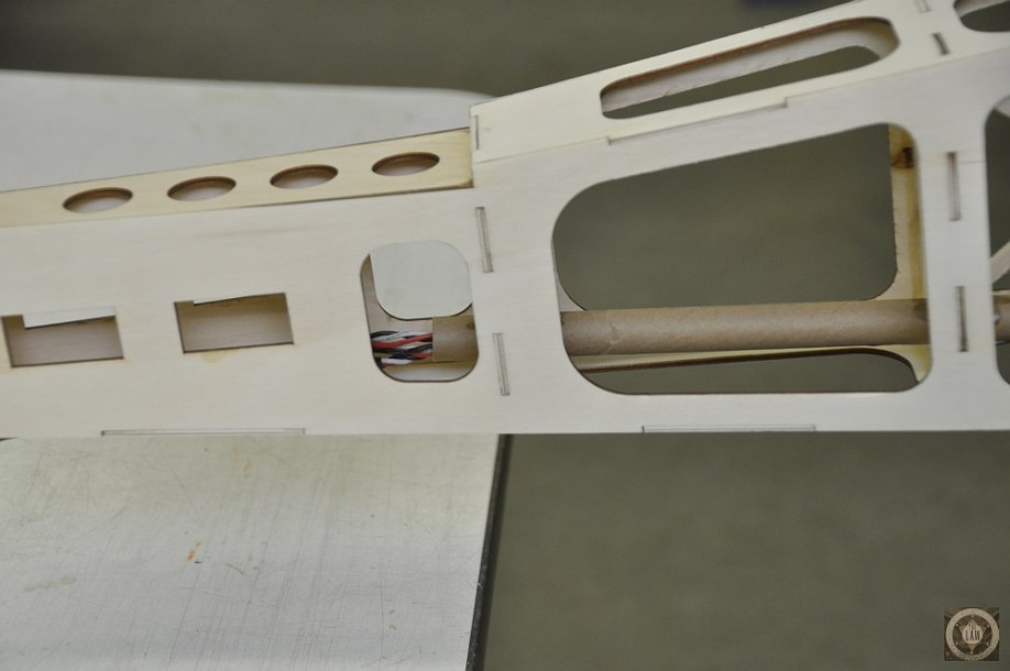

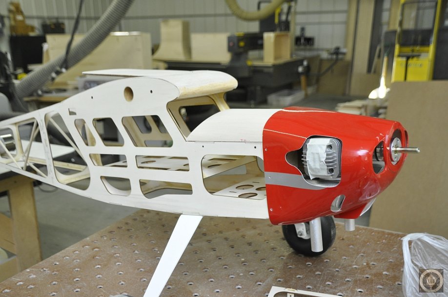

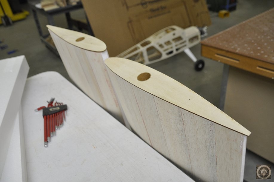

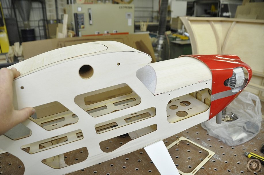

Took a couple hours yesterday to build the hatch, cut the windshield and work on the wings. I'm trying something new by lasering blocks for the wing bolts and the hole is perfectly sized to be tapped for 1/4-20 bolts. Blocks are pre hardened with thin CA and will be hardened again with foam safe thin after tapping.
I have some actual work to do today and then hopefully work on the wings some more.
