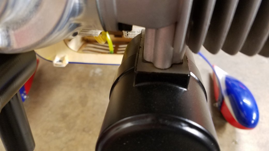

I have around 5-6 gallons of 32-1 Redline through it (on your suggestion). @Tavis likes 40-1 Stihl Ultra from the get go, and he has lots of experience with these motors, but I went with your suggestion because you are www.ZDZUSA.com . haha I'm curious to look at the blow by on the pistons but I don't want to mess with the muffler seals that are working perfectly. No sealant, no locktite, no oil. I just bolted the mufflers down with dry factory bolts and dry stock gaskets... using nordlocks for washers. The seal is perfect after 18 flights. I did that because the ZedDeeZed stock gaskets looked like they're of a special material. They look like they might even have some metal in them. Maybe to transfer heat out from the cylinder to the muffler for cooling even. Oh, I want two spare sets of those if I can setup that order here with you. haha

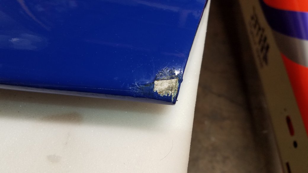

I did a low torkano and me and Joe were just laughing away, that move really makes me laugh. :) And, I was doing a rolling harrier down the runway and thought I was getting pretty low and thought I heard a scuff sound... and I guess I did. haha
