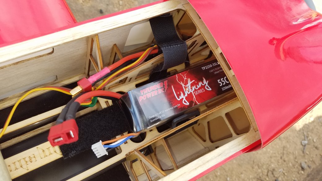

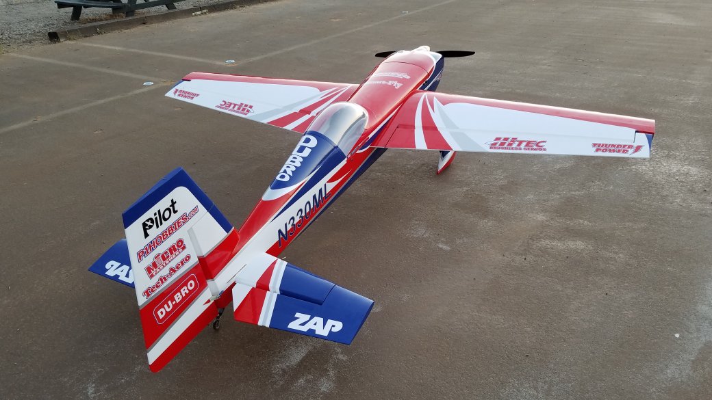

McBride wanted to do a little flying this afternoon so I took out my 48" Extra since I picked up some batteries for it. This little planes fly great!

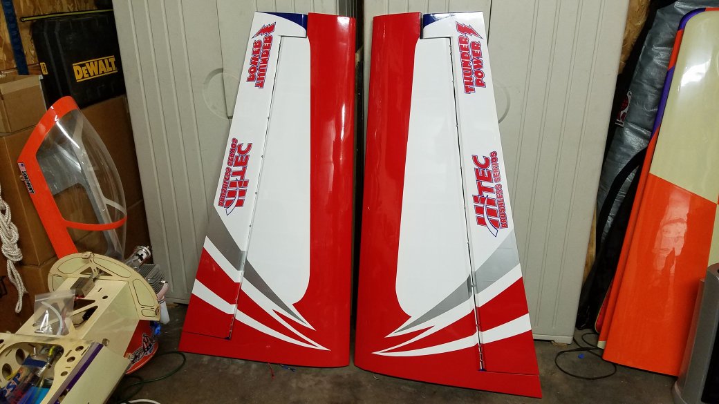

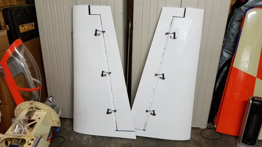

I finished covering and hinging my wings. Got about 40 hours in it, lot of work. Still need some setup, but they're close to RTF. The hinges are bombproof and the red and white covering will be much easier for me to see.

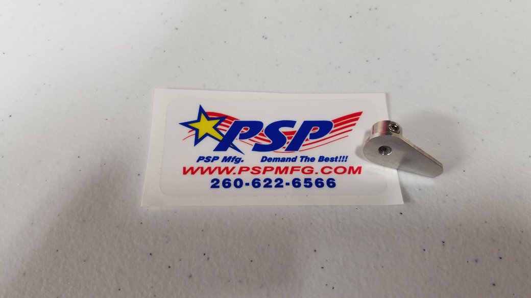

I also picked up some PSP throttle and choke arms. They look nice and have double setscrew mounting.
I've used that scheme a couple times and really like it, looks great:way_to_go:
