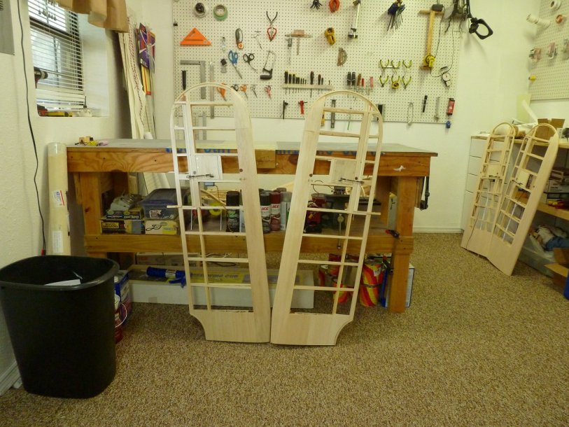

After a bit of a hiatus I am back at it for a bit.
Went to the airfield and got in several flights on the GP Pitts.
Come back home and commenced sanding on the last of the wings. The fit sanding is complete so now I can put it together, after fitting the control linkage of which is in progress, then the wings go on and the struts get fitted. After the struts comes the fine finish work, you' all know, the filling and fine contoured sanding. Well, gotta get back at it.

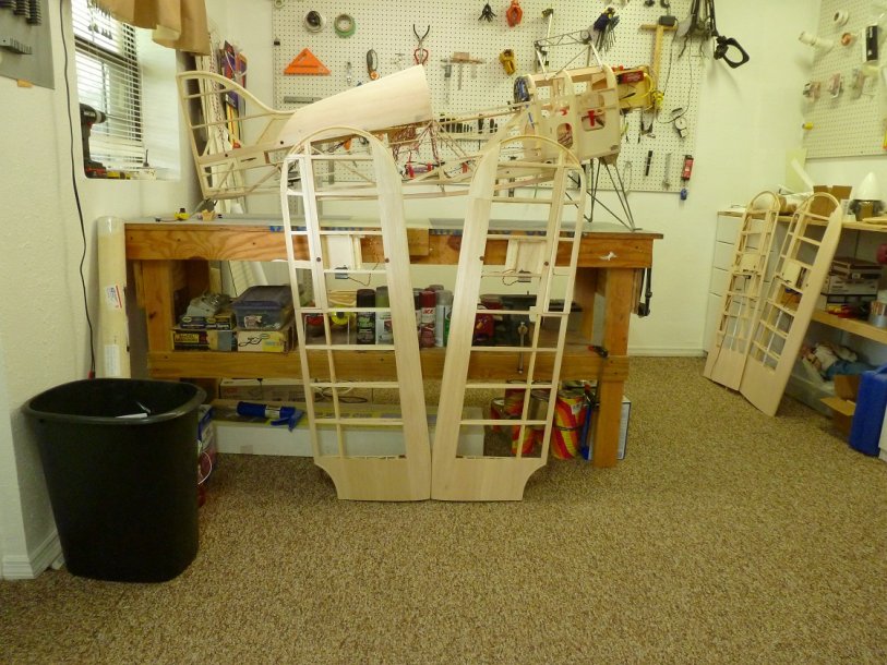

The linkage had been made and JB'd. That's going do it for today, the JB needs 12 hours.
