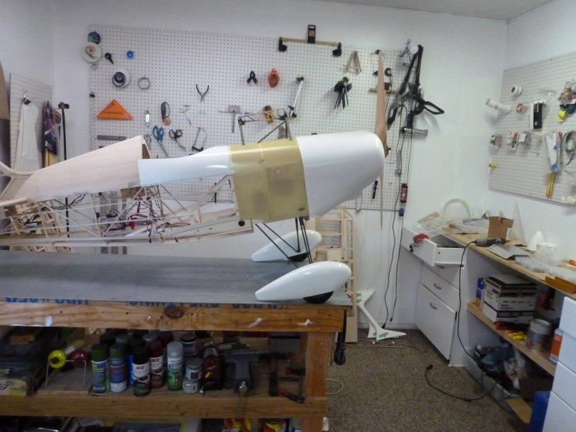

acerc

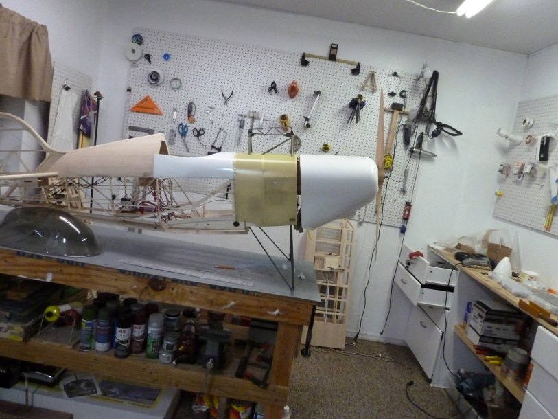

When I was fitting the cowl last week for some reason it was short, pic 1. So I made a spacer and epoxied it to the nose former. The fuse panels have been re-cut for the longer nose and awaiting their turn to go on as soon as the epoxy is dry enough.

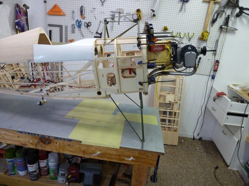

Panels and cowl installed!! Next up? The wheels and pants..

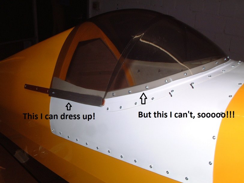

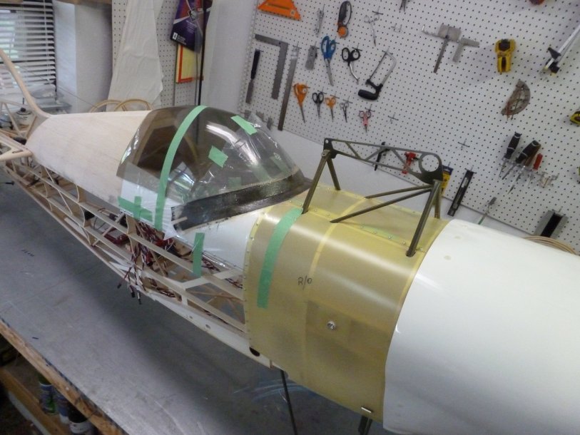

Being as the kit supplied canopy mount is hideous, pic 1, I am making a glass one like I did on mine. I have laid up a five ply frame and will give it until morning to cure. Then I will give it a good glazing readying it for prime and paint.
