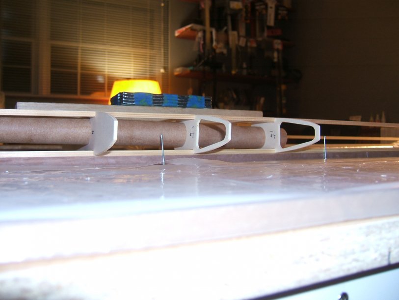

Attempting to demonstrate the angle of the wing tube. The wing tube socket passes through the 1st 3 ribs. The tube socket rises up slightly from the flat table surface. The 1st rib is angled to account for dihedral. You can see the angle in the 1st spacer block. The remaining ribs are perpendicular to the building table ????????

acerc
@Jaketab, those are correct, if all three are slid on the wing tube abutting each other one can see how all three are tapered.

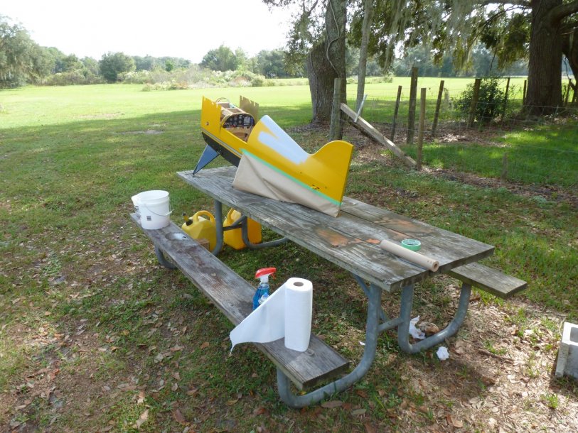

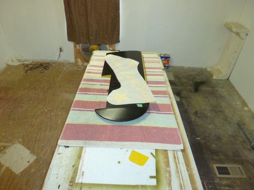

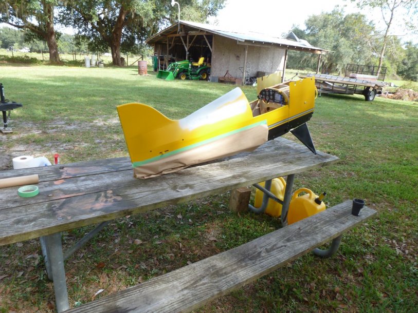

acerc
All the pin striping has been completed and getting ready to start the vinyl/ decals/ logos. It is going slower than normal because I have been working on cleaning up some seams. I can live with minor issues such as a small bubble or wrinkle in a stripe, a dust bump, little things that won't jump right out at you. But the seams on the turtle deck I could not let go, at first I thought they were good but the inspection after the yellow told a different story. I have been filling and sanding in and out of striping and one more sanding and it will be right, then spray yellow and it will be done.

I measured the angle of the rib spacer next to the root rib.
The angle or dihedral appears to be 8 degrees. ???????????
