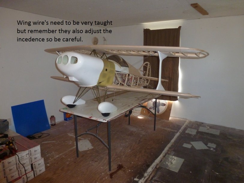

Install the prop using caution not to crush the prop with the six and/or two nut's, tight is good over tight is not, and install spinner.
acerc
#14,
Once again, ensure the radio is set-up so as to "not" deflect any surface's or control's to a point of breaking thing's. Some items may even need reversing including the throttle and choke.
Be sure to familiarize yourself with the airframe and it's component's. I have tried to make assembly require certain method's to familiarize you with thing's.
I have also left wire ties off the fuel to carb connection as well as the smoke line's to exhaust connection. Be sure to remove cowl and secure these!
Don't forget to do a balance check. It is best to have help with this bird due to the weight.
Hope you enjoy it as much as I do mine!!

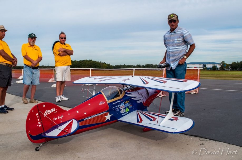

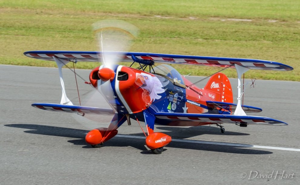

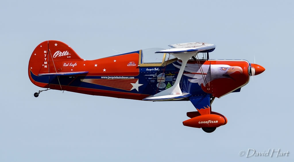

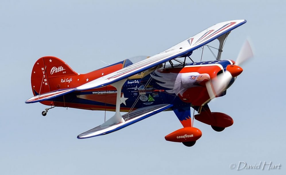

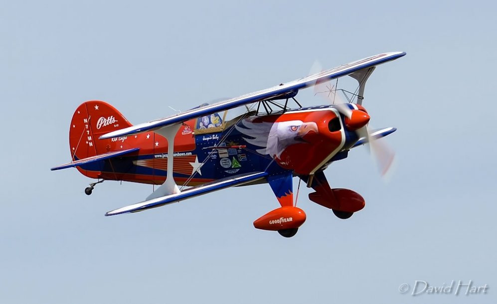

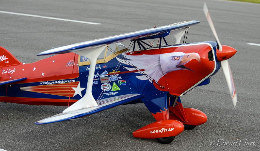

Speaking of mine, I still have not had a chance to fly it with the 3 blade prop, soon hopefully. On another note, Frank Tiano has the 12 O'clock High pics posted and some how I managed to rate eight pics.
