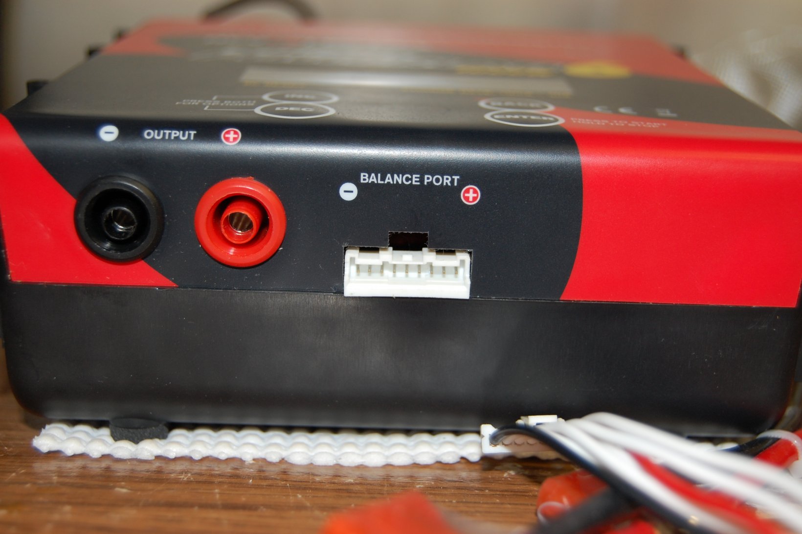

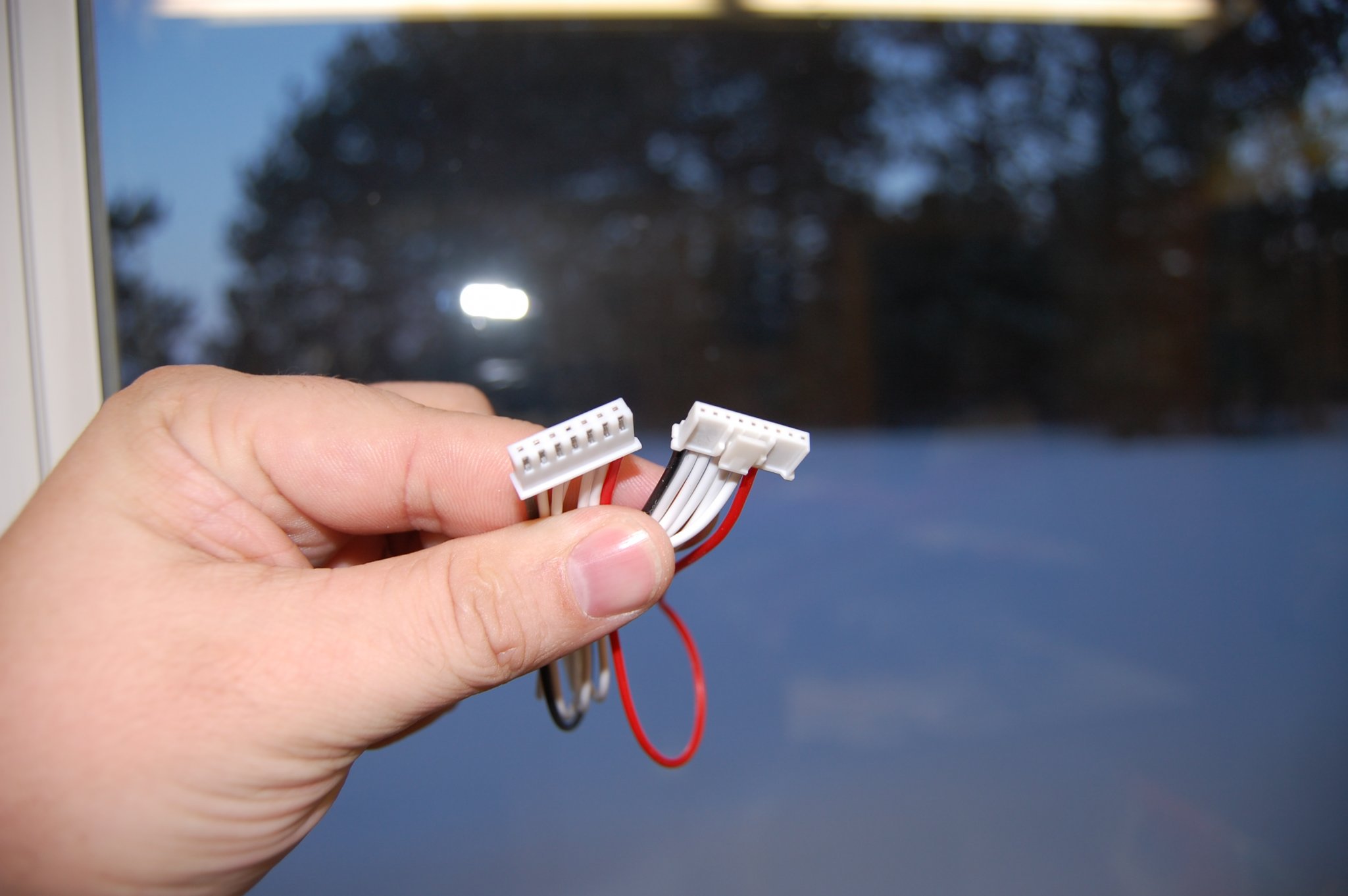

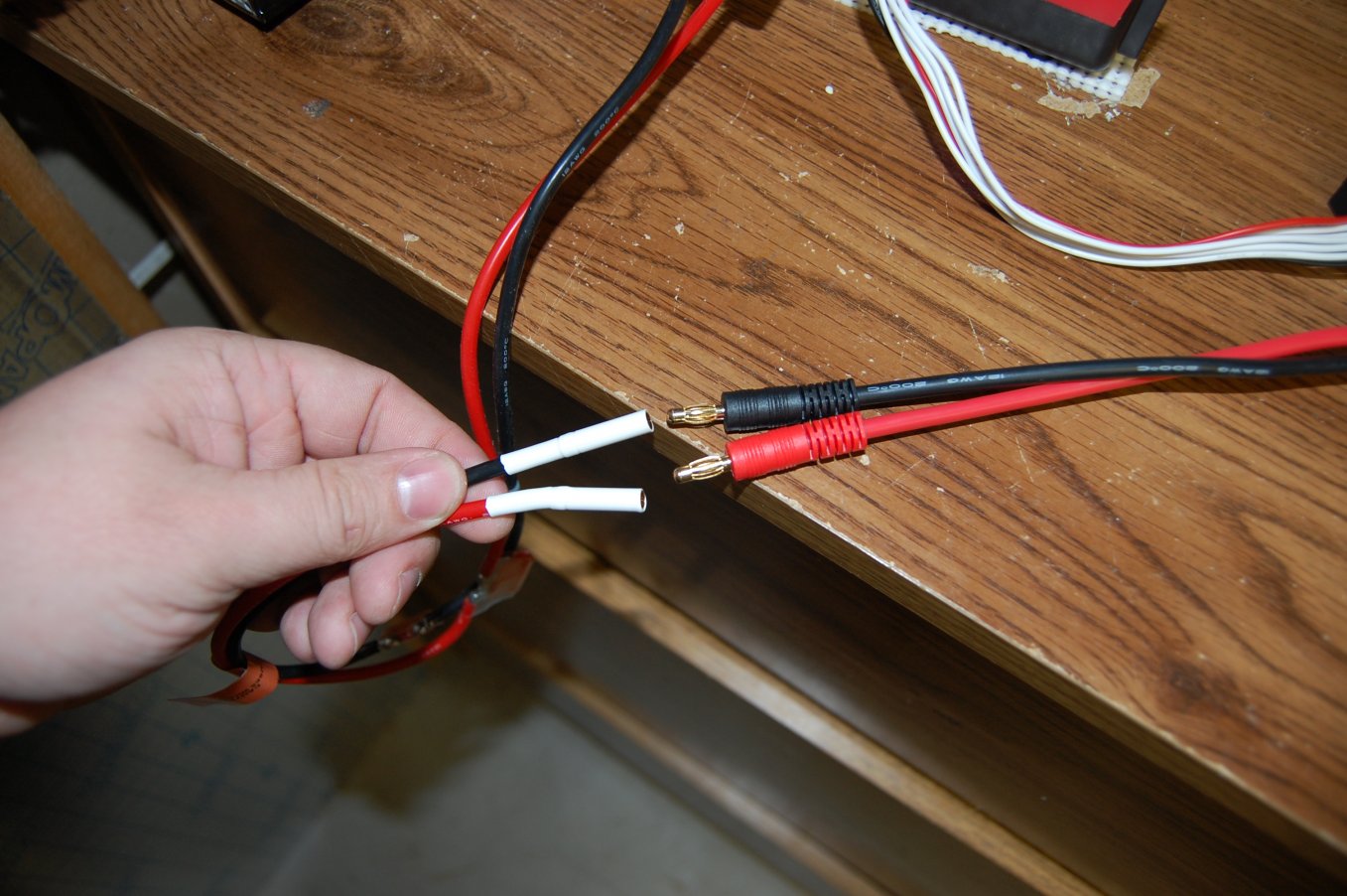

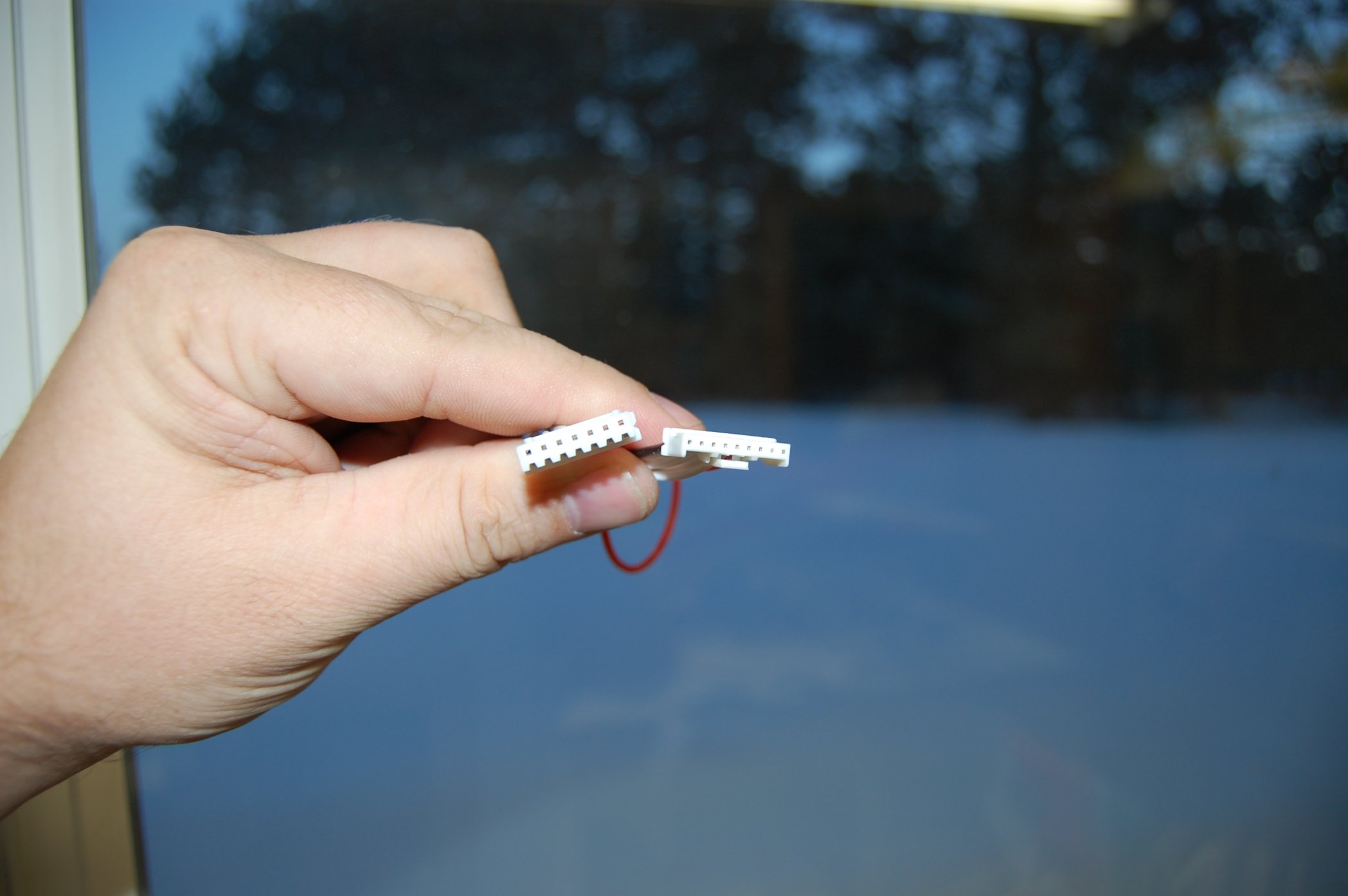

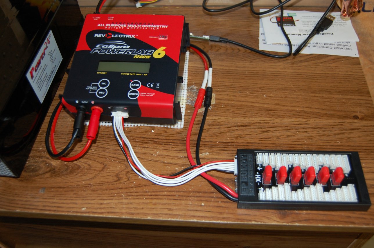

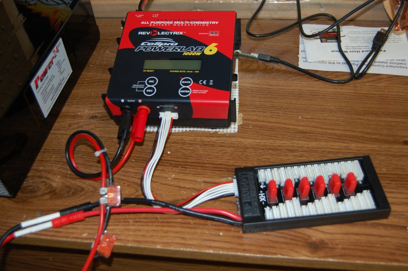

Hey AV8TOR, I wanted to get back to you with a few photos of my setup. From the posts above it looks like you've been shown that adaptor, but with the cords you have you will need that balance board listed above and shown in my review of the solidhobby.com power supply. Below are a bunch of photos I took just to try to add some clarity. Hope they help you or anyone else with questions:
Please note that I soldiered 4mm female bullets on the standard FMA leads because I thought the 40amp fuses on the discharge leads was a nice touch by PL. I also wanted add some length and diversify my main leads for any other type of charge connection for transmitters, receiver batteries, and potentially lead acid type connectivity, of course as you can see from the last photo, anything with a 4mm bullet will plug in to the PL.

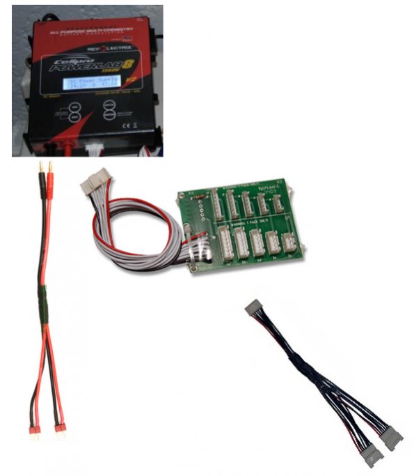

So I just got back from my week at the PGA Show and was giving this some thought. I understand the cable need if I used a ParaBoard but as I mentioned I have lots of these Parallel cables that I simply find easier than my ParaBoards. So is this setup I diagramed out the right way to accomplish this? Also I read that there is a software toggle for using non FMA standard connections so do both this and the PB adapter cable require changing this software setting.
I am also curious how many of you actually use the computer software? I like tracking IR and mAh put back into my packs but I really don't see myself doing the graphs.
I am not ruling out the MPA board either.

Yours setup is exactly as needed. You won't have to toggle between FMA and XH mode if you are using the FMA board as the FMA board is already wired for the conversion needed.
