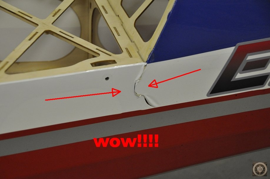

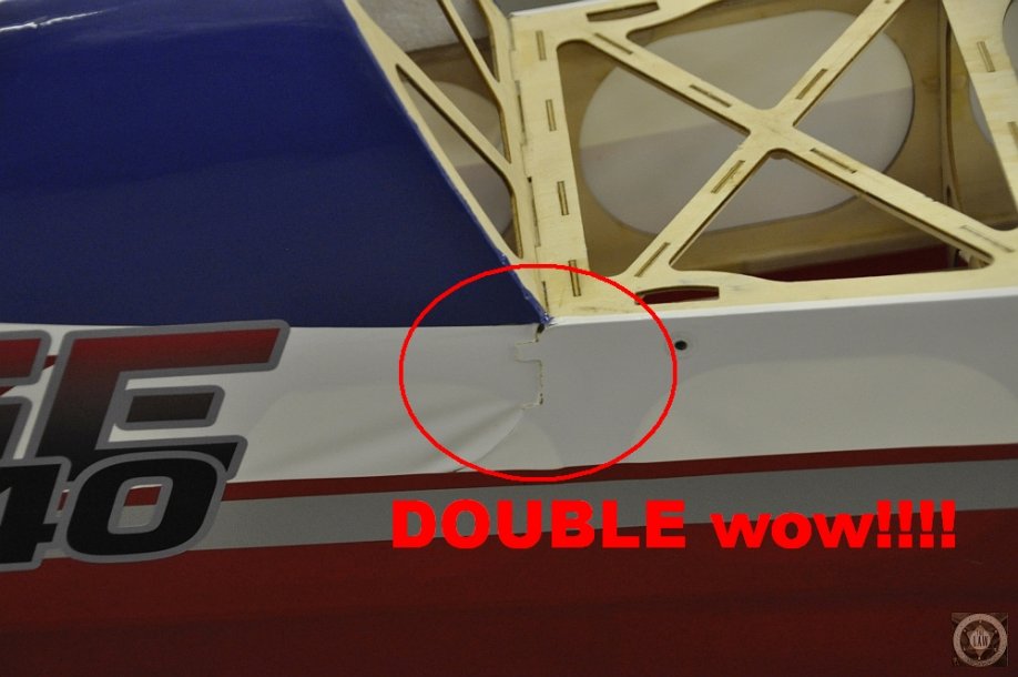

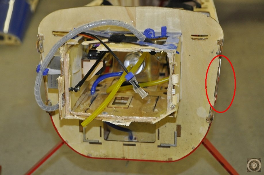

Years ago I had a Hangar 9 Sukhoi with a 3W-106 and a 28X10 prop. Took off and about 50ft. in the air it exploded. Shook the engine off the firewall, engine was laying in the bottom of the cowl.
Terryscustom

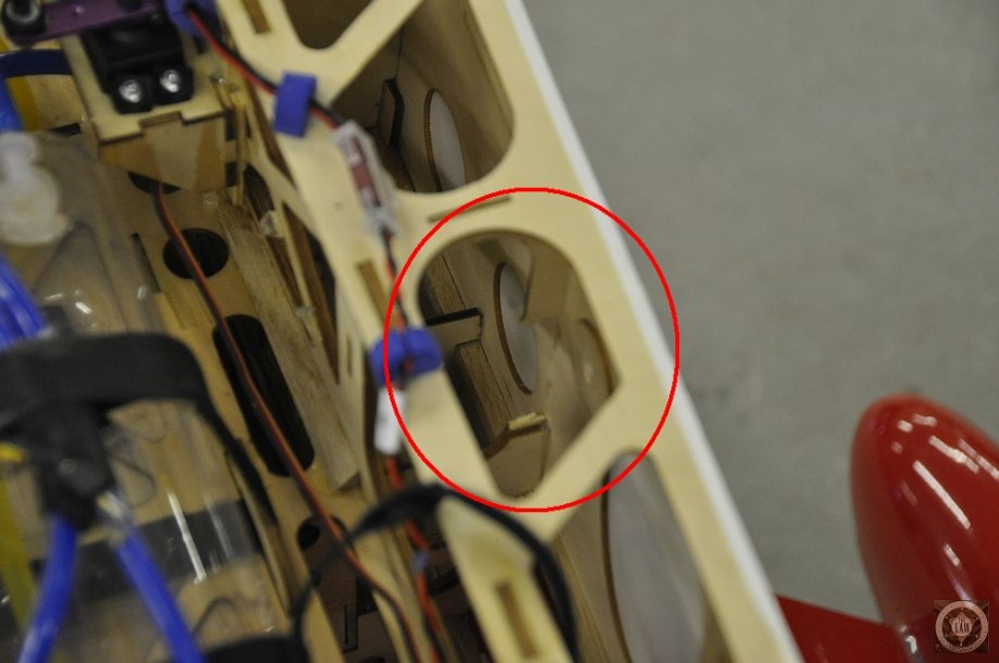

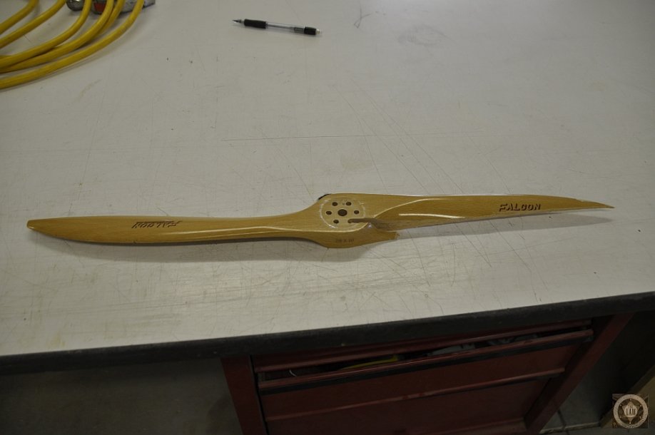

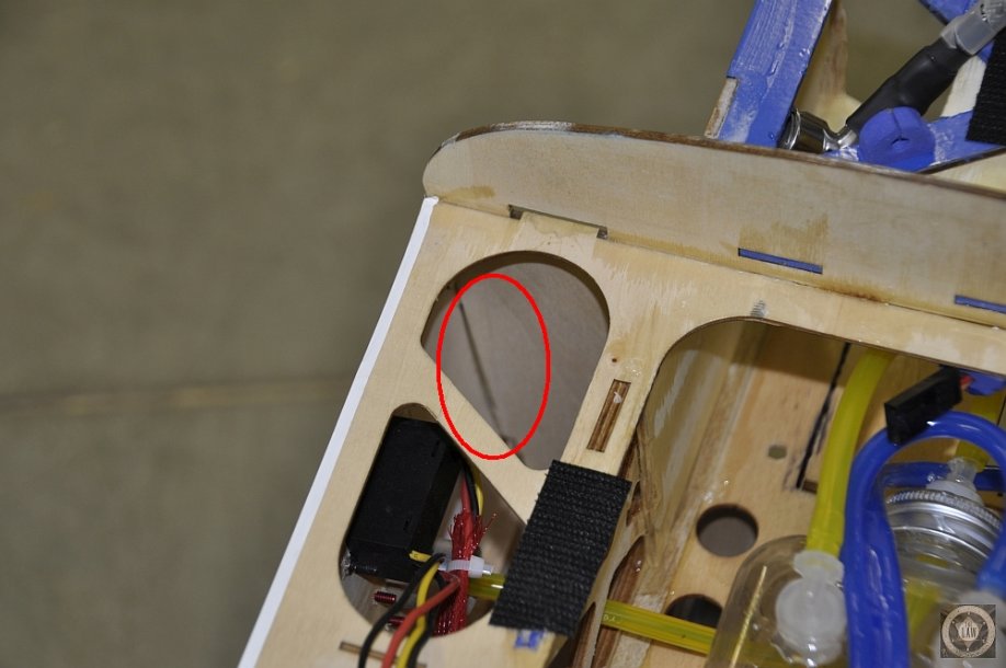

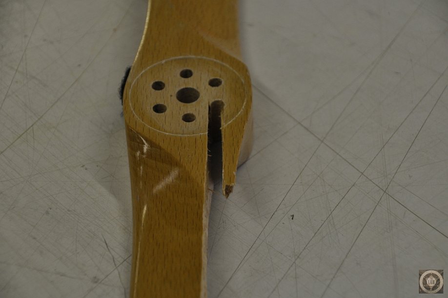

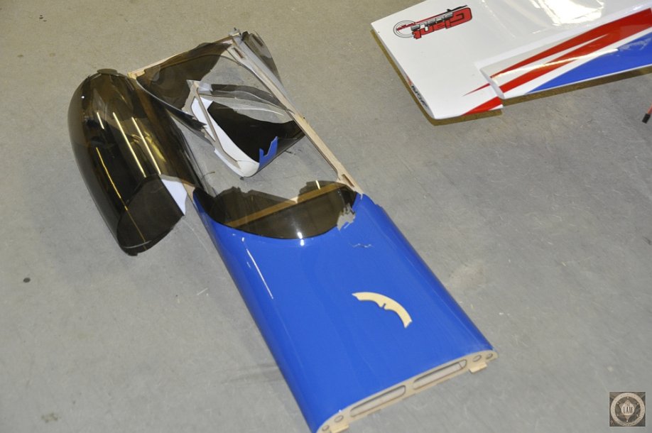

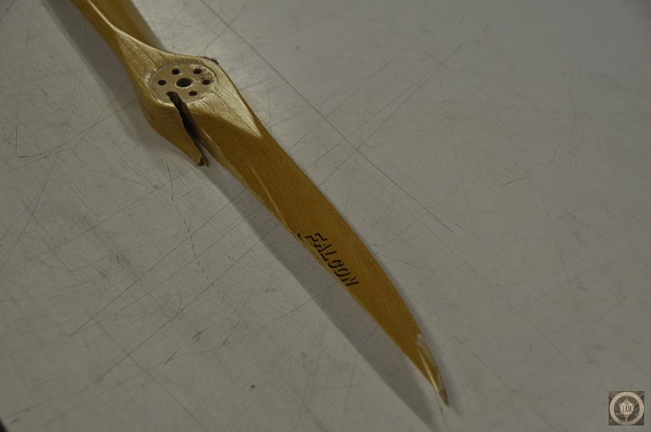

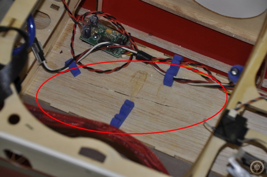

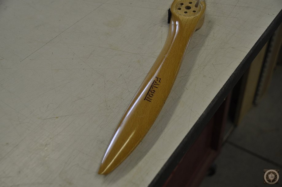

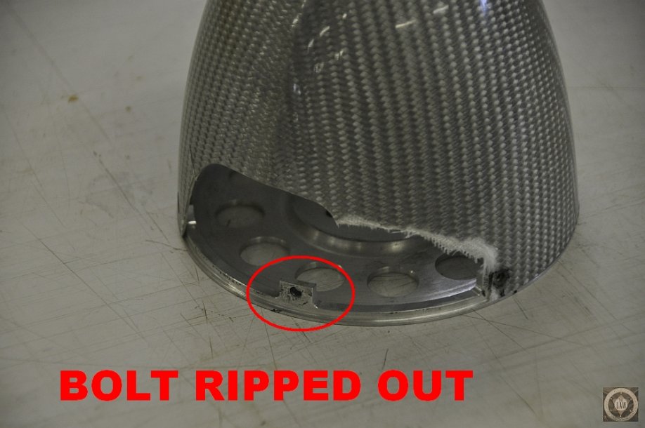

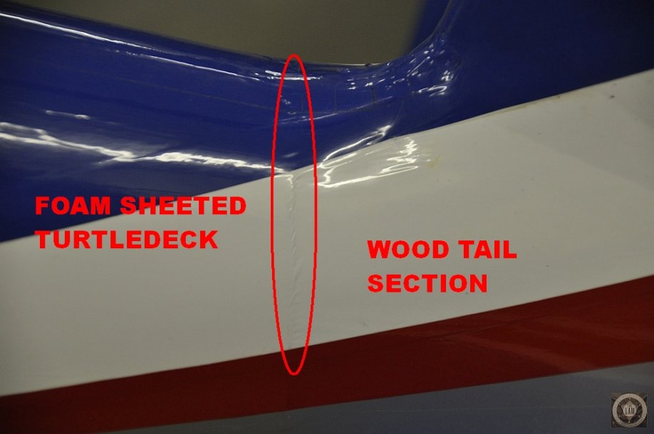

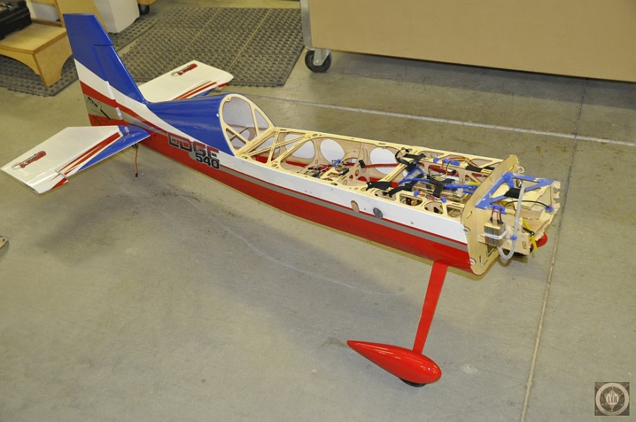

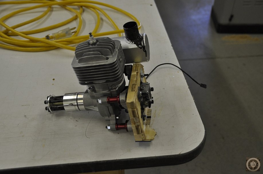

I was not going to post pics, just a discussion so please remember one thing no brand or company blasting!! Also please don't blast me for my setup, I experiment with crazy stuff all the time, just part of the hobby for me so $#!t can happen and I accept the responsibility on that. This thread is purely for educational purposes.
So yes the air-frame had a DLE85 on it. NO it did not shake excessively and actually it was an amazing combination when paired with foam core wings. The vibe mount and foam core wings did an super job of soaking up the normal engine vibes and the plane flew extremely well. I let @cardenflyer have a swing at it and he agreed it was pretty cool.
- spinner balanced with back plate.
- prop balanced on hub and blades and double checked
- Engine vibes normal for a single.
The part that always bothered me with wood props is the amount of crush you get just trying to tighten the bolts. I saw @SupaTim just posted in another thread about the qualities of laminated props. I didn't even think of one of those as I was planning to buy a carbon after testing if the plane / setup was even worth it. Either way, some pics for your entertainment:

Exactly, mine was a little more violent since I was doing a pretty high speed slow roll. The firewall did not give out until I was just about ready to touch down. The engine started gaining RPM quickly so I hit the kill switch. That's when I saw I only had half a prop more or less.
