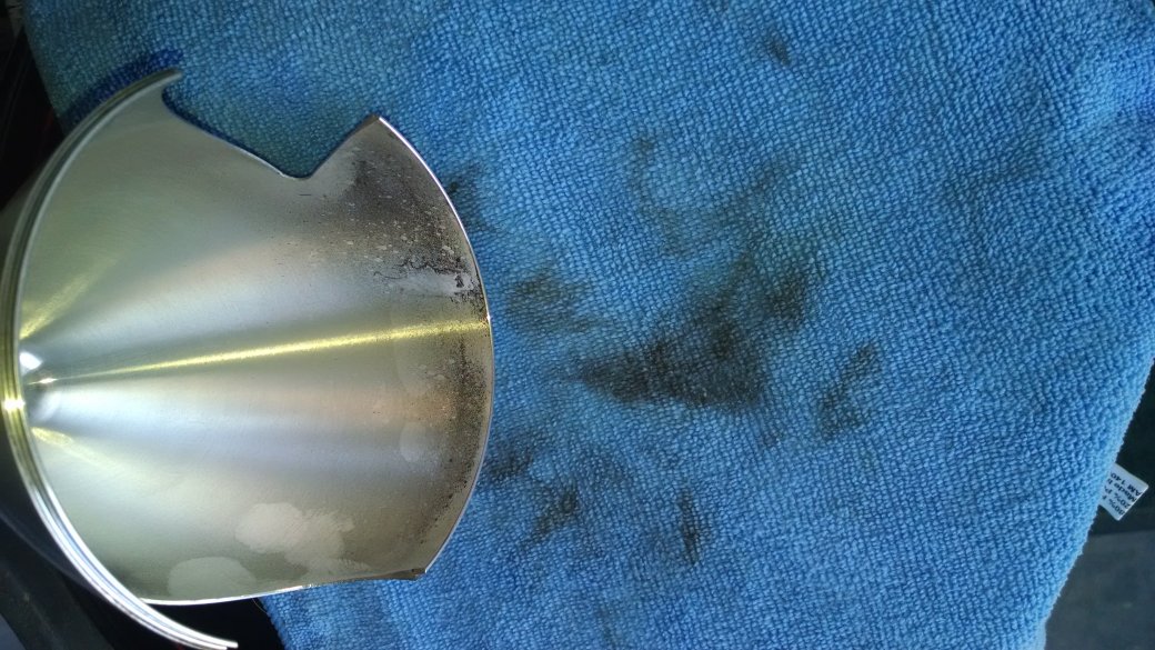

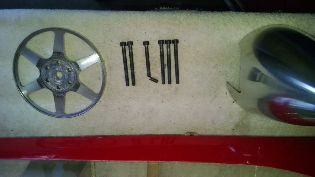

I had a very rare occurrence with a Falcon 32 x 11W prop the other day as well.
I normally spend the week tinkering on my planes and preflighting for the upcoming weekend,,, to include Torque Checking the prop bolts with my certificated calibrated Snap On torque wrench at 90 in. lbs.
Well the other day, while torque checking the prop bolts, the first bolt I checked, the torque wrench went click followed by a a loud SNAP.
I got lucky and was able to pull the broken bolt back out of the hub.
Spinner is a 5in. truturn and the prop is less than 2 months old.
Spinner cone had lots of dust too.
just makes no sense as to why this occurred.

No, not that I could tell as it was useless to mess around with the remaining bolts while trying to figure out what the hell just happened. The back side of this particular prop has the normal TruTurn backplate serration wear marks on it. Bolts are the 12.9 metric grade.
This particular prop is done as far as I am concerned for as I don t trust it. Got another one coming and thinking that last one was just that 1% of "if its going to happen, it will thing"(murphy's law)
I have a really nice band saw so it will be interesting to see what the prop hub looks like underneath the C/F or if there's any large voids, etc.
