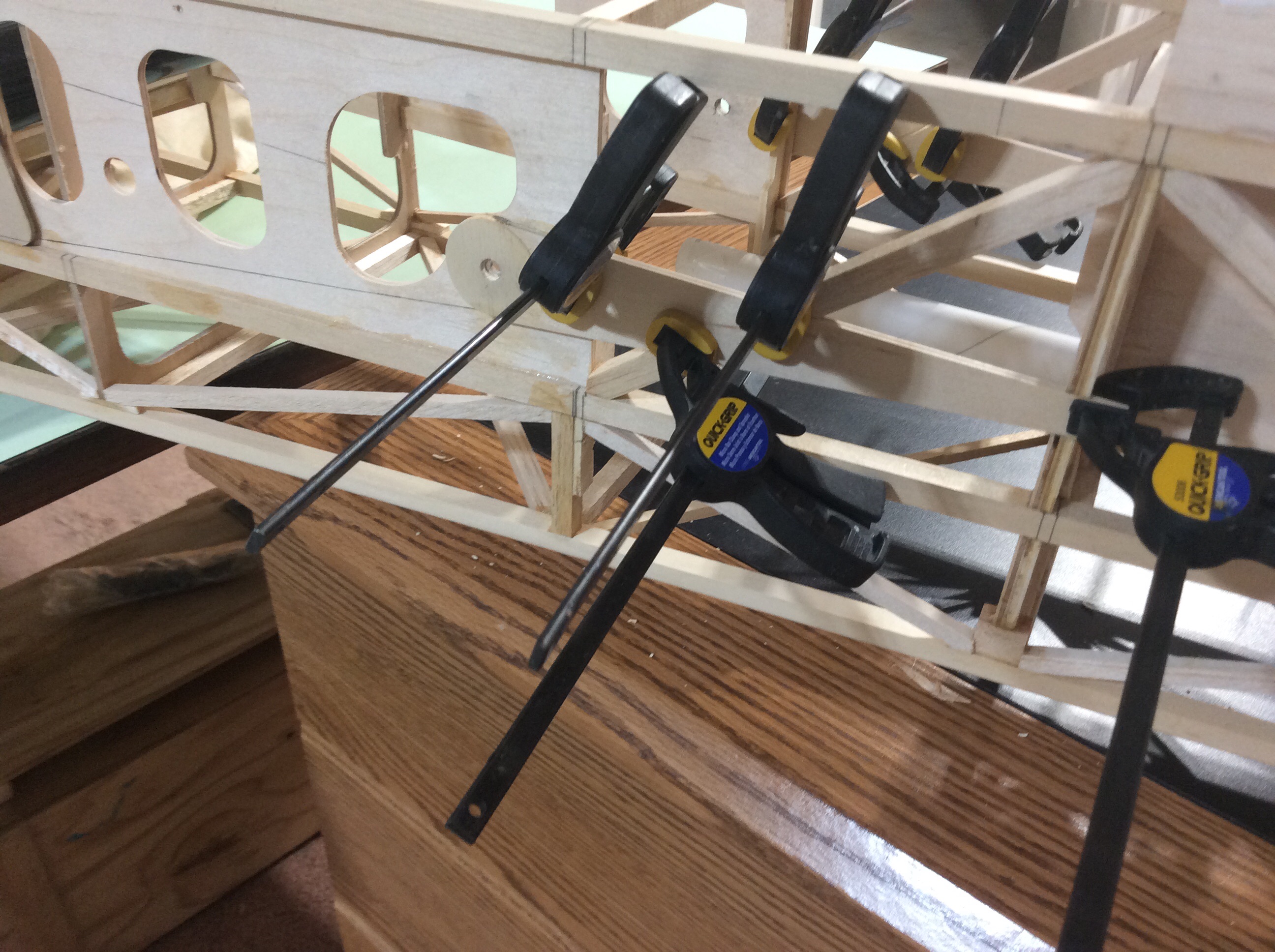

Just working on the sides of the fuselage to make it good flat surface for the wing to match on to. This will take some time and fitting of small parts to match the wing profile.

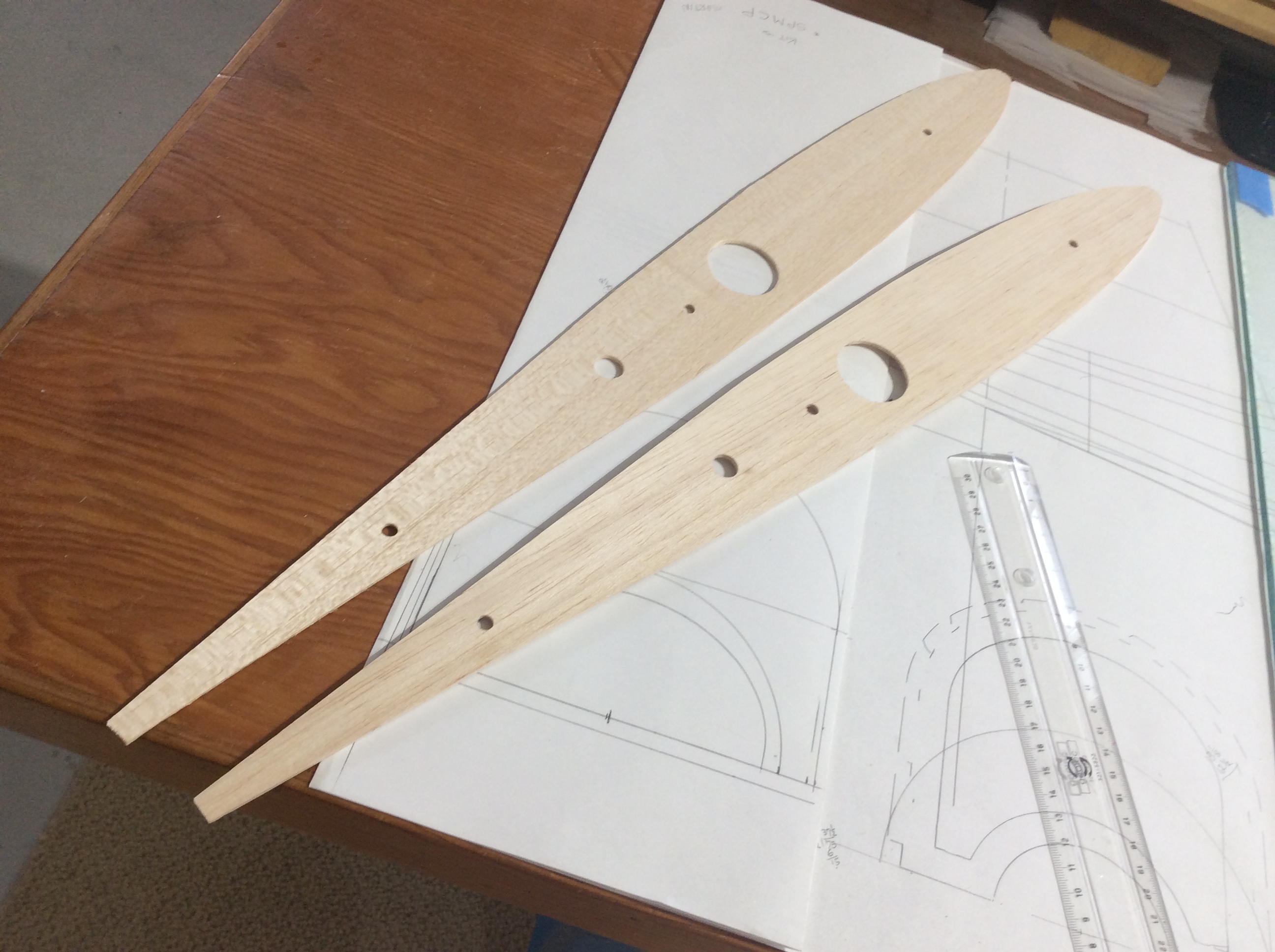

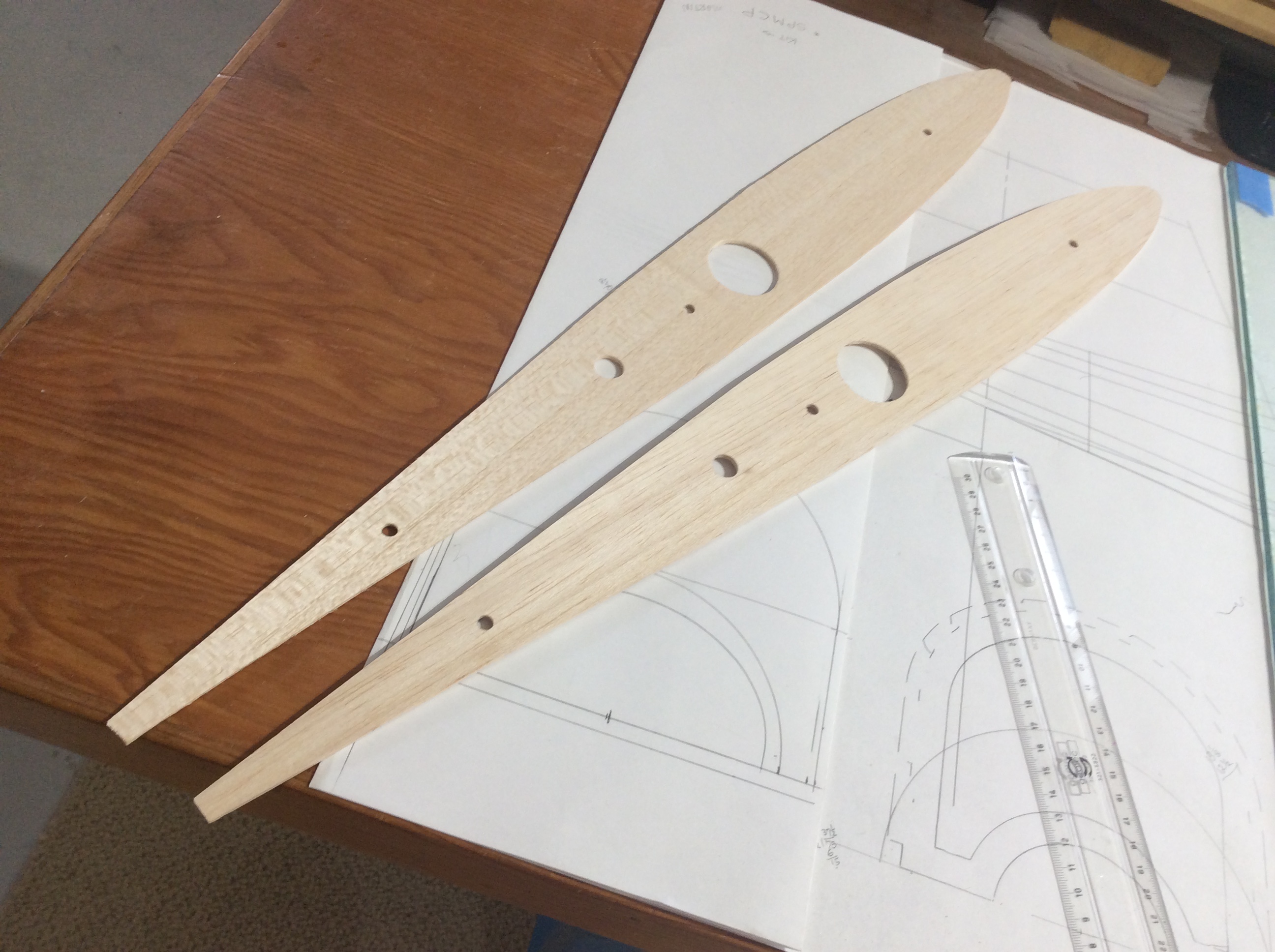

Made 2 new wing root ribs 1/8 thick this will be glued to the wing root this will give the ability sand the root rib a little to match the fuselage. The root rib on the wing is 1/8 aircraft ply.

Not a good day for me, I thought of how I would do the transition from the fuselage to the wing but it did not workout. So removed everything cleaned it up and will try some other method tomorrow, it happens.

Looking at the photo, looks like you need about 1" of filler, why not use a balsa block? I would get it close then use epoxy and microballoons to fll the small gaps and make a perfect fit
I was thinking of doing something similar, I like block idea, now let me see if I have 1 inch block 3 wide and 28 long.
